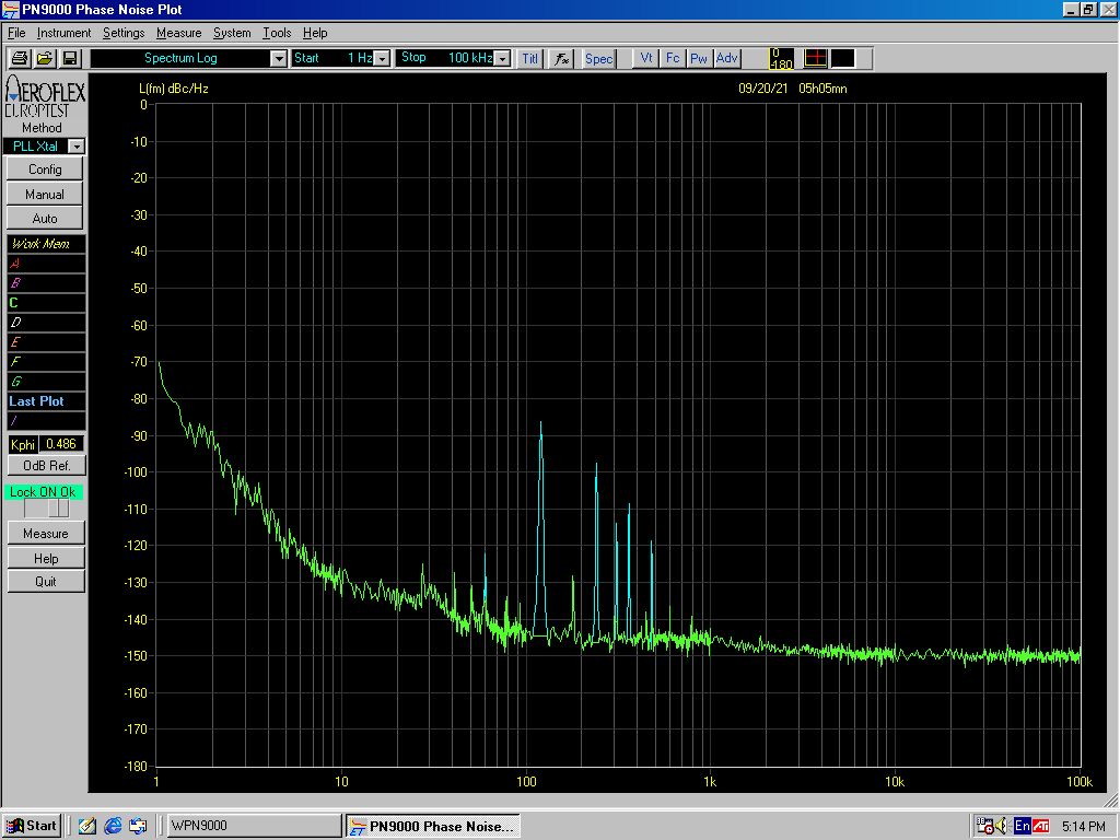

This is my first clock generator measurement. Schematic (there are a few changes)was posted in this thread. Essentially, it's a fractional PLL that generates the audio master clocks for the ADC and DAC starting from a fixed reference of 24 MHz (a 50 cents quartz) which is also used to clock the XMOS CPU. For audio purposes, this is followed by a series of jitter cleaners (also PLLs), based on the Cirrus CS2100 chip.
Attached is the phase noise plot for the worst case of 100MHz output (close enough to the 98.304MHz required for 768K conversion). Reference for the measurement is a Morion MV317 100MHz OCXO. I am sure Andreas will be deeply disappointed on the results 😀.
Because I see people around really like to push my buttons I thought I should revisit these measurements; and indeed I made an "small" error in reporting. The results are NOT for 100MHz as originally stated, but for 10MHz, using the PN9000 OCXO as a reference, upgraded with a Wenzel Streamline OCXO https://wenzel.com/wp-content/parts/501-31686.pdf unit. The conclusions remain the same, my clock generator has very good noise floor, but rather poor close in phase noise, so Andreas business in nowhere in danger :rofl:.
Sorry for the error, I did too many thinks over the weekend and didn't properly keep track of everything. The error would be obvious for those inquiry minds that would carefully look at the setup photo, rather than scratching their nose while commenting. It is obvious the 10MHz OCXO was in use. I'll post the 100MHz results with the Morion MV317 reference OCXO later tonight.
P.S. A simple inspection revealed the source of those spurious in the 100-1KHz range. They occur at mains frequency multiples, so it's a matter of shielding in my over mains polluted environment. Already discussed this in the LNA threads, I had to shield my best x1000 LNA (yes, massive paralleled JFET based Gerhard, it's perfectly stable) in half an inch of aluminum to clean the output.

I have built 100 MHz oscillators that go into peer reviewed space systems
and I know what is physically possible and what not.
You now concede a times 10 frequency error and back down to a
completely different setup but claim the conclusions stay the same.
I have pointed out your error, that's all.
It's YOU who tries to do phase noise voodoo in the audio field, not me.
That makes YOU a jitterati member, not me.

- Nobody claimed you are as ignorant as some of your friends around and nobody debated your qualifications and achievments. Admitting mistakes is a sign of strength, not weakness as you seem to believe, and proved by your position in ultimately stupid JFET LNA stability debate, where you programmatically choose to ignore hundreds of practical implementations, measurement and simulation results.
- Yes, the same conclusion, good noise floor but rather poor close in phase noise. Absolute values were wrong, not the shape of the result. A honest approach would be to look closely and point to a very obvious error. Instead, you always choose to jump to the guns, and get frustrated when responded with arguments (even if not always 100% right).
- If audio is boring, perhaps you should find another forum ready to bow to your knowledge and experience, without challenges and debates. Even so, I could help with the 15GHz phase noise, since the new system measures up to 26GHz, but then of course you would have to give up a drop of your ego. Not gonna happen, I know.
- Thank you. After so many years here, my ignore list is still empty. Very few made it temporary in, you are not one of them, only one is still an active member here. Now that I am ignored, I can feel your satisfaction irradiating through the screen glass.

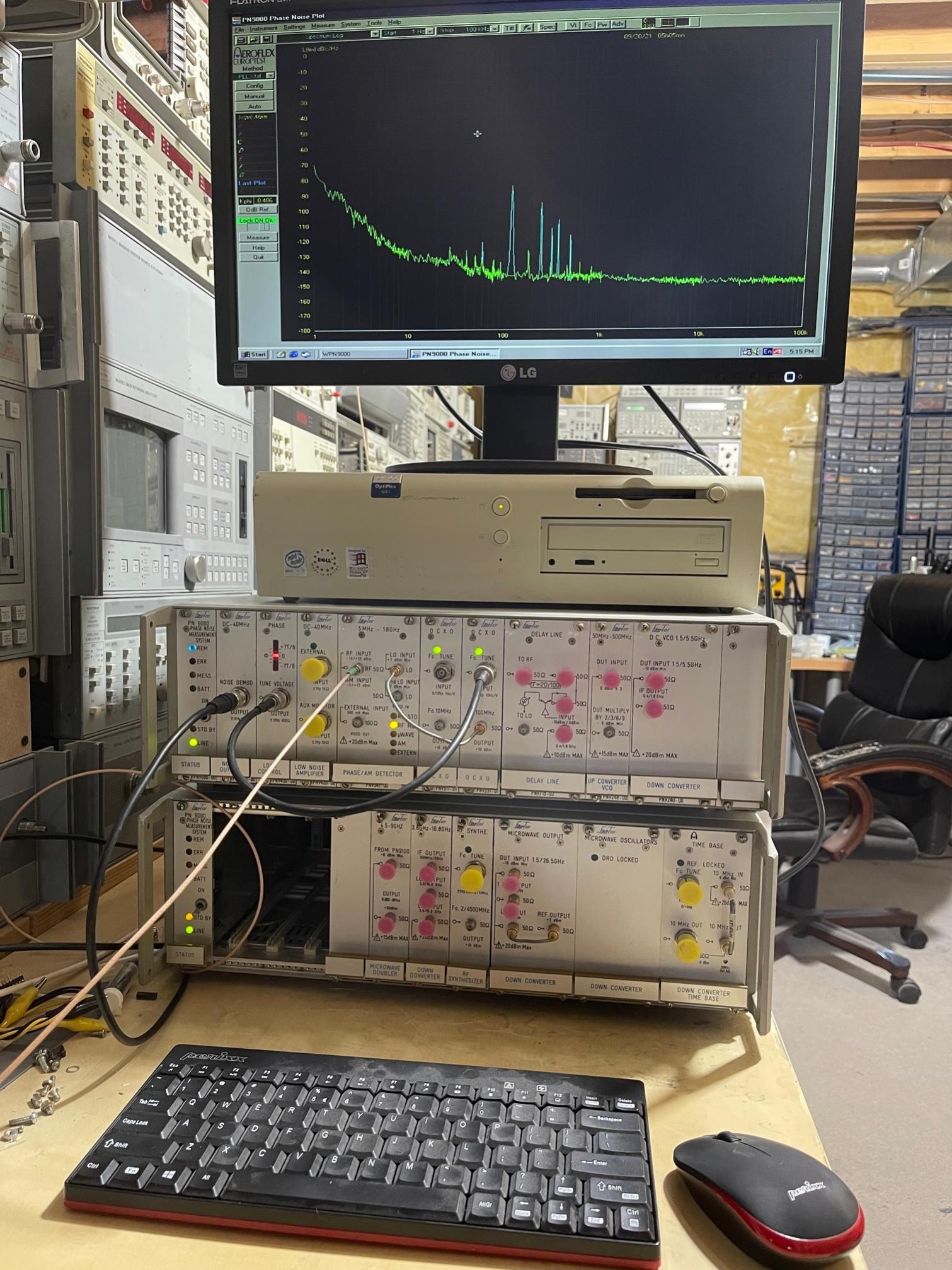

Here's the 100MHz results. and setup.

Don't hold your breath. If we are talking about the SNR impact of jitter, then the formula I posted above holds, and the numerical examples shows than anything in the single digit pS could barely be analyzed in the analog domain, set aside any useless debates about audibility.
As of the much invoked close in phase noise effect, I am not aware of any metric that could be conveniently measured in the analog domain. I think Andreas believes he could measure the effects by upconverting the audio signal, but I doubt an upconverter that would bring the audio signals to the RF domain could be build without additive phase noise that would completely obscure the audio signal jitter. I might be wrong, though, and as of the audibility of such effects, I'd rather stop before ruffling more audiophile feathers.
