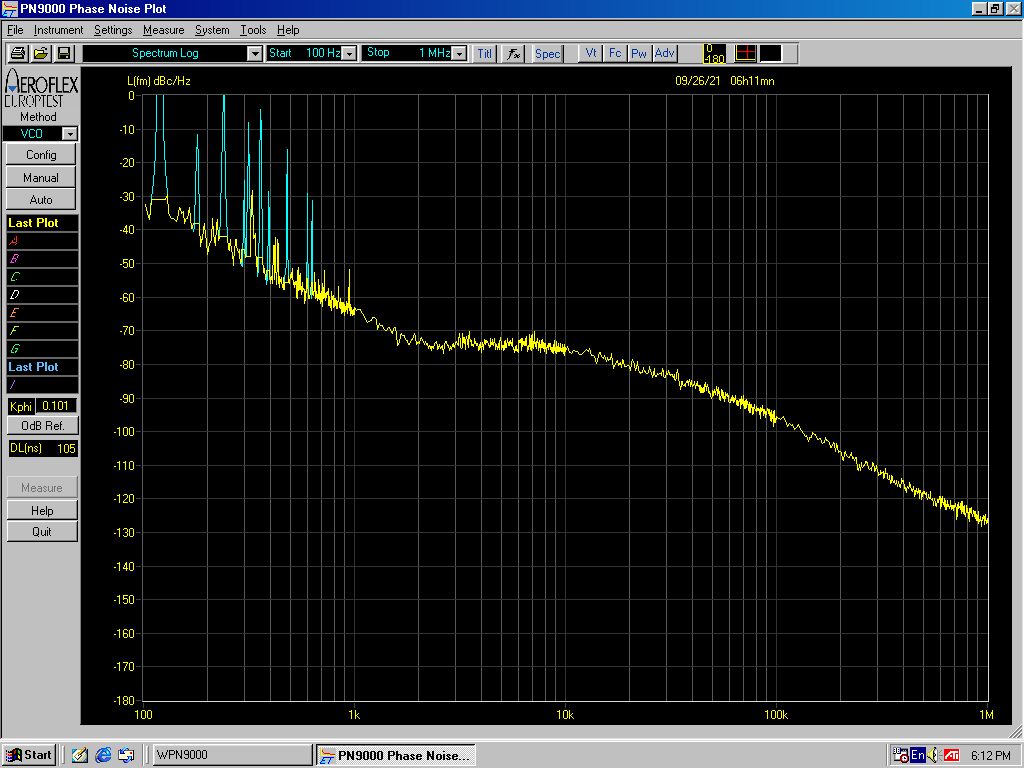

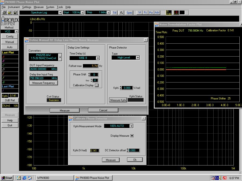

Here's what the PN9000 I got for almost nothing can do; Attached is a 26GHz signal phase noise from a hobby fun level synthesizer I built some time ago. TI LMX2594 chip based plus a Hittite HMC577 doubler, from the time chips were chips in the DigiKey shopping cart, not abstractions in a manufacturer catalogue.
The phase noise sucks, of course, this is only to show what some TLC can do to an instrument.
P.S. Among other minor issues, the 100MHz OCXO was working here and there, more like "there". Since I had nothing better to do with it, I cracked open the Wenzel 2x1 inch metal brick inside, and got the disappointment of my life. A PCB with a discrete PLL driven by an 100MHz, allegedly SC cut, crystal, in a TO5 case. The board had cold solder joints and some corroded PCB traces, from the foam used to isolate the board. Which was certainly acidic, since the insides had a distinct vinegar smell after opening. It's an old VCXO of the 500- series (meaning built to custom specs, no data sheet available for the public) but even so, I was not expecting such blunders from nobody else but Wenzel. Melted the hot glue used to attach the board to the metal shell, pulled the board out, repaired the corroded traces, walked a soldering iron across the solder joints, closed the brick, it is back to life, but to God knows what performances... It will be replaced with a Morion OCXO, anyway, pretty soon.

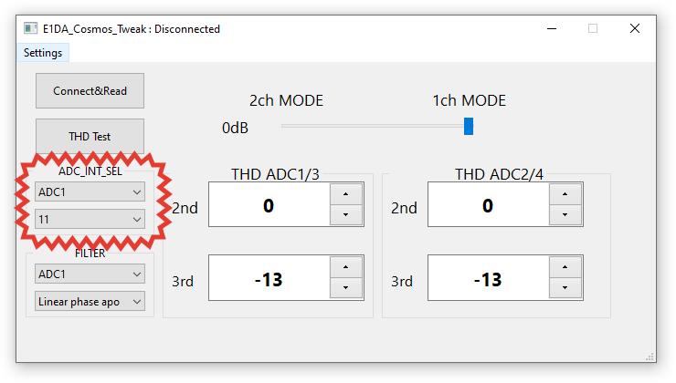

The ES9822 THD compensation isn't just limited to the 2nd and 3rd harmonics. You calculate the entire polynomial and coefficients to be programmed into the correction registers.
I am assuming that you could, theoretically, add in as many orders to the equation as you want but the resolution for storing the final result might be limited.
With enough patience, trial and error, and a clean enough signal source, you could compensate down to 0.00002% in my opinion. Whether or not this is necessary, or reliable, is another matter.
I've got a dual mono 9822 acting as slaves. For optimum compensation I'd want to split these into stereo ADCs first and then compensate the left and right channels separately. Then do this for both ADCs. 4 separate sets of finely tuned THD compensation coefficients and out to the 5th harmonic if I really want to push it. I cannot be bothered to do this though.
For simplicities sake I tried using one set of THD compensation coefficients for all 4 channels and only targeted the 3rd harmonic. With the 2nd/4th down at -140dB+ they don't need any attention it's just the 3rd and 5th that really do.
Regardless, the simple compensation gives me 0.00005% THD and 0.00008% THD+N with ARTAs A weighting at 0.5dBfs which is as good as I can realistically expect from the AK4499 signal source as I've measured when using a notch.

BTW, I brought the ADC_Int_Sel parameters for all 4 ADCs to the Windows app because you can really find a better SNR if you change the recommended 0xB e.i. 11 to something else even different values in the pair ADC1 = 11, ADC3 = 15 as an example. Some chips up to .3-.5db better vs recommended 11.

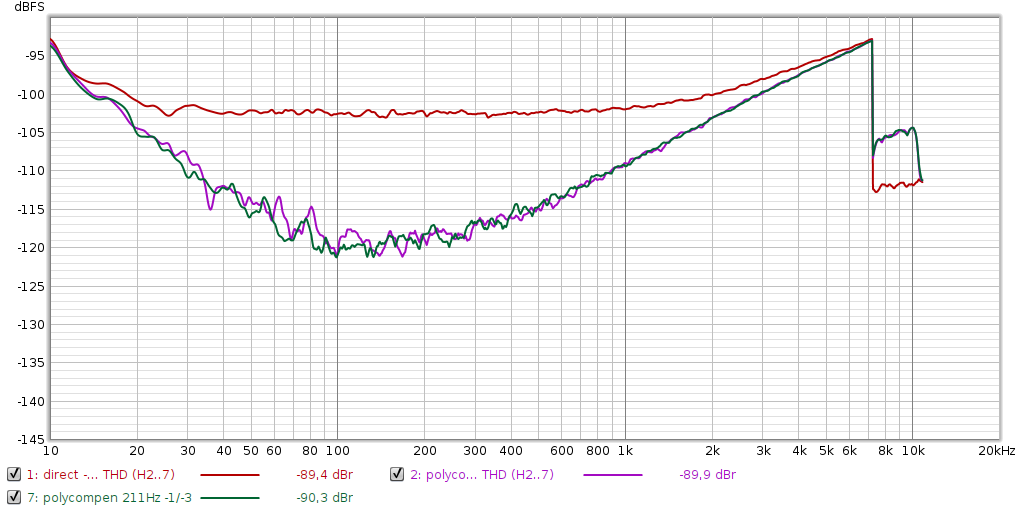

One question just hit me. With the distortion correction does it hold for small changes in frequency? We have a tendency to use nice round numbers like 1KHz. But 997 Hz may well exercise more "bits" in the AD and DA system and highlight any particular steps that are not ideal. We know that Pavel's correction is sensitive to almost everything. Is the ESS more resistant?
ESS distortion performance by frequency has been measured in A Look Inside the New ES9028PRO Converter Chip and the New DAC3 - Benchmark Media Systems - see their chart
My results for static polynomial were very similar to the Benchmark measurements. I calculated two transfer polynomials - from distortions calibrated at 211Hz and 911Hz, they ended up basically identical. It makes sense - static distortions do not change with frequency, being static :)

The static distortion compensation tries to straighten the static transfer function (linearity) and as such it applies to any frequency.
As of the performance drop at lower and higher frequencies: For the lower frequencies I assume the THD measurement is affected by the increased 1/sqrt(Hz) noise. For the higher frequencies the dynamic distortions take over the static ones, the distortion phases are rotated from the "static" angles H2: -90deg, H3: -180deg, etc.,
The static compensation adds/subtracts harmonics at the "static" phase angles, as "generated" by the polynomial. The dynamic compensation method I use is employed by many other projects. It's nothing new, I just applied it to the audio measurement chain. It pre-determines amplitudes and phases of the distortions at a specific frequency. The pre-determined distortion tones are re-generated at the same phases and subtracted from the incoming signal when measuring the DUT. Therefore both static and dynamic distortions are handled.
If the distortions are determined (calibrated) at 1kHz, they will apply at 997Hz too, the dynamic distortion profile does not change so wildly. But the compensating H2 has to be generated at 2x997Hz, not at 2x1kHz for which the profile was calibrated. So the dynamic distortion compensation by generating harmonic anti-distortions does not apply only to that exact frequency only, it's valid within a range around the calibration frequency. Width of the range depends on distortion profile of the device, of course. BUT this compensation method requires knowing the fundamental frequency exactly (either by analyzing the incoming signal or getting the info directly from the generator), so that anti-distortion sines are generated at correct frequencies.
The major advantage is maximum performance for a signal containing only single and multiple tones which is the typical signal for measuring ultra-low distortions. Performance of the method depends only on precision of measuring the distortions, theoretically no distortions remain as a harmonic distortion is "only" a sine wave of amplitude and phase, nothing more.
Actually my latest version of the compensating tool compensates the static distortions by a polynomial (for any input signal) and the remaining dynamic distortions if applicable (for pre-calibrated single or multiple tones only).
It definitely did hold with me. In my case the performance of the ADC was only really affected by the 3rd order harmonics. When measured this dominated the entire DAC>ADC signal chain. A 0.5dBfs signal to the ADC basically had all harmonics well below 0.0001% from something like 100Hz-20kHz except for the 3rd. This sat at around 0.00015%.
Whether or not this was from the input stage or the ADC I don't know but I couldn't be bothered trying to figure out. I am using an ADA4945 to drive the ADC directly with 330ohm feedback resistors. I figured it should be capable of much better than 0.00015% at the given drive levels and datasheet so maybe it's the ADC, whatever, it doesn't really matter. With the 3rd order compensated away that neatly brought it in line with the other harmonics giving me a THD of ~0.00005% at 0.5dBfs.
Without the THD comp the 3rd order measured as a flat line from 20Hz-20kHz and sat at the aforementioned 0.00015%. With THD comp on that flat line just shifted down to 0.00003% or something and sat there across the entire frequency bandwidth. With 100kHz bandwidth it went up to around 0.0001% above 20kHz but that was about it.
Clearly the THD comp effectiveness is only as good as the linearity of the rest of the system. My 3rd order was a flat line without any significant deviations at the frequency extremes. This is, apparently, easy to compensate out as it doesn't fluctuate, or require different compensation values for different frequencies. If the ADC driver had shown a significant increase in 3rd order distortion, with rising frequency, then I'm sure the THD comp wouldn't have been anywhere near as effective.
