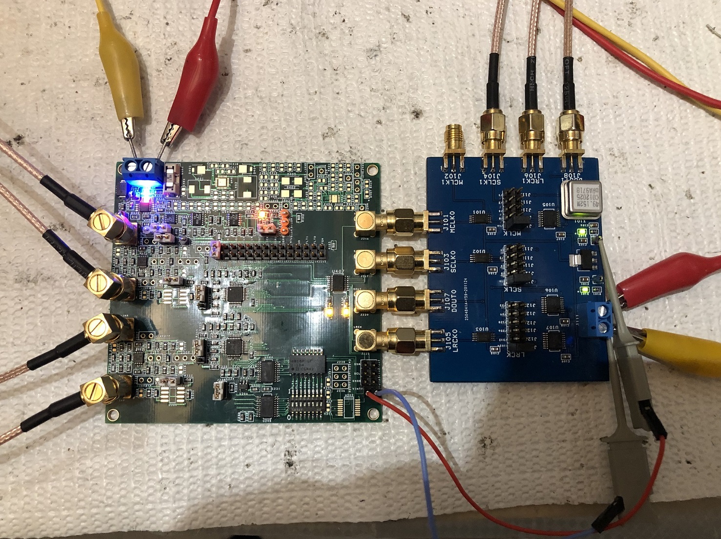

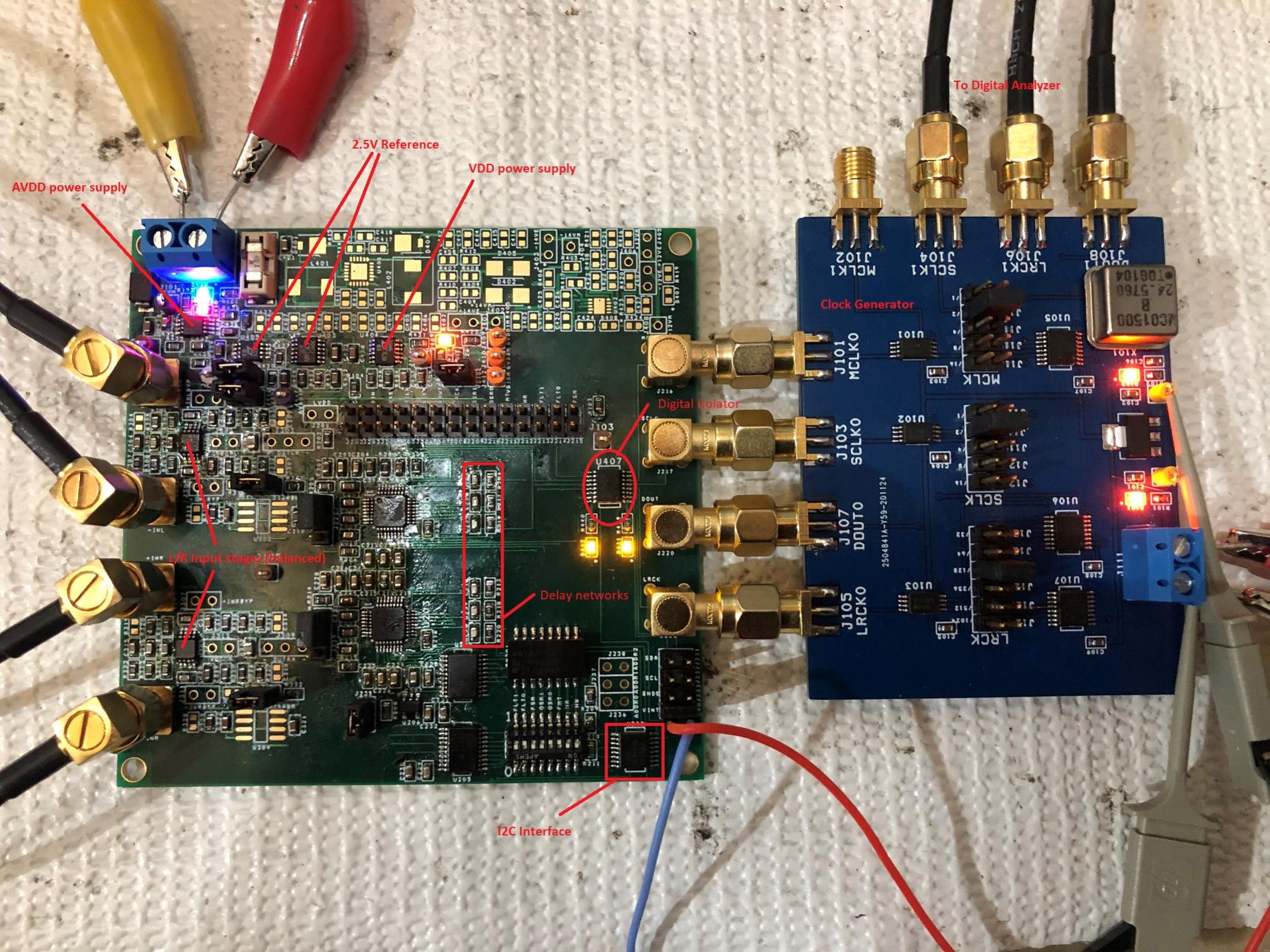

Update. Attached is a photo of the ADC, 2 x ADS127L01. Preliminary measurements are right on target, -125dB THD @1KHz @48KHz sampling and is ruler flat (no noise shaping) up to the maximum sampling frequency, 384KHz. @20KHz THD is a measly -118dB @192KHz sampling.
Maximum sampling frequency is 384KHz with OSR=32. The secret for going that up (the max MCLK frequency is only 16MHz) is to take advantage of the internal slave/fsync mode, which includes double buffering. This makes possible to use a MCLK=12.288 MHz and BCLK=24.576MHz (both within the data sheet spec) with OSR=32. The 2 ADC chips are daisy chained. The on board logic (no CPLD or FPGA!) implements an addressable I2C bus, since in FSYNC mode the ADS127L01 internal registers are not accessible, so the external I2C bus controls directly the hardware pins. The board is still somehow experimental, lots of headers and jumpers are provided to facilitate measurements and various configurations. Converters are in slave mode, clocks are provided by a TI CDC925 synthesizer (in the future will come from the XMOS bosrd synthesizer). Board is fed by a single 5V (USB) voltage, everything (+/-12V for analog input stages, +3.3V digital, +3.3V analog, +2.5V reference) are generated on board by switching and linear low noise regulators. Reference is LTC6655 + LTC3045 and has about 5nV/rtHz (note to myself: need to measure again). Board is 4 layers with a solid ground plane split in 3, analog ground, digital ground and input analog stage ground, connected in single points to minimize the ground loops. Input stage is based on the THS4551 differential amplifier, with a switchable OPA827 single ended input. All passives RC are size 0602.

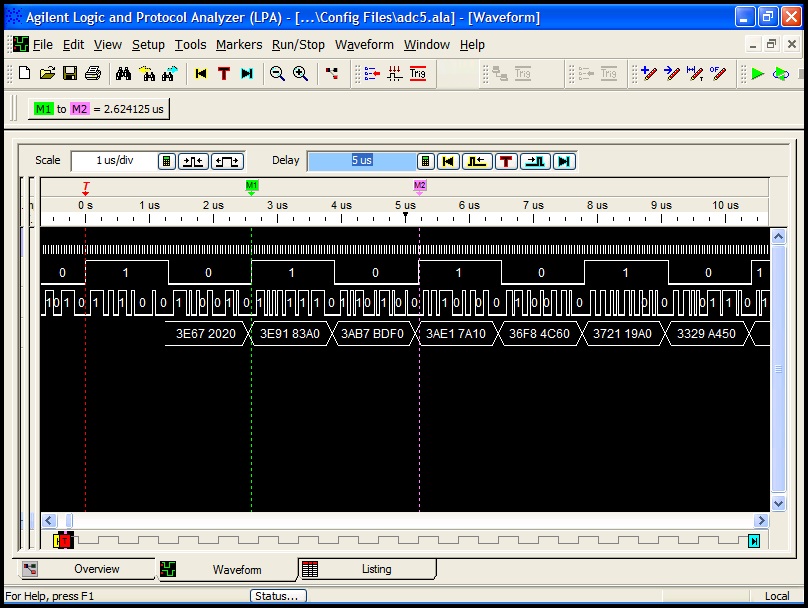

Attached is also a screenshot of the logic analyzer, with a few 384KHz conversion cycles, together with the serial conversion. Output is 32 bit, but bits 28-31 are always zero, while bits 24-27 are an internally generated checksum, which will be removed after transferring to the XMOS chipset.
Now, on to some serious and detailed measurements/characterization. I'll post the final measurements and the schematics if there is any interest.

Schematics and Gerbers (even if just as a SMA test platform)! If what you have measured is repeatable and no other issues appear, many will ditch audio interfaces for measurements assuming it can adapted to a USB input device with a few more chips.

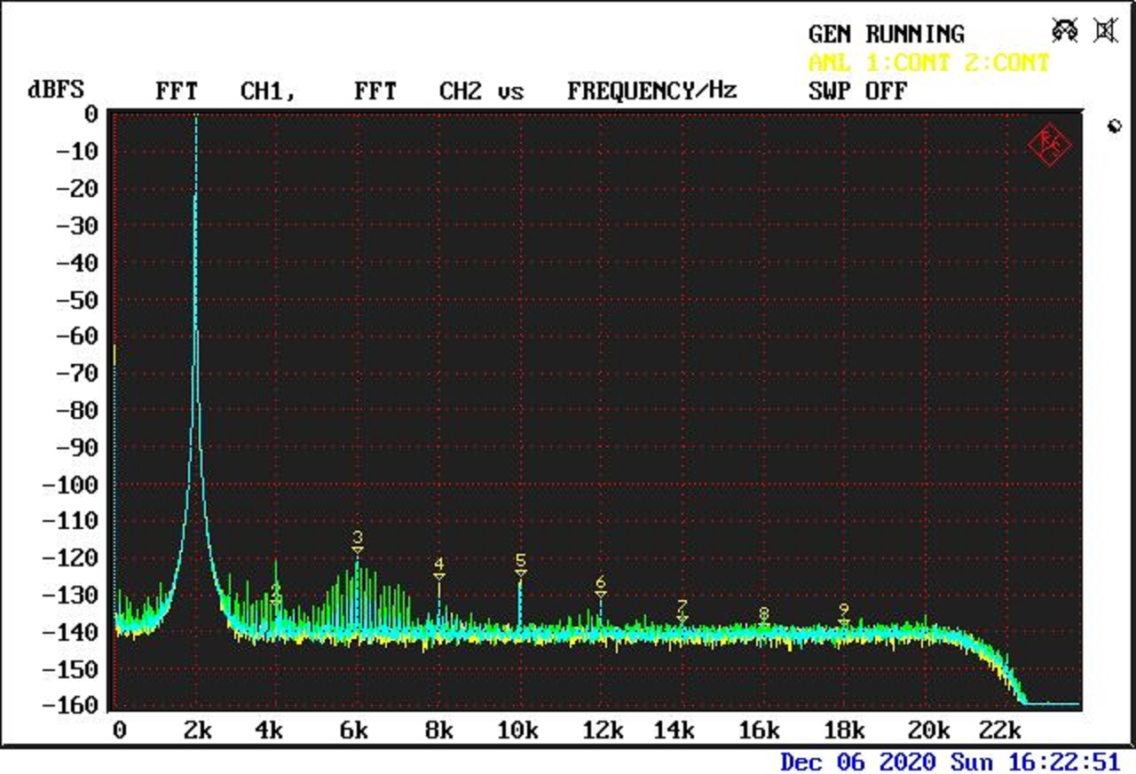

Not much time lately, unfortunately, but here's the noise floor: -138dB. Given the bib size of the FFT, this maps to a SNR of about -107dB, in line with the data sheet. Some spurious are due to the lack of shielding and my lab known contamination with 60Hz harmonics (see the LNA measurements discussion in another thread). No noise shaping effect, of course 😀
Sampling rate is 192KHz, 2048 points FFT, MCLK=SCLK=12.288MHz, OSR=64, WB1 filter, ADS127L01 is in HR mode, differential inputs (THS4551 with gain=1) shorted, Vref=2.5V, channels are daisy chained.

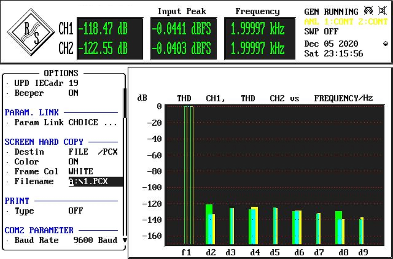

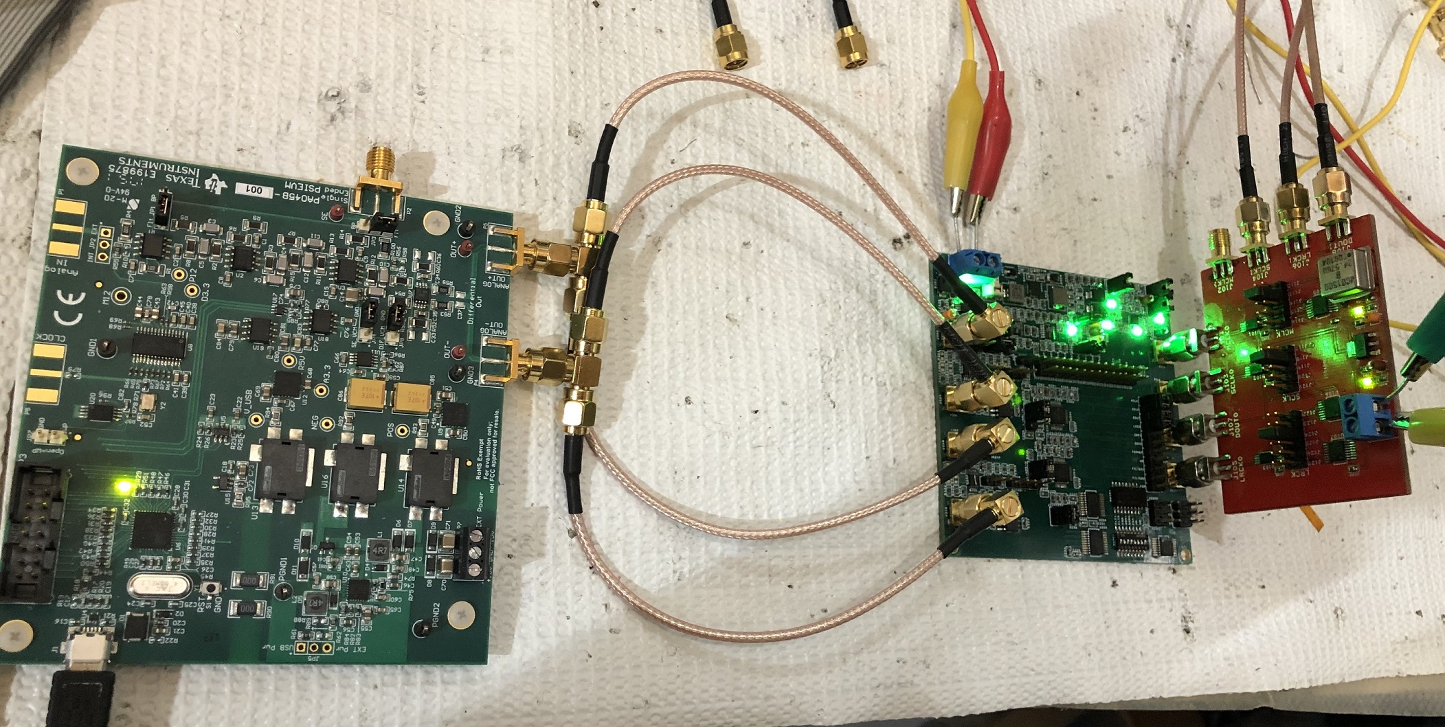

Distortions, see attached.
I build a simple synchronous clock divider (red board), 3 x 74LVC163 synchronous counters driven by a 24.576MHz 50ppm crystal oscillator plus three LMK1C1102 dual output clock drivers (one set of outputs for the ADC board, one set for driving the digital analyzer with SCLK, LRCK and SDOUT.
An ultra low noise 2KHz (<135dB) sine generator with balanced output is connected to both analog inputs, sampling frequency is 192KHz (I wish I could go to 384KHz, but my Rohde doesn't go that high).
Interesting asymmetry in THD, at -0.1dBFS. ADCs are sharing the same reference, so not much to look there. If I go down to -0.5dBFS the values balance nicely at around -120dB+/-1dB, which is what I was expecting at 192KHz. The delta at -0.1dBFS remains almost unchanged if I go down to 48KHz, or change the over sampling ratio (went down to MCLK=SCLK=3.072MHz and LRCK=48KHz), also balancing if I go to -0.5dBFS, to about -126dB. So it is either the THS4551 differential amplifiers at the input (I doubt) or something inside the ADC chips, I should bite the bullet and swap the two sets of chips, not much in the mood for this delicate surgery for now.
Anyway, another set of boards are on order, with better symmetry around the ADC chips and on board digital isolators from SiLabs. I cobbled a small board with 5+1 channels (3 clocks and 2 I2C lines, plus 1 SDOUT) and the noise decreases some 5 dB, bringing the ENOB to about 20.5dB which is again what I would expect. Right now, THD+N @192KHz is around -114dB, not too shabby, but I hope to bring it close to -120dB with the digital isolators.

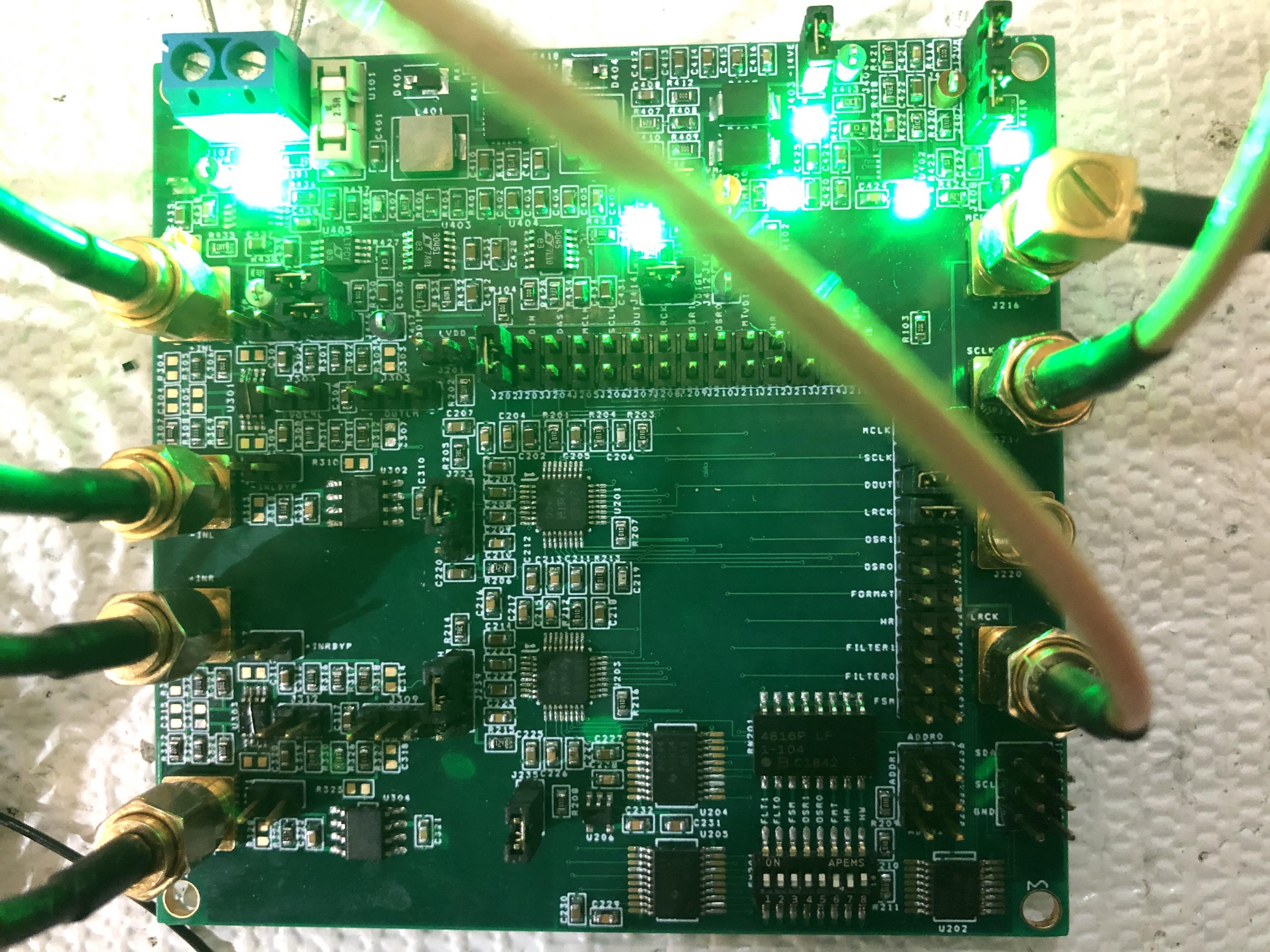

Very, very hard to optimize this ADC, at all sampling rates and oversampling rates... My lack of experience in digital designs and the sad fact that a reference design for the ADS127L01 does not exist (the Texas Instruments EVM board is intended for showing the DC performance only, it does not include anything AC related) are certainly not helping...
I've found out the hard way (the data sheet is not exactly clear in this respect, only a short paragraph) that the ADS127L01 ADC inputs are not buffered, so the analog input signal conditioning requires quite some design and optimization, to avoid the switching glitches. Of course, the EVM input stage is not optimized for AC, although the required parts do have placeholders on the PCB.
Secondly, the required clocks for the Slave mode are tricky to set up; having MCLK, SCLK and LRCK synchronized (like for an audio ADC) leads to sub optimal results. For reasons I do not fully understand (and probably never will, given the lack of any insights of the chip internals) these clocks need a carefully timing between them and to the start of conversion (which here is on auto). I had to add RC cells on each clock lines and experimentally adjust each while optimizing for the overall distortion performance. Again the EVM has only a 10ohm/10pF RC on the MCLK line, which, as it is, does pretty much nothing to optimize the 3rd harmonic (that's where the impact is). Of course, I am talking here about <-100dB which is outside the scope of the EVM.
Here's the best results so far, still working on optimizing the beast. Needless to say that the PCB layout is also critical, I was not expecting having 2 chips to be so demanding in terms of symmetry and clocks distribution, after all it's only 12 MHz...
A digital 6 channel 5+1 isolator Si8661 was added to the PCB, and it helped a lot with breaking any ground loops. 3 inputs are the clocks, 2 inputs are the I2C lines and one output is the serial data out mux. The board in the photo has only the minimum circuitry soldered, the whistles and bells (power supplies for the high impedance input stage, the high impedance input stage (OPA827) allowing single ended input, the I2C expander) are set aside until the distortion performance is fully optimized.
The THD is now practically -120dB, which is what I was expecting. THD+N is now sligtly under -100dB, but from the spectrum it is clear that a big contribution is the spray of 60Hz harmonics up to 4-5KHz. In a shielded build, given the noise floor of under -140dB, I would expect a THD+N better than -110dB, which is again what I was expecting at this stage.
This is still work in progress, I want to get the last drop of performance out of this ADC. It is already better than any audio ADC I have seen, but it can do further down. I'll update here from time to time.

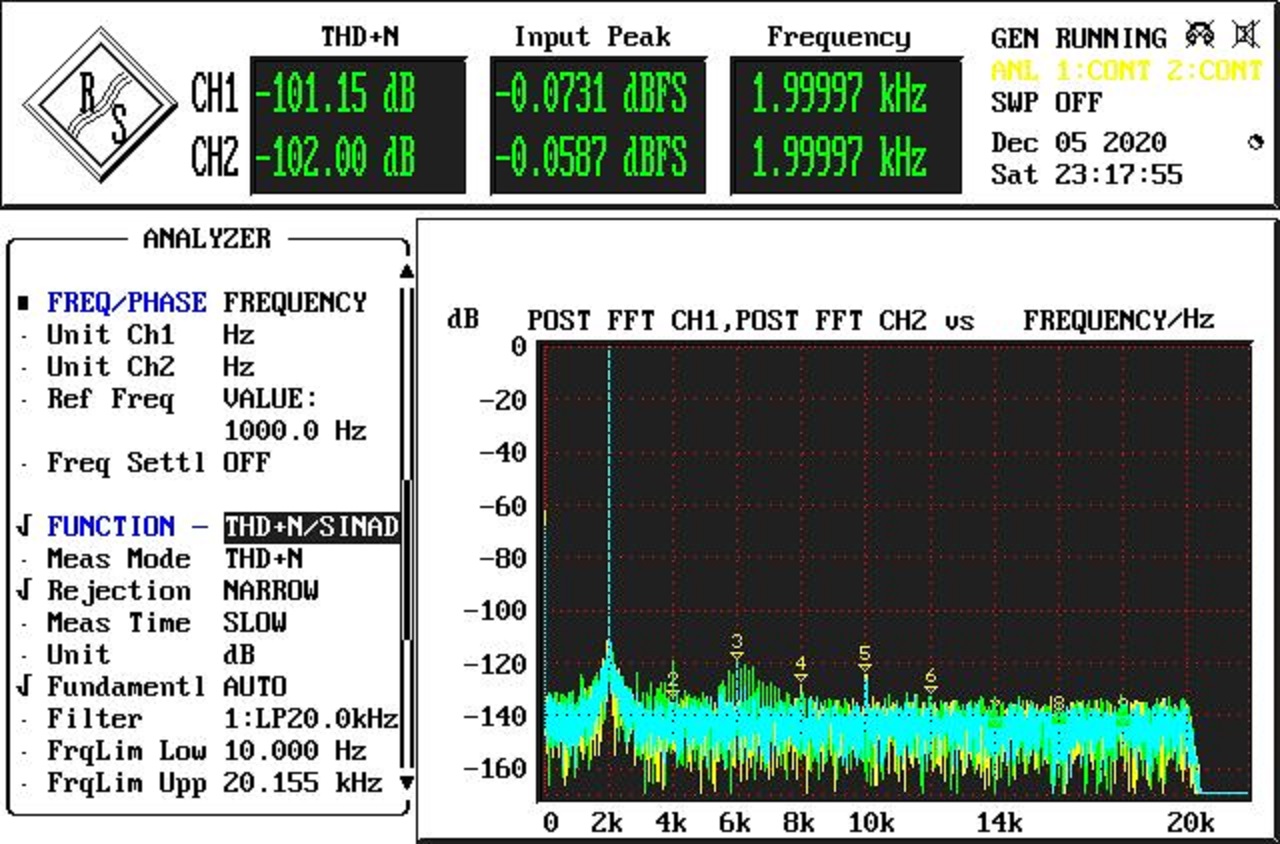

An averaged spectra clearly shows the harmonic (60Hz) noise being responsible for the THD+N performance. Hanning window, 8192 bins, 32 averages. Shielding is going to be required and it's not going to be trivial... With proper shielding I am now confident the THD and THD+N performances are going to be close, currently at about 0.0001% @2KHz/48KHz sampling.

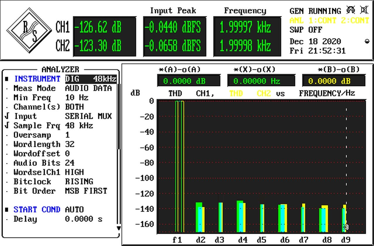

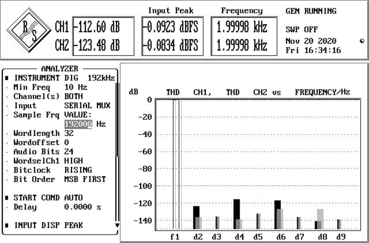

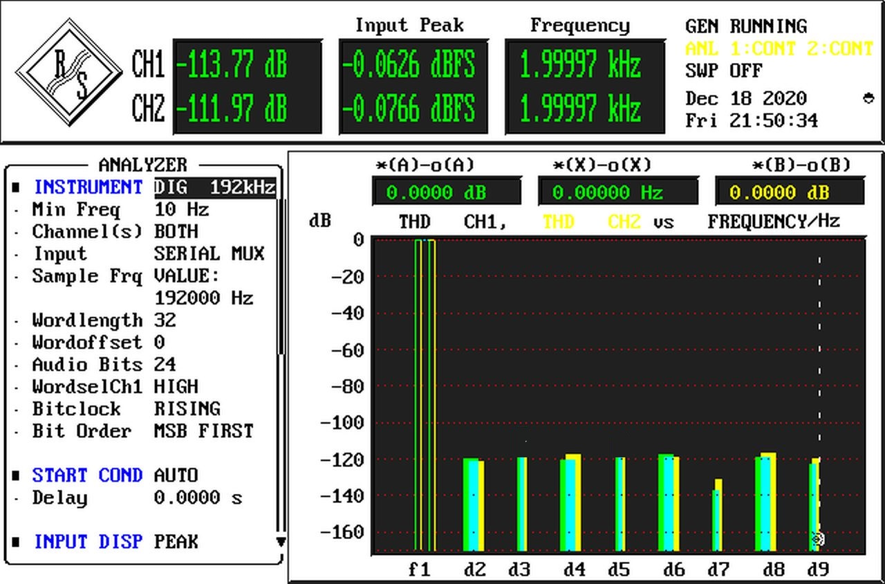

Follw up on post #307. This is the final version of the design and PCB. Same signal generator having 2KHz and THD about -129dB. At -0.1dBFS:
48KHz SR with oversampling x64, THD is -125dB.
192KHz SR with oversampling x64, THD is around -113dB.
This time the channels are almost perfectly symmetric. Providing an improved distribution for all clock signals and optimizing the timing (delaying the LRCK 4nS ref. MCLK and SCLK further delayed by some 3nS) pretty much cleaned the distortion spectra.

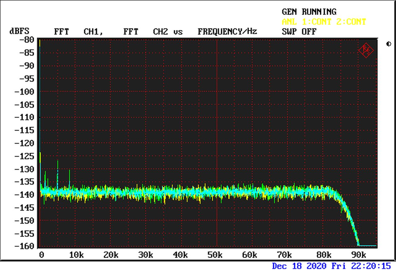

Noise floor is about -140dB with 8192 bins in 96KHz. Some spuriae are still visible, but nothing that I would not expect from an unshielded experimental board.
This concludes the experiments of using an industrial grade ADC for an audio analyzer, I am happy with the results, much better than I have seen with any audio grade ADC.

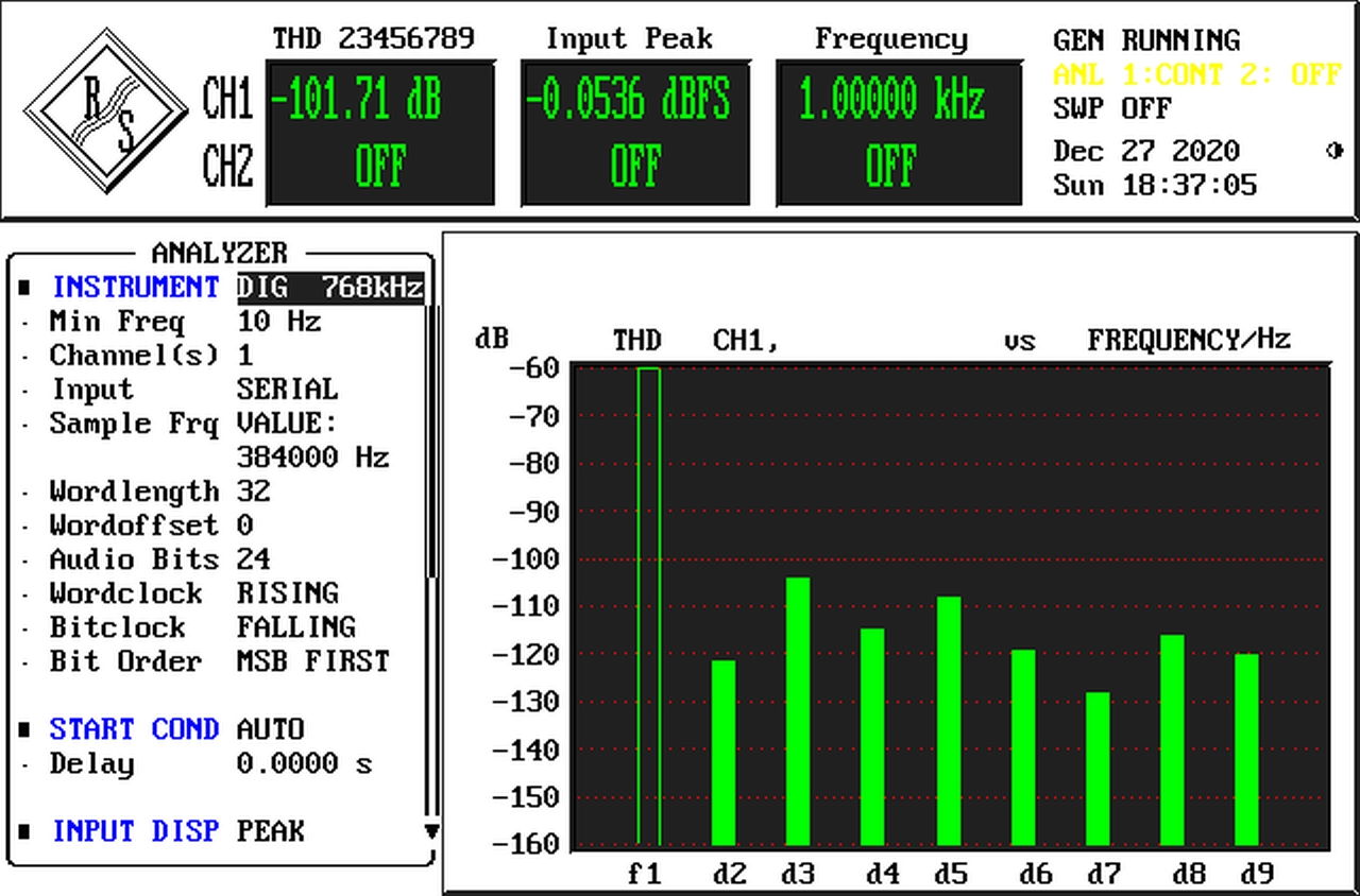

Below, 1KHz sine with THD -129dB sampled at 384KHz.
THD is -102dB (0.0008%), not too bad, about what I was hoping for. Unfortunately the digital analyzer doesn't let me include more than 10 harmonics, but I don't expect any sudden rise up to say 80KHz.
