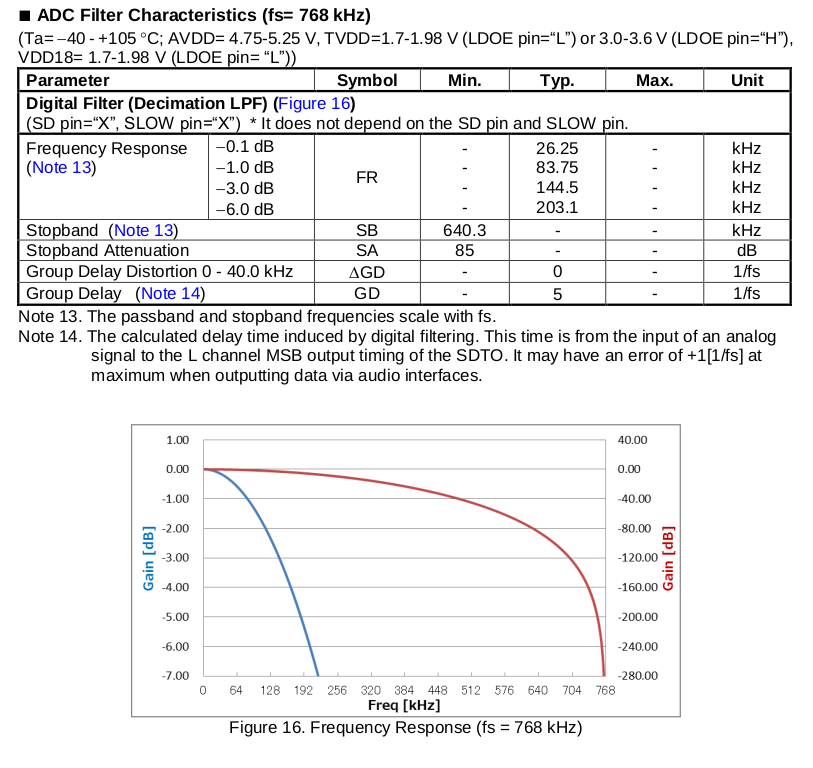

I considered AK5572 but was fast discouraged by params of its higher-samplerate filters. It looks to me like they took an old (192kHz) design and tapped the filter section to accept higher samplerate, but the actual conversion stage runs basically unchanged.

If you want something with a low noise up to 96 kHz you should take a look at the AK5397.
I used it initially, but changed to the AK5394A because the distortion of the AK5394A is lower. But in terms of noise, the AK5397 is better.
I did, and the AK5397 is IMO not up to the task of distortion performance for instrumentation. -108dB is a non starter.
AK5394 is slightly better (still not good enough, IMO), but it's no longer in production, anyway.
