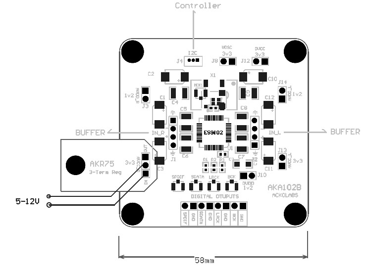

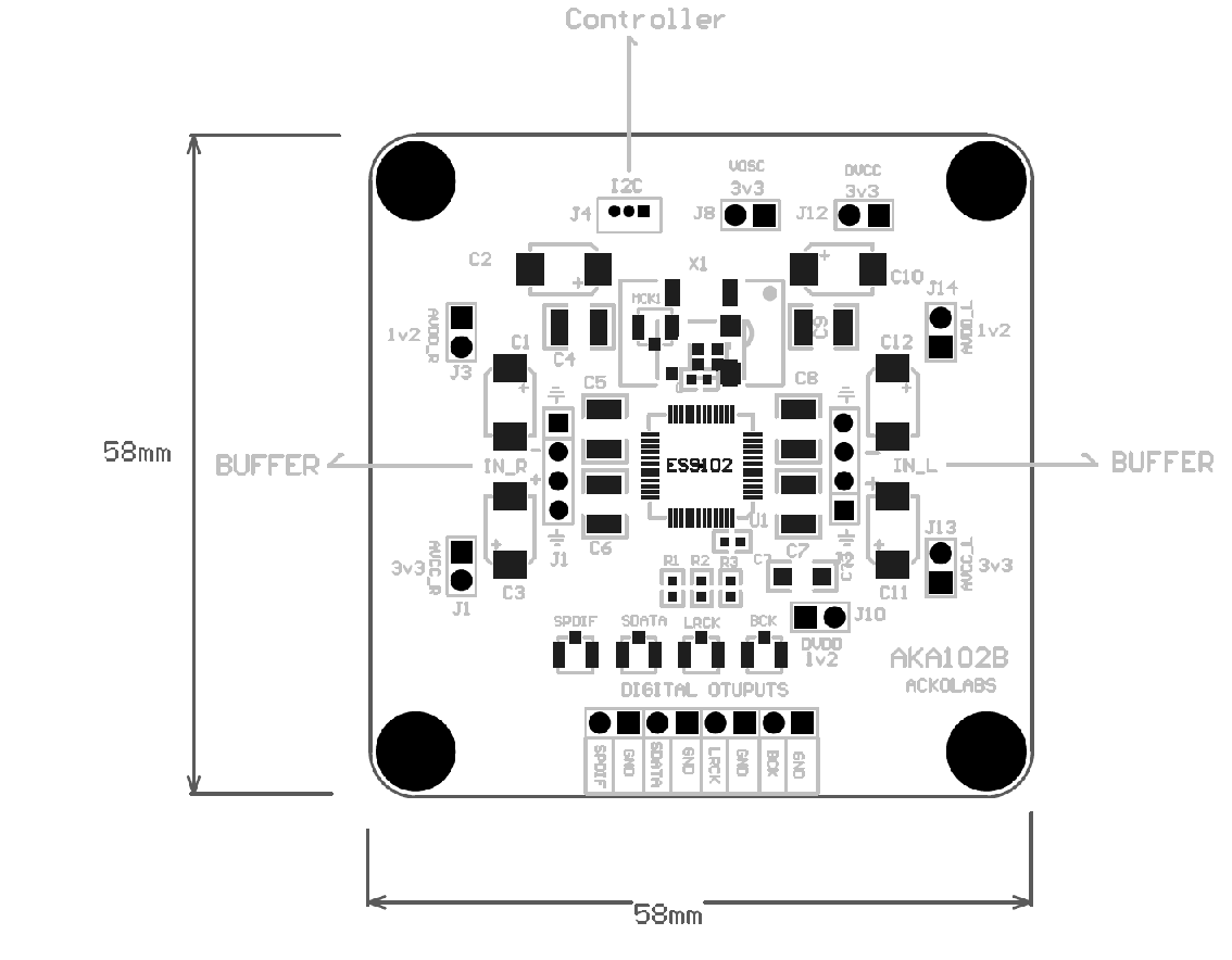

Basic model:
Requires external 3.3V and 1.2V supplies as shown
Empty board: USD 45
Only IC loaded: USD 85
Fully loaded module: TBA
Availability: TBA

Schema, BOM and support information provided for this basic version (AKA102B). Prices are for FR4 boards only. Teflon/Rogers option ~$120 extra. All options will be listed when design is ready.
On-board XO can be 9x14mm, 7x5mm or 2.5x2mm types. Suits Crystek CCHD957 and NDK XOs. U.FL coax for external clock if preferred

Sounds great all around to me. Without a controller, what comes out of the board?
Would be nice with some onboard strapping possibilities.
Without a controller only i2s output, could always send that to a hardware DIT of your choice for SPDIF conversion if that's your preference. I read the datasheet a week or so ago and don't have it in front of me, but I believe that you can configure whether it is master or slave i2s device.

ADC is Hi-Res full 32bits in I2S mode and full 24bits in spdif mode.
In hardware mode only I2S is available. Spdif disabled
Sample rates can be selected in hardware mode: 48k, 96k, 192k and 384k (running on a 49.152MHz MCK). If using 45.1584Mhz then 44.1k based Fs possible
No RIAA filters enabled
No mono mode
No multi-channel

I would prefer to have on board power regulators (SMPS and very good traditional regulators), since these are difficult to design. Maybe a separate card for this?
There are several well known psu designs already. You can also use 3-term types with connections as shown. Makes it very straightforward and you can experiment with different types rather than a fixed on-board one
