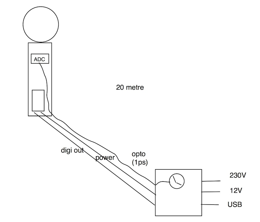

Acko, I'm almost on the list, just want to understand that I can master the task to make what I want. A small, hyper quality 2ch (or more) field recording thingy. zenelectro seem to be a good companion to have onboard the project. Lets nail the clock solution. Including consideration for mechanical vibration and power feeding quality etc.
I form factor was really long and small, I would like to built it into the mic(s) for shortest possible analog signal paths and long power/digi connections.
Then I dream about an optional clock distribution from a central point, with clocks mechanically isolated, using (femto-)opto in a synchronous fashion without any PLL in the ADC in the mic(s).

To get a clean clock you could consider the MiniDSP USBStreamer instead of the miniStreamer. And add an interface like the one I have described here:
http://www.diyaudio.com/forums/digital-source/244042-master-clock-isolator-minidsp-usbstreamer-3.html#post3751341
This would allow you to use the cleanest clock that you can find. And if needed it would provide 8 channels instead of 2.

Thanks Terry, couldn't agree more. I we pare back then the performance drops accordingly. I will be focusing on the ADC module only initially and other specialised modules to match in future. The preview shows the concept design for a 2CH board and as you can see with all the power supply requirements, etc puts the level of complexity right up to that of the 9018 DACs. Inputs are line level and requires specialised buffers to drive it as its immediate front end. Mono and multi-channel mode are even more involved with external controller development.
