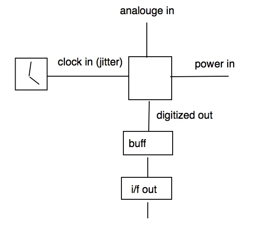

Jitter on the ADC data transfer is a non-issue. As long as the data is transferred bit perfect the only issue is that of the sampling clock jitter, reclocking the data achieves nothing.
Correct - I'm worrying about the clock *into* the ADC chip. Surely the Ian clock could be used to feed the ADC process. And then we need to take care of from the ADC chip outgoing bit stream (which now has no jitter aspects) ... here a buffer is probably needed before it hits a suitable interface standard... buffer.... Ian.... 🙂 but maybe that buffer is a bit overkill here...

A few points:
A few points:
- I believe there is a good clock on the chip.
- There is need for a super stable power regulator.
- Support for different input levels (MC, MM, rca line level, pro line level)

I'd leave the head amp stage separate. People will want different impedance matching and a bunch of different gain values ...
Yes, agree these are specialized designs and others do it better. The last time I looked at a MC circuit was 20 yrs ago!

The 9102C has a slave mode so should be possible
- Digital Line Level
- ADC using ES9102/9112
