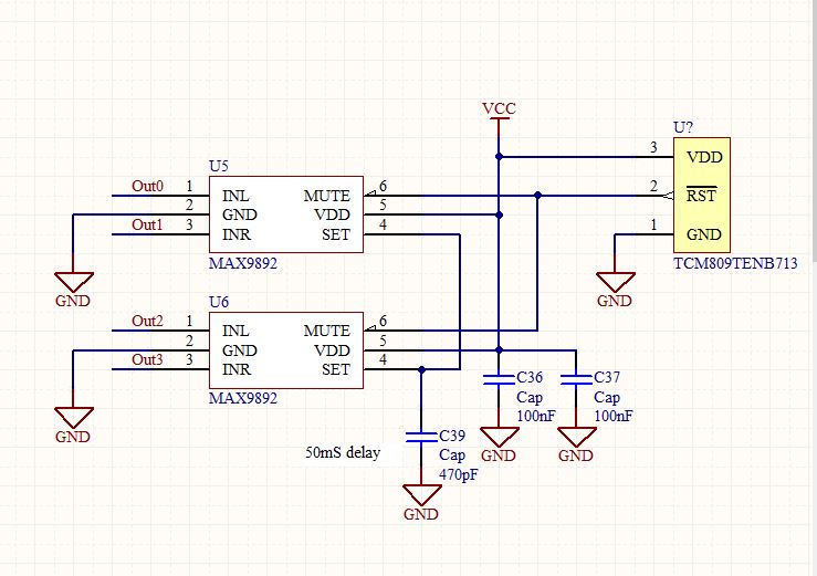

ADAU1701 based DSP for sub or 2 way
Happy New Year 🙂
Starting the new year and decade playing a bit with DSP.
Have bought a Sure DSP and programmer board, and gotten familiar with SigmaStudio.
Time to do my own 😉
Would highly appreciate a review for any mistakes or misunderstandings I might have made, by someone much more experienced in ADAU1701 design than myself.
I can make PCB design available if interested ... when I get that far 😉
Design based on ADAU1701 obviously, and NCS2632 to allow for pop free operation.
The output is enabled by a voltage monitor, TCM809TENB713.
I have included 3 general use pots for control, and 3 LEDs for especially peak indicators.
Output 0 and 1 are additionally run through a 10k log pot, for use with e.g. a sub amplifier directly, or my coming party box a la "Soundboks" :djinn:
There is an extension port which is intended to be used for additional or alternative DAC / Codec. I have not included the I2C signals though, which is otherwise the normal for e.g. FreeDSP ... can't really see the use ... but correct me if I'm wrong on this.
/Baldin

Hi Baldin
Happy New Year to you as well!
Maybe I'm just crossed up by the variable names, but it looks to me like you have the Outx and VOUTx connections to the pots reversed. The PWM outs should probably go to the CW terminal rather than the wiper.
There must be a DC reference for the output buffer/LPF's, U6 and U8; happily the NCS2632's are designed to eliminate the need for coupling caps, both incoming and outgoing, by generating its own -Vss. I still have some studying to do on the data sheets, but a resistor from each Pin 6 to its corresponding PWM out, U4 pins 43 through 46 should probably do it. Trouble is, that will alter the LPF behavior in ways that I'm not smart enough to predict. You may need a separate buffer for the level shifting; happily (again!) the 2632's are only US$0.71 each.(DigiKey)
The input caps, C14 and C16, are larger than I would use -- 2.2 or 4.7uF is usually plenty with an 8k resistor in series. The input protection belongs on the other side of the current-limiting resistor, though. A pair of Schottky's (chosen for relatively low capacitance) to each supply rail is typical; that saves having to account for the usually very high capacitance of MOV's and Varistors.
Your LPF is a Sallen-Key variant -- a practical, hard-working design -- but I haven't seen a 47:15 ratio between frequency-determining elements before. It certainly isn't a Butterworth response -- those are typically a 2.0 or 2.2 ratio. Also, you may want to consider polystyrene or mica or metalized film rather than NPO. The latter is OK temperature-wise, but is on the lossy side for a filter.
If you're really worried about pop suppression, design one detection circuit and send the signal to every IC that you want to control. Each IC having its own resistive divider (and yielding a slightly different threshold) is a troubleshooting nightmare when something goes wrong.
Somebody smarter than me might know a good reason for an Under Voltage protect feature on a 600 ohm line driver, but I can't think of one. Also, a series 75 or 100R is usually enough for output short-circuit protection in such cases. I wouldn't be willing to pay the 6dB gain 'penalty' (that will result with 604R in that position) if a proper 600-ohm-terminated line is driven.

Hi Rick
Thanks for feedback.
You are totally right about the output pot. Have changed it in the new file.
Maybe a bit different labeling would be good … changed to DAC_OUT for the output from the ADAU1701, for clarity 😉
The Sallen Key filter is based on the opamps as unity buffers.
What do you mean by DC reference for U6 and 8?
Input caps for U6 and U8 I think is needed. They are doing the level shifting.
Cap size … yes 47uF is a bit over the top, and 4,7uF would probably be better in many ways .. not least taking less time to char initially, but also requiring less space on PCB. But I would like to keep the Fs quite low especially for the subwoofer use (not having multiple high pass filters on e.g. 10Hz on top of each other).
As for ESD protection, I think I need to research a bit more. Maybe something like this:
[Resolved] INA137: Differential line receiver input protection - Audio forum - Audio - TI E2E support forums
with 100pF direct on input and a TVS diode at the ADAC pins 2 and 4 after the 8k resistors.
The under voltage protection should actually detect the missing power, but it seems like a little double action together with the Enable pin on the NCS2632! Was thinking that you could mayby bust use the UVP function to eliminate pop … but from the data sheet this is not clear.
Also I have been thinking on whether the WB function will work?
In a setup whare you have direct power input to the board from say a wall plug PSU, it will work well … as unplugging the power input will totally remove the 12V and will therefore turn Q1 off and WB will go high immediately.
In a setup where the board is powered from same supply as e.g. the power amp, the input power will not turn instantly.
But you can maybe “tune” this little circuit to change state, when the “12V” input falls below e.g. 7V. Will sim it … will only be a matter of the right value for R2 I think ….
Regarding the 600 ohm on output … you are right …. But in say 10k it is not really a problem. A 100 ohm resistor would require a 20nF cap for same feq … a bit large for a NP0!
As to NP0, Mica or polystyrene …. I thought NP0 is actually the best? ….. but disputed by analog HIFI nerds 😉 …. Maybe I’m wrong ……. Do you have something scientific on this?
Also found that a diode was missing in the 12V input to allow for better detection on power loss.

A unity-gain Sallen-Key is perfectly OK, but with matching resistor values, the damping/frequency response is set by the capacitance ratio -- 47:15 is going to be (probably should've LTSpice'd this before risking foot-in-mouth disease, but I'll leave that to you) very under-damped. Anything higher than about 2.2:1 is rare in audio use.
Without a DC reference (or maybe 'DC path to ground' would be more accurate), an LPF has no incentive to center itself in the available signal range (whether its 0 - 3.3V or +/-3V). If you keep the level-shifting caps, they'll need to have a DC load to the new signal ground. Keep it 10x or so less than the resistor values used in the LPF to avoid disrupting its action. (Another useful simulation project 😉)
** Wait just a gol-darn minute **
Sorry I didn't see this sooner: Consider moving the gain pots to the U6/8 outputs. That solves the interaction issue with the LPF input.

Oopsy doodle! There's still something major I missed/forgot 😱😱 --
On the Sallen-Key LPF's the node between the resistors has to connect to the capacitor whose other leg comes from the op amp output, not ground. The cap whose other leg is ground must have its signal side connected to the node between the +input and the 2nd resistor. The current way looks to me like it'll oscillate.

Not so concerned about the filter ... 3. order at ca. 100kHz
Think the DC path made by changing from buffer/unity to a gain stage x1 adding 2 resistors (one from out to +in and one from +in to gnd).
Having a DC over the pot is not a good idea I think as it will make noise when being operated.
I think you are reading the UPV wrongly. It is no a protection as such but a way to turn the output off.

I'm still reading up on the ADAU1701, but noticed something else I should've noticed sooner:
Changing the output filter from Unity Gain is a good idea -- ADC input full-scale is 2 Vrms (if you change the series resistors to the 18k shown in the 'protos' shown on pages 49, 50 and 51 of Rev.C of the data PDF) while DAC output full-scale is 0.9Vrms -- a 7dB loss.
But the circuit change you described has a typo: The resistive divider HAS to be from Output to the '-', inverting input.
And it gives both 'reward, and penalty' .. The gain can be handy, of course -- 6dB will result if the resistors are equal -- but I don't recommend it! Damping is no longer controlled by the ratio of the capacitors: Higher gain results in lower damping. Before you start ordering parts it might be worth checking out "Equal component value Sallen-Key filters". Sams used to publish "Active Filter Cookbook" by Don Lancaster and I highly recommend it. Mine is over 40 yrs old now and I still refer to it once in a while. It has just enough math that you can accomplish what you want even if you don't have an engineering degree.

Time to get on with this project.
To keep it very simple in this first go, I have decided to give the MAX9892 "Shunt Mode Audio Click-and-Pop Eliminator" a go. Distortion should be very low, so only the very small physical size of the components are a bit scary 😉
Changed regulators to LM317MSTT3, again for simplicity.
A bit unsure whether I have exposed enough pins for further experiments with external DAC like pcm5102a or a full codec. My extension port is called "Expansion1" on the schematics.
Output filters changed for a simple RC network.
Anything missing?
