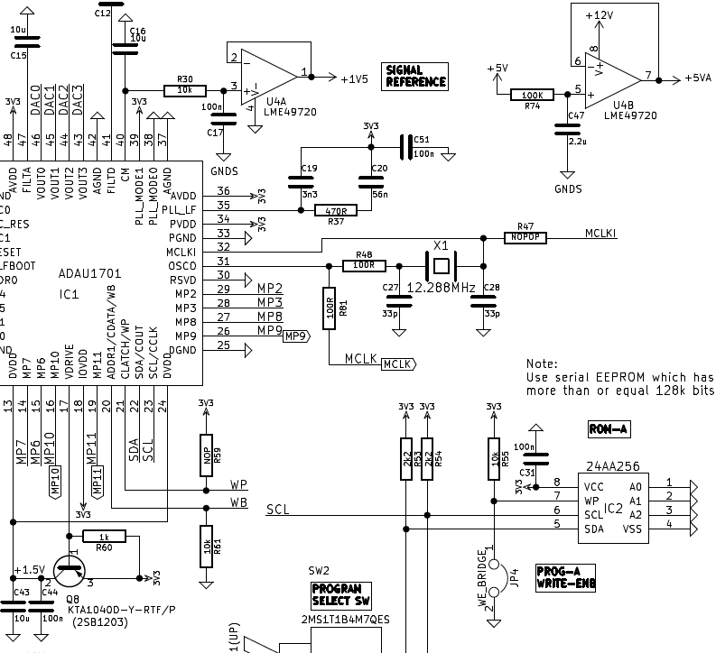

The LM317 resistive divider values need work. You may also want to include the 1N4002's mentioned in the data sheet, esp since you have somewhat larger capacitors.
The inputs and DAC_OUT2 and DAC_OUT3 need a large value resistor to ground -- otherwise the MUSE caps will have no incentive to charge. Also, polarized electrolytics would be fine in this use (at least as OK as any electrolytic) since you have a consistent polarizing voltage.

- the MMBT5401 is a relatively high voltage type - it may not have the specified hFE 100 at such a low Vce; it would probably worth the extra cost of a Zetex part since the 1.5V Vce can challenge even 40 and 60V parts - and it would be an awful waste of half a weekend if the 1.8V was flopping around in some code-execution-dependent manner
- consider 74LVC1G04 or -14's to drive the LED's - naked outputs only provide 2 mA
- a 10nF or so cap to filter each 10k pot wiper might be good, and
--- full scale for that ADC is 3.0V -- a 750 ohm or 1k in series to the 3.3V would keep the top 1/8 or so of the rotation from being wasted (that is 'giving no control change')
- I think your WB circuit will be too slow - another good job for an 74LVC1G14, maybe with a 3k3 pull-down on its input, then 680 ohm and 8V zener to the collector of a PN/MMBT2907 whose base-emitter junction replaces D1
- most microcontrollers hate slow reset signals - consider buffering (LVC1G14 ?); I haven't found anything in the data PDF about this one tolerating a 100 microsecond time constant; also, you may want to include a push-button so you can force a reset without removing power

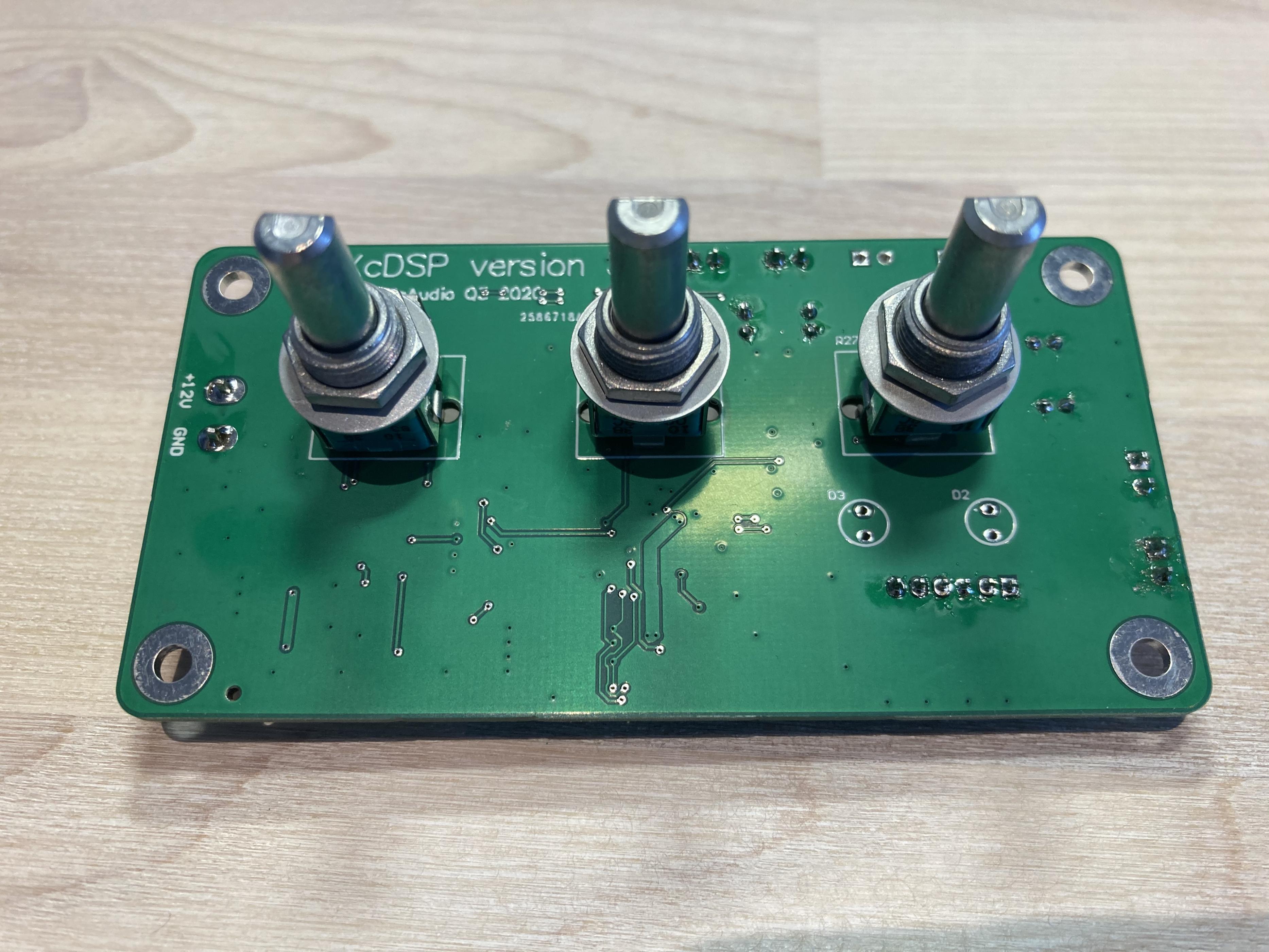

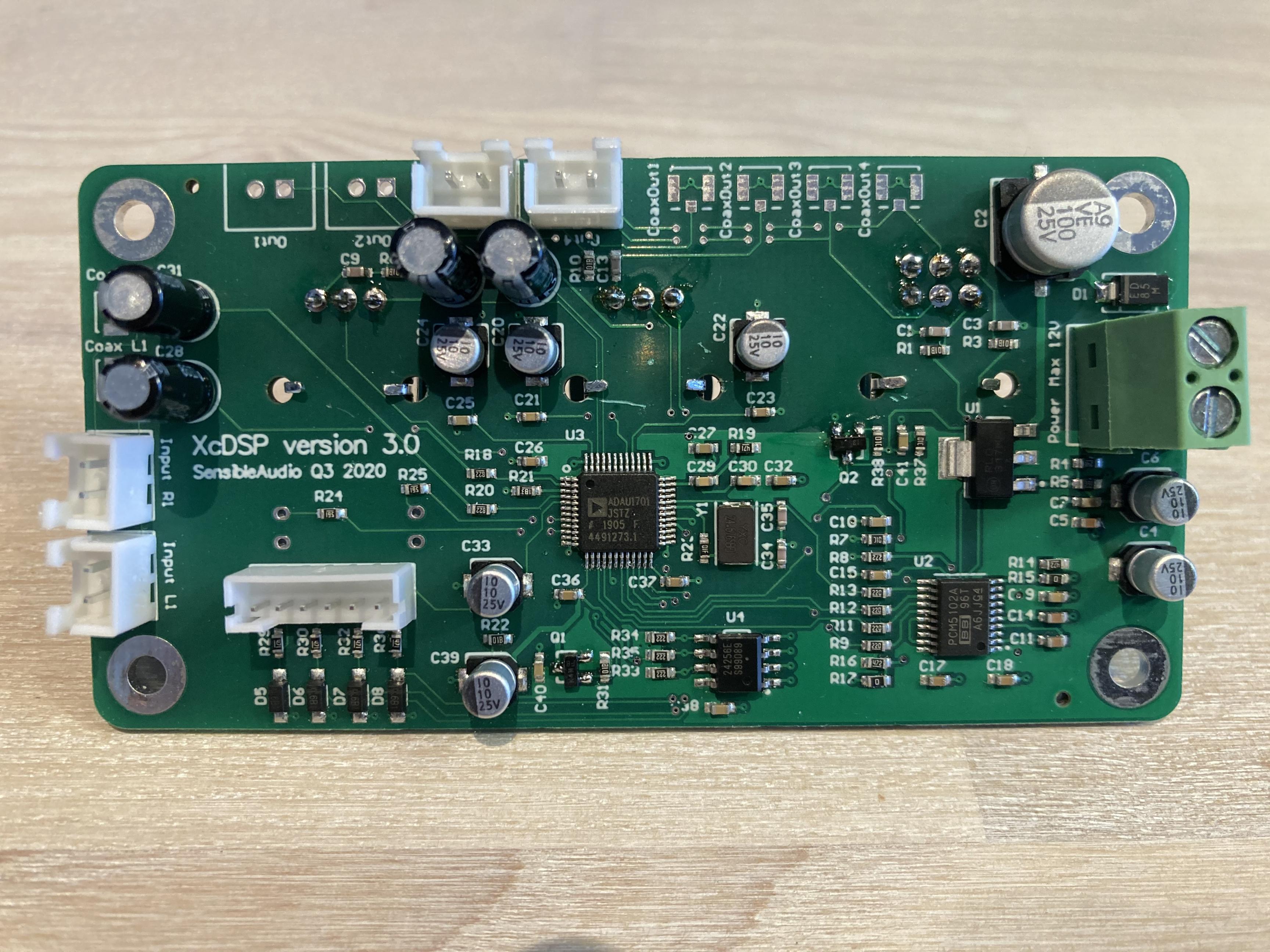

Have progressed somewhat with my first ADAU1701 board.
Have gotten the PCB made and populated at JLCPCB, at least for most of the SMD components.
I opted to go for a PCM5102 as DAC to make sure I have some pop free outputs.
See PDF for details.
Have mounted rest of the components, and tried to power up, but I only get 1V DC at the output of the LM317 ?!?!?!?
Scratching my head. What can be wrong?
I have 16 V dc in, so more than enough for the regulator to work.
Over current protection on the LM317 due to fault somewhere else??
Have tried to change the LM317 to see if this was what was wrong.
Have checked the resistors .. correct values.
I know it is no conclusion to anything, but measured the resistance from GND to +3V3 and this is 25 ohm.
I have two boards made from JLCPCB, and they measure the same resistance.
Also measured this resistance while I had the LM317 not mounted, and it's the same. ..... not sure what I would expect to see though!
See pdf for details
In your schematic, aren't the PLL mode pins set up for 384 x Fs? That would require an 18.432MHz crystal for the "conventional" 48K sampling rate.
ooops--nevermind. Looks like that got changed in a later version of the schematic.
Good points Cyberpit and Niel Davis. Thanks.
See Schematics in post #23
PLL_Mode_0 = 1
PLL_Mode_1 = 0
=> 384 x fs
Xtal = 24.576MHz => fs = 60 kHz ....... that is going to be a bit unconventional ... but I guess it will still work ok.
Changing to 12.288 MHz would give 32 kHz ... more conventional 😉 .... But I do not have a Xtal that will fit, so will have to try it out.

The MCLKI for the '5102 should come from the OSCO side of R23 -- it can not come from the return side of the crystal.
You may need to cut the trace from C35 to R13 at both ends, to eliminate the stray capacitance (ground plane on the other side, for starters) and EMI pickup. Then fit a jumper from R13 to the pin 31-side of R23; or install a buffer as recommended in the '1701 PDF -- maybe a 74LVC1G04 or -G14.
Oh, and, if you do re-do the board, you could eliminate 4 feed-throughs in the mute line: Swap R8 / C15 and bump them and R7, C10 half a space farther away from R13. Both Mute and Clk can come in around the 'south' side of the oscillator section.
The row of 22R resistors belong closer to the outputs driving them. Their job is softening the edges a bit, giving less bounce at the receiver.
R7 trying to pull Mute up to 12V is probably not a good idea, either. Besides forward-biasing substrate diodes, the Mute signal will still be well above its threshold (somewhere between 3,3V and ground) when the regulator drops out of regulation.
It may also be necessary to remove the ground plane under the oscillator traces, or possibly just reduce the 22pF's.

Year, think it is highly unlikely the the ADAU1701 has survived the pin swap.
Ok also seem I have been way to fast with this design 😉 ...... and a total newbie in this field on top 🙂
Well, we are here to learn and have fun.
I'll work some more at it today. Think I need to make a new PCB ... too many mistakes to be sorted starting with the Xtal. I actually found another Xtal on 12.288 MHz, but is has a different pad layout, and will not be easy to mount. ... need to get myself a microscope 😉
Also as I see it I would need to change PLL_Mode1 to 3V3 and PLL_Moce0 to GND, to obtain a fsx256 giving a sample rate of 48 kHz. For any design soon I do not need 192 kHz and 48 kHz will be just fine.
