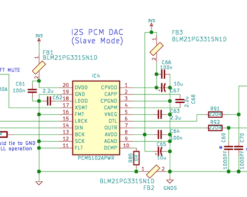

Hi Baldin-San,

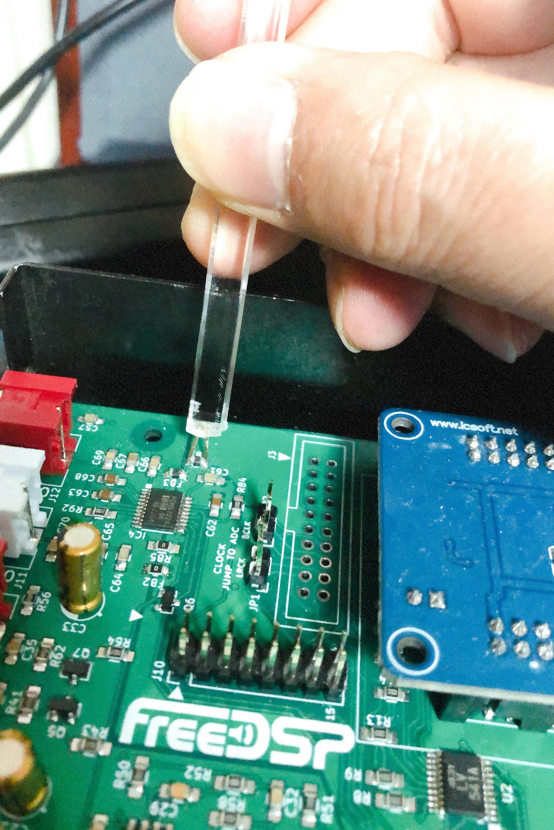

About Bead:
I checked with bypassing Beads FB1/FB2/FB3.
I can hear increasing remain noise in high-frequency range when I shorting the FB1/FB3. ( Please refer the attached picture)
I could not heard the difference when I shorting the FB2.
The difference is too small to show in the numerical difference with my measuring equipment. (Except ears 😀)
About New Schematic:
If you want to add solid-state muting to your ADAU1701 embedded DAC outputs, you can use PCM5102A pin5 for the negative bias voltage source for releasing muting transistors.
The other part comment was covered with Rick-San's comments.

Thanks CyperPit,
Ok think I'll make room for a few beads 😉 .... the cost is almost nothing 🙂
... why did you not include a bead for AVDD?
Good idea to use pin5 as negative bias for muting transistors .... will maybe come back to this. On the other hand for now I'm only planning to use the 2 outputs from PCM5102 .... but in a next design ...

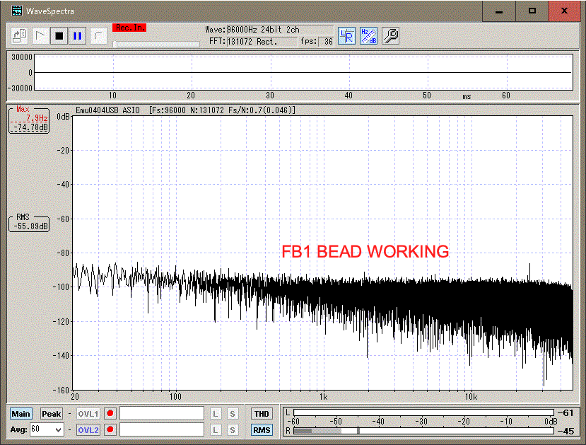

Hi Baldin-San,
I checked to know the beads insertion difference around PCM5102A.
The difference was FB1 > FB2 >> FB3(very small)
Attached animation GIF shows bypassing FB1 or FB1 Working in my FreeDSP Classic SMD A/B plus II board (40dB Boosted to see the remain noise)

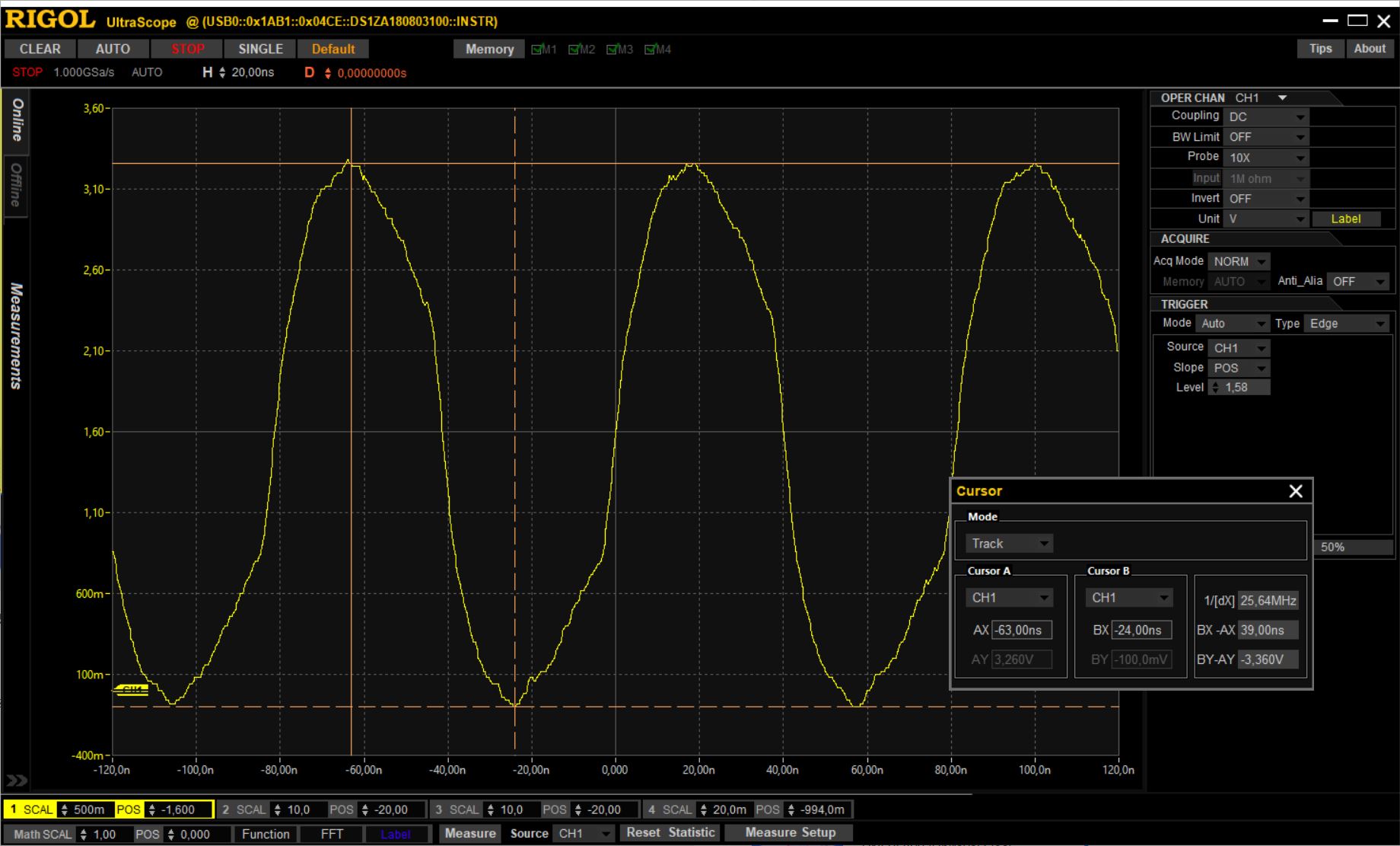

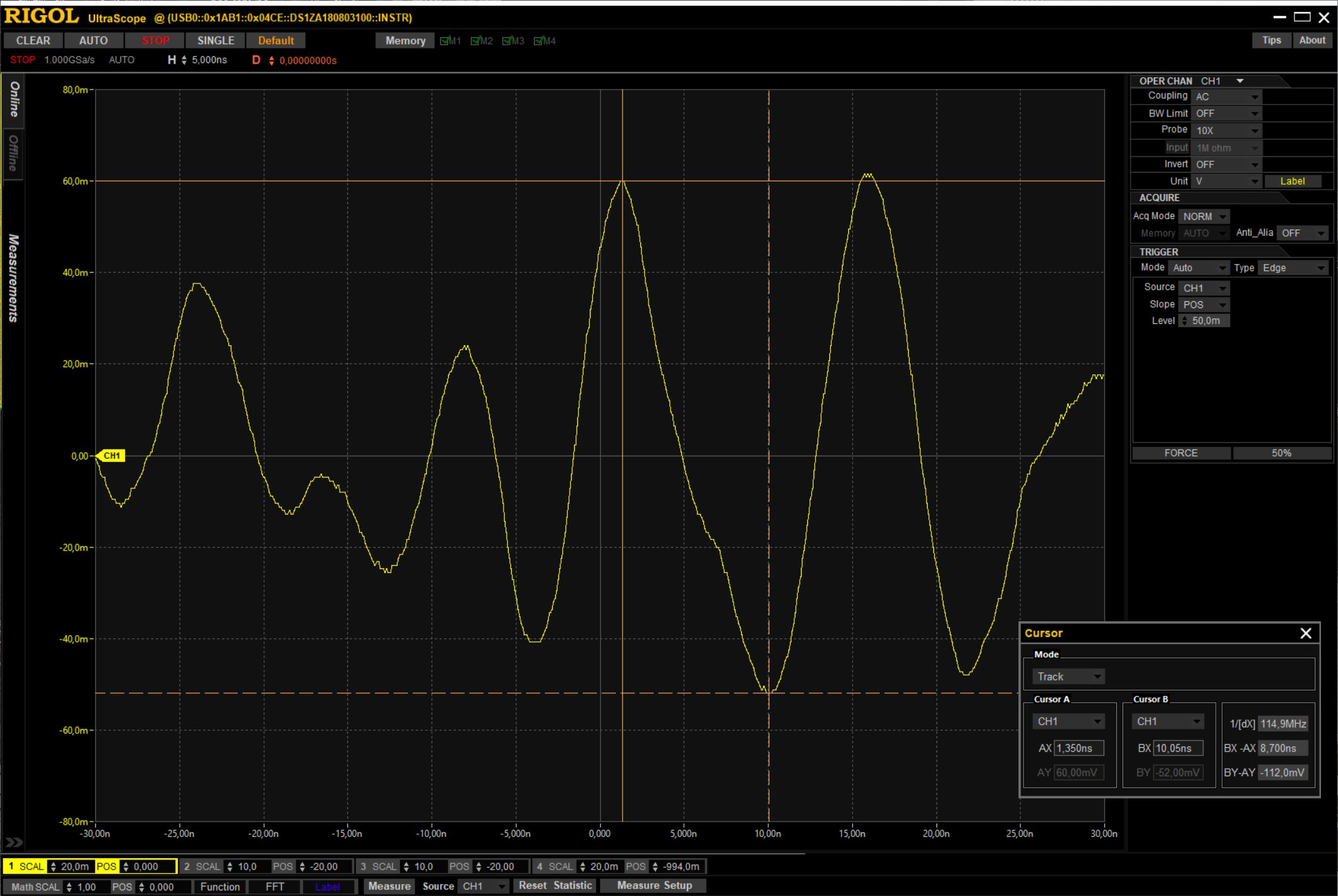

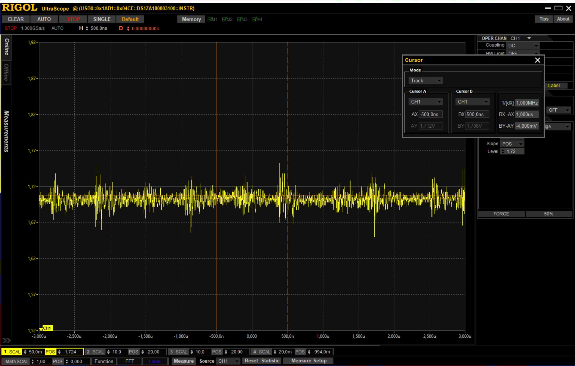

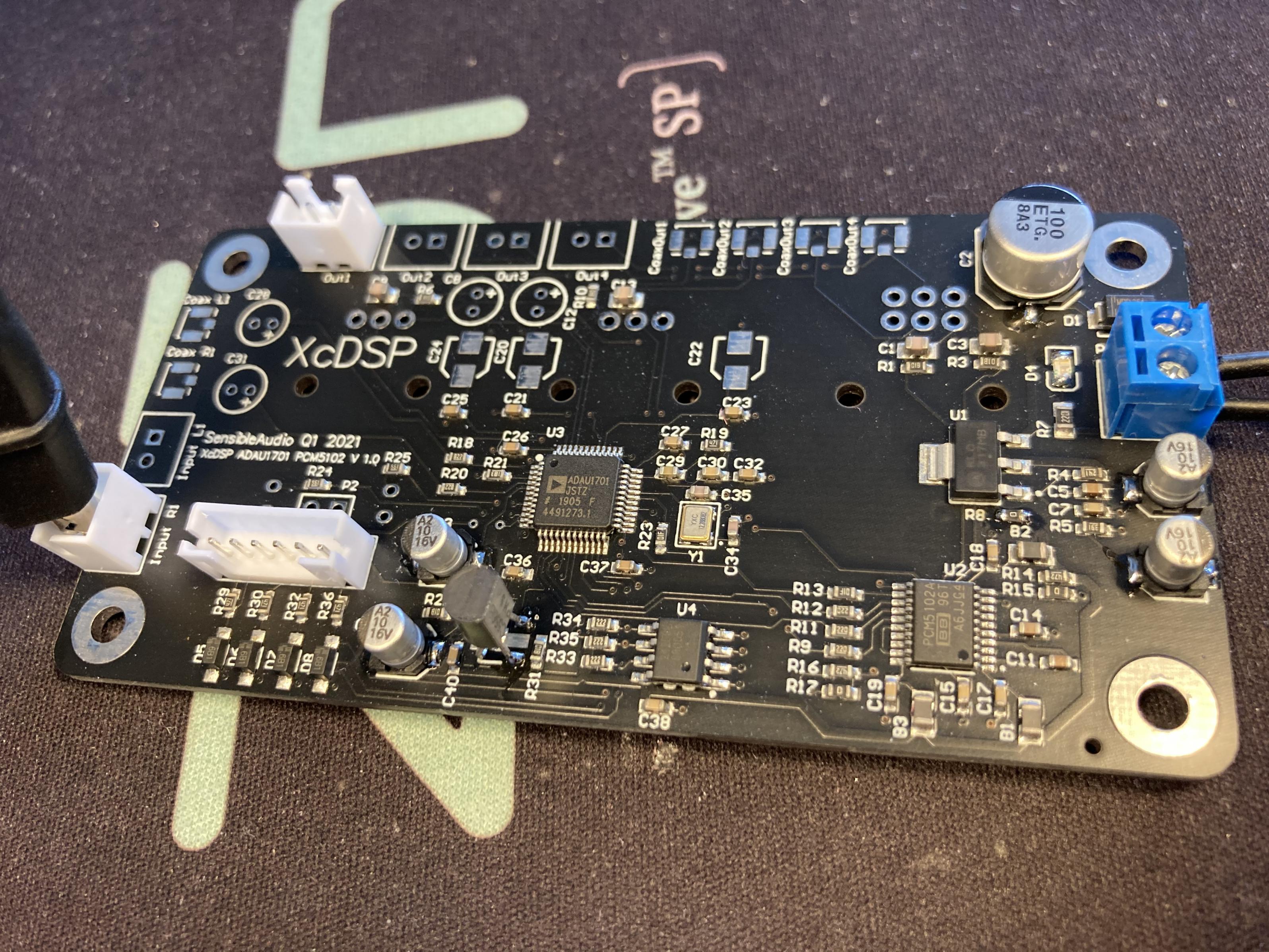

New PCB first trial ....
Got the PCB back from manufactory.
Somehow had forgotten to get the transistor for DVDD mounted, so had to use a BC556B (with a bit of leb bending) in stead.
The line reg gives the 3.3V as it should, but I only measure 0.1V at DVDD!
The OSC out does no really give any meaning full ... see picture.
The 3.3V regulator gets a bit hot, so some current is for sure running (also 16V in, so quite a drop).
Hmmm what to try next?
