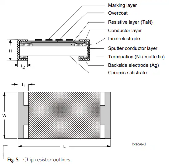

But those (PNM, PTN) are thin film smds not tantalums
I doupt that I'd hear much difference changing that kind of quality resistors (RN60s) in a reg. Hope it made sense to your ears, curious about what change they brought. At least they are cheap.
Vishay seems to be rather cryptic but the graph of Yageo's ones shows that it's the actual resistive layer. Was expecting something like Audio Note's tants which cost an arm and a leg. The good thing is their Temp Co is very low, 25ppm and below. Still, for psu, RNs 50/100 ppm is good enough for me, it wouldn't accure to me to make a comparison but apparently there are some inquisitive souls out there and is proven to be one of them :trapper:

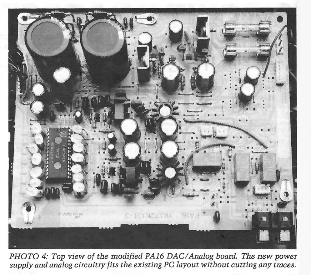

In support of that, here's a photo from 32 years ago from Audio Amateur(2/92) when Gary Galo, Walt Jung and Hampton Childress modified a Philips DAC960, naturally with an AD811 🙂 .
