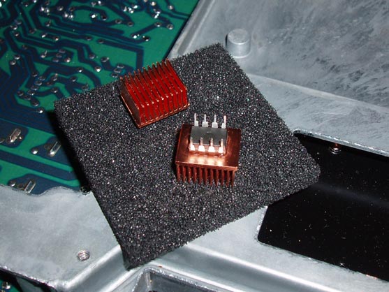

It is hard to obtain - unused. In equipment they used without any heatsink, so they are "exausted by high temperature".

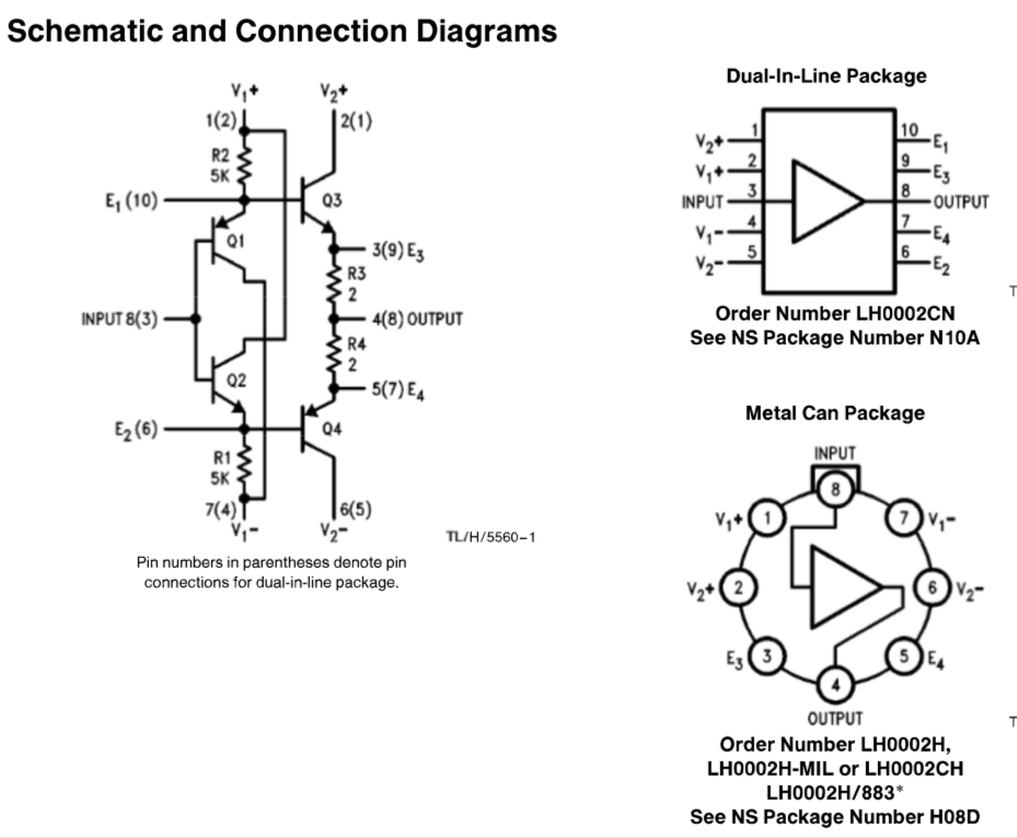

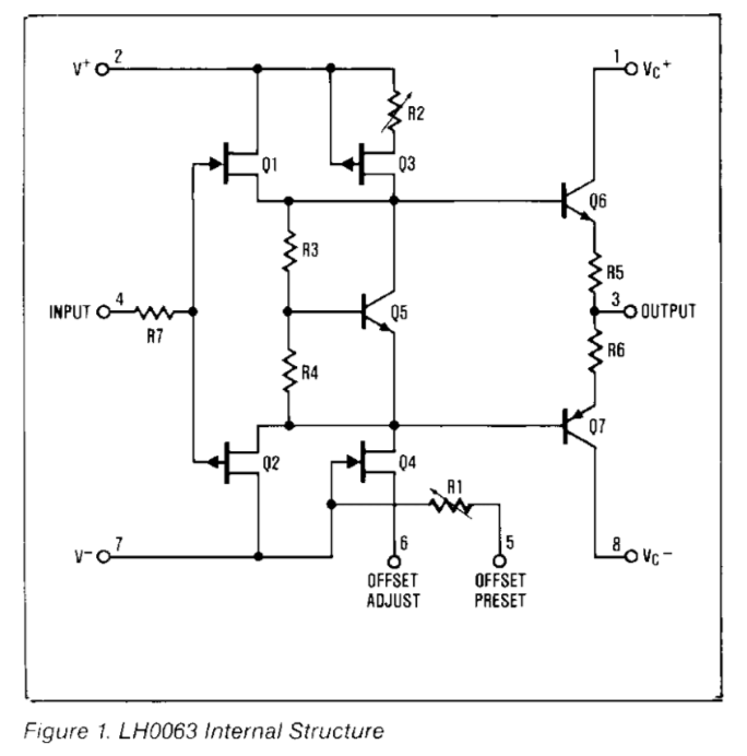

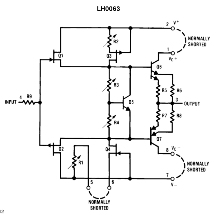

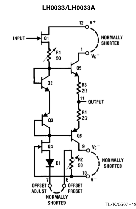

Take a look at the LH0002 or LH0063 inside configuration. They are high speed, high current and CFA topology input stages. And open structure to configure on different ways via separated pins.
But also maybe a harder than AD811 to obtain.
Actually I took the peak now on ebay and they are (not Chinese) around LH0002 is 20usd piece, LH0063 40usd. National and Calogic.

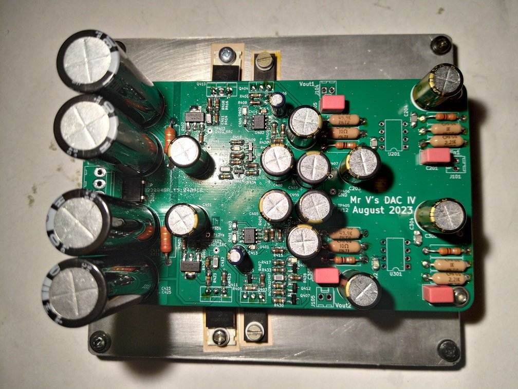

Is anyone having a couple of spare PCBs as per Grunf's maybe?
I'd like to get there in the coming new year to this AD811 balanced IV stage, I'll need to move to a fully balanced preamp first.. and planning it will take place of my dddac 1794 tube output stage as I cannot squeeze the tube stage in the dddac case (well probably I could but it is not currently balanced..).

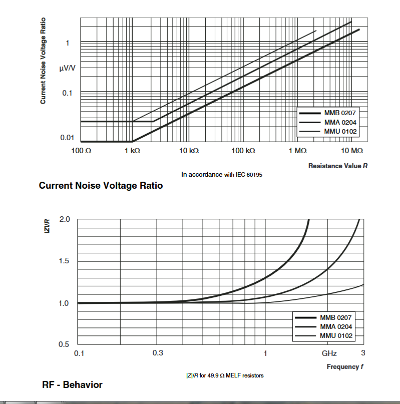

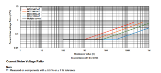

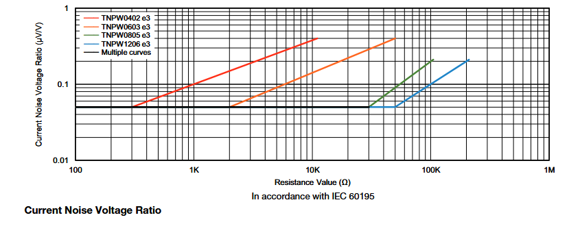

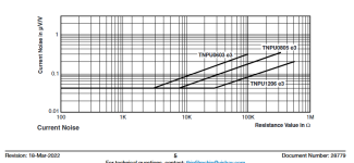

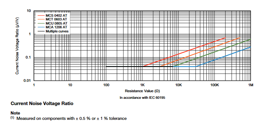

This is for those who think MELF resistors are crap. The graphs are from Vishay DSs, classic thin film flat chip resistors. They all have higher noise than regular Vishay MELF.

And there is a heatsink for DIP8 too. Has to be bigger than standard. Probably custom made.
Are you thinking of Vunce's PCB?
We are on the same path, and I also plan to put my PCM1794 into operation this year. The PCB with the PCM1794 will be mine so I can place small shunt regulators right next to them. I'm just still thinking whether to put the four AD811s on the same PCB or separately so I can do tests.

We know about all this, Vunce made the PCB and BOM for the order from Mouser.
Now we need to find someone willing to make a new PCB that will include minor improvements to Walt's regulators and replace the RN60 with the PTN or PNM series.

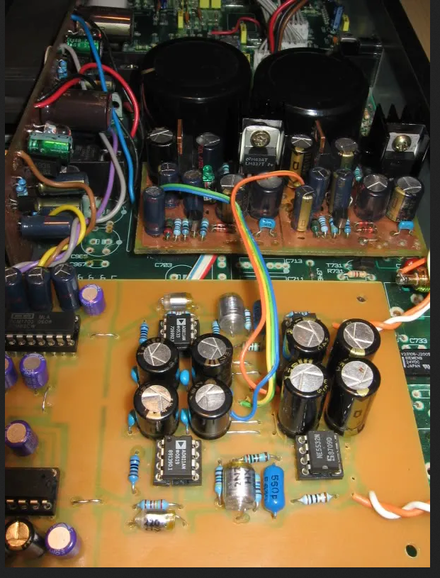

I have the original article from Audio Amateur 2/92 when Gary Galo, Walt Jung and Hampton Childress modified the Philips DAC 960, Walt recently sent it to me, very good reading. As part of that article there was also a short review with measurements from Walt Jung on the AD811 itself and its application with the TDA1541. That short article led me to the AD811 a long time ago and for this today I have Walt's full support so there is no lack of knowledge.
