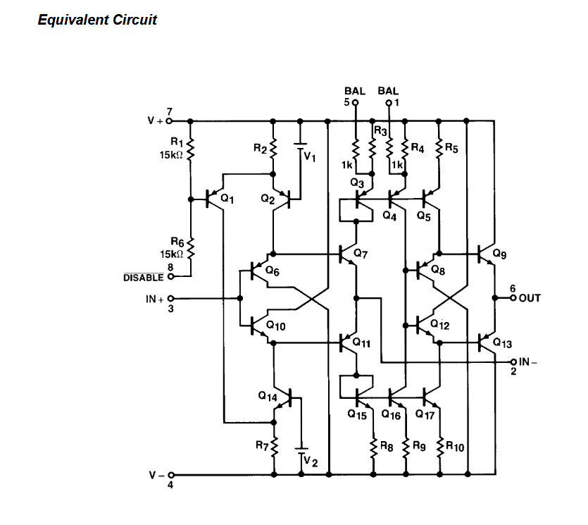

Maybe some discrete design as CFA?
Simplified schematic is in EL2020 datasheet.
Also different (but same concept) are present in other Application notes...
(I also tried EL2020 OP as IV was maybe a bit better than AD811?)
You mean this scheme?

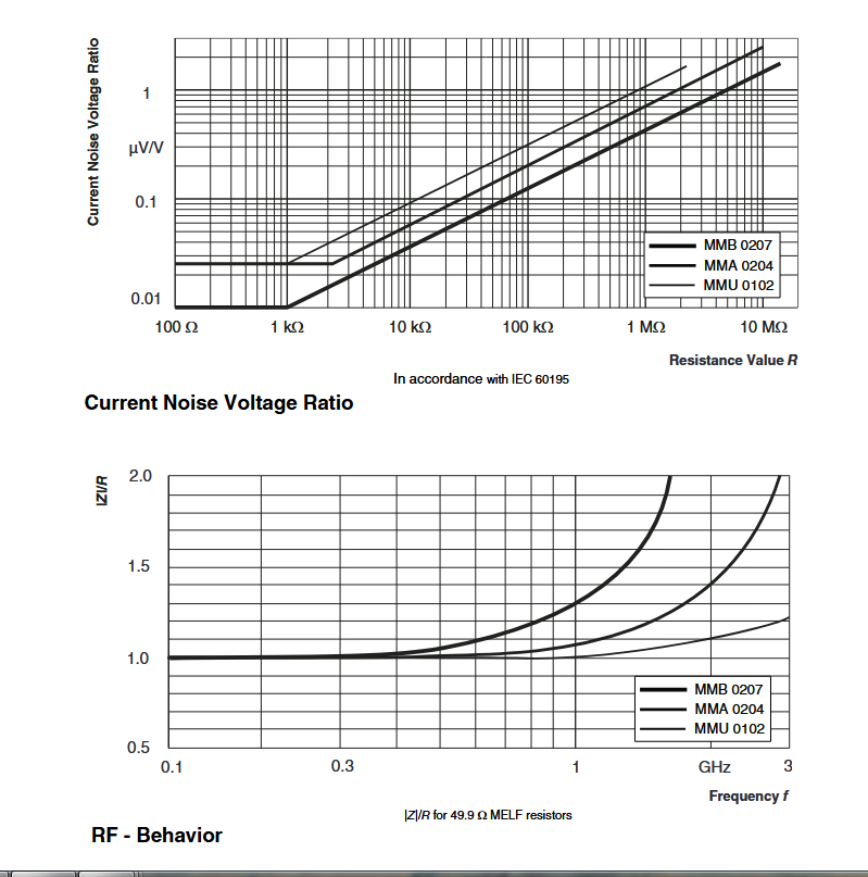

I don't believe that the reason SMD is better is because of lower parasitics, I have replaced a lot more SMD than TH resistors. Vishay MELF are usually good in the RF range, better than RN60 for sure. Another thing that makes MELF better than classic SMD resistors is lower noise. And regardless of all that, tantalum resistor is still better than MELF. Certainly, non-inductance is also a factor, but not as much as the choice of materials and technology.This is an interesting topic i encourage you to make a thread so it gets the attention and doesnt get buried here, and it obviously applies much wider than just our brave little AD811. Those TaN resistors are very good. I experimented with buying Manganin wire and winding my own resistors (ayrton-perry) exactly for I/V and critical positions. But they just ended up bulkier and thus less practical than i'd like.

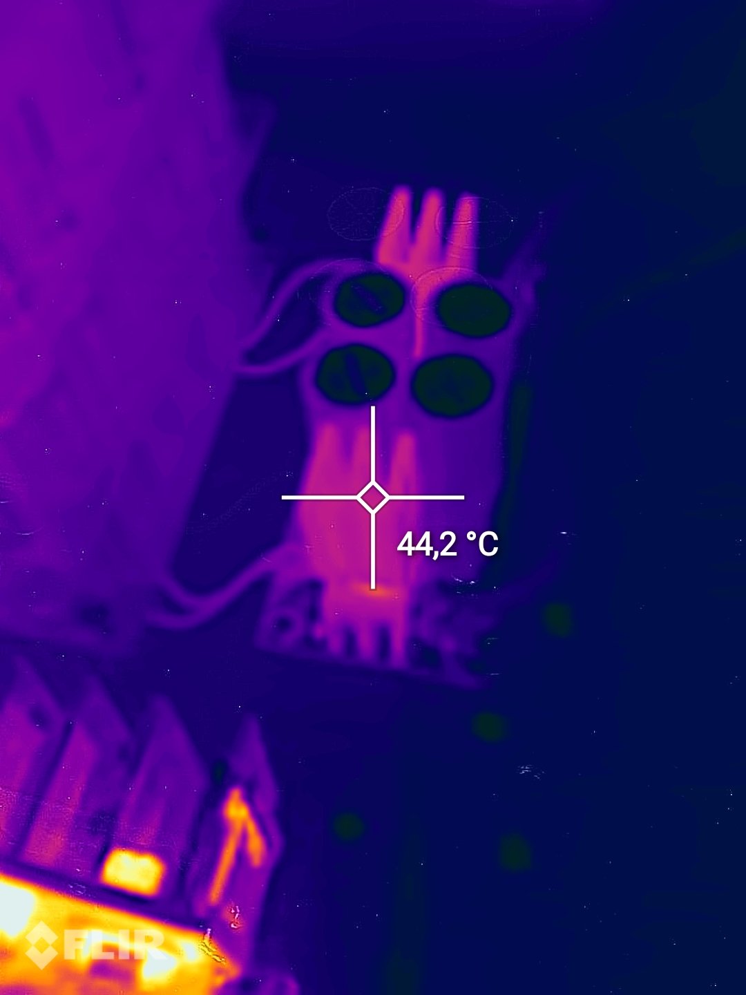

Now I've taken another thermal image of the AD811 with small BGA heatsinks, the temp doesn't exceed 44C, which isn't really overheating at +/-15V.
I wouldn't exactly say that the AD811 has a 'harsh' sound, quite the opposite as Vunce says, not even with the TDA1541 on which I also tested it about 15 years ago. If it had been 'harsh' then, I certainly wouldn't use it today or even try it again .
