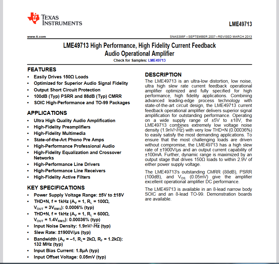

As for the LME49713, it was not considered for testing because it is obsolete (although it can be obtained in Rochester) and because of the higher input impedance compared to the AD811.
Otherwise I have no doubt that both op amps sound good.

The main difference between them is that the LME49713 is made for audio AD811 for video signals. That's why it's no wonder that the LME will have better characteristics in the audio range, but regardless of that, it still has a lot more noise than the AD811 if you read the DSs carefully. In the case of DACs with low current output, this could also have an impact. According to my measurements, the AD811 has much lower noise than the AD4625 at the same position in the I/V conversion with all the same passive components, even with a 1k RN60 at the inverting input.58 Z VS 14 Z ... we are low enough, And you have better specs on CMR and PSRR, better input noise and a very good Intermodulation distorsion, as well as that metal can good for thermal cooling as a CFB and shielding !
If you read 'smedegaard 4217 aes pp' you know that the input impedance is the most important in I/V conversion, so the difference of almost 5 times higher input impedance is not insignificant.

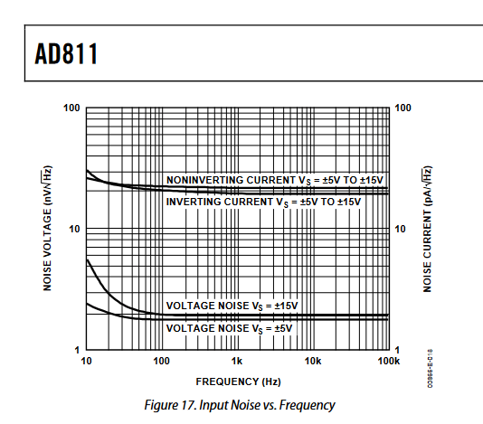

The 811 noise numbers look much better than the 49713. Please tell me more about the input z. I am not clear on which part is said to be better and why. Thanks!
@diyiggy D1 is a balanced I/V, it needs two DAC chips (and two IRF510) per channel for optimal operation.

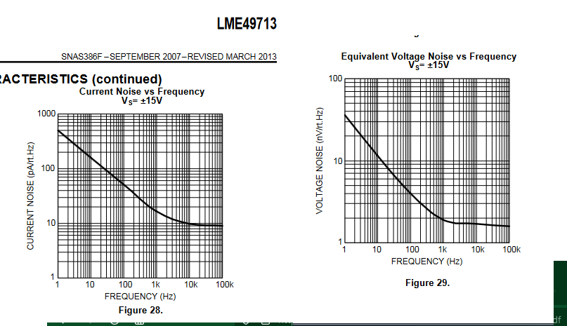

@audiosteve The input z of a CFB amp into pin2 (-ve input) is that of a common-base stage BJT. So its typically in the region of 10's of ohms (depends on bias) and doesn't depend on loop feedback for this.
@grunf The notion that LME49713 is 'made for audio' is extreme irony, given the high noise corners in both voltage and current noise. Just from looking at those two plots I would have guessed 'made for RF' if I hadn't any other information. Whereas AD811 while being 'made for RF' is rather good in noise corner terms for audio.

Well, that's what it says in DS, it's not extreme irony it's the truth 🙂 .@grunf The notion that LME49713 is 'made for audio' is extreme irony, given the high noise corners in both voltage and current noise. Just from looking at those two plots I would have guessed 'made for RF' if I hadn't any other information. Whereas AD811 while being 'made for RF' is rather good in noise corner terms for audio.
Honestly, I took a closer look at the DS yesterday for the first time and I was also shocked when I saw the noise corners. TI probably went with the intention that the LME49713 works as a buffer, some kind of line stage with low gain or something similar where it will not work with high gain and small signals.
