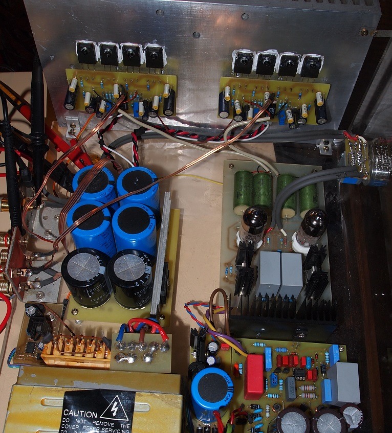

Well, honestly, I have not yet found a tube amplifier with which I would be satisfied and I listen everything from classic and jazz to techno. But, that's why I made a hybrid amp without NFB that used a 6S4P as a voltage amplifier and laterals in the output, I was satisfied with it because I canceled out the shortcomings of the transformer in the output.I guess this means you don't like tube amps either !
Soon I will start making something similar but this time with ECC88(PCC88) due to better availability and distribution so that anyone can assemble that amplifier.
I use PCC88s in my R2R DAC buffer between dac & transformers. They measured better than ECC88s and work fine on 12.6v. DC.

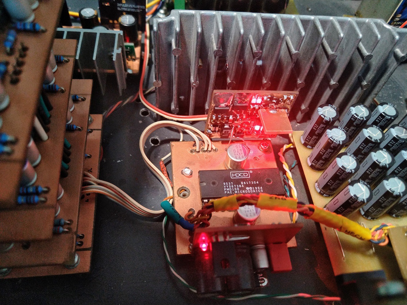

Grunf,Today I finished the prototype PCB for IV with AD811 but this time everything with SMD components except four 100uF/50v ukz and two AD811 with heatsinks.
For the first time I used DALE PNM non-magnetic series instead of RN60, and instead of polystyrene and polypropylene TH capacitors I used non-magnetic SMD COG capacitors. AD811 is soldered direct on the PCB.
So far I can say that in this application the PNM is much better than the RN60.

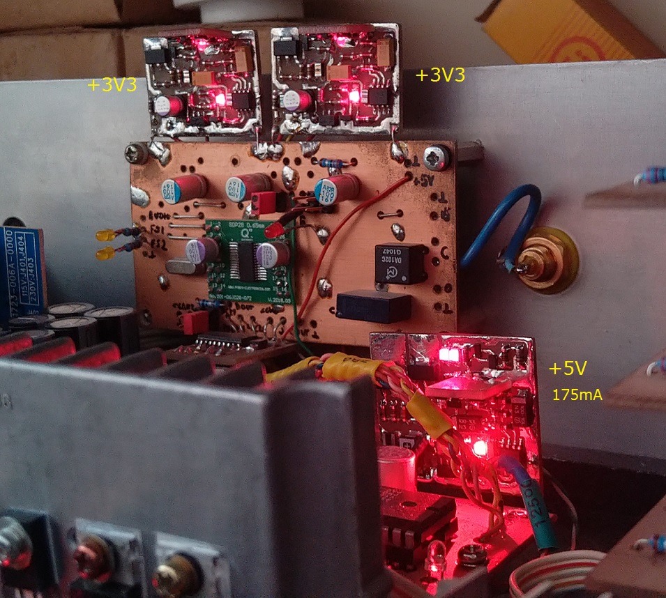

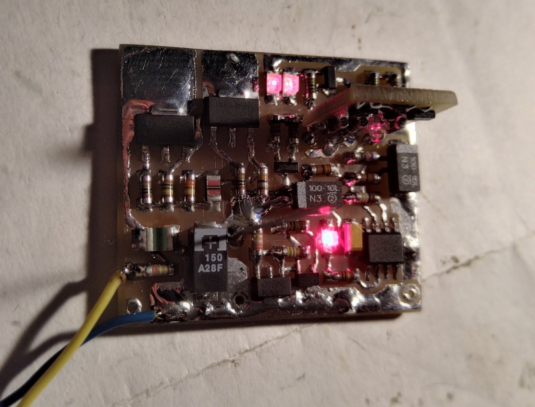

Today the DAC got a new regulator, it is again Walt Jung UnivReg_122714 but an improved version and the first complete SMD version. Op amp in reg is ADA4625-1 and output voltage is 5V/120mA to pin22(output interface) on PMD100 . It is interesting that in the DAC, the regulators themselves contain four ADA4625-1 and four ADA4897, the voltage range is from 3.3V to 14V(negative and positive).
But more importantly, DALE PNM non-magnetic are a perfect match for AD811 and I recommend them for this I/V stage. Unfortunately, the problem is poor availability, as @Vunce says, but the values 1K, 50K and 33R, all 1206 are available and just what I need for my setup. The problem arises with a different DAC current when the feedback needs to be adjusted. There is also a PTN version that is not non-magnetic and Mouser has a few more choices above 1K.
It's been more than two weeks since the new regulator was installed. At first, the sound was a little weak in the bass, but now it's a completely different story. Unfortunately, tanatals that work at 1V in the regulator take a long time to play properly, I had a similar experience with 3.3V shunt regulators. In general, they need more time than standard electrolytes in this position. As far as I can see, UKZ is no longer available for purchase at Mouser, so these tantalums are a great choice instead. The sound of the DAC itself is now on a new level and this again gave me new guidelines when making my new DAC with PCM1794A.
I have to thank Walt Jung for these regulators and 1V references and I have to admit that this is the best regulator I've tried so far for digital in a DACs, incomparably better than the LT3042, ADM7150 and other regulators on the market, whether discrete or integrated.
