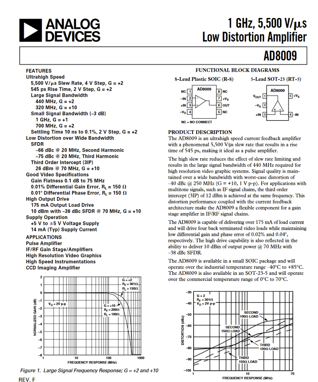

What about AD8009?
Higher current, higher slew rate, higher bandwidth and some other pretty impressive specs (for ex. bandwith still higher with gain of 10 than what AD811 can even do with gain of 2), both are current feedback.
SOIC-8 but can be easily adapted to DIP8 with adapter (though probably not achieving 1ghz anymore, though that is just overkill for audio use anyway) or soldered on.
I mean if we're taking AD811 for I/V, might as well bring it to its logical conclusion?

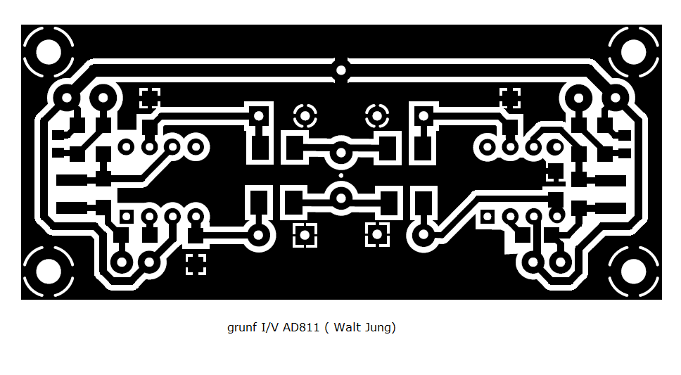

Sim says it can but will have to try, not sure how elaborate the included ltspice model is but i wouldn't be surprised if you can drop it in. For AD811 values for the "compensation resistor" and output resistor we are using make it pretty stable all things considered, on well implemented board should be fine but dont take it for granted (i am working on one right now). Stability also depends on your load capacitance and other things. You can raise the 10ohm output resistor to 50-100 if you have a highly capacive load. Also remember, +-6V max for this one.
Also here is some light reading from W. Jung himself on the topic.

What about AD8009?

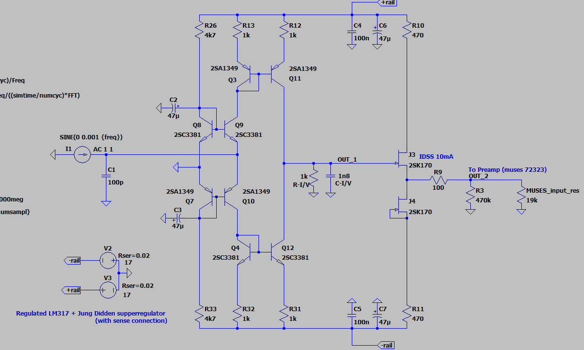

Last weekend I made some small changes. Outputs are now 2SA1209/2SC2911 with slightly changed operating points. The current through each IV stage is now +/-40mA.
And the sound? Excellent considering that it has only 6 transistors that still work at slightly higher currents. Much much better than the first version. I hope that there will be further progress, however now comes the more difficult task which is to find output transistors(low cob, high ft, with good hfe) that are easily available at Mouser.
Hi Grunf, I was playing with the Toshiyuki Beppu topology as well. Experienced some difficulties to achieve the needed gain and the negative feedback was a minus point.
As I also rejected the Pedja Rogic diamond buffer IV stage (after multiple proto builds) due to thermal issues and highly accurate NPN and PNP matching, I simulated quickly below circuit. Bias currents are rock solid and idem to simulation.
Now listening to it!
If this was not flying, my next step was the AD811.

I'm not really satisfied with Toshiyuki Beppu either, but I didn't have any problems, the maximum output voltage I got was around 6Vp-p. The sound depends a lot on the output transistors and the current through them. I'm thinking of improving it, but I'm not sure that with some discrete - simple I/V stage I'll reach the quality of the AD811.
