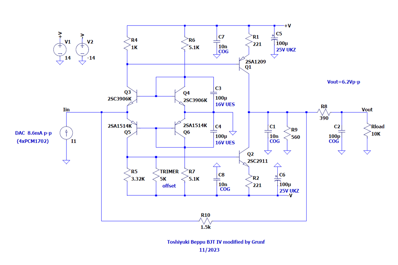

It works! 😀
Reactions: krca45
So far, I have listened to a couple of CDs and it doesn't sound bad, quite deep bass with a lot of detail in the highs, nothing blurry, quite correct. The output voltage is 6.2Vp-p on a 10k load.
I still need to play a little with the operating points and the selection of transistors to see what this simple IV can do. This BJT IV is not yet close to the AD811 but who says it can't be so it will stay in my DAC for a while, at least until I make all the modifications.
Otherwise, I would recommend this BJT IV stage to anyone who doesn't want to invest in expensive op amps, tubes and transformers, it is capable of directly driving the output stage and it is sound correct and neutral.
I am currently thinking about a completely new DAC with two PCM1794 and four AD811 for IV. I don't think that the AD811 will stay in that DAC forever, because I intend to go for a completely discrete IV (current conveyor) but much more complicated than what I presented today.
The show always goes on 😉

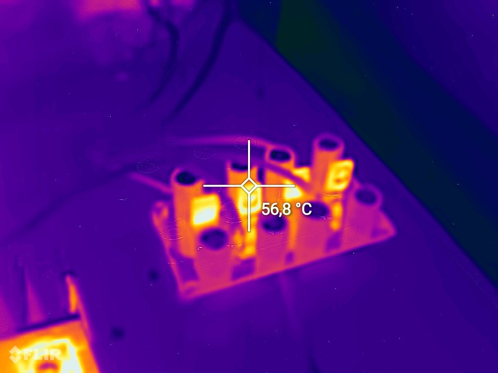

Temperature of output transistors.

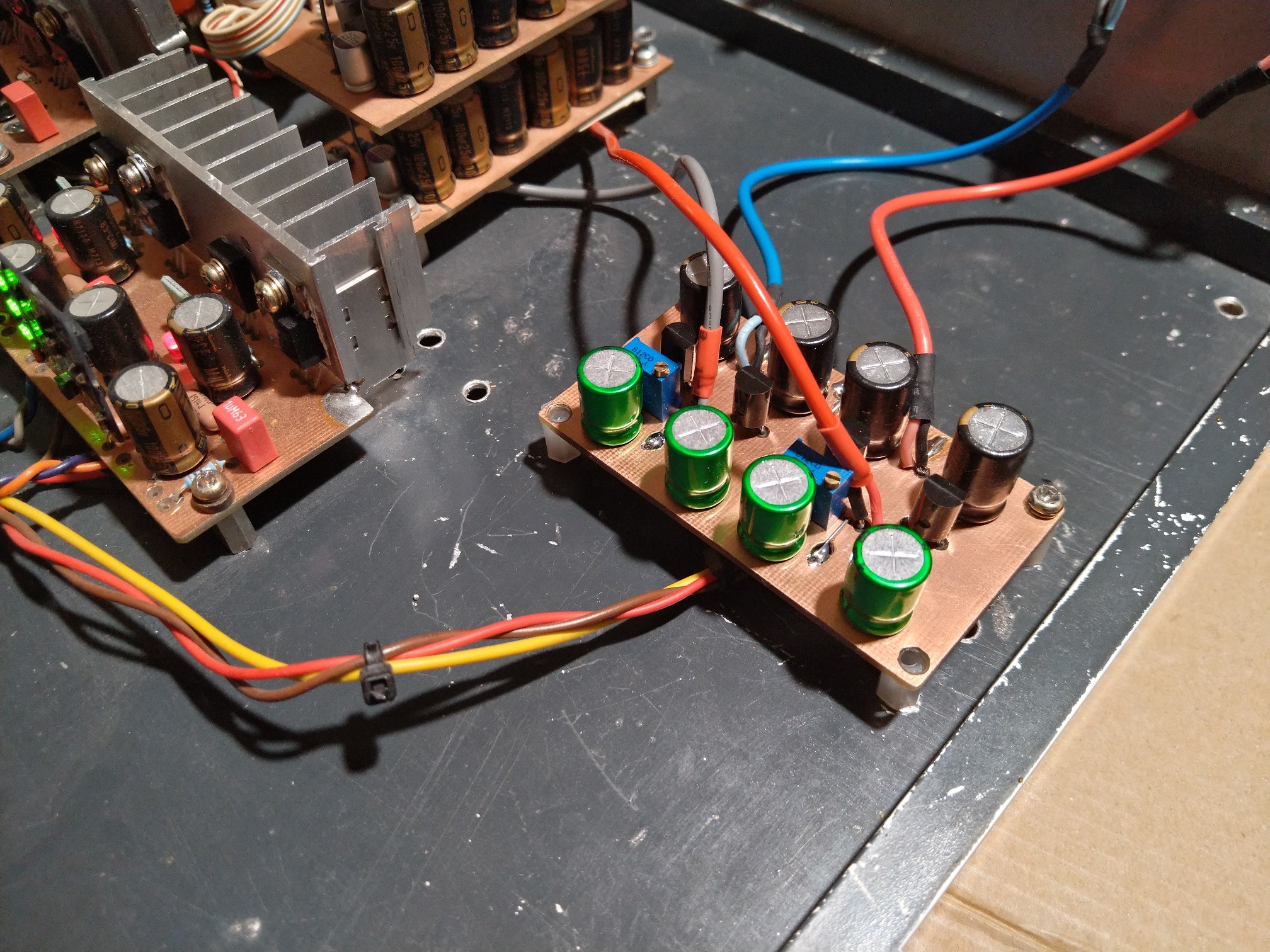

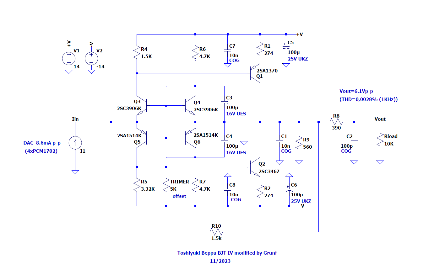

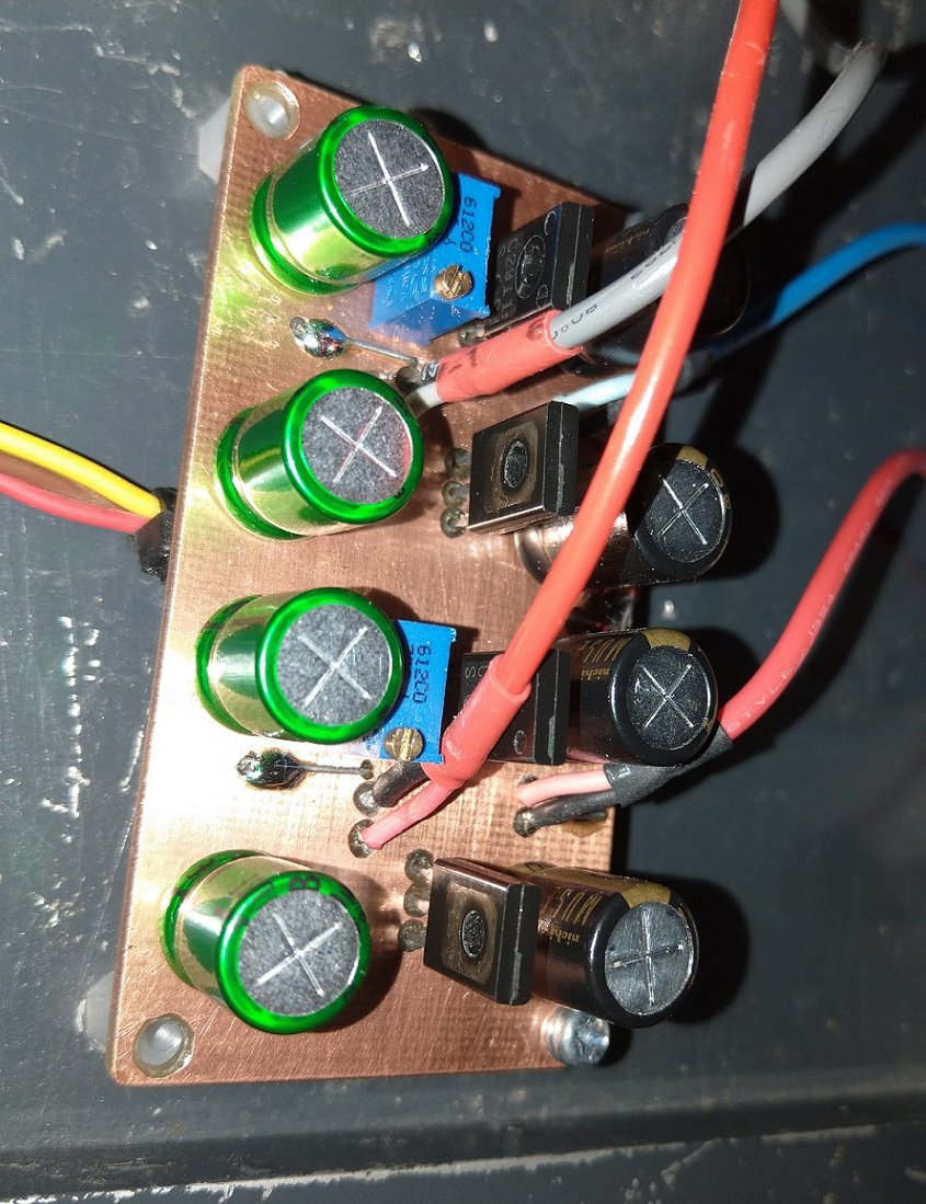

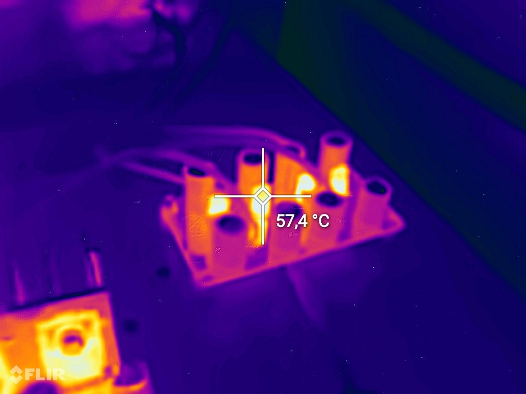

Last weekend I made some small changes. Outputs are now 2SA1209/2SC2911 with slightly changed operating points. The current through each IV stage is now +/-40mA.
And the sound? Excellent considering that it has only 6 transistors that still work at slightly higher currents. Much much better than the first version. I hope that there will be further progress, however now comes the more difficult task which is to find output transistors(low cob, high ft, with good hfe) that are easily available at Mouser.
