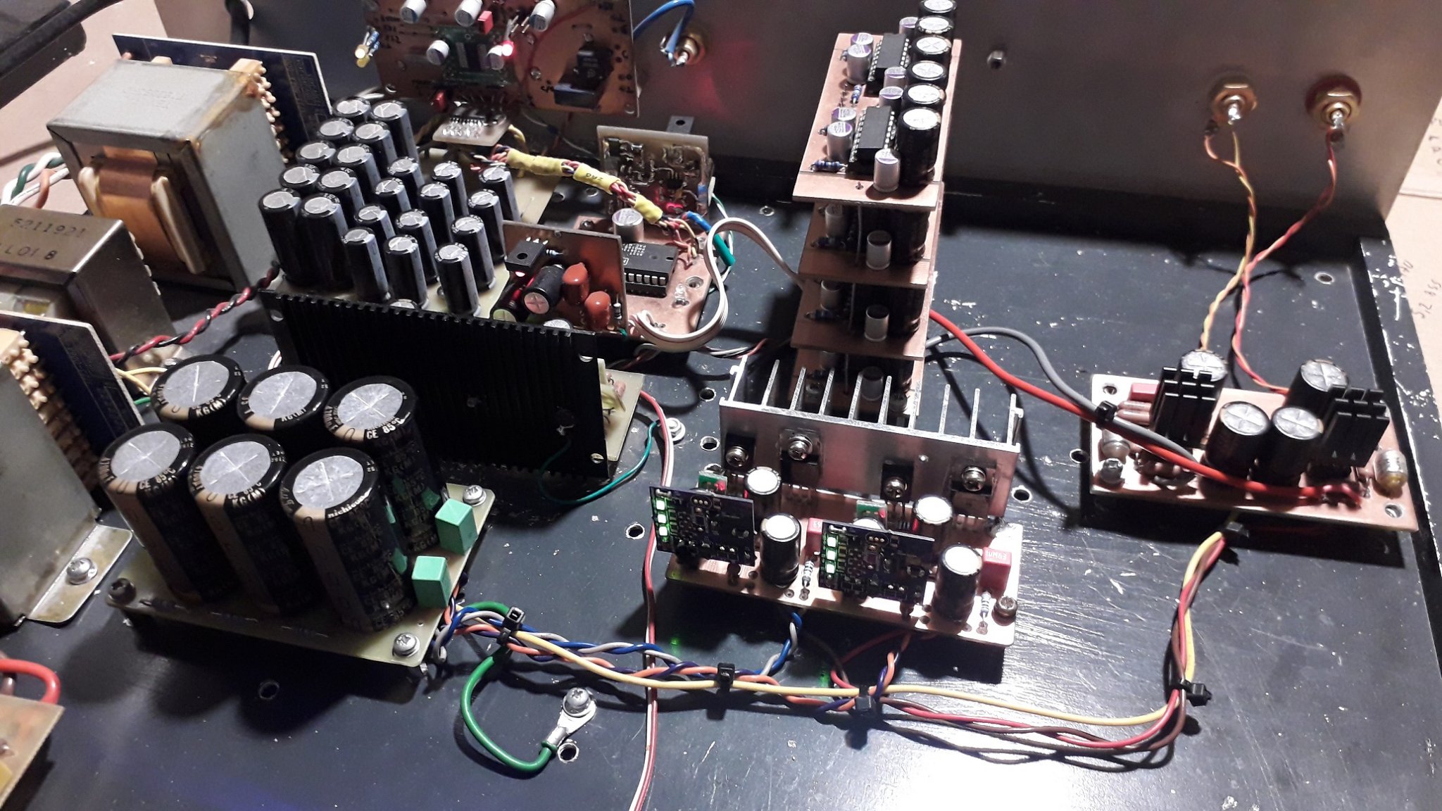

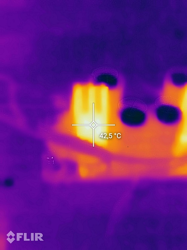

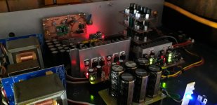

Today I finally finalized the rectifier-regulator for the AD811. The output voltage of the regulator is +/-14V, and the input voltage is +/-28V. The rectifier was also refreshed with new capacitors, 6 pcs. 4700u/35V Nichicon KG so that there is literally none ripple at the input of the regulator. That's the beauty of the shunt regulator, with a good CRCRC filter you can literally remove all the ripple from the output of the rectifier.
AD811 now have heat sinks, BGA 12*12mm literally glued to the i.c. and with them the temperature of the AD811 itself is 42.5C which is almost 4C less than without a heat sinks with a lower supply voltage of +/-10V.
I hope to start testing some other op amps this week😉

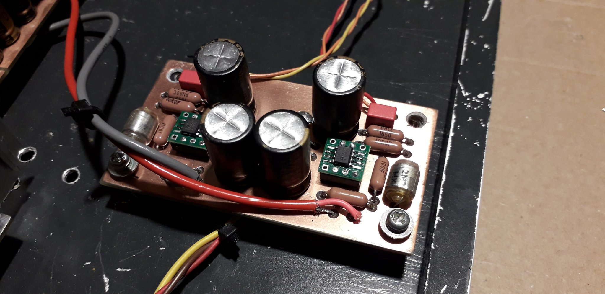

The ADA4625-1 was the first to come to hand only for the reason that it is intended for something else, so this was an opportunity to try it. My intention is to try more than a dozen single and double op amps, but I have less and less free time, a typical problem today.
Operating conditions of the op amps: Vs=+/-14V , Idac=9.6mA pk-pk ,Zdac=250ohm , the output of op amp (Vout=9V pk-pk) is directly connected to the output stage via a 10k potentiometer and there are no capacitors or transformers on the signal path. This will be the case for all op amps in test.
For the ADA4625, the guys from AD say in the DS that it's the best jfet op amp on the market, and I think they're right in this case.
I have to admit that it is good as an I/V, it plays beautifully, a complete surprise. But it's still not like the AD811, it's a bit withdrawn and not as clean and precise, but anyone who hasn't heard the AD811 would be very satisfied with the sound. My friend says that it is similar to the AD797 with the characteristics of sound.
Excellent op amp for I/V stage in any case. 🙂

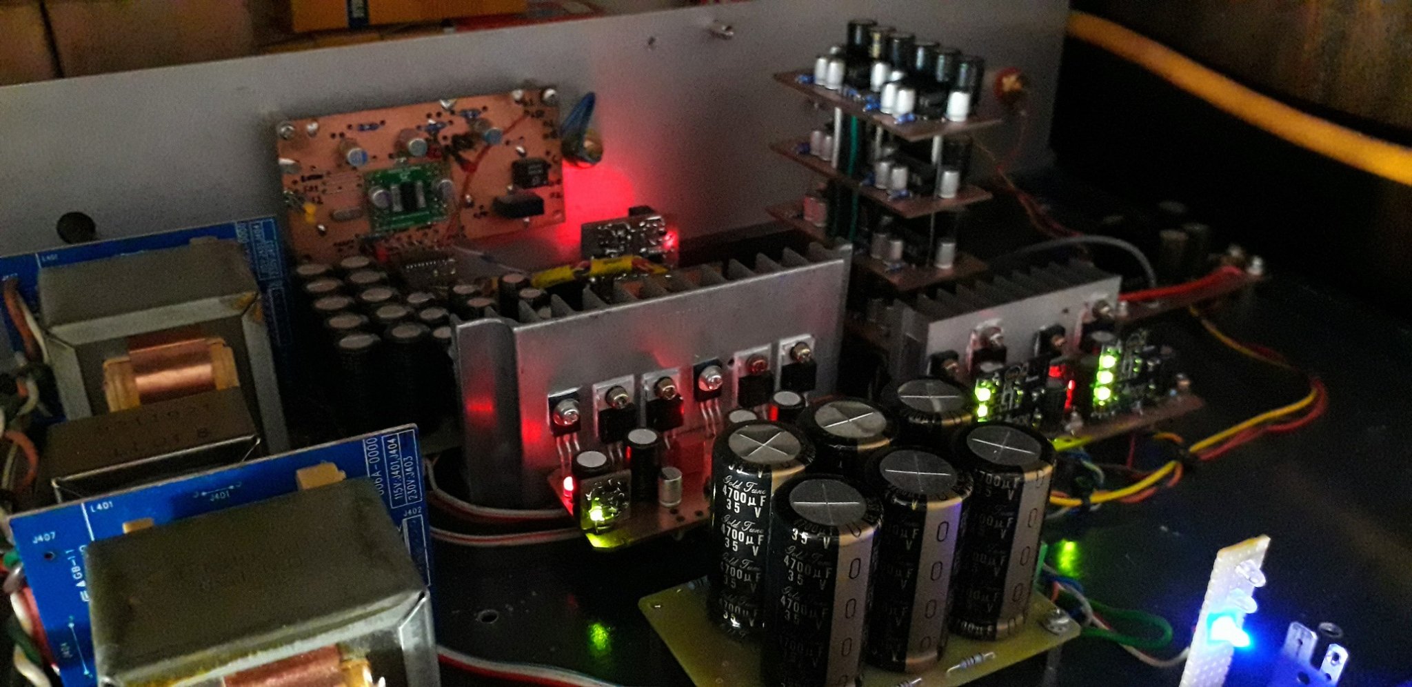

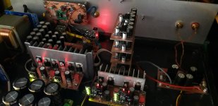

I finally finished upgrading all the essential power supplies-regulators in the DAC. A few days ago the PMD100 got a new shunt regulator only for the interface (pin22, VDD2), eight pieces of PCM1702 also got a new shunt regulator similar to the AD811 analog stage regulator but with a much higher output current (400mA max). All regulators now have ADA4897 and ADA4625-1 op amps in them instead of OPA1641 and ADA4610.
For the first time I tested the ADA4625-1 in a 5V shunt regulator and I must admit that it is much, much better than the OPA1641 at the same position with a 1V reference, the conclusion is that I managed to completely remove the MHz noise from the DAC power lines and analog stage with new op amps and improved power supplies -regulators.
Naturally, all this led to a huge improvement in sound quality, which only confirms my thesis that there is no good DAC without a quality regulators. Unfortunately, the price and the effort invested in these regulators are not small, but they justify the invested funds.
These experiments with power supplies and regulators will greatly facilitate the creation of my new DAC, because I already have developed regulators with excellent characteristics, especially in the MHz range. I think the next candidate will be the PCM1794 with a hybrid analog stage (CFA I/V + tube output).
So far, I still have to test the op amps in this DAC, only AD811 and ADA4625 have been tested, and there are more to come.

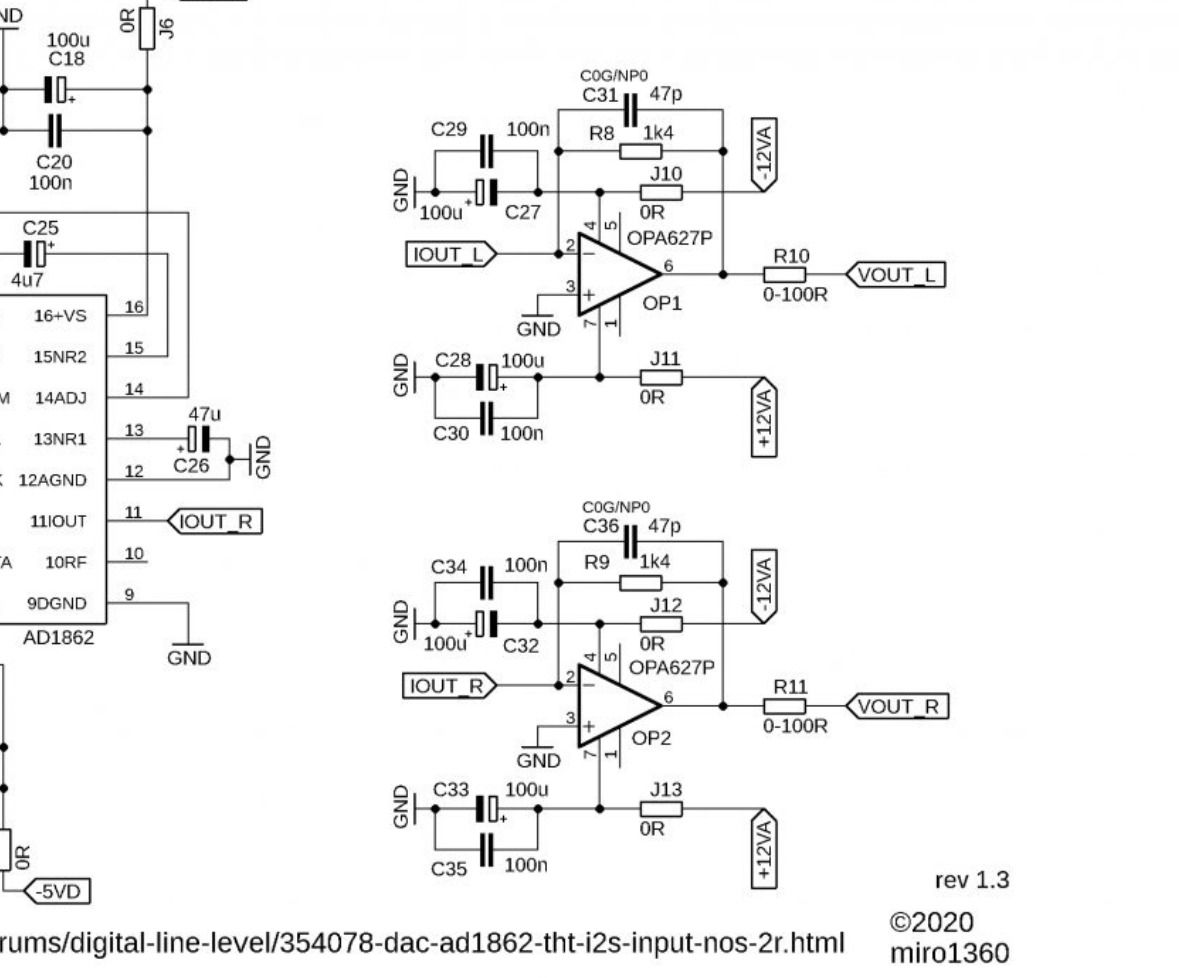

Hello Grunf,
I’d like to give AD811 a try in one of my AD1862 MiroDac’s. The board has an integrated opamp circuit for I/V, the difference I see from your/Jung’s AD811 circuit is the addition of R1 (for stability?) and R3, R6, R5 and C5.
At the bare minimum, should I implement R1?
The DAC uses single chip so current output is +/-1mA, not the higher current you get from paralleled chips. But, I use a preamp with gain between the DAC and amplifier. Does R2 and C1 need adjustment from your schematic on Post#1?
I have the choice of using DIP8 or SOIC8 (soldered directly to the pcb, no adapter), which would be best for thermal considerations? Heatsinking for either package is mandatory, correct?
MiroDac I/V section is attached
