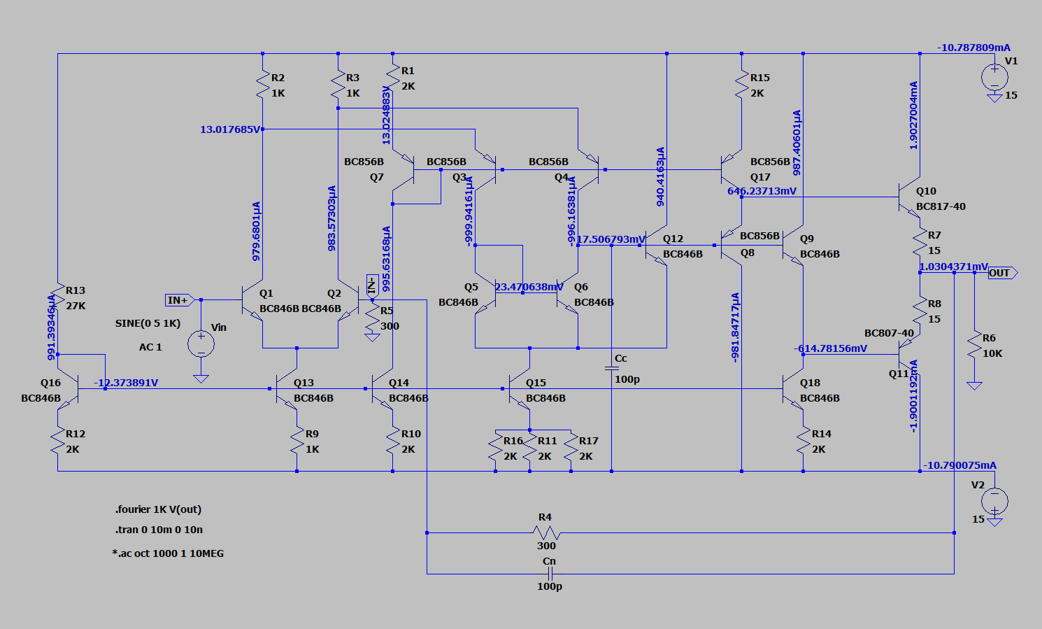

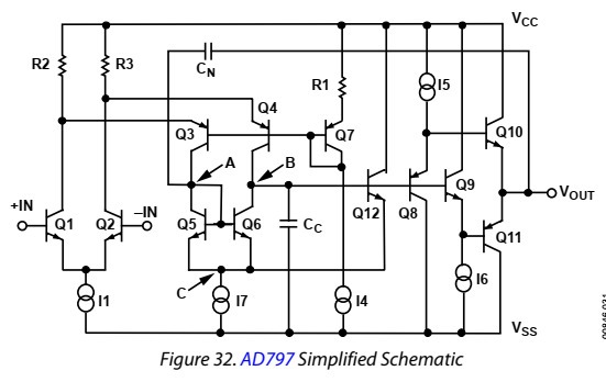

AD797: what a nice scheme!
Hello,
I was attracted by the elegance of the AD797 schematic (well, the simplified schematic only is available) and so I decided to reproduce it on LTSpice.
Here my interpretation, maybe one day I will make it as discrete one:
any opinion?
  • Thank You
Reactions: ginetto61
Hello,
any opinion?
Differential input stage -> folded-cascode VAS with shunt compensation -> diamond buffer output stage.
The novelty is the current mirror of the VAS is bootstrapped. It should benefit its open-loop bandwidth.
As the vas stage has no current gain, it may lack gain as standalone power amp. For an audio amplifier, you want at least 23dB gain after closing the loop. Plus 50dB negative feedback at 1KHz.

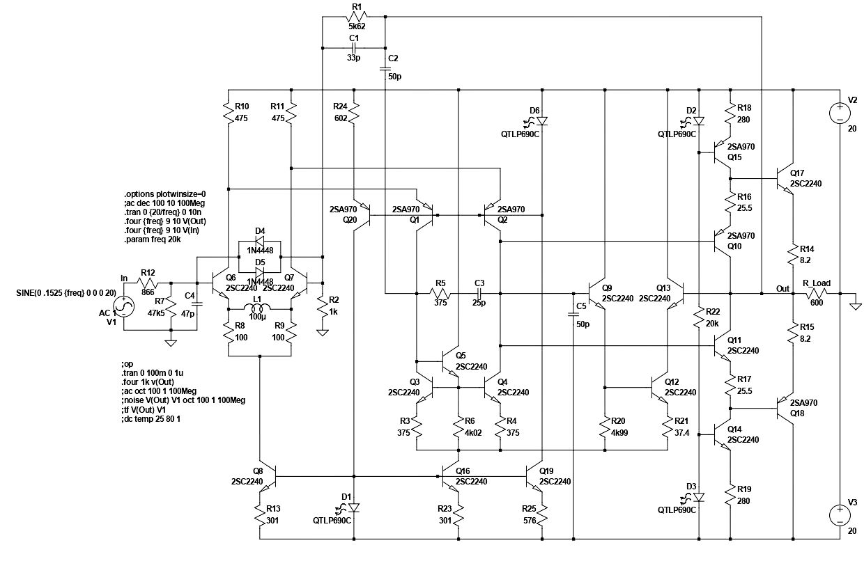

AD797 Clone people! Who can make a better one?
I think I manage to bit you lineup😀 ...at least my sim tells me so
:cannotbe:
Below you'll find a circuit and FFt diagram at 1kHz and 20kHz (output at 1Vpp, load 600R)
Made this , Circuit working, it has only one problem, whenever I remove input signal,getting dc9v plus out and when connecting signal from phone jack it's become 1.8mv offset and works, why without signal or any input connection getting DC out and circuit not working 🤔 any fix?
But u can publish for diy users or for personal users, it's pretty old clone tried to make it cause it's simulated but not made by any other, but now 2024 if anyone modified it for better performance, then that's will much better damn sure 👍
