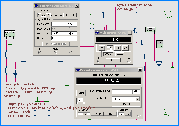

Lineup, you really need to put emitter resistors in the output stage. The AD797circuit you’ve copied uses the “Diamond Buffer” circuit as an output stage without any emitter resistors. This is fine for a circuit made on an IC chip, as the driver and output transistors can be closely matched and thermally bonded.
If you were to build the circuit with discrete transistors, the first time you apply power, the output transistors will either turn on hard and blow up almost straight away, or thermally runaway and blow up a few seconds later.
Glen
If you have a look at my Later own version, based on AD797 topology,
but some changed and added features:
High Voltage Op-amp (100Volt or +/-50V)
using 2SK373 JFETs input (minimum input bias current = offset precision)
and 2N5551 + 2N5401 transistors for the Diamond
....you will notice
I have used small emitter resistors, for better control of idle current in output.
SEE My Attachment - second time around! .... wont be a third opportunity 😉
But the initial test circuit, built very much to explore AD797
uses no such emitter resistances, and simulates well enough,
as Electronics WorkBench, EWB MultiSim9, assume ideal perfect match transistors.
Lineup Introduction Post = Post #1 of this thread:
My circuit is in attachment and follows the AD797 schematic
- what I know from reading This Datasheet Very Closely
All transistors BC550C and BC560C.
Total Supply Current 8.0 mA
Output stage, like the original biased only 0.5 mA ( 492uA more precise .... )

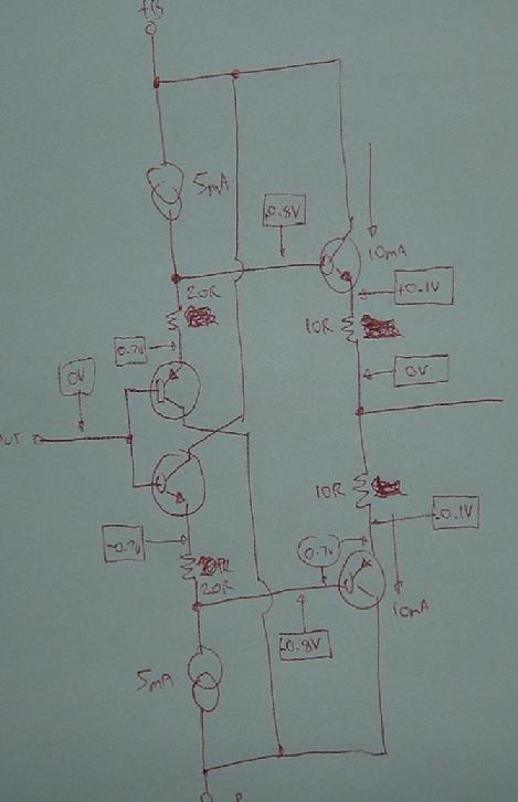

D'oh.....OK
To be fair though, you didn't mention the emitter resistor change in your text, so I didn't bother clicking on your image 🙂
Anyway, have you considered adding emitter resistors to the driver transistors as well? I’ve just draw a simplified circuit of how I like to make discrete diamond buffers. In order to have a predictable output stage bias current, I use emitter resistors for both the driver and output transistors.
The diagram I’ve scribbled shows a design for an output stage with 10mA quiescent bias current. The output transistor bias current is roughly equal to the driver transistor emitter resistor to output transistor emitter resistor ratio times the driver bias current. In this case, 20R/10R*5mA = 10mA.
Note that this is a simplified description, as a 700mV Vbe is assumed for all transistors. In reality, the actual output transistor bias current will generally be slightly greater than calculated in this manner, as the output transistors, running at greater current and higher junction temperature, will run with a lower Vbe than the driver transistors.
Glen
