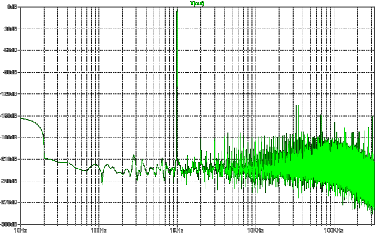

AD797 Clone people! Who can make a better one.
THD @ 1kHz = 0,000001%

I think I manage to bit you lineup😀 ...at least my sim tells me so
:cannotbe:

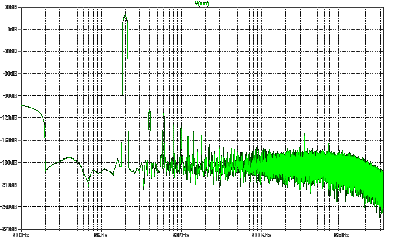

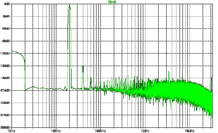

Below you'll find a circuit and FFt diagram at 1kHz and 20kHz (output at 1Vpp, load 600R)

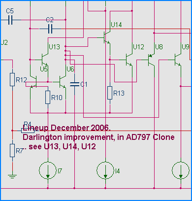

About your circuit, aparatus:
I did that darlington addition, in December 2006.
7 months before. 'Ahead' we may say 😉
See my attached circuit - is one of my test versions from that period.
I did not bother to publish my later findings and improved figures.
Why Throw Pearls before The Svines.
But I am glad you are here now, finally!
8 months before. 'Ahead' we may say

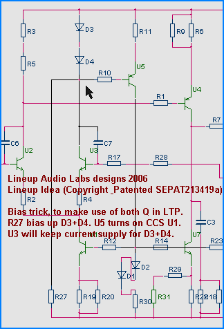

The Q20 Q19 current source biasing loop relies on leakage current to start, and as such it will likely fail to start with good small signal devices. Try adding a 1 meg resistor between the collectors of Q20 and Q19.
Good advice.
Or maybe try some other solution to bias those 🙂
aparutus good attempt to make a smart bias, with high PSRR,
remains me of the following circuit Trick:
so
below you will see one of my Patents of Audio Ideas from last year.
for those who can read schematics
this will be 'self explainative' 😎
Regards, lineup 🙂
