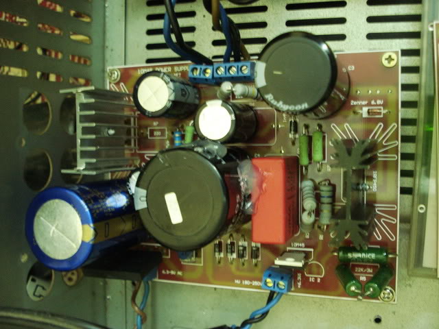

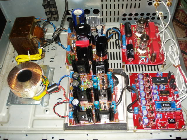

AD1865 is great dac, easy to make , high quality sound
i have sample dac project with ad1865
first protype, i use simple regulator for dac, and srpp for iv
then i'm replace srpp iv by paraller triode iv
second ver i use shunt regulator for dac board

Great samples, guy. It seems that shunt regulator is the rule of success in efficient power supply for DAC. And parallel triode at I/V stage is a saver for extended bandwidth output.
Suggest you to try the shunt power supply board by Quanghao, the more completed and tested one, with your DAC part to see how things are changing.
On the AC side, can we have a photo of your transformer? Thanks for sharing.

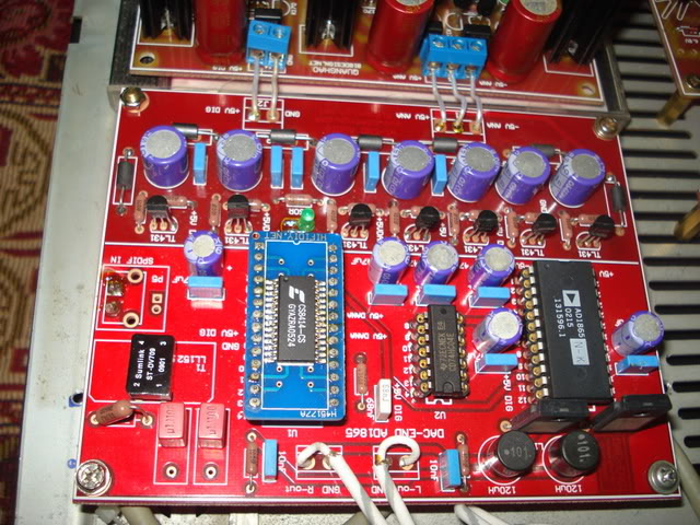

Now im layout new PCb for DAC-end use trasformer for output, all in one PCB, and i change tl431 by many Salas shunt low!
with capital under $ 1000, DAC-end can be compared with any DAC that cost $ 5000. is my thought! and when you've completed it you find difficult to replace the DAC that the present time and the next few years.

Do you have a schema of it?

The other issue with the AD1865 is the low output current you are going to use a high resistance I/V resistor which is not good. Best to parallel 4 AD865's to get a higher current and less load on the DAC Chip.
Why a high resistance I/V resistor is not good? V=IR is the Law of Physics. To get the desired level of signal, you can either increase the value of current source or the value of I/V resistor, provided that it's not too big to be affected by the input resistance of the next stage. The input resistance of the tube output stage is greater than hundreds Kohm whic is not a factor.
As far as the load dependance of SRPP read Broski'es article on SRPP. I did a lot of experiementing with SRPP in DAC's and found that a simple 6n6pi or 5842 with output taken from the anode sounds a lot better, just personal experience and Broskie does a good job explaining the why.
As far as bigger I/V resistor there is proof that most R2R DAC sound best with the lowest I/V resistor possible, some claim the AD1865 is somewhat immune but the datasheets are not specific. Basically you want the DAC chip to see the lowest impedance possible, this is why people spend hundreds of hours designing low ohm analog stages for DAC's like Jocko's I/V, etc.

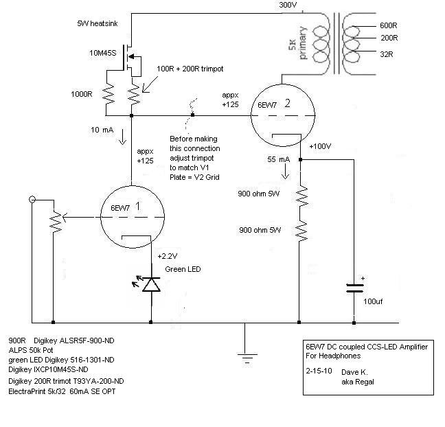

I used a PCM63 so I used this simple stage with a 47 ohm I/V resistor:
But I am now working with an AD1862 which has similiar +_1mA output as the AD1865,
so I am going for a lower I/V resistor (10 ohms) and a gain stage of 100, output impedance is 800 ohms:
Except no output transformer (just CCS like the first stage & OTL 1 uf cap) and the led on the first stage is upside down (I need to correct that), may experiement with cap coupling stages and grid bias on the second stage per Sy's recommendation. I'll report how it works out. I will modify the schematic for DAC output if there is interest. But this gives you the general plan.
