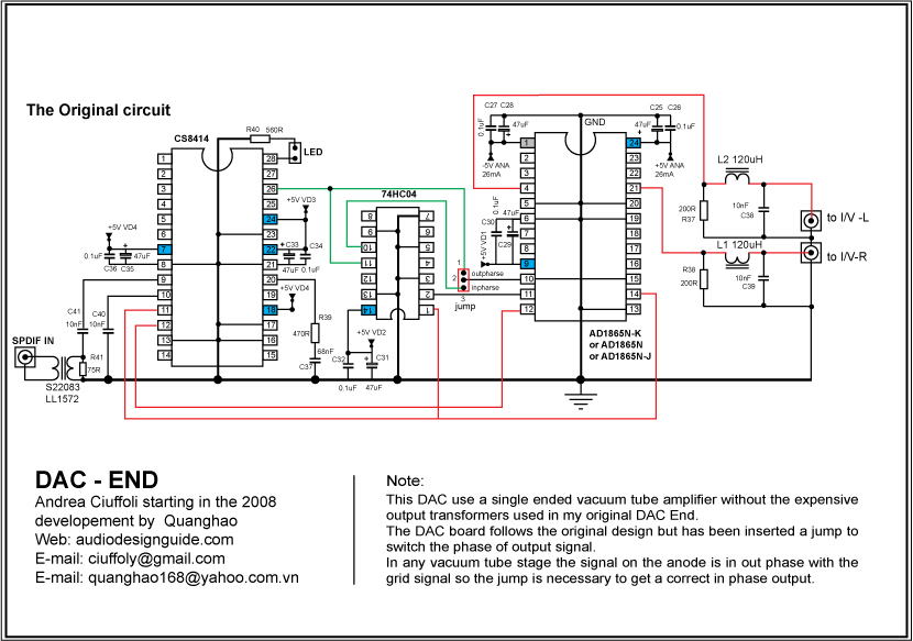

I had some questions about this design.
1. Way this DAC relay on clock from SPDIF and not using reclocking? How difficult is to add reclocking? Will reclocking improve jitter on this DAC?
2. What changes must done in schematic of digital side to use dual AD1865: L and R channels of one chip in parallel?

How rigth/wrong is information on site: Retro - DAC adout digital schematic of this DAC:
"all non-oversampling DACs have the same bug... At the recording side samples a made at the same time. Now look at CS8414 chart. We've got serial output: first goes out left channel, than right channel with 32 clock-beatings delay (signal FSYNK), which is T=1/(2*Fsmp) = 1/(2*44100)= 11.34 microseconds. It produces the phase shift between the channels:
360* 1000*0.00001134=4.08 degrees @ 1 kHz
and :
360*20000*0.00001134=81.7 degrees @ 20kHz."

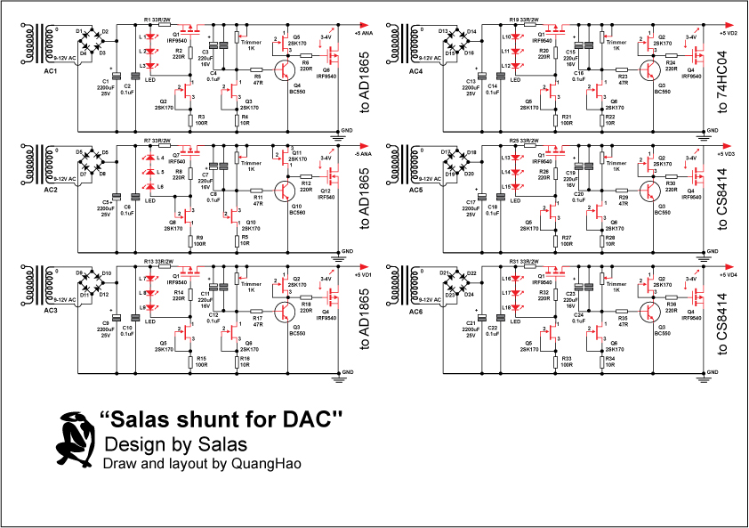

I would be very interested in getting one of the dac board and shunt power supply.
BUT what I would be most interested in is developing a battery supply using A123 batteries for the board.

The problem for years is SLA batteries are a bad choice just as car batteries are for filament supply. Now with these new A123 batteries they have a impedance of .008 Ohms..

Hello phrarod
Maybe you know:
1. Why this DAC relay on clock from SPDIF and not using reclocking? How difficult is to add reclocking? Will reclocking improve jitter of this DAC?
dac going to conversion just after accepting two words L and R...
not left after received left data word and so...
I think that is not true...:confused:
Not exactly this way. After reading CS8414 and AD1865 data sheets carefully I find out that there is delay between channels. On AD1865 "The falling edge of LL and LR cause the last 18 bits which were clocked into the Serial Registers to be shifted into the DACs, thereby updating the DAC outputs." The LL and LR are taken from CS8414 FSYNC output. To get falling edge on LR, when on DL (also DR, serial data inputs from SDATA on CS8414) right channel data data is clocked into the input registers, FSYNC is inverted. Result is 32 clock-beatings delay for right channel what causes 4.08 degrees @ 1 kHz and 81.7 degrees @ 20kHz phase shift.
This happens also on the DCA End 2.
I had not yet analyzed AudioNote schematic between 8414 and 1865 but I think it is better.
Sorry, can't catch your thoughts.... what phase shift and 32 sck delays ?
CS8414 serial out works in mode 6 (L/R, 18Bits LSBJ). Because data is LSB left justified, we have 14 sck cycles before MSB shows up (32 sck in whole audio sample). FSYNC goes directly to left channel latch. So no problems there whatsoever (timing between LSB ant FSYNC falling edge is in accordance with datasheet) . Now right channel latch gets inverted FSYNC with cmos propagation delay (in my case using ST HC04, ~16ns). This has no impact to transition beginning, because of 14 sck cycles before MSB. Now whole sample is fed to DAC, FSYNC goes up, inverts, gets delay from inverter, latches the Right channel DAC with normal delay of "LSB to FSYNC" + 16ns, end of story.
Am I missing something ?
Dunno about Audionote, but there were HC04 in between 8414 and 1685 in some version fur sure. Post a link to some reliable schematics if you know one.
I went through the documentation of the chips, very informative !
Why the CS8414 shown bi-phase coding error in my DAC_END ? Is it supposed to be like this ?
