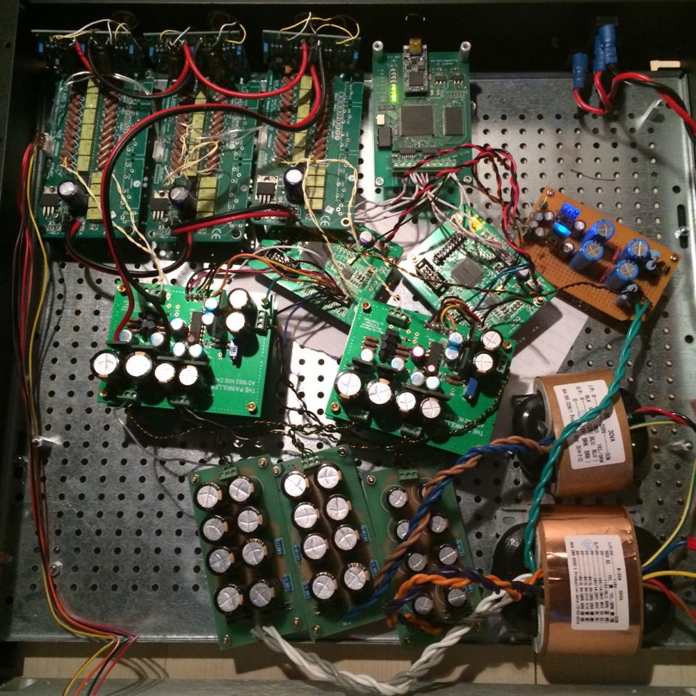

So, the prototype is now up and running, full speed. Four channels. Two and two channels share the same regulators. It looks a bit messy in the picture, but it's not easy to fit dacs and volume controls and buffers in the same cabinet.
Next up is a new batch of boards with a bit larger PSU caps, more space, more thermal relief, SMD-caps closer to the dac, HASL pads and a new name.
What do people here feel about analog low pass filtering? I've put in a small cap across the IV-resistor. Tried different values, ranging from 150pF to 1nF. But I found out that I actually preferred it without the cap. :shhh:

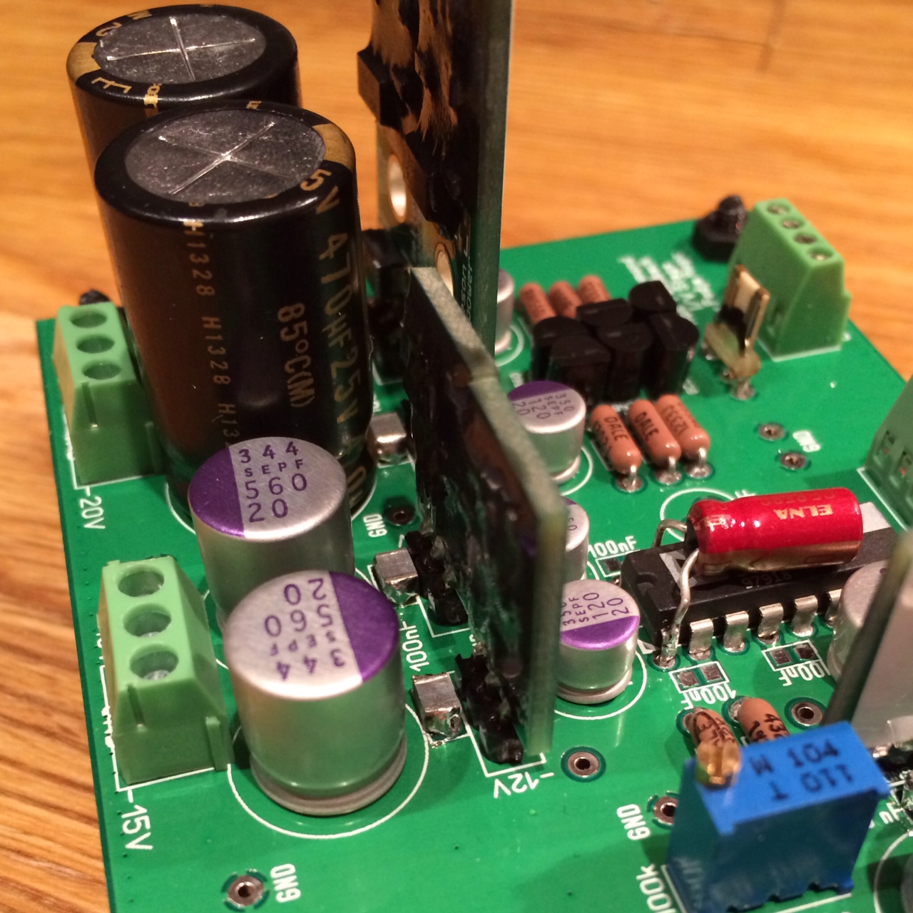

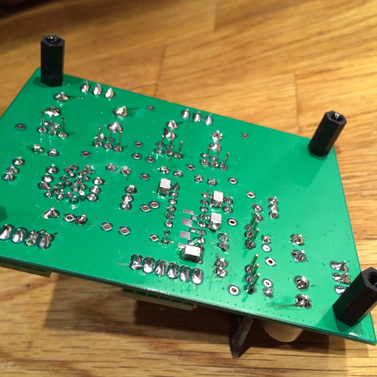

I've got the revised version up and running. It's got some minor changes. There's actually space for all the components and terminals, there's space for optional U.fl connentors underneath the board. There are SMD-pads for 1210 film caps underneath the board.
Been making a version with naked z-foil i/v resistors, Panasonic SEP caps and Belleson regulators. Works like a charm up to 384 kHz, but I have some trouble with the exaU2I receiver since it only has 11.28Mhz and 24.58Mhz oscillators.
I've completely abandoned Ian Canada's I2S->PCM converter board. I made a neater solution that I call the LE flipper. It's a REALLY simple device with one 74HC00, that outputs an inverted LE signal which I feed to the right channel dac. To align the bitstream I just reduce the volume in JRiver Media Center by 78.27 dB (13 bits). Works perfectly with any I2S-receiver and actually sounds better too.
Attached some photos of the newest board. No ceramics on this one.

Great job Jorgen,
Do the 470 uf before the Bellasons regs the advised value by Bellason ?
Does anybody know if the Bellassons need a output cap ? For lowering the impedance or to make a local reservor tank for the load ?

Jorgen,
Have an idea in relation with what i writted you in PM : could you try before the Bellason the UCC ASA caps instead the sepc but stay with little SEPC after the Bellasson in a first listening test ?
Try after the opposite : it will give you the sensibility of the mlyout and those regs to caps mods 🙂
Hi Jorgen,
May you please to publish a more focused photograph of one of your board in situation (your actual working DAC). I need it to connect the two mono PCBs togethers via some Gnd Vias
... but I'm a little worry as I don't which ones and I am a little scarred to create lound grounds loops !!! Does it need more than one link between the 2 pcbs ? Which ones do you use ?
Is there some advices as the origin of this thread was the difficulty to create a standalone pcb with two mono AD1862 chips ? Marce if you read this 🙂 ?
thanks in advance for your hints
kind regards
Eldam
I've connected the boards together at each of the pwr gnd pads, and also at the dgnd. I've also tried to connect them together through the mounting holes, as these are also connected to ground. There seems to be no difference. No problems with ground loops. But perhaps someone has a bit more knowledge on this topic. Ground loops is a difficult topic.
