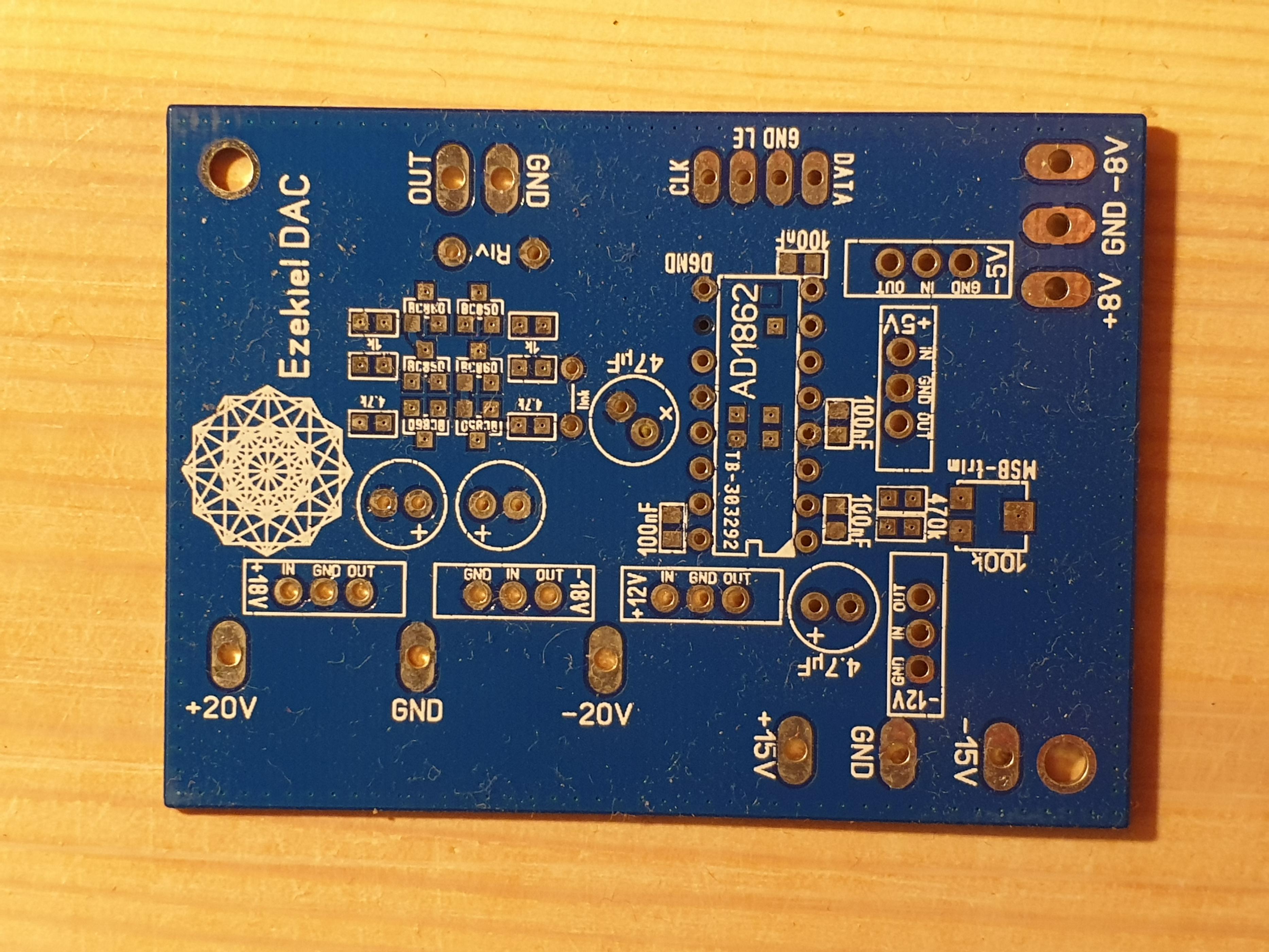

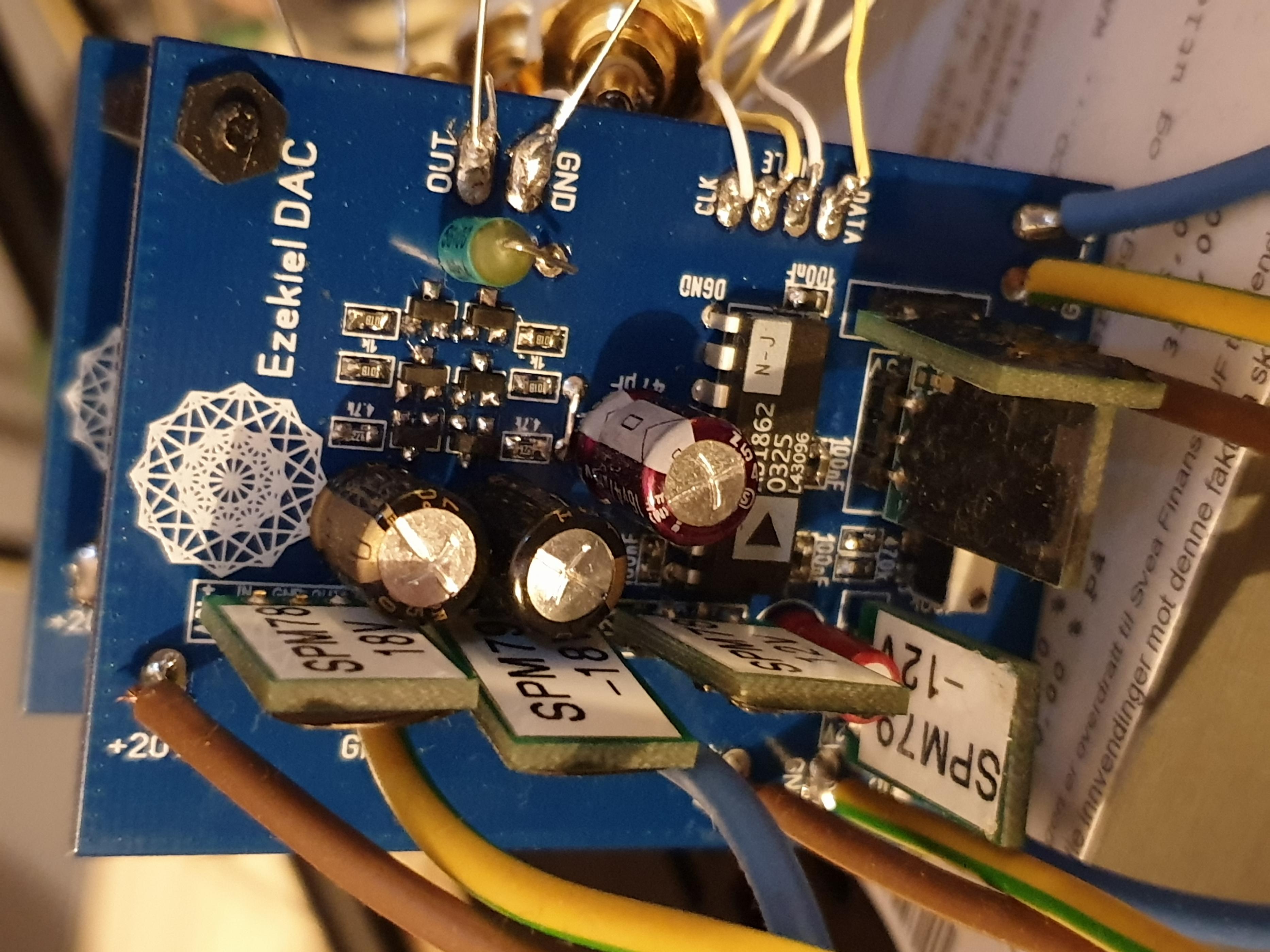

Here are a couple photos. One of the (dusty) unpopulated dac. And one of the populated prototype. It's really compact. I'm surprised at how good it sounds compared to how messy it looks 😀

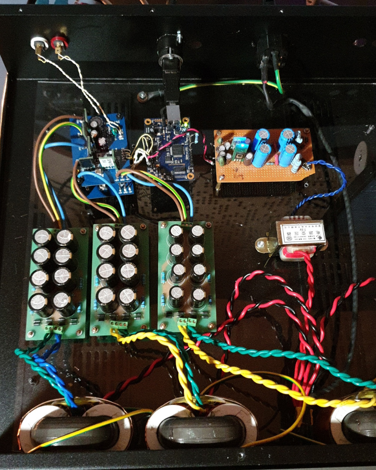

...aaand here's the finished dac in its enclosure. All is diy except the I2SoverUSB receiver. Very happy with the result!!
I haven't heard many different dacs in my setup, but I can definitely say that it's way way better than the Chord Hugo 2 and the Naim DAC, both priced at $2000 USD. Would be interesting to compare it to some higher end dacs.

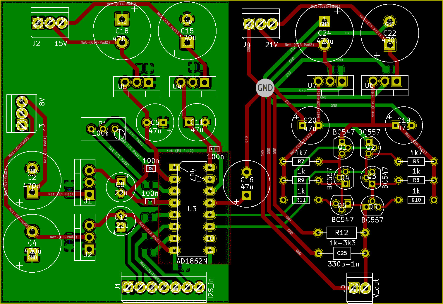

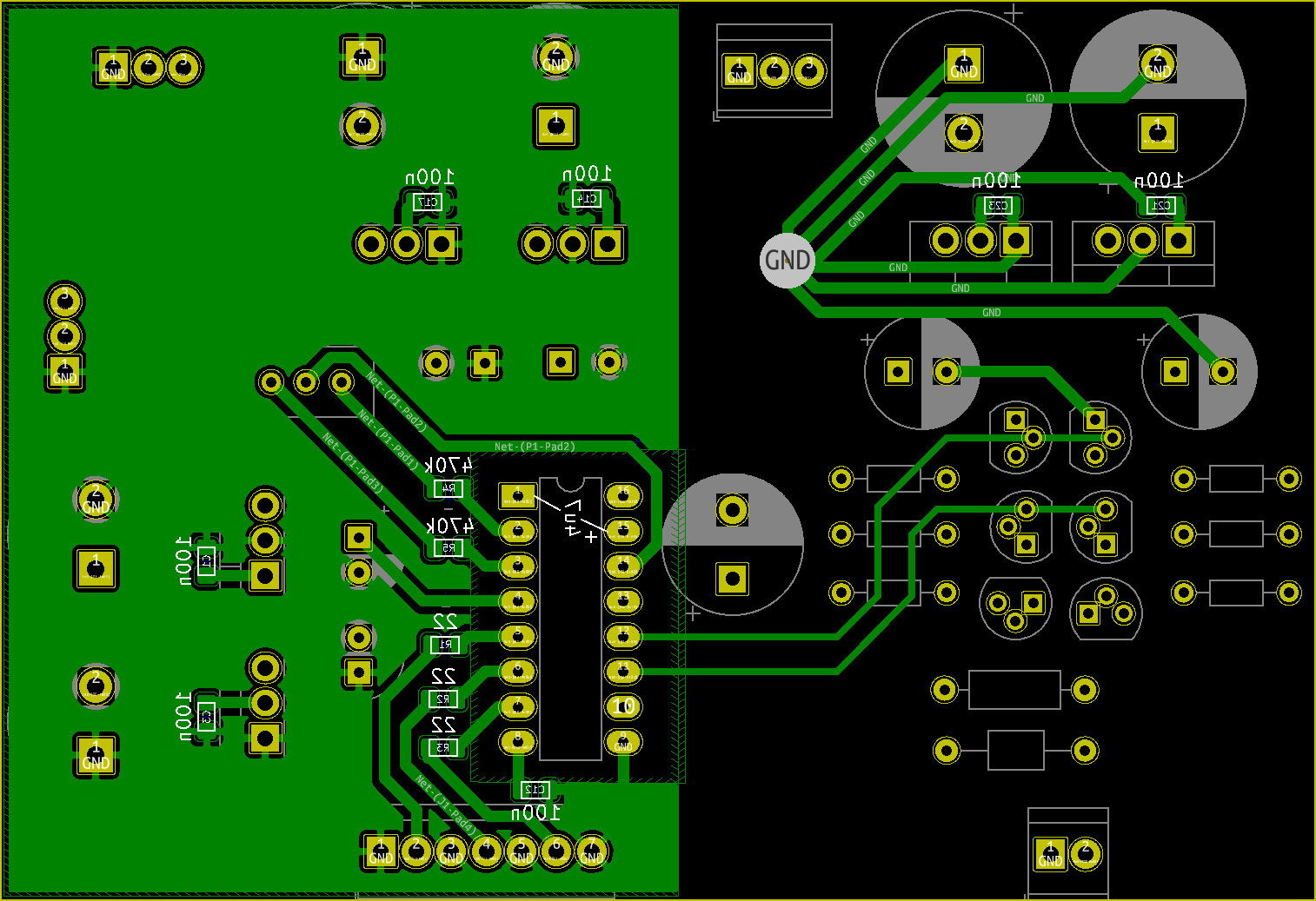

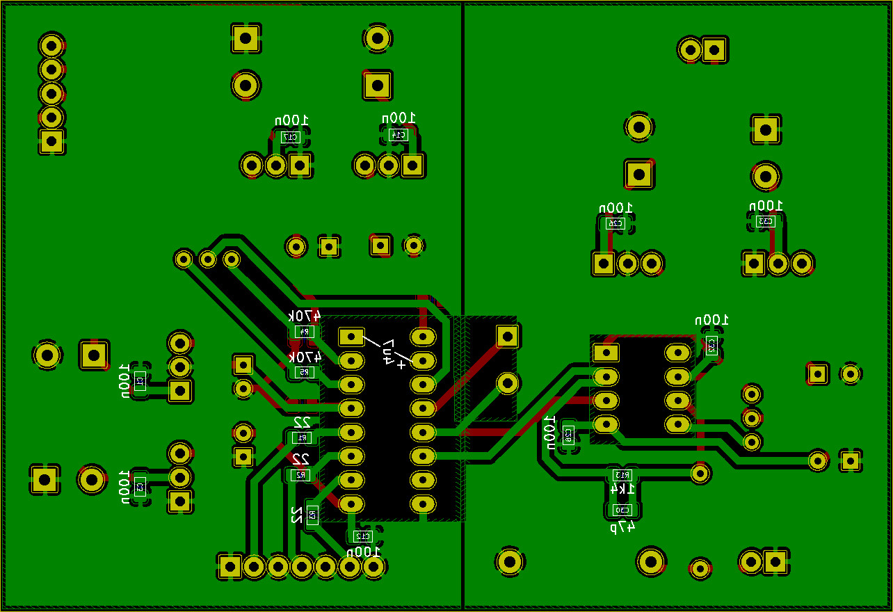

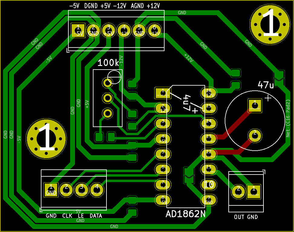

as the gerber files are lost and I wanted to build this project I made new boards. Iam very curious if this circuit really sounds better than a Naim DAC 🙂
Front view:
Back view:
I tried to star earth the analog section, and the digital section has a filled copper zone instead.
Any advice...?
Front view:
Back view:
Any advice...?
... Any advice...?
yes, if its I/V is from post #36
AD1862 PCB layout
then put something else in there, this I/V has not a nice sound at all, it's very flat, basic NE5532 opamp sounds more beautifully (I myself have compared it few years ago) ... there are much better solutions (better opamps
AD1862 PCB layout

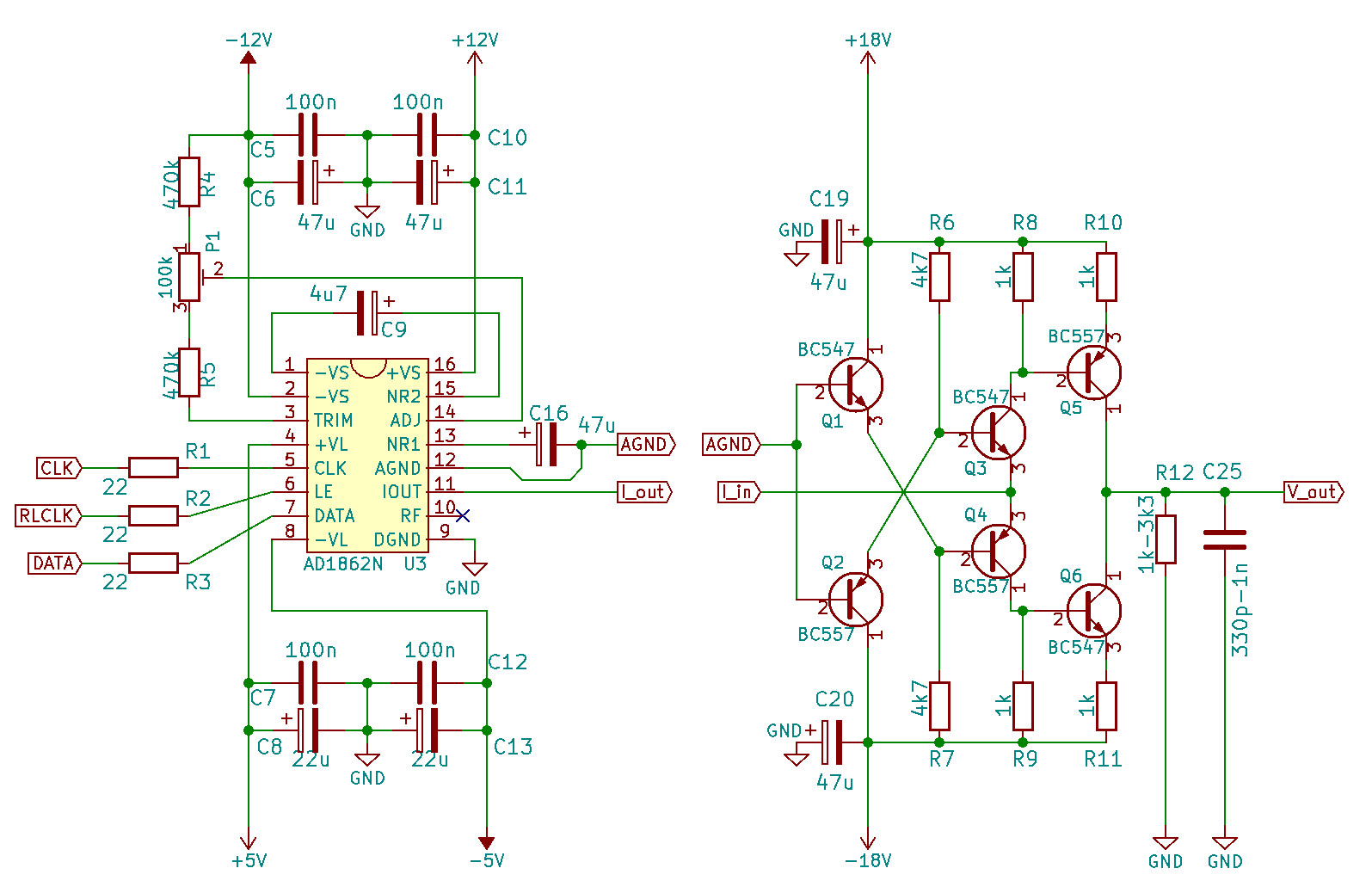

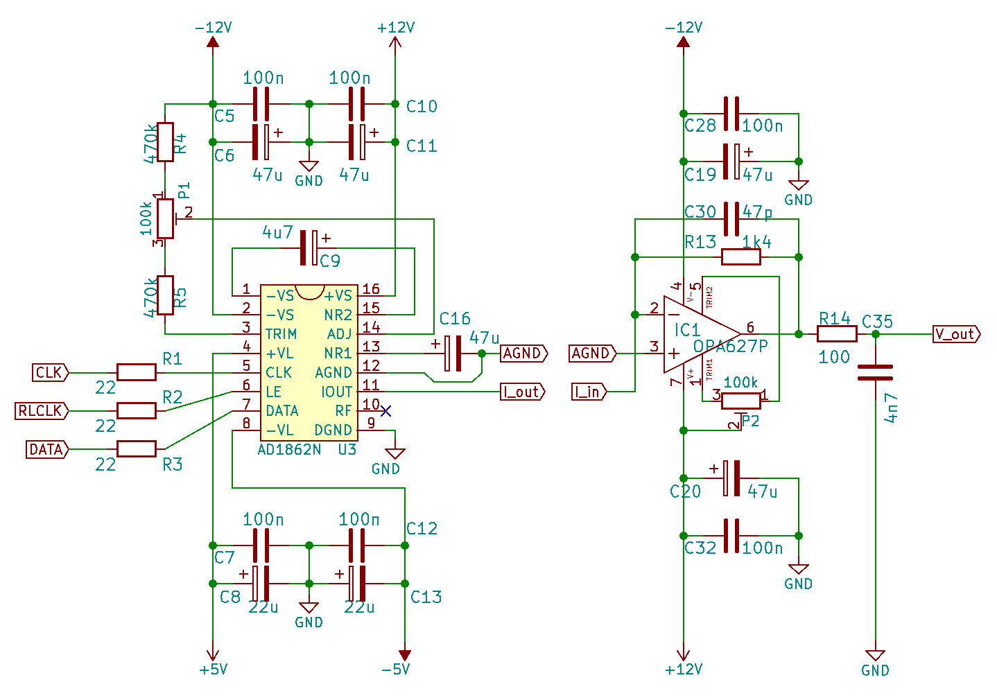

Yes, I tried to re-draw it:
But Painkiller wrote it sounds better than DACs by Chord and Naim...?

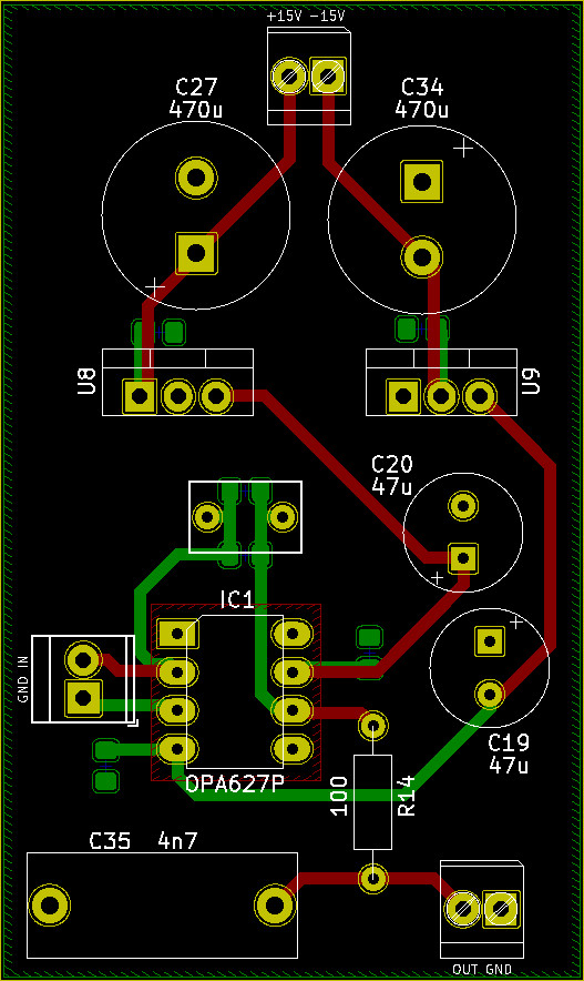

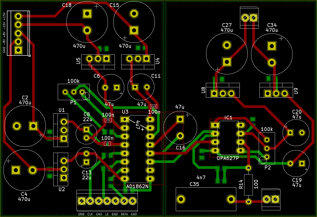

OK, I also re-draw your OPA627-based circuit:
PCB front view:
PCB back view:
Questions:
- Painkillers schematic shows AGND connected to GND. I draw a separate star-GND for the analog section: where should I connect them together?
- For the OPA627: is it a good idea to have the 47p cap across the 1k4 resistor?
I will build both I/V versions and report about the sound. If successfull I will publish files (gerber, schematic, PCB). In any case big thanks to Painkiller and Miro for the inspiration!

You should connect them together under DAC chip.Questions:
Best if you follow a solid GND plane, and don't cross the wires, like this: DAC AD1862: Almost THT, I2S input, NOS, R-2R
Yes, you can have it, ceramic C0G type only, or THT PP foil.- For the OPA627: is it a good idea to have the 47p cap across the 1k4 resistor?
Don't populate C35 (4n7), leave it empty, the AD1862 is audibly clean at the output.
I saw you have some 0R bridges: I thought vias and solder points create problems such as jitter...? As for the analog section I could do without crossings like this (added a THT footprint to the 47p cap as you suggested):

0R bridges is on power supply lines, not on signals. Most importantly, the NOS R-2R does not suffer from jitter problems, for the logical reason how it works. The biggest change in sound is in I/V section.
OK, my PCB without crossings and flexible ground options (GNDs tied together at the power supplies outside the board or near the AD1862, selectably with solder jumpers):
Drawing the GND wires in DACs into a star is not recomended, it's very bad, theoretically it could be but not like this.
It is recommended to do solid GND, and separate analog and digital only at critical points, not elsewhere (or not separate it at all) ... but don't trust me, follow the professionals if you want to learn something, because you obviously want to learn

Just an update: I finally built and tested the circuits and found the discrete diamond IV stage (with original Philips BJTs) superior to the opamp stage (cleaner, more involving, more transparent, better PRaT). I compared it also to the DAC in my Naim integrated: the diamond IV won hands down. The opamp IV stage was also good, it has triple stacked AD844s followed by OPA627 (it did not sound very good with only one AD844: with 2 it was much better, with 3 it was fine, so I found the same as reported by others). I used multiple 3X7-regulated supplies and will upgrade them to super regulators in my final build (6 per channel plus the digital supplies from a separate transformer). BTW I tried PCM63s in place of the AD1862s and far prefered the latter. I also compared the glue logic NOS input to DF1704 and PMD100 on both DAC chips and IV stages: the PMD100 is clearly better than the very good DF1704, the glue logic was noticeably less refined but also not bad. So I ended with enough modules to make 2 DACs out of all this: DF1704->PCM63->opamp-IV and PMD100->AD1862->diamond-IV 🙂
