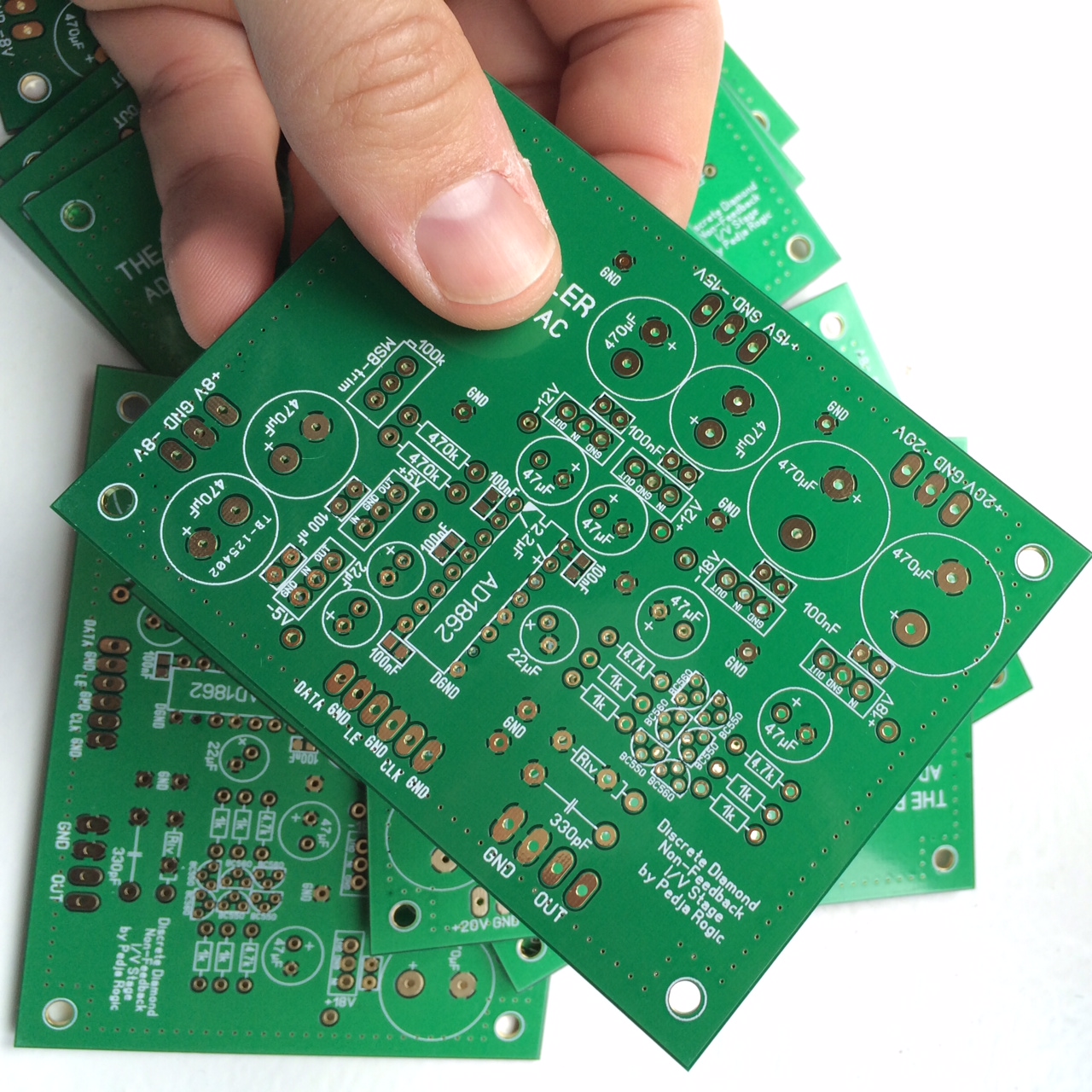

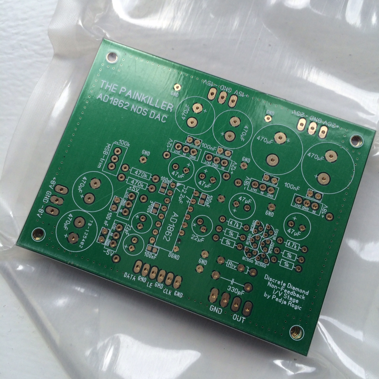

Well, yes and no. I'm waiting for a small batch of boards, on their way from China as we speak. I've sourced most of the parts. Just some Vishay Bulk Foil resistors that are missing right now (couldn't get the Rhopoints). But no sound yet.

Thanks! They look nice, and they feel like very high quality. But they weren't cheap. I payed $260 including shipping, for 8 boards. I ended up receiving 9. Don't know why.

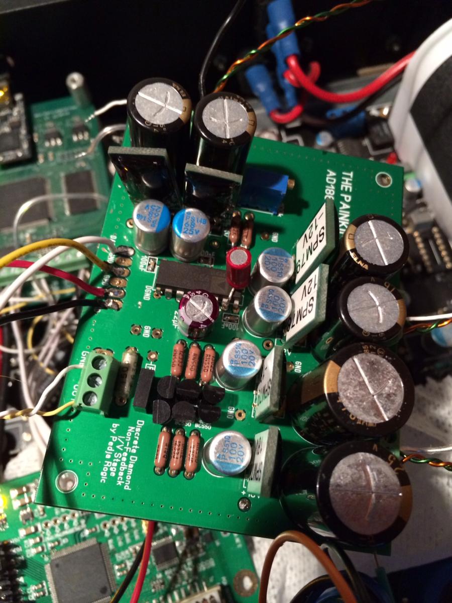

First two channels are now up and running. Attached a picture of the first card on the test bench.
Encountered some problems at first, and noticed some irritating mistakes with the board. First of all, there was an error in the silkscreen where two of the BC550/560 had been switched. Blew a couple of transistors before I found the source of the problem. Then there's not really enough space for terminal blocks. And the Belleson regulators are a bit wider than the regular LM79xx/79xx.
But it works. It really works! It is completely noise free. After adjusting the MSB trim there is no audible low level distortion. The sound is really smooth, detailed and airy. The timbre is just right. It all sounds very natural. Never harsh. Never muddy.
I think it should rather be called the Presence dac, because the music is just so natural and present.
All in all I'm very happy with the result. I think this dac really has potential, with only some minor changes is layout and component values.
