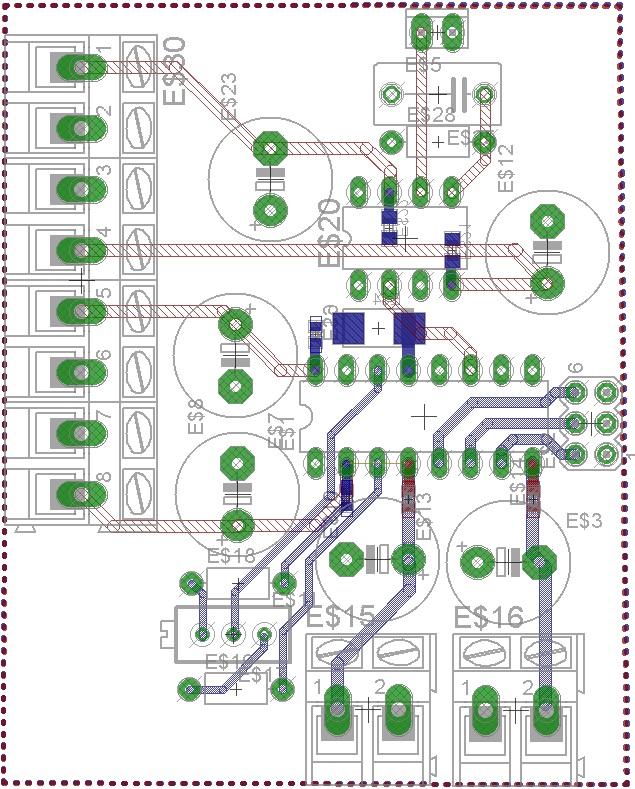

Maybe finding the layout of th eTEAC VRDS20 could help you for these two chips arrangement ?
http://culture.motiontopic.net/454308334307-teac-vrds-20-cd-player-used-sold
I don't know if the longer trace for signal is a better trade off than crossing the voltage lead beneath the pcb ? Marce seems to prefer the longer path... is it important with small current leads ?
For the value of the cap, I think most of the time a trade off has to be found between the ratio and flavor in each layout.
What sort of cap do you want to use right here ? If self inductance is important and you won't put ceramic for a question of flavor (after all you could put a 4.7 X7R 603 case with your ratio, but does such an important value for a second cap would not play alone and cause more problem in relation to a slower big one ?!), you can use a two pitch throug holes size on your pcb : 2.R & 5 mm. You will be able to populate with polymer or aluminium 2 or 2.5 pitch for the bigger value and idem for the smaller (e.g. Wima MKS2 1 uf 2.5 pitch if you don't like the ceramic; note here with 1 uf the ratio is not good as this is the bigger value in 2.5 pitch with MKT).

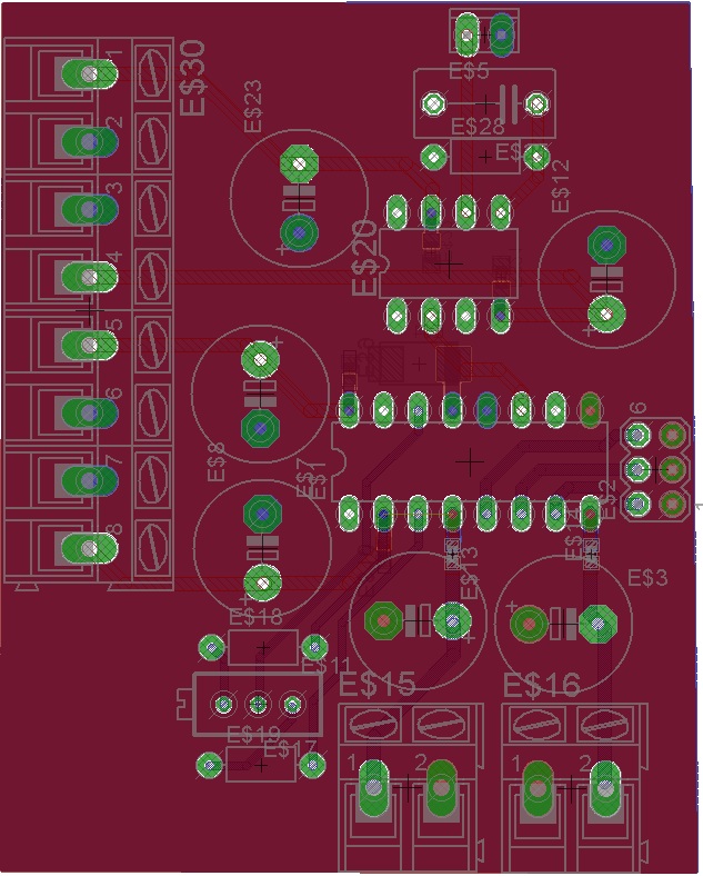

The TEAC VRDS doesn't even have a continous ground plane. It's a two layer board, And the grounds are split. Look at the photo of the VRDS-25 below. I don't know if this is an example I want to follow. This noise I'm talking about is only audible with very efficient speakers and with no attenuation. But I still find it unacceptable. I like the concept of stackable mono boards.
I was thinking of using 4,7uF and 47uF Silmic II. Of course, I could put different footprints here in order to be able to experiment with different caps.

Hi, I am back home from Racal Acoustics today, so as well as getting my life back I will finally have some time to do other things than work!!!
I wouldn't get to hung up on digital and analogue grounds for a two device board, I have some ideas that I want to formulate in my head first (and I will probably copy the circuit and have a play, its much easier to do a picture than pages of text).
Anyway just to keep you on your toes, some relevant info, that I thought appropriate, instead of trying to formulate a short answer...
Cos there isn't one...

Thanks painkiller,
I remenber this pdf now. Be aware than Mr Rodric notice : could be harder than an integrated chip ! After this design he went to OP861 for AYA2 and TDA1541 (you could find the scheme in a recent thread here or in the Audial site (pdf from 2013). People say this chip is better in standalone use than the AD844... Take a look too of the AD844 stacked thread here by George Hifi (many inputs about others chip than the PCM1704 : AD1865, TDA1541...). I saw also a thread elswhere about a video fast aop from philips in I/V conversion but don't remenber the ref !
About the Silmic 2: just tests can let you know : so you can sold sockets for jumping from a cap to an other one without solderind as it is a test board !
For me this cap is better for analogic coupling (in serie arrangement +--+)if no space for transformer or MKP...IF dc coupling is needed or pre has no serie input cap !
You try as well polymer : SAP serie from UCC, or SEP/SEPC/SEPF from panasonic... some exist in low value with better ESR than MKT and 2.5 or 2 mm pitch for a lower inductance ! I surmise the better is the layout the lower you will hear the pleasant distorsions than caps add in the set up & trade off phase of the listening test.
WOW the TEAC had no continous ground ! that was the 90s' years if i remmenber ! what are the aluminium caps, they looks like Black Gate standard (equal cold sound if too much used) ! near red ceramics... crystal is far from the four dac chips... and it was 2 000 euros !

Is the inductance not a question of disatnce as the docs Marce linked ? I believe a little sacrifice to let the AD1862 safe is a good thing !
When you consider two parallel conductors (IC pins) Inductance is proportional to length, so a standard socket has more since it adds length to the pins (which is why it will make highspeed opamps less stable)...
Whereas a low profile socket (recessed in the PCB) adds much less length, thus less inductance...
It adds a small contact resistance, maybe 10 mOhm, but this is less than the bond wires inside the chip anyway... and given the price and availability of AD1862... might as well socket it...
However the link I posted is a press-fit one (you must insert it forcefully in the plated thru hole), it is not soldered, so it is perfectly flush with the board, but... it will need a good precision in the finished hole diameter. It is easier to use a solderable version (they have a closed "bottom" so the solder doesn't get on the contacts), that way if the hole is a little larger, no problem.

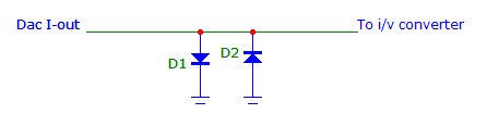

Signal diode e.g. populated in some I2S ? smd, bulk ?

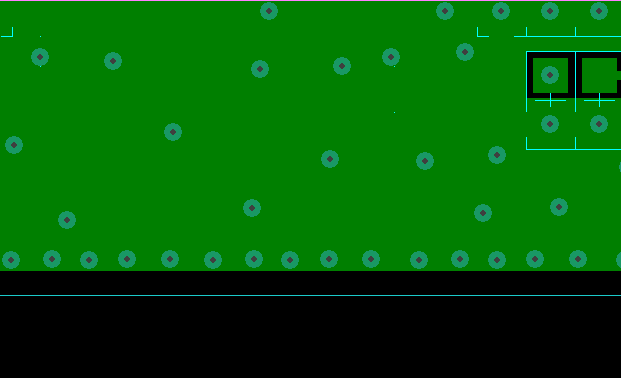

I've been reading Henry Ott's page. I quote: "Two of these three problems can be alleviated with the stack-up shown in Fig. 3b, where the two outer planes are ground planes and power is routed as a trace on the signal planes. The power should be routed as a grid, using wide traces, on the signal layers. Two added advantages of this configuration are that; (1) the two ground planes produce a much lower ground impedance and hence less common-mode cable radiation, and (2) the two ground planes can be stitched together around the periphery of the board to enclose all the signal traces in a faraday cage. From an EMC point of view this configuration, if properly done, is the best stack-up possible with a four-layer PCB. Now we have satisfied objectives, (1), (2), (4), and (5) while using only a four-layer board.
_____________ Ground.
_____________ Sig./Pwr.
Figure 3b
Actually i was designing a four layer board for fun and the configuration of layers was the same as described above. What do you guys think about stitching the two ground planes together in the periphery of the board? Would that be beneficial in this specific application?
Yes, like this.Does it work with a curent ouput ?
For example: for 10ohm i/v input impedance and +-1mA current out, the voltage will swing only +-10mV which is nowhere near the forward voltage of the diodes. So they don´t conduct and should definitely be used at least while the dac is being tested.
In case you made some mistake during your build / had a failure on the i/v / your probe slipped while measuring / etc... Then the diodes are there to limit the voltage +-0.6v and save your dac chip. Better be safe than sorry!
This looks good to me at least. But don't forget the cap between pin 1 and 15.
The GND, SIG, SIG, GND stackup is the one that I opted for as well.
Eldam: You're saying "use the largest capacitor value within the package size". I've chosen 0805, for practical reasons (my smd soldering experience is limited). So I could actually use 1uF for decoupling instead of 100nF?
I also see that Panasonic has some polymer caps with ESR down to 20 mOhm. That's lower than a lot of film caps even. I'm gonna try these for decoupling as well.
Ground plane always have to be stitched together with vias, round the edges as well is always good, don't need to be so close though, and add some random ones in board, as per picture below. These help break-up any tendency for resonant waves to build up on the planes, more a problem with power ground pairs, but can still effect just ground planes. Stitching vias round the edge of boards (a techniques used in RF design a lot) also helps supress edge radiation of noise.
The above stackup would be great for this design as you get excellent shielding for EMC purposes. Most commercial boards tend to have a hybrid version of this, where there are a mixture of tracks and copper pour on the top, as it limits the number of PTH vias, which can be problematic from a cost and spacing point of view.
HDI PCB designs though, that I do more and more of these days this is coming back into fashion as the vias are laser drilled and only pass through one layer so you don't block inner layer routing directions, also the cost doesn't go up when you start getting into the few thousand vias on a board. We have many a merry discussion on the various board stack-ups that are available for a particular design as there are advantages and problems with all choices. There are so many factors at play it can be quite fun (if you are into PCBs to the same SAD extent I am).
One area where todays high speed boards differ is power planes will have a closely coupled ground planes (both are done as planes, the power is not routed as tracks unless the design is very simple) to give buried capacitance.
