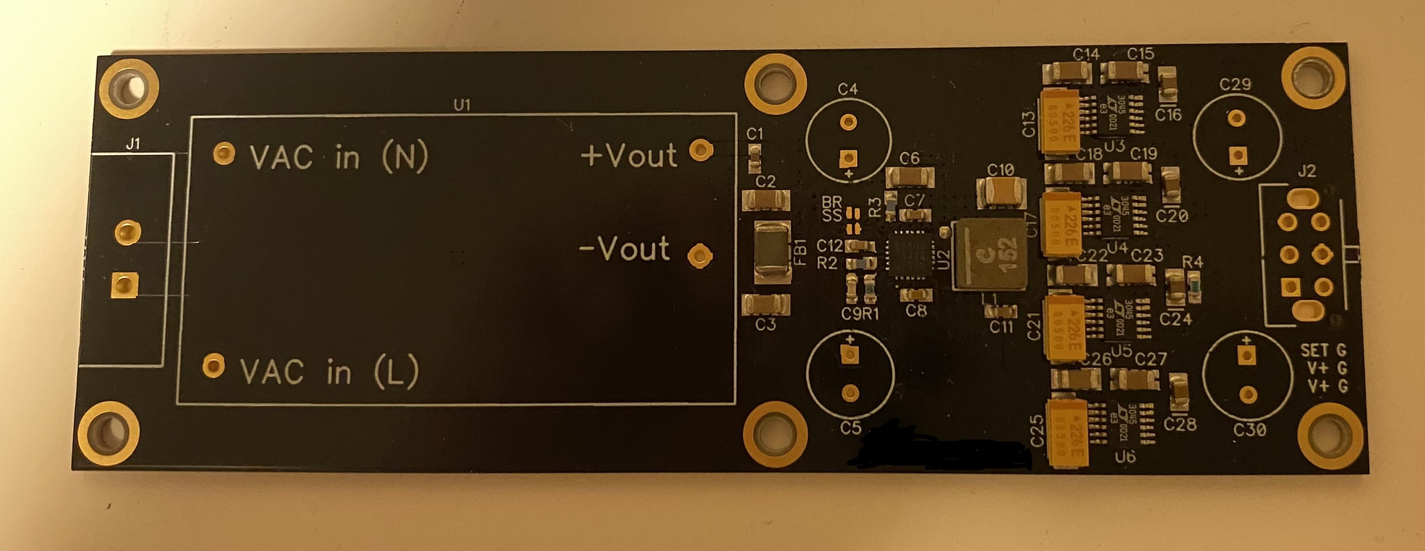

I made this killer little hybrid supply with a silent switcher 2 dropping the 12v input down to 5.5v, then into 4x LT3045’s in parallel set to 5v. 0.2uV ripple noise! 2A output.
