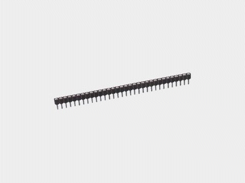

Our PCB designer, Jens, posted a pic showing a couple of pins/sockets for mounting 5mm pitch capacitors. Simply unplug and swap in new caps.
You could easily insert solder pins for all the frequency setting resistors. Then just tack solder resistor to the pins. It becomes very easy to unsolder and re-attach without damaging your PCB/pads.
Even better would have been to use dual in-line sockets/headers for all the frequency setting resistors and caps. Then just swap out dil headers with alternative components already set up in each header.

Try looking at this link: http://portal.fciconnect.com/Comergent/en/US/fci/drawing/58805.pdf
Sometimes I simply use standard DIL IC sockets that I cut in pieces with my side cutting pliers. The remove the plastic and you are ready to go.

The connectors are called SIP breakaway strips.I couldn't find them on Digikey but Mouser carries them.
http://www.mouser.com/catalog/630/1179.pdf
type F is the one i used.
When a connection would fail it could make some interresting noise i agree. As long as you don't have a fully DC coupled system your speakers and Amp should be ok though.
You can always solder the parts in the sockets whem you are satisfied with the final result.
