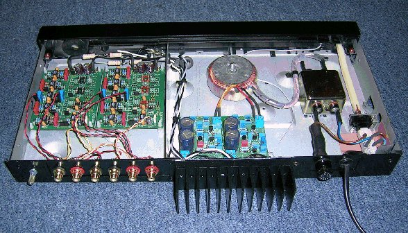

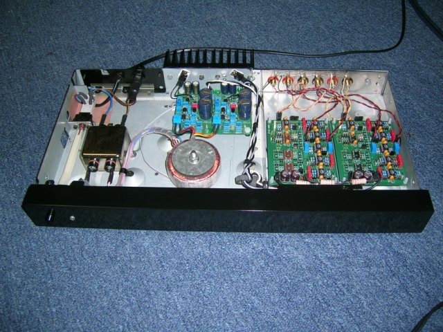

Hi Kro,
nice bit of re-use.
I like the relocated output Qs on the remote heatsink.
Is that box on the left an EMI filter?
nice bit of re-use.
Hi Andrew, yes it's a EMI filter. I had a number of them and there was enough place so i put one in.
All i can say is that the filter is dead quit. No noise,hiss or hum at all.
