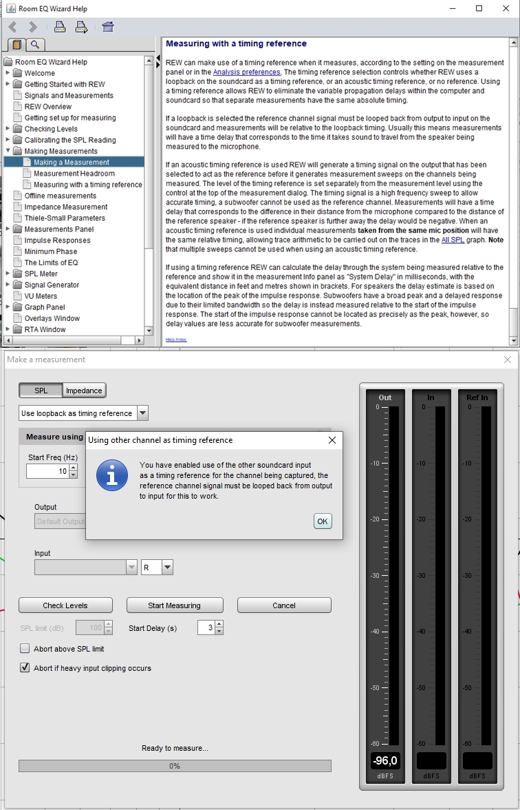

What does this mean?
Just looks like you haven't connected your loopback channel yet..???
Have you split your output channel with a Y-cable, to run the loop back into the timing channel? If not, that will solve.
That's either semi dual channel or full dual channel (depending on implementation). USB mic.s don't have this capability.
I knew it had that for discreet "sweeps", I just didn't think it had it for real-time measurements (..fft real-time is tough on the computer, and you can even see that problem mentioned in the video above).
