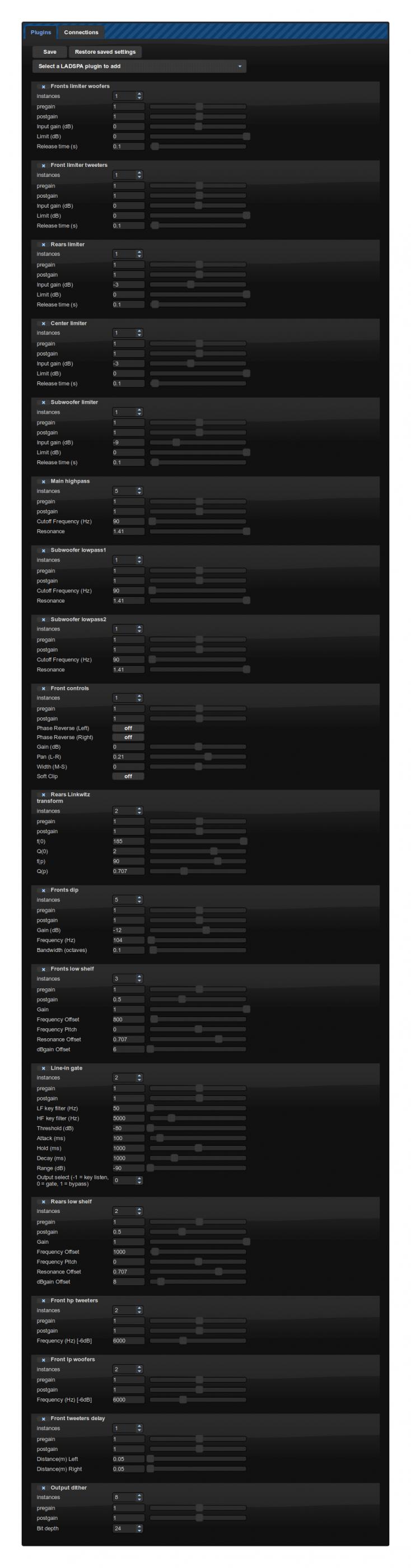

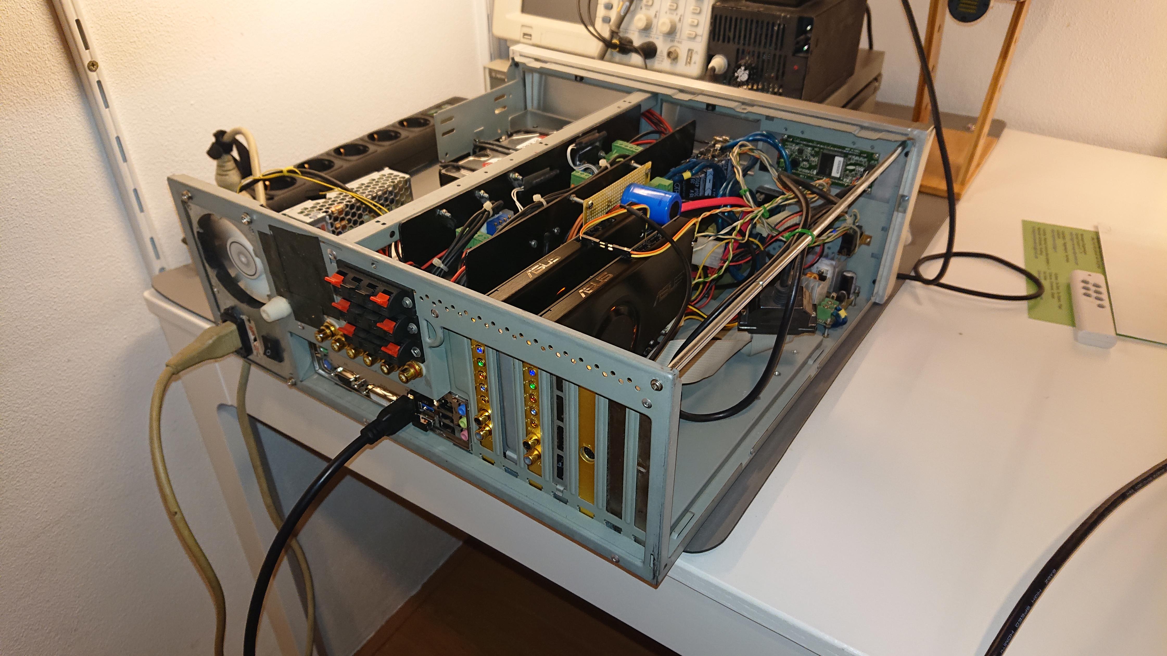

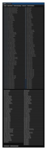

I'm using my own developed ladspa host for jack GitHub - bobo1on1/bobdsp
It has a webinterface in which I can add and remove ladspa plugins, adjust the controls live, and I can set the routing for jackd. I still plan to do a release for it, if I can find the time.
At my computer desk I have an extra desktop pc with an ASRock J4105M mainboard and Asus Essence STX II 7.1 sound card, powered by a toroid transformer and a wide input pico psu. It's connected to 3 stereo LM1875 amplifiers to drive the front woofers and tweeters, and rear speakers. There is also a stereo LM3886 amplifier to drive the subwoofer and center speaker. Audio is sent to this computer over ethernet using pulseaudio when I'm running linux, and when gaming I'm using the scream project on windows: GitHub - duncanthrax/scream: Virtual network sound card for Microsoft Windows
All filtering is done using ladspa plugins, the crossover between the front woofers and tweeters is 4th order linkwitz-riley.
The subwoofer is filtered using a 4th order linkwitz-riley lowpass, the other speakers are tuned to a Q of 0.7 and -3db point of 90 hertz, and filtered using a 2nd order butterworth at 90 hertz, which turns the speakers into 4th order linkwitz-riley highpass filters.
In my living room I've got a home theater pc with a self built dual TDA7850 amplifier built in, and two Asus Xonar D2X sound cards running from the same Crystek CCHD-575 oscillator. I have already built 3-way front speakers, and I will hook them up soon. All filtering for that setup will be done in the same way using ladspa plugins.

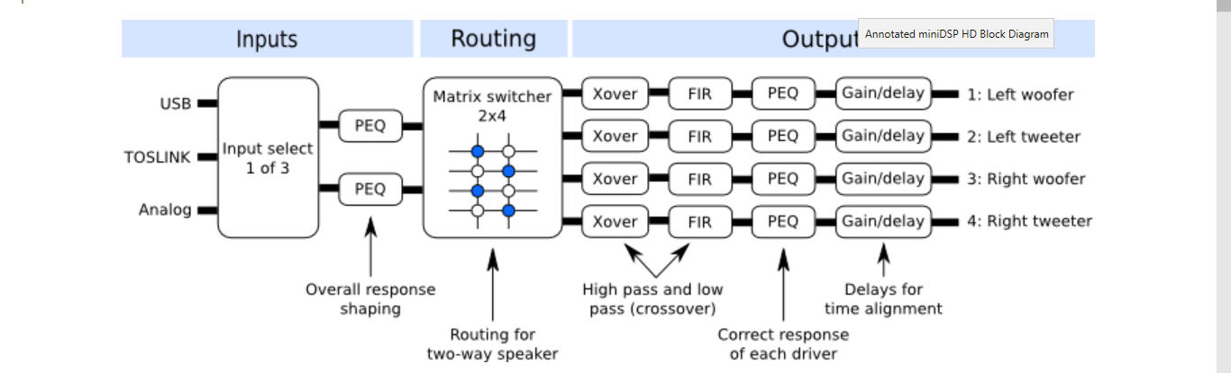

OK, thank you. You may have clarified what I was looking for.
Based on your post, EQ can be applied to each individual channel, for example one for the tweeter, and one for the woofer. And of course, there is also one FIR filter for the tweeter and one FIR for the woofer.
Your post also implies that EQ can be applied to the front end signal before going into each individual filter for the tweeter/woofer.
