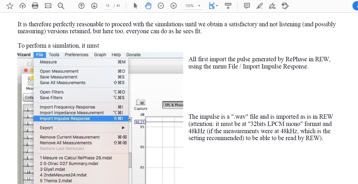

OK, so I found the answer to one of the question I asked before. That is, once you find the FIR from RePhase, how do you measure the affects of RePhase.
Apparently, in REW, you can import the impulse response from RePhase and I guess REW will convolve RePhase impulse response with the measurement.
You are not measuring the effects of rephase by doing that, but it is possible to simulate the effects of the convolution by applying it to a measurement in REW.
An easy way to think of convolution is multiplication (time domain). To convolve two measurements together you multiply them.
REW can do this in trace arithmetic with the A*B function. The SPL will increase so it will need to be lowered afterwards probably around 80dB more or less depending on the levels of the files combined.
If your original measurement was good the simulation will be very close to reality. This is where it can be beneficial to simulate the response of the filters rather than measure them. It will be immediately obvious if you stuffed something up and won't result in letting out the magic smoke 😉
