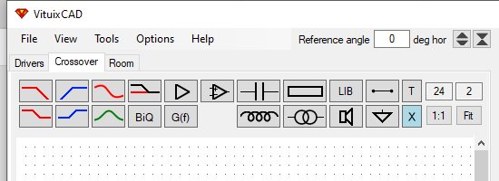

As you can see, the block options are somewhat limited.

What you are seeing there is filter types, low pass high, pass, biquad etc. Add one of those types in then change it to whatever slope and type from the above list you want.
I would advise putting a little bit more effort into actually using the program, before making negative comments like it being primitive or limited, you will then be rewarded with a state of the art simulation program that cost you nothing but your time and effort to learn 🙂

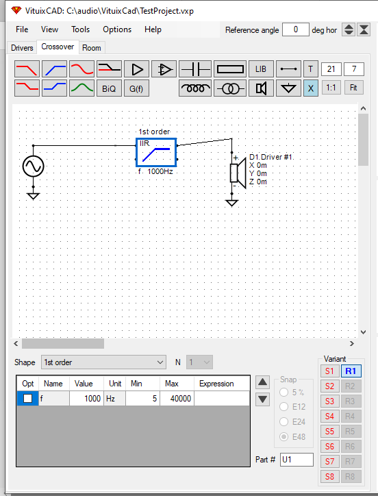

I did try one of those block but it's very limited. I think you can only change the corner frequency and that's it.
As you can see, you can only change the corner freq. of a IIR block. Have you personally try it out yourself?
There is a "BiQuad" that you can change some parameters but that's about it. There's really nothing much more than that.

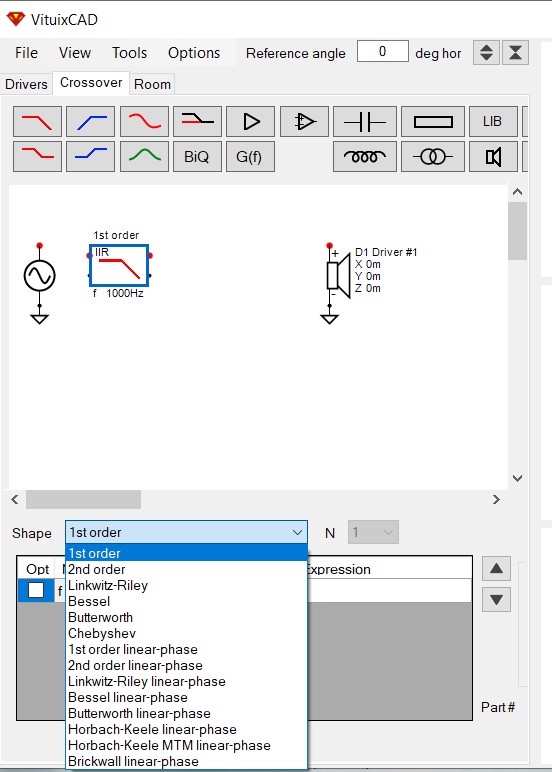

Just press the shape menu box and voila!
