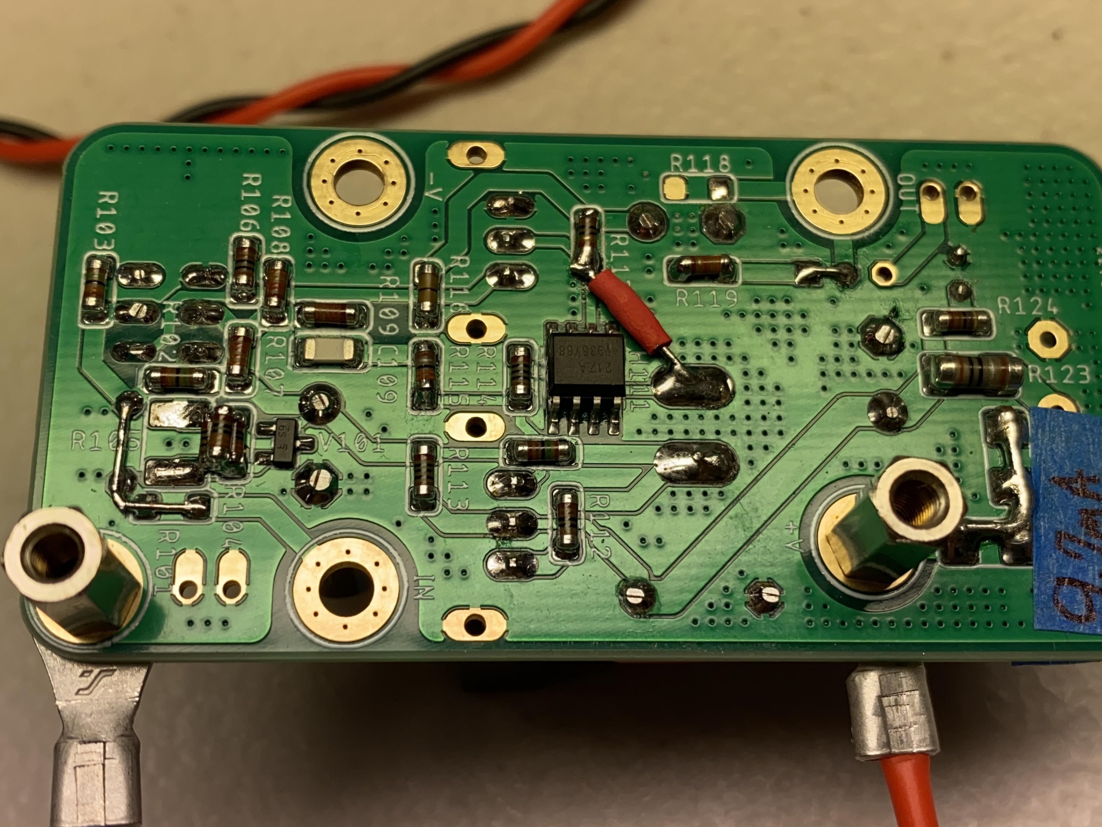

The ACP+ as designed is really for driving headphones. So the bias current is a rather high 150mA. It runs too hot with these tiny heatsinks.
dBel84 did the following changes to drop the current and it runs at 40C.
R111 = 3K
R115 = 3R2
R117 = 10R
I seem to recall these settings were for about 70mA bias current. Plenty as a preamp and even for higher impedance headphones.

We have just tested the ACP+ with the new reduced bias current settings. The current is now 75mA vs 125mA and temps are down to 56C at the heatsinks. Even at 75mA you can drive moderate impedance headphones quite nicely. As a preamp though, it can drive any input of an amp. We are noticing that it will take some fiddling with various values of trim resistors to set the bias current of the JFETs precisely. There are extra large pads there so you can add in parallel, values that can fine tune the bias.

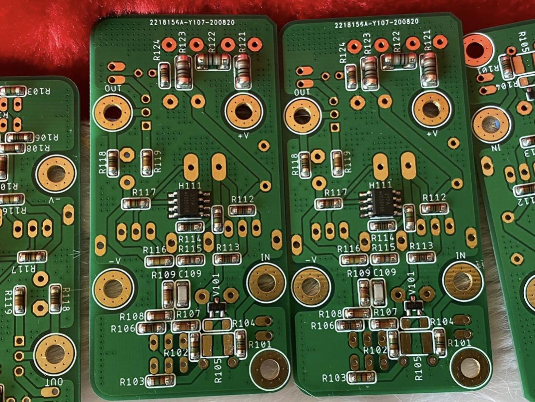

R105 pads were originally spec’ed for a mini-MELF resistor holder. It’s a socket that you can swap resistors in/out very easily. But the problem is I can’t get the holder in the US. SMD component holder for Mini-MELF | Burklin Elektronik

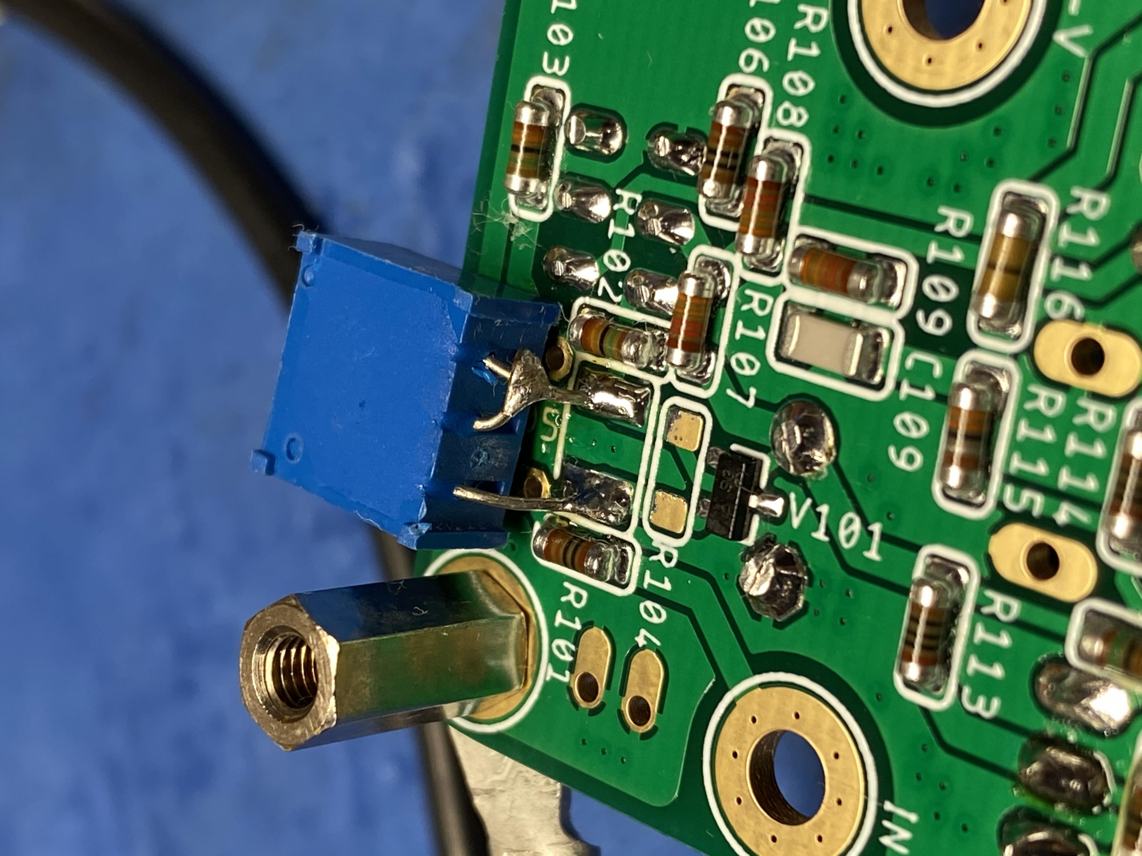

With a bit of creativity, your temporary 200R Bourns type trimpot solution soldered to the larger R105 pads will work. Adjust the trimpot to 125R before installing. The trimpot will be used to calculate the resistor that eventually will be soldered to R104 location once the trimpot is removed. Using this method, just one MELF resistor is installed instead of parallels.

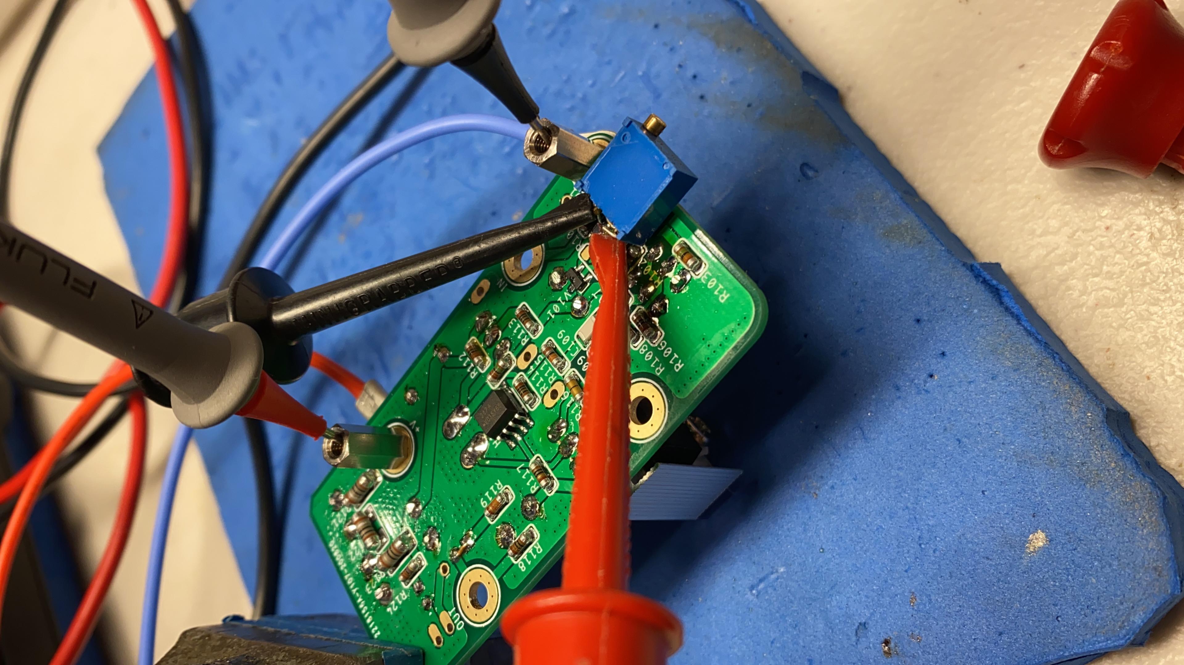

I built an ACP+ board today and tried the “trimpot mod” to dial in the 10mA across R104/105. I soldered the trimpot legs directly to the R105 pads, initial setting was 125R. Then tapped power directly from the Yarra psu and fired up the ACP+. With 125R bias was 6.8mA, turning down the trimpot and checking bias along the way, finally settled at 60R.
.612v/60r = 10.2mA Good Enough!
I didn’t have a ‘close to’ 60R MELF resistor, so I left the pot soldered to the board and installed the ACP+ in my Yarra. Singing away beautifully with a bit of traditional Christmas music to get into the season.
Note: There is no need to parallel resistors at R104/R105 if you get the exact value needed via the trimpot. Just install the resistor at R104 and remove the trimpot. R105 remains unpopulated.

A quick follow up question about setting the bias. My PSU measures at +/-26v under load. Will setting the bias at +24v from my bench PSU good enough? Or do I need to dial in the bias with the board in place in the amp?
Oh, and the boards look great!
Yes, that should be fine. It will scale linearly so 24v/26v will give you a bias that’s 8% below what it will be in the chassis PSU.
Thanks XRK971. I can adjust for 8ma with the bench supply at 24v, and expect 10 in the amp at 26. Much safer than having floppy wires from underneath in the amp itself.

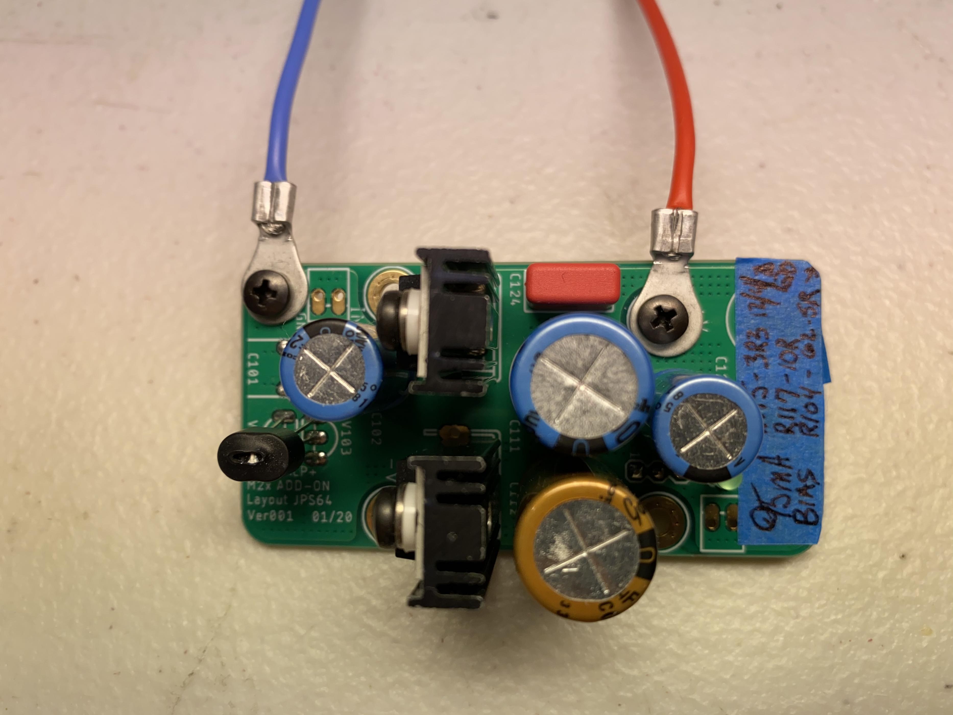

Hi Bones13,
Remove your ACP+ from the Yarra and make two power cables with a crimp ring terminal on either end. (Or alligator clips on both ends) Take power directly from your Yarra motherboard outside the chassis so you can work on your daughter board in the open. You will have the trim pot connected so you can easily adjust and test with your DMM for correct voltage to get the 10mA. If done this way, you don’t have to estimate the bias based on a different power source.
