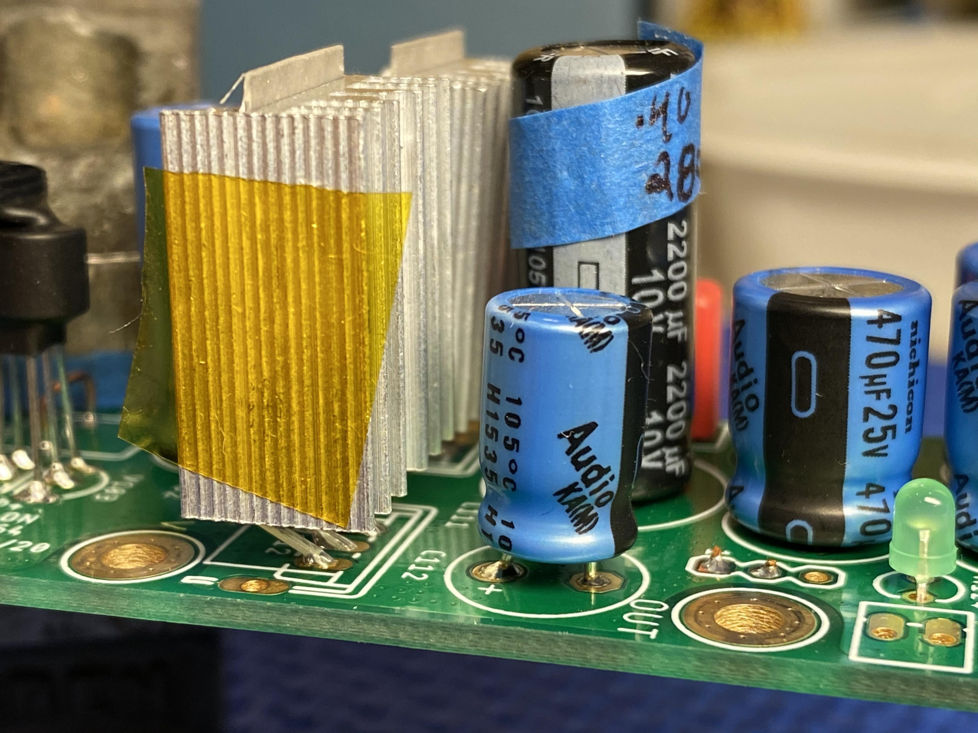

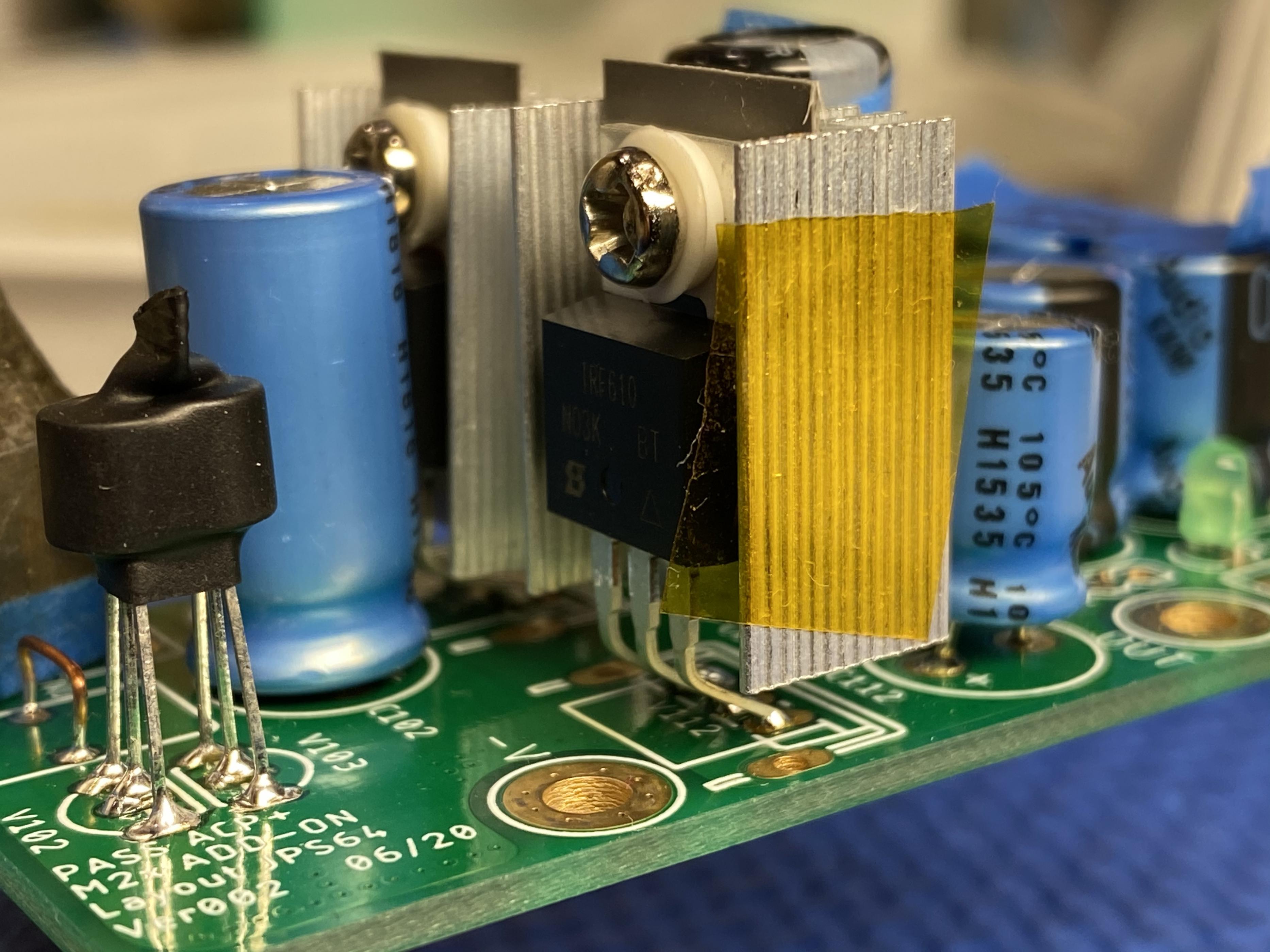

C111 can be reduced from 3300uF in size to give more room for HS clearance. Bend the Mosfet legs to move them forward. I found these tweaks to help a lot.
Thanks for that. It’s a good fallback position.I have the standard Nichicon caps in place. I’ll try some of the heat sinks that I have ordered, and decide if I want to downsize caps, and bend legs. Now, if someone, in Europe, were to get some of the specified heat sinks ordered for a group buy...

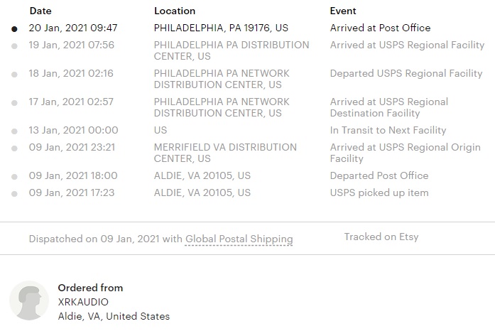

I still have not received mine.
Sorry about that, I think you are experiencing the Eastern Seaboard USPS delays that I experienced.

I got some smaller heatsinks with a 32 thermal resistance (vs the 24 of the specified Fischer heat sinks)
Will these be enough for the new lower bias setting? Or do I need to find some with a rating closer to 24?
The née lower bias is very helpful to get the heat down. Give it a try and see what the temp is.

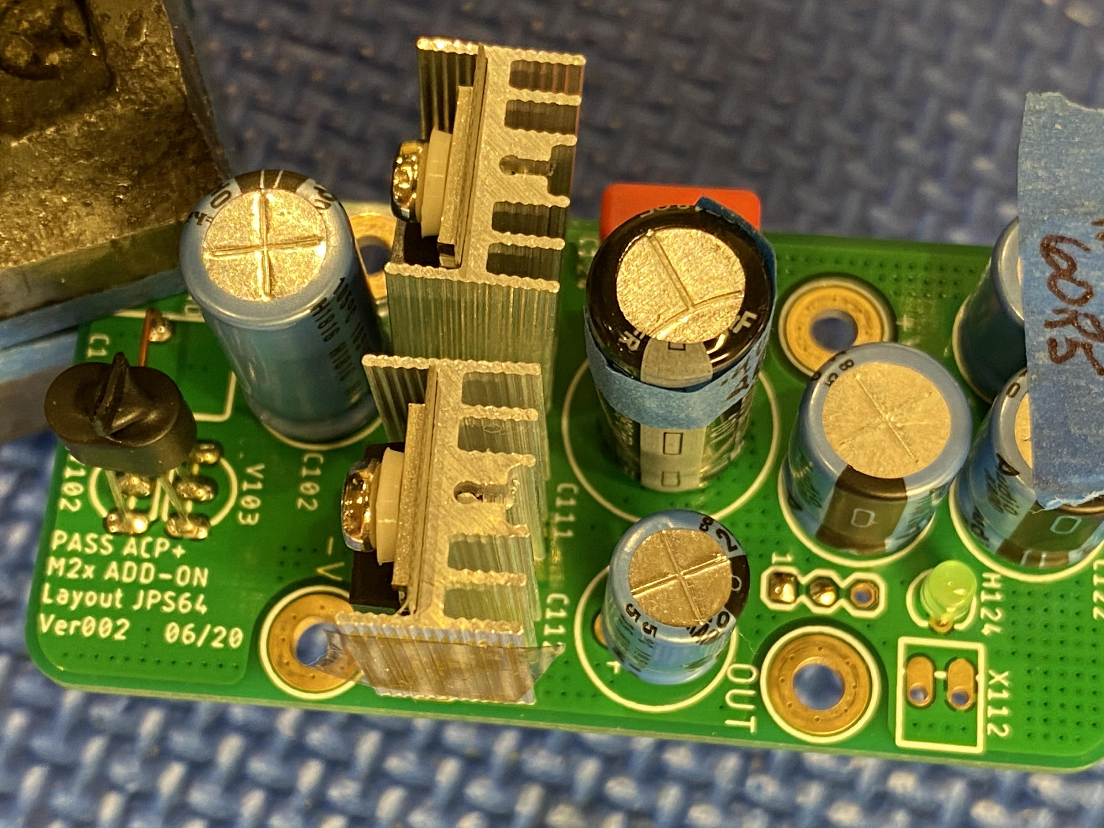

I plan to. I got the power bypass caps with the correct pitch for the Hakuin cards too. Next soldering session I get, I’ll finish Hakuin, and mount the output transistors on the ACP+, and try to figure out the final resistor with lab PSU, and potentiometer. I’ll try to remember to shoot temps.
Finished the Hakuin boards (all the possible SMT parts used) and the ACP+ boards. I did not have time to tap the PSU of one of the M2x units to power the ACP+ boards to work on the bias resistor before we headed off to the beach for the weekend. I will get there. Thanks XRK!

Getting that bias current through the JFETs set to the correct value helps to make it sound great. It’s not that hard if you use a trimpot and then swap to a fixed value resistor.

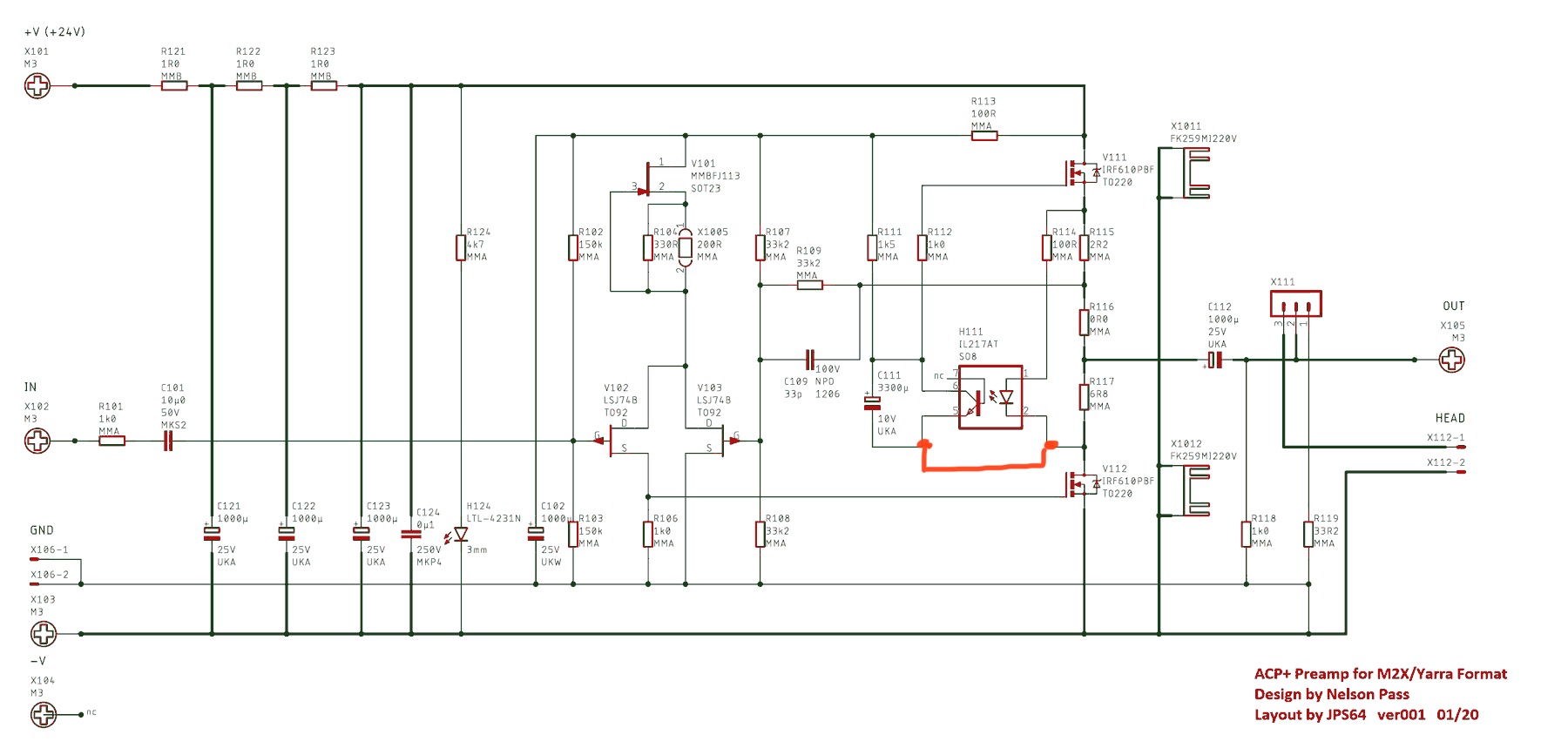

For us M2X users, I would appreciate any tips on how the overall gain of this ACP board can be adjusted.I think, as designed, it’s probably +9dB. I would like +5dB.

The feedback resistor R109 is between the output and the second JFET on the LTP.
This is a Pass circuit so maybe you would be better off getting an answer from the ACP+ thread in the Pass forum? If I were to offer any changes to the gain, I can’t guarantee it will be stable.
Typically making feedback resistor smaller in value will lower gain...

I noticed that Vunce jumpered C101. Is that the recommendation if using the Yarra motherboard?
I also noticed Vunce jumped something else with a little red jumper. Was that necessary only on the prototype board or is that something we need to pay attention to?

X111 should be jumpered 1-2 for headphones out. But if using as preamp, jumper 2-3 to give it a 32ohm load. The circuit ideally likes to be loaded to give the correct harmonic profile. But if you reduce the bias current, increase the on board load resistor accordingly. Probably 100ohm is fine for general use
Vunce bypassed C101 as the Yarra main board provided the cap coupling. Be careful when using the ACP+ elsewhere where there might not be cap coupled input.
