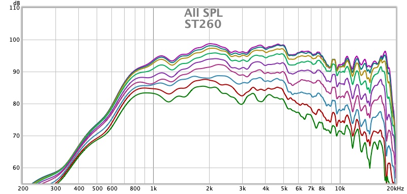

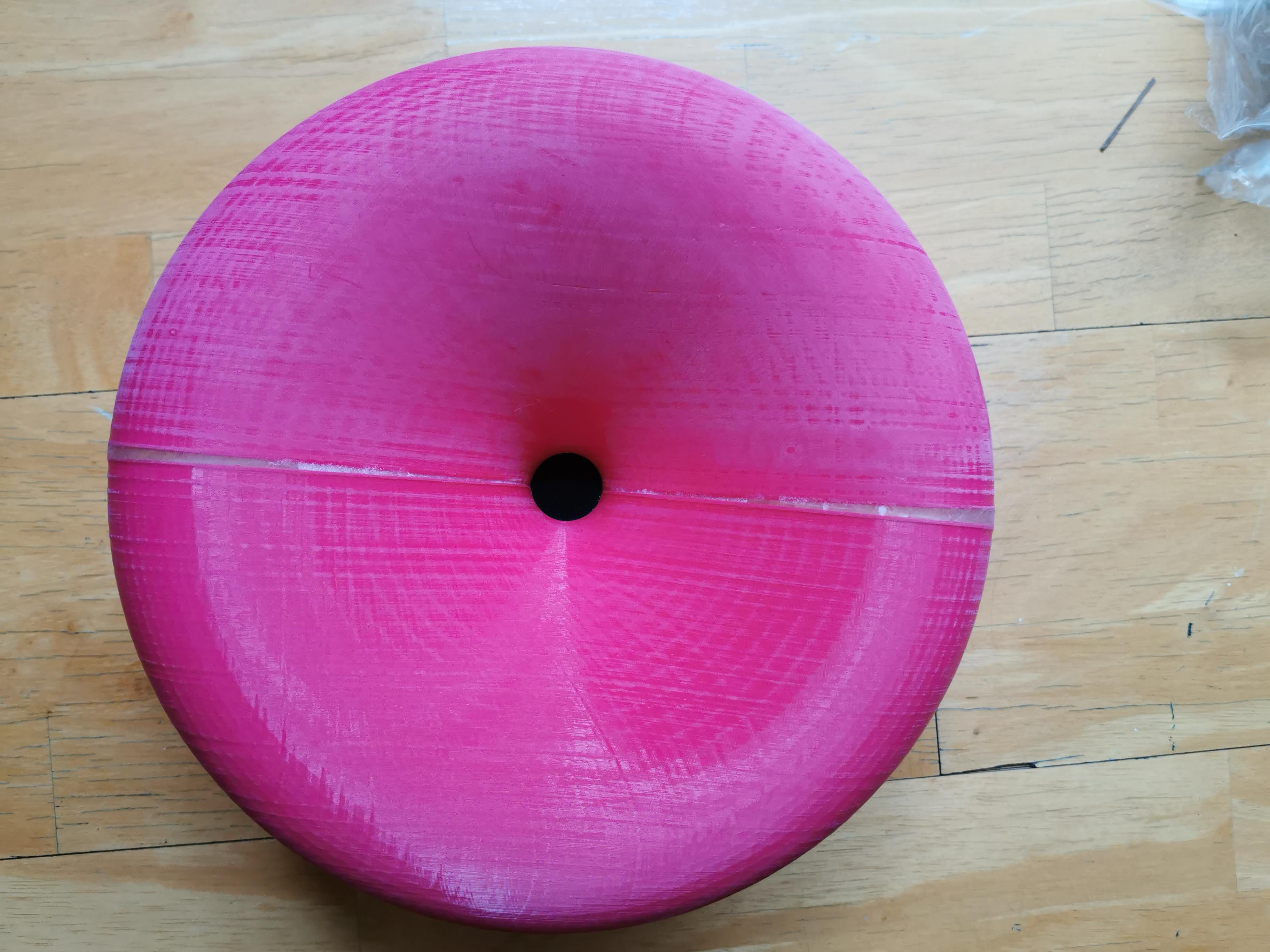

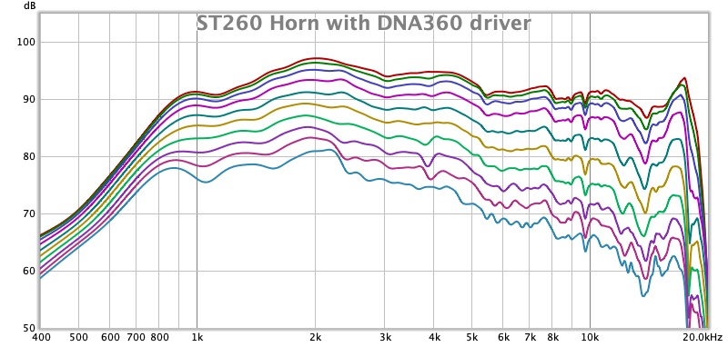

Print quality is not so good. On the first half it was bend but the second half is good. I glue both together and fill the gap with epoxy

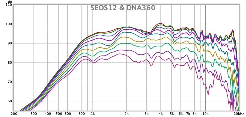

Here is the same driver with SEOS12 waveguide

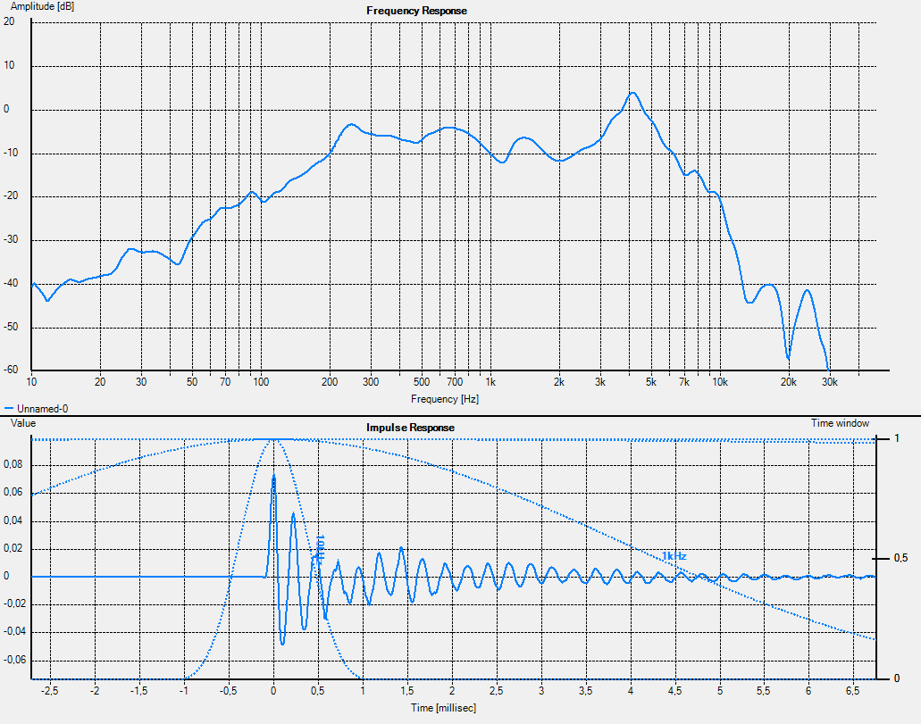

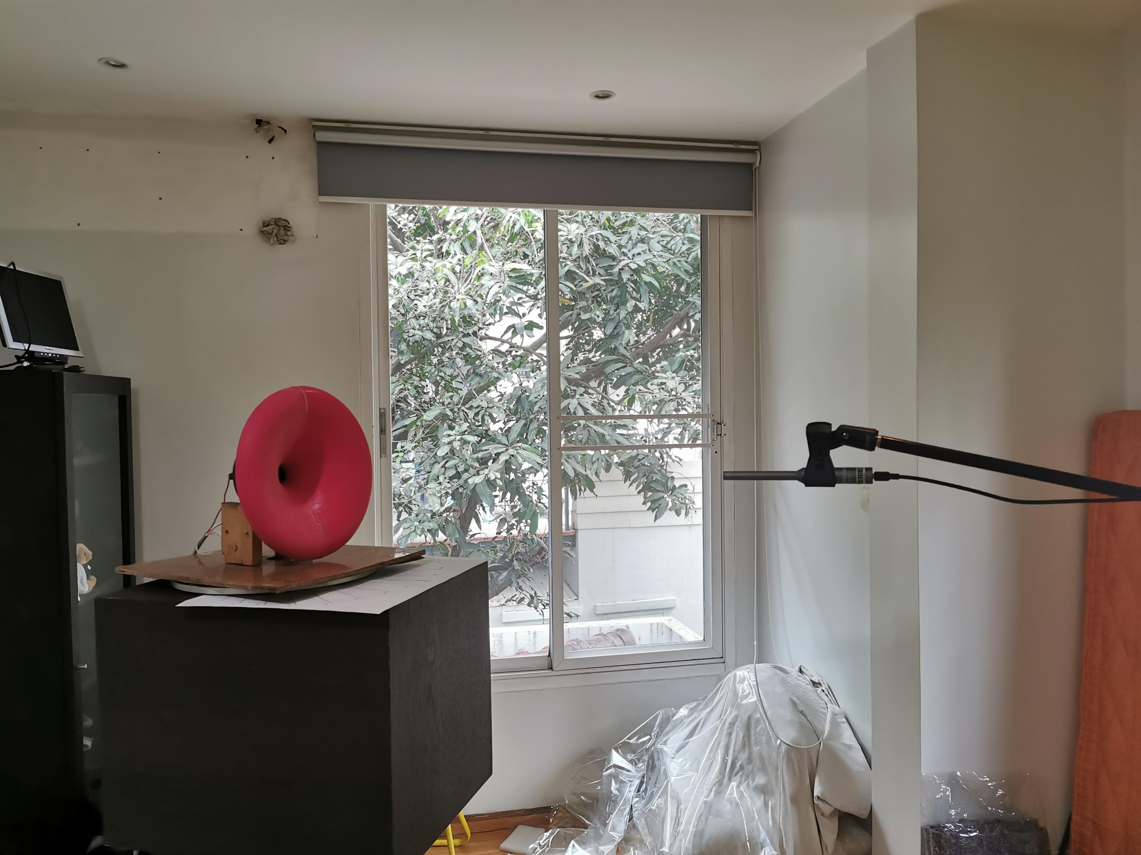

Do you use some kind of a frequency-dependent window? It doesn't look like time gated or simply smoothed but it's not anechoic either. What did you change?
I gated the response at 4.6ms, no smooth using REW. The first time, REW did not ask for calibration time, I didn't know why. After shutdown and reboot, everything seems to work fine. My set up is not the best there are reflection from box that I set up driver for measurement.
