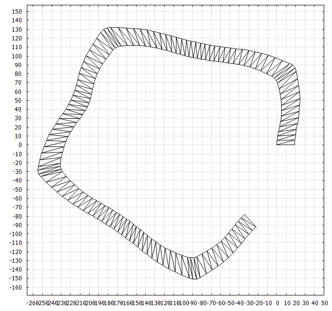

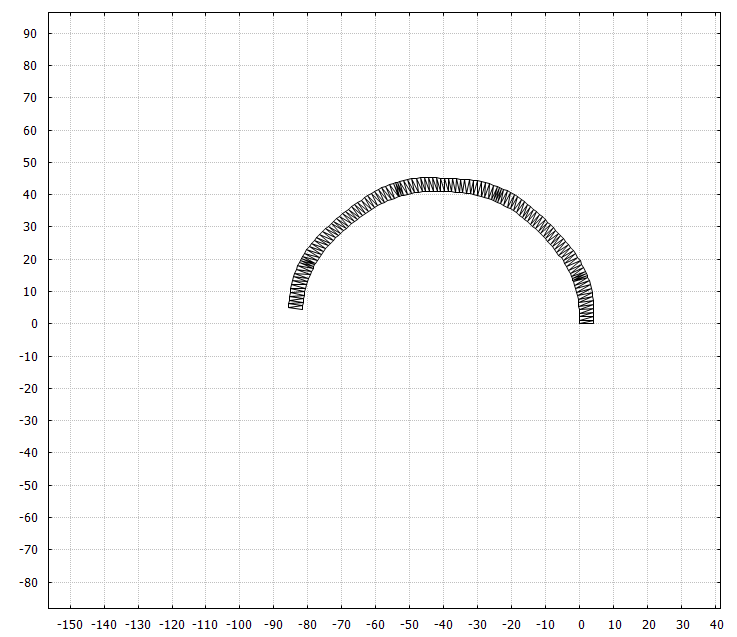

A poor man's way how to make a basic mould shape - from paper, with glue and scissors 😀

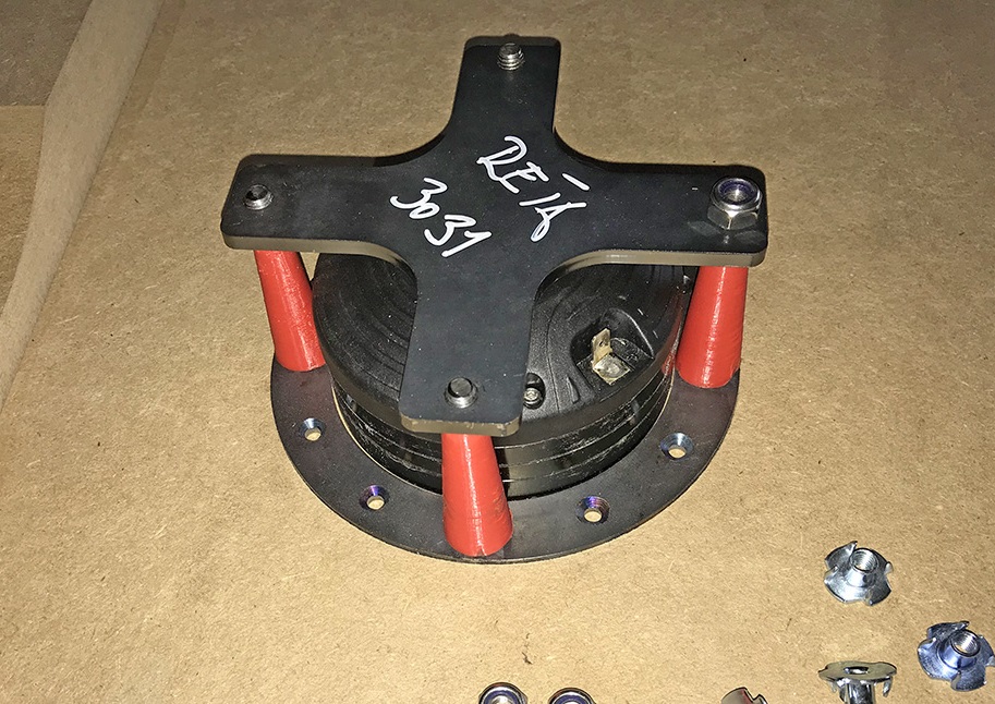

BTW, this is the mounting of the driver (designed as self-centering):

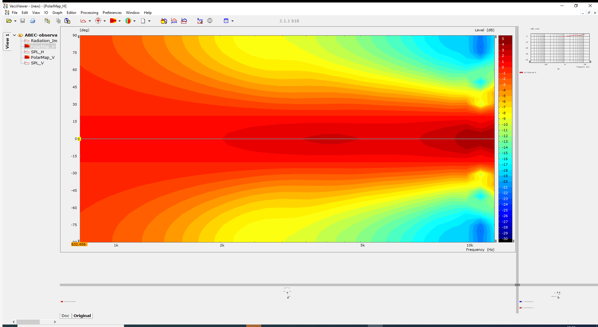

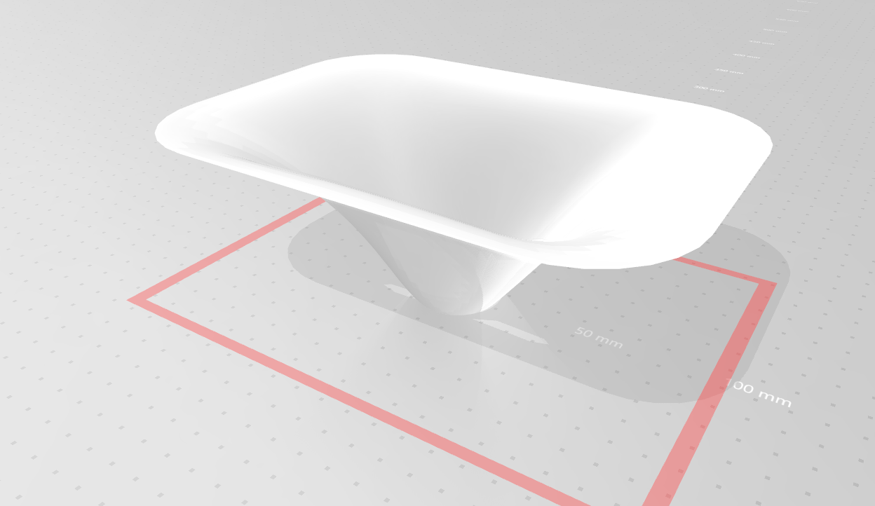

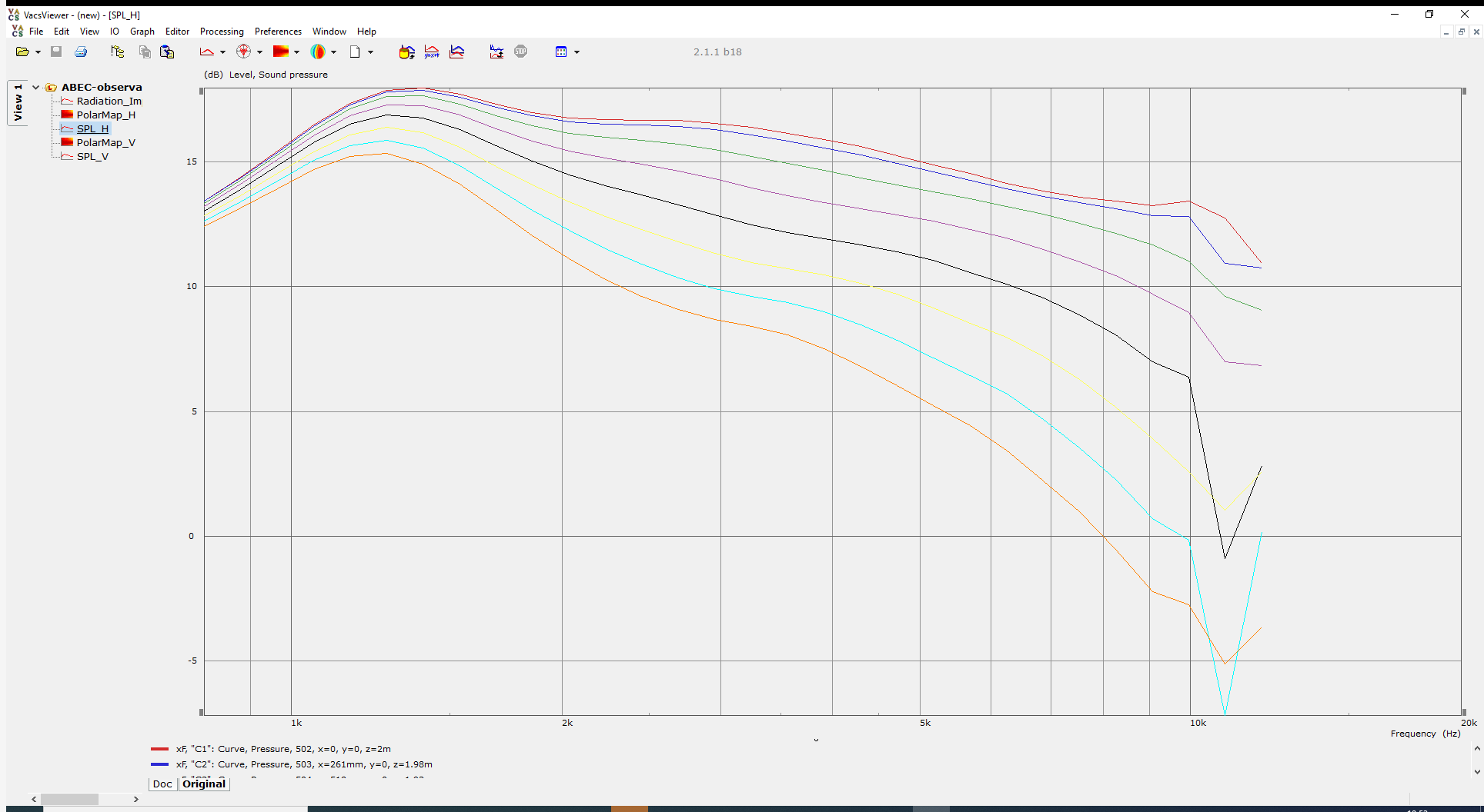

Here you see the ABEC simulation of the generated project file and also the generated STL file.

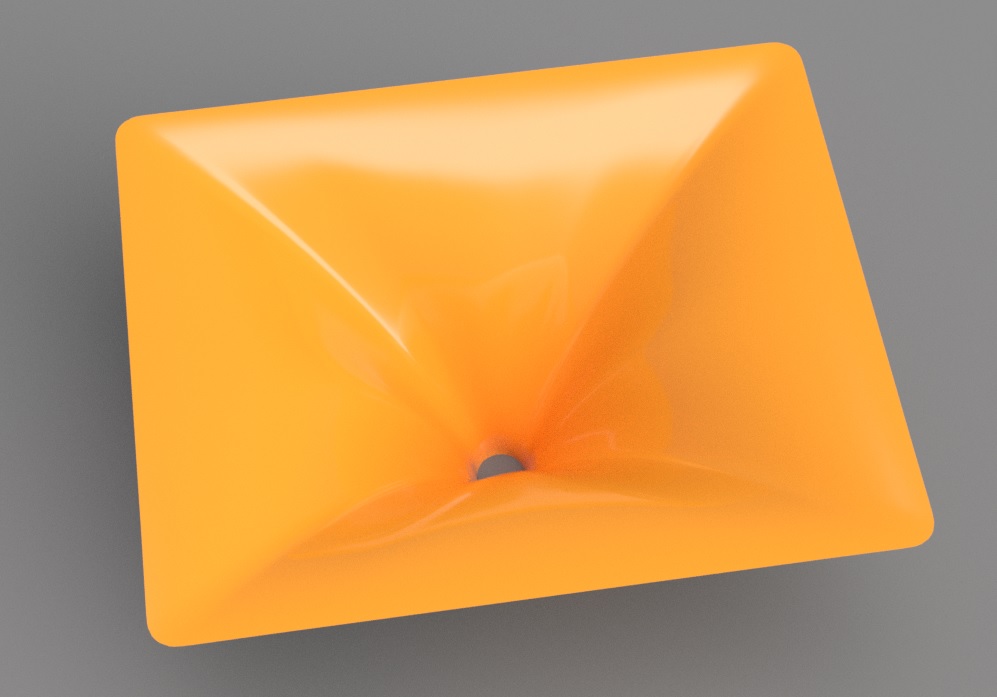

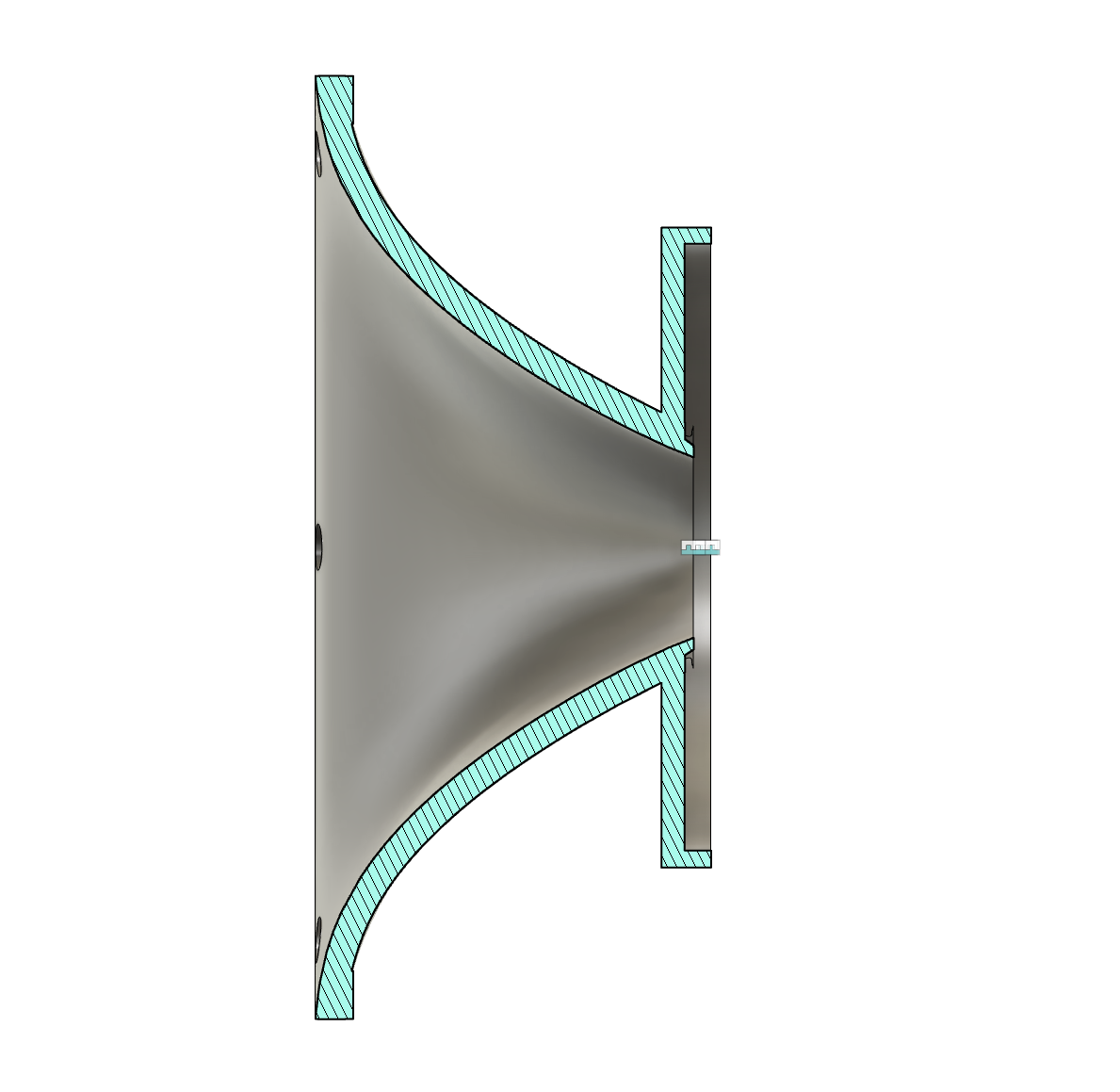

The Fusion360 add-in module were used to import the surface profile.
The profile were thickened by 5mm and I have added a mounting flange for the Seas H1212-06 27TBFC/G tweeter and also for attachment to the baffle.
I have removed the tweeter grille to get closer to the dome and the throat ID is at 31mm so it is covering about half of the surround.

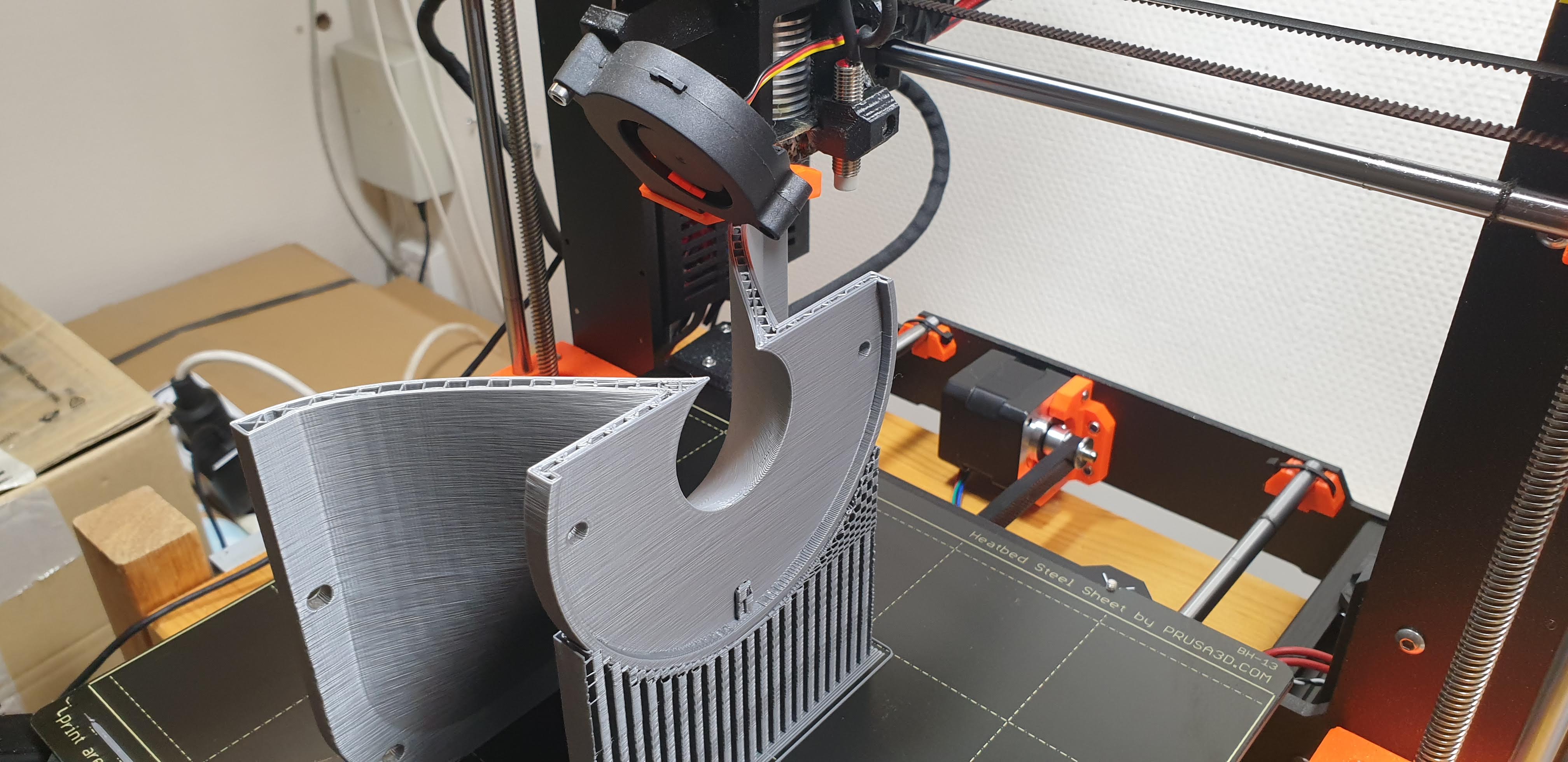

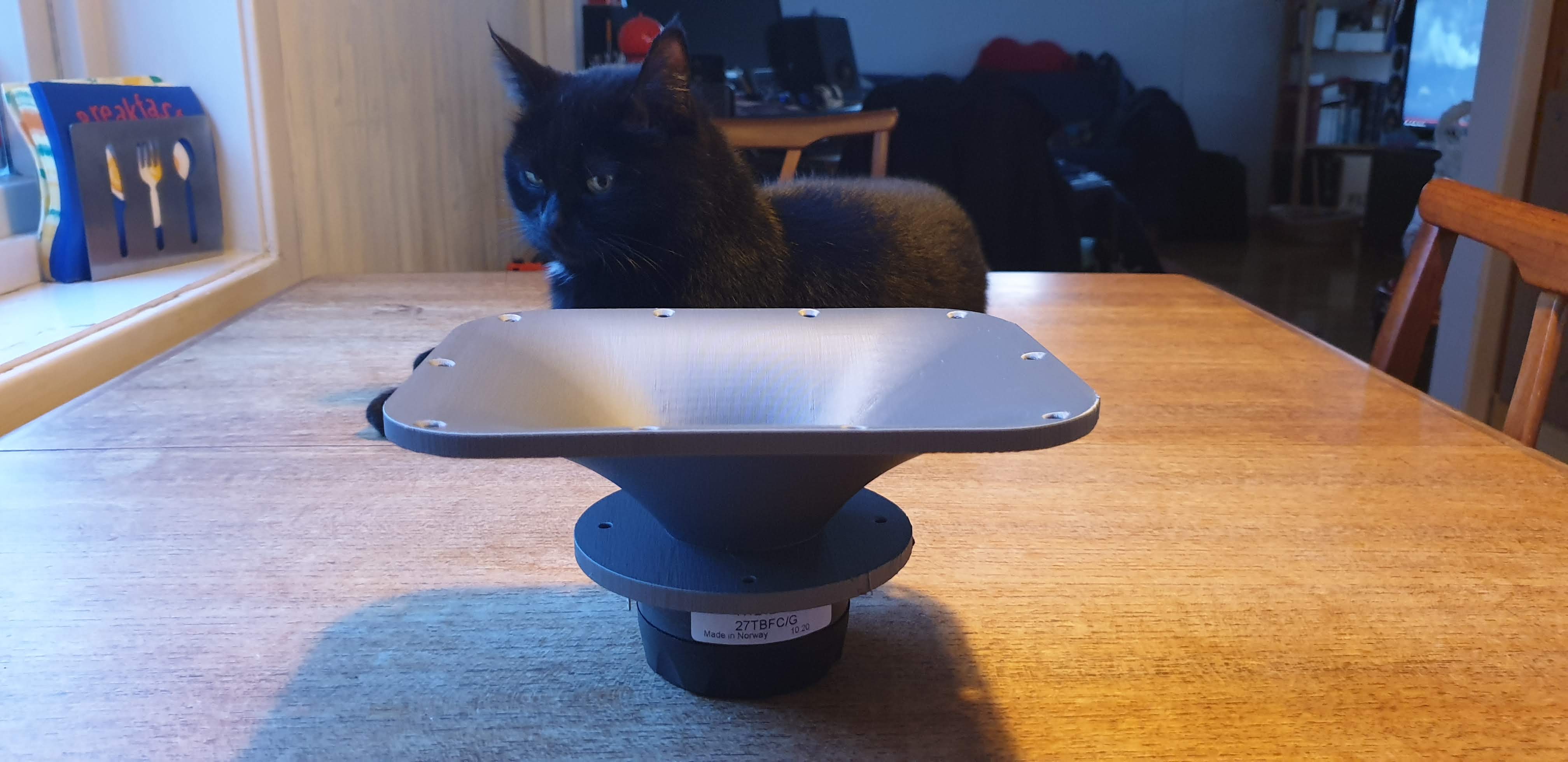

The model was printed standing on the short, flat side.
Support on the mounting flange.
Printing time was about 17 hours with a layer height of 0.2mm and a 0.4mm nozzle.
After assembly it was thoroughly inspected.

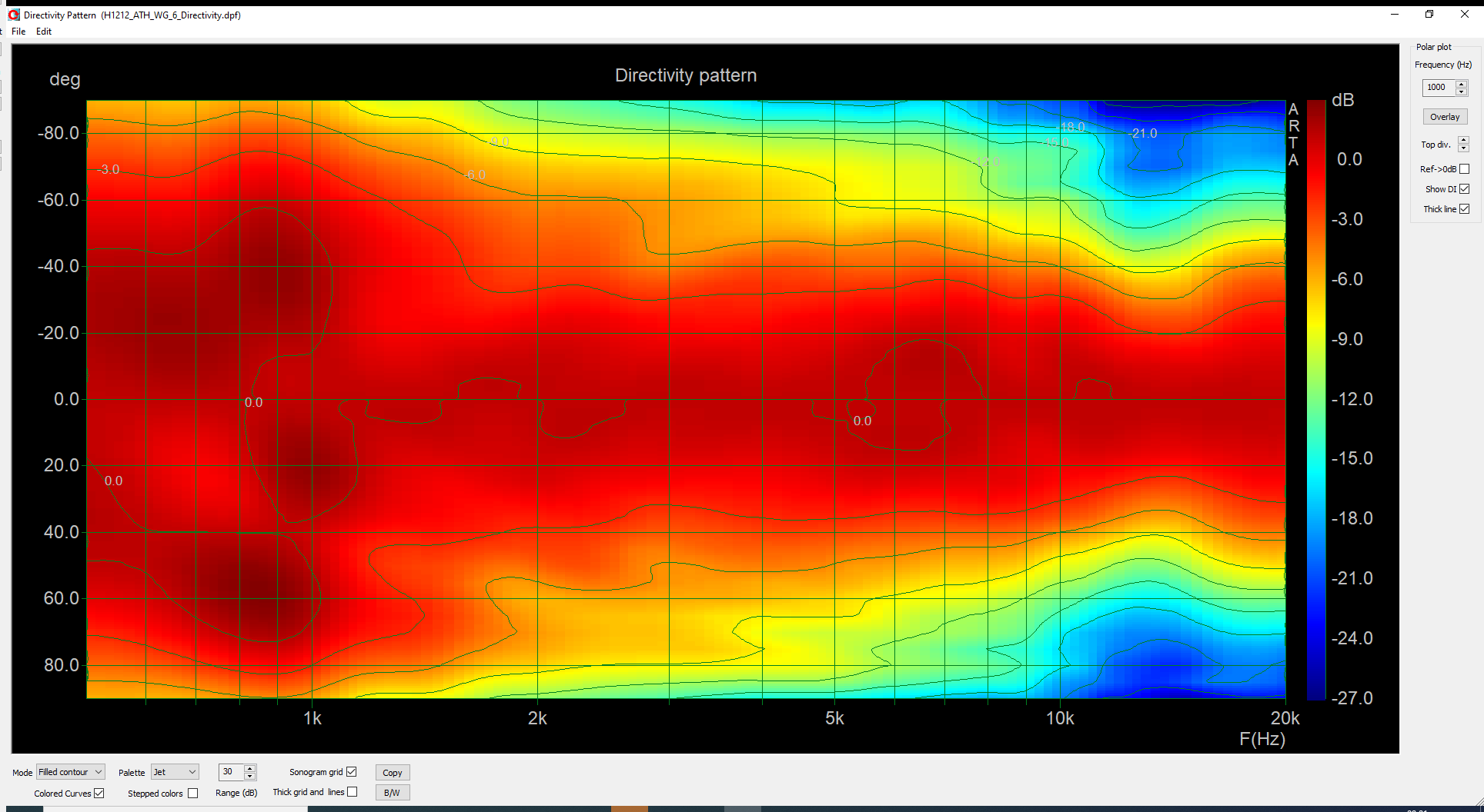

Then the prototype was measured in a 600 x 800 mm baffle using ARTA with a Scarlett 2i2 sound card and a MicW 215L measurement microphone.
Measurents are done in 10 degrees steps from -90 to 90 degrees.
Directivity plot is showing a 30dB range.
Is there a way to normalize measurements in ARTA, or are you using another sw for this?
Thank you very much for sharing, this is very interesting to see. Nice work.
Now it will be extremely interesting to see the simulation after you include the dome geometry in the throat (with Ath 4.6) - how good the match will be. So far my experience is that the surround of the diaphragm in the throat is not a good thing but then the measured data you show are pretty good, at least compared to what I have seen in the sims. It is also possible that the real-world situation is actually better than the with the theoretically rigid dome - that's one of the things to be seen.
