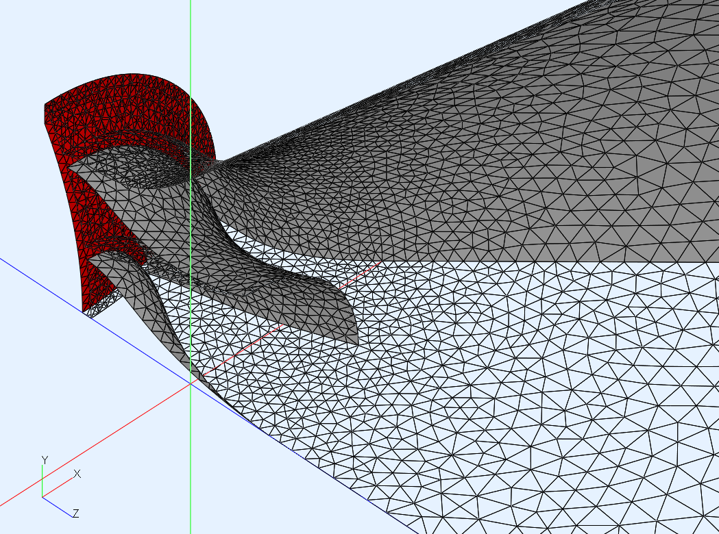

We are not at the same page here, I guess. Actually, the compression ratio for the above example is 8:1 as it is the total slot entrance area that matters, not the throat area (which is not even clearly defined in this case). And I really do think that if done as I suggest the velocity entering the waveguide (i.e. at the exit of the slots) is much more closer to radial than for the diaphragm alone.
Unfortunately my first attempt for a simulation ended a while ago for "out of memory"...
Edit: I checked again and it is in fact more like 7:1 as I made some changes in the meantime. For a home use I think it would be harmless to reduce it.

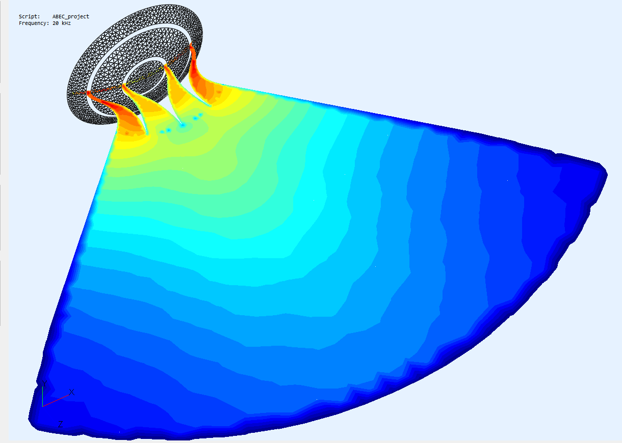

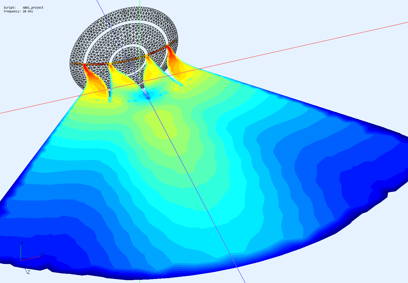

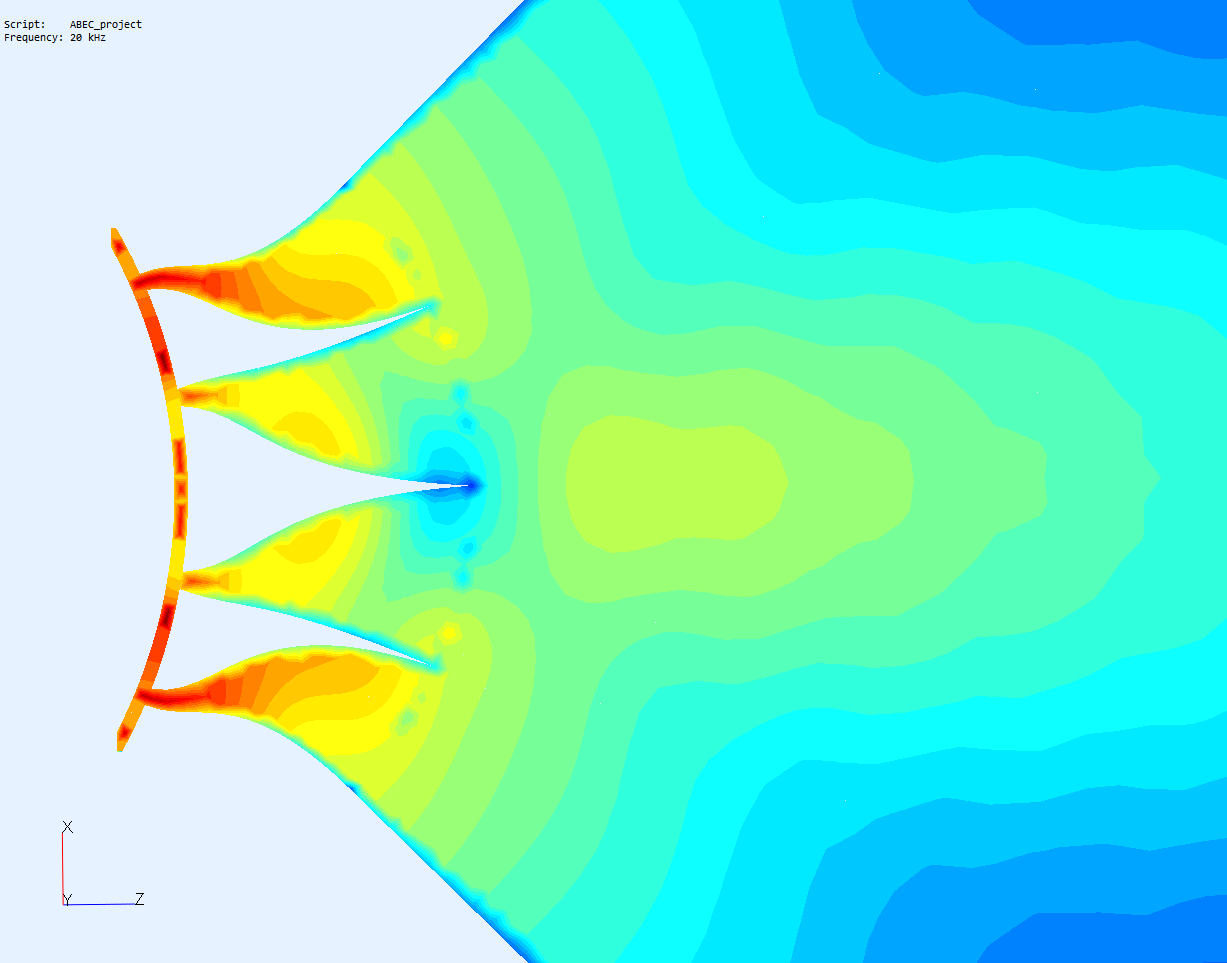

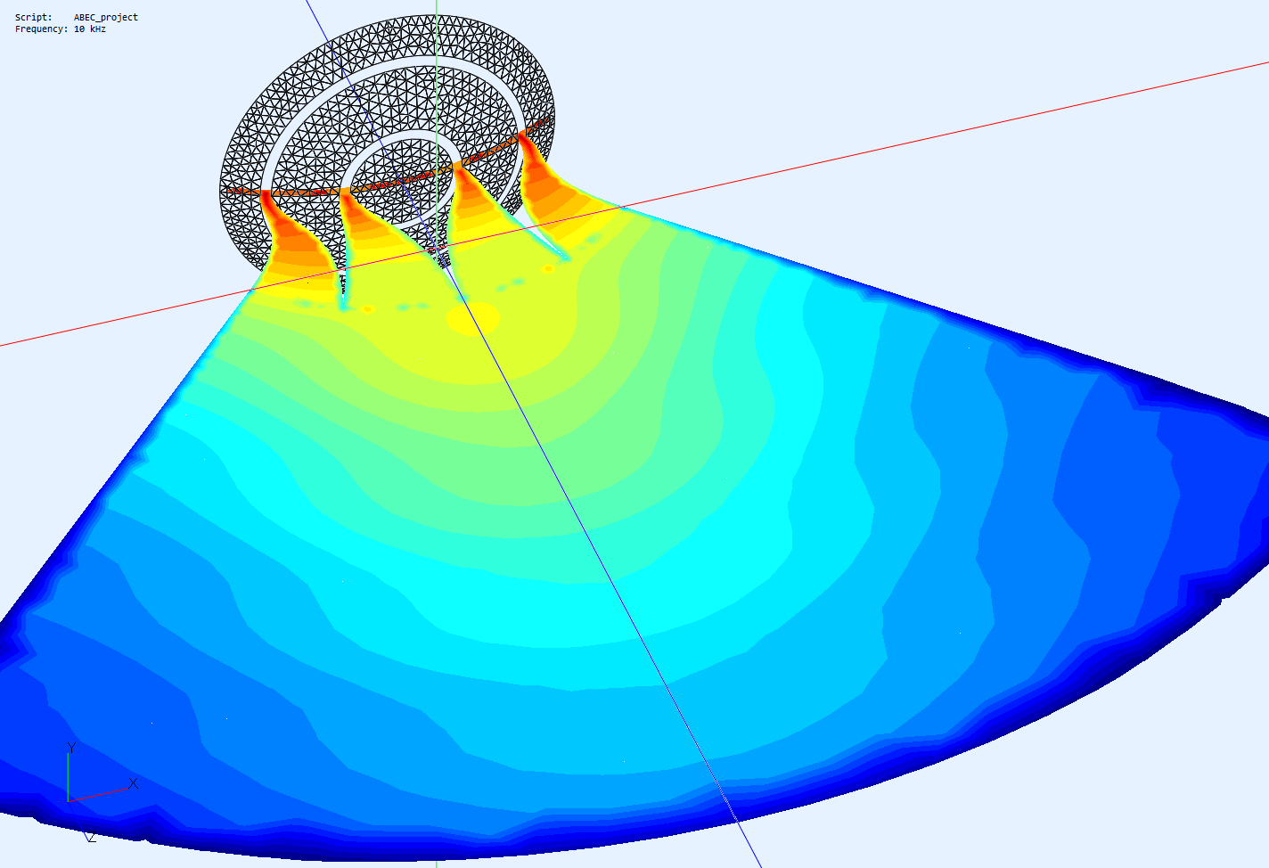

Regarding ABEC, I'm a bit frustrated right now as it seems that the field observation can't use the user provided mesh but uses always a simple plane instead that intersects the model rather randomly. Nevertheless, after dividing the whole thing into several subdomains, it calculates in an acceptable time. BTW, this is for 20 kHz on a 100 kHz mesh grid. The phase plug used is the most simple variant I could think of for the start - two slots, placed more or less randomly. Will need to use a still longer waveguide.
Maybe a polar map from somewhere inside the waveguide will be a better presentation.

ABEC3 enables to import field mesh. Picture below illustrates field calculation along horn-like plane.
Btw, it is also worth a try to use another meshing algorithm than Delaunay triangulation. I often use GMSH "packing of parallelograms" triangulation, which quite often ensures a value of "Free term" closer to 0.5 even if the mesh is coarser than Delaunay mesh. Sometimes this trick helps significantly reduce computation time

ABEC3 enables to import field mesh. Picture below illustrates field calculation along horn-like plane. ...
I omitted the "Mesh_Properties" section.

OK, this will be fun
(color division 1 dB)
You're really up to something special!
When I get back, you've probably experimented with the center channel 😉

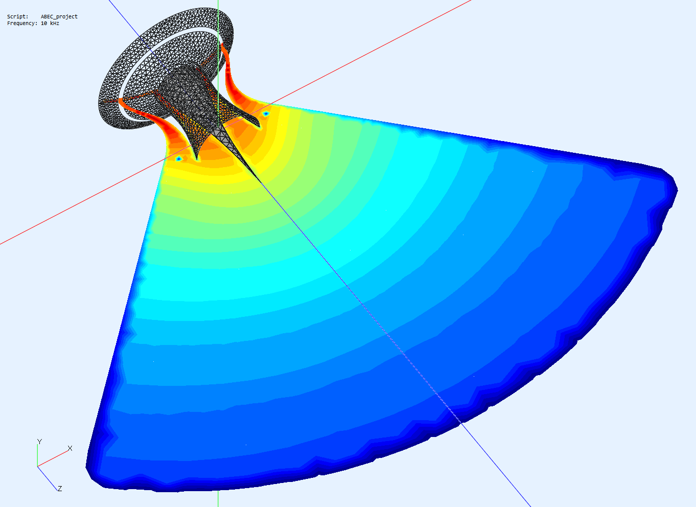

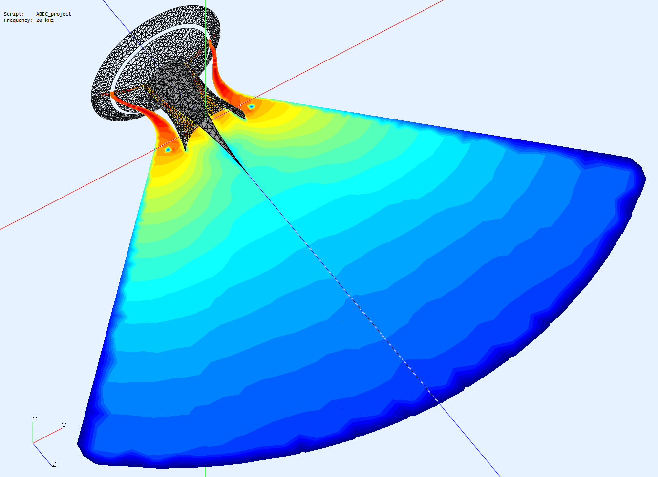

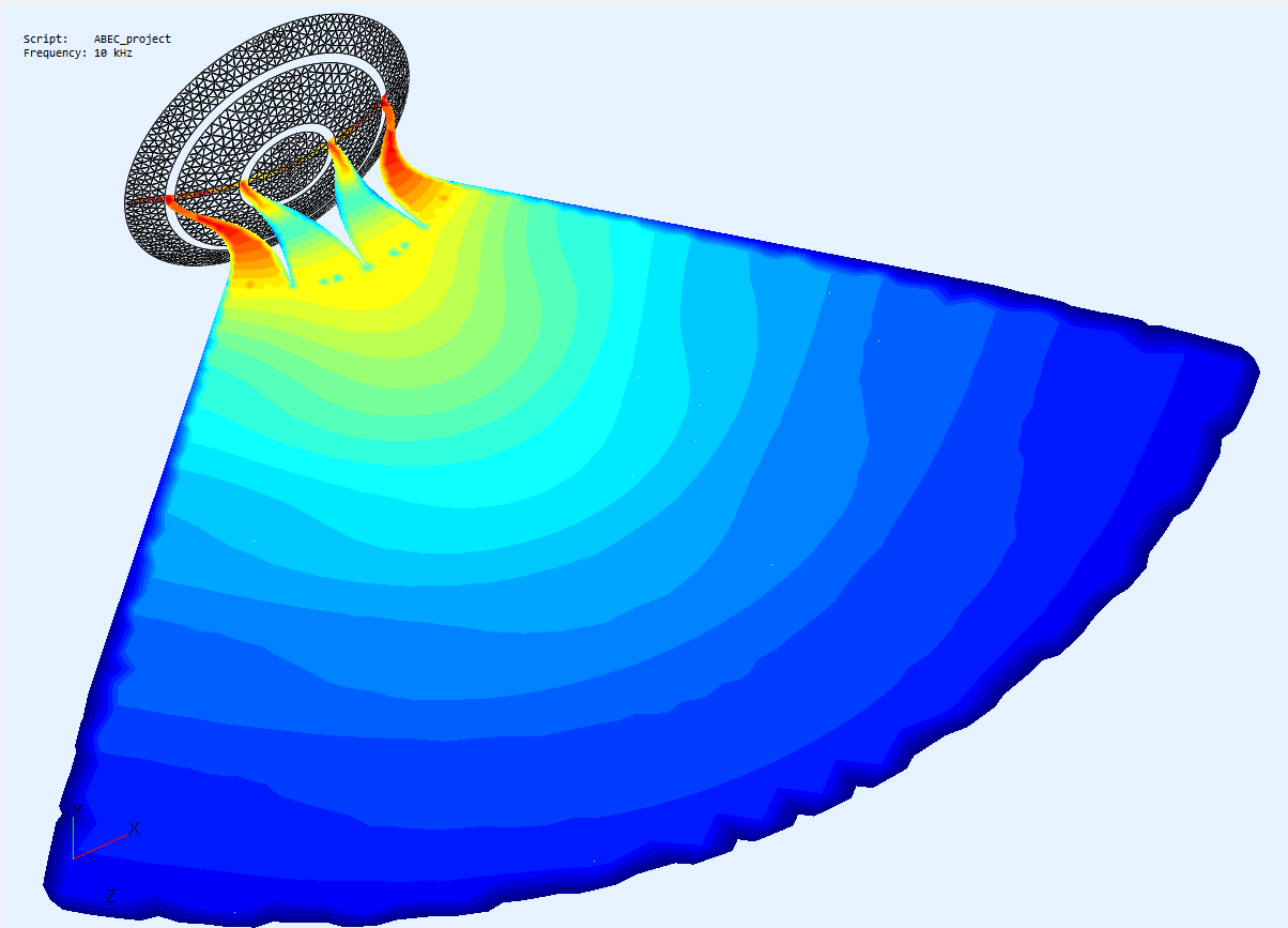

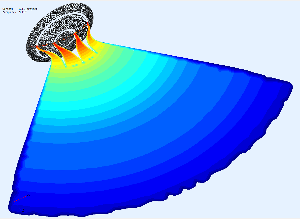

Yea, something about the center channel needs improving. I'm at the very beginning now. It will take some time to acquire the right "hunch". The outer slot seems to be working quite well though.

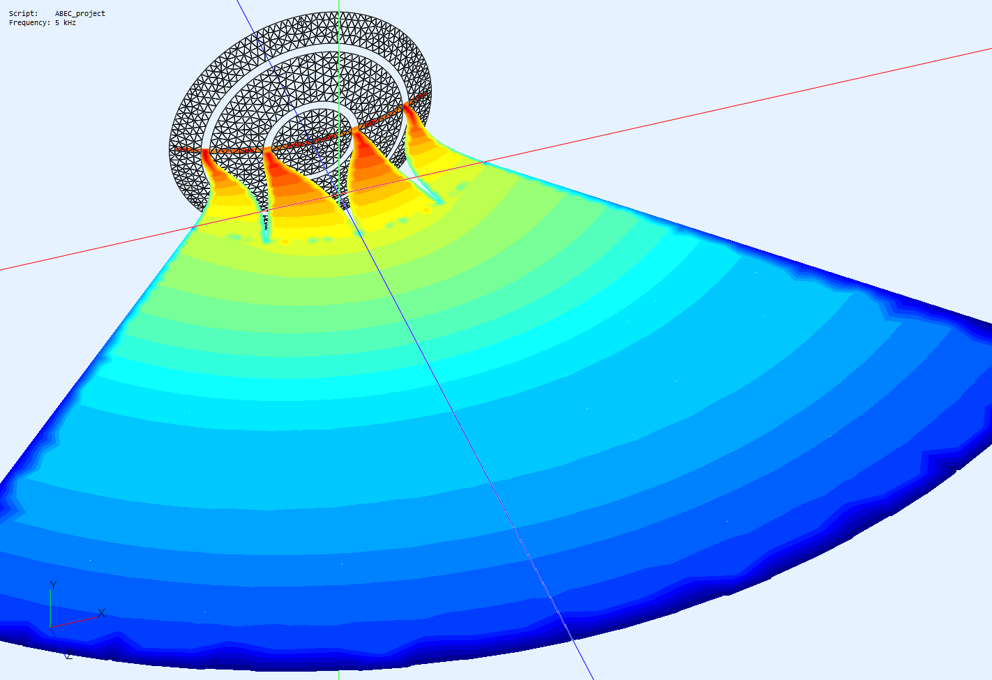

I'm thinking about splitting the inner slot into two towards the diaphragm at about half of its length, making a tree-like (fractal) structure.
Or maybe three slots would just make it.
BTW, the elliptical entrances are quite feasible with Gmsh and it would add no additional cost in the end.
Or just add a central sting - 10 and 20 kHz
