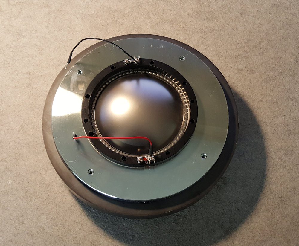

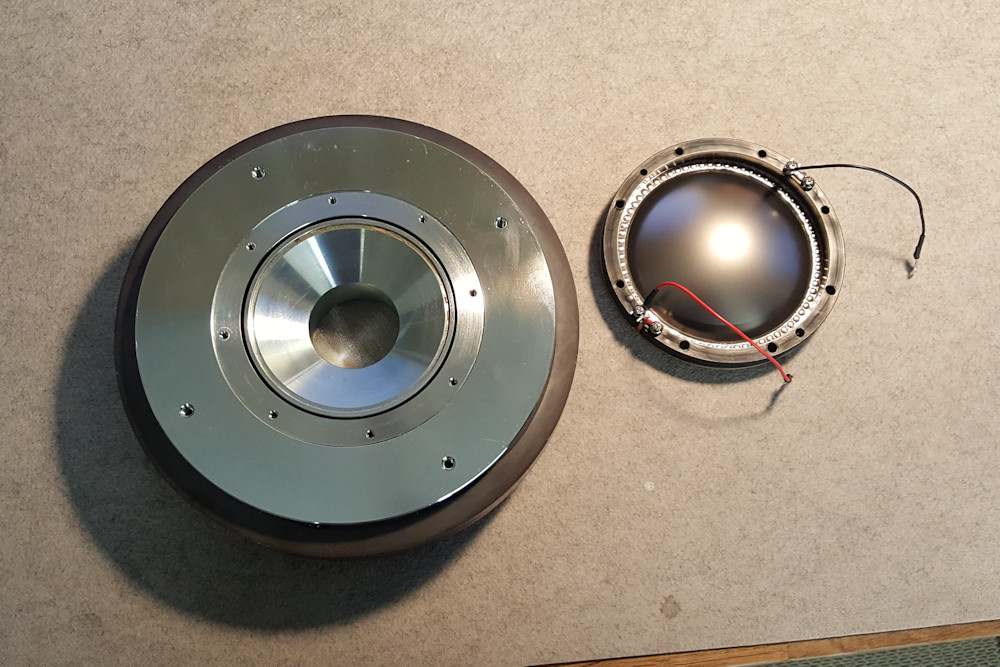

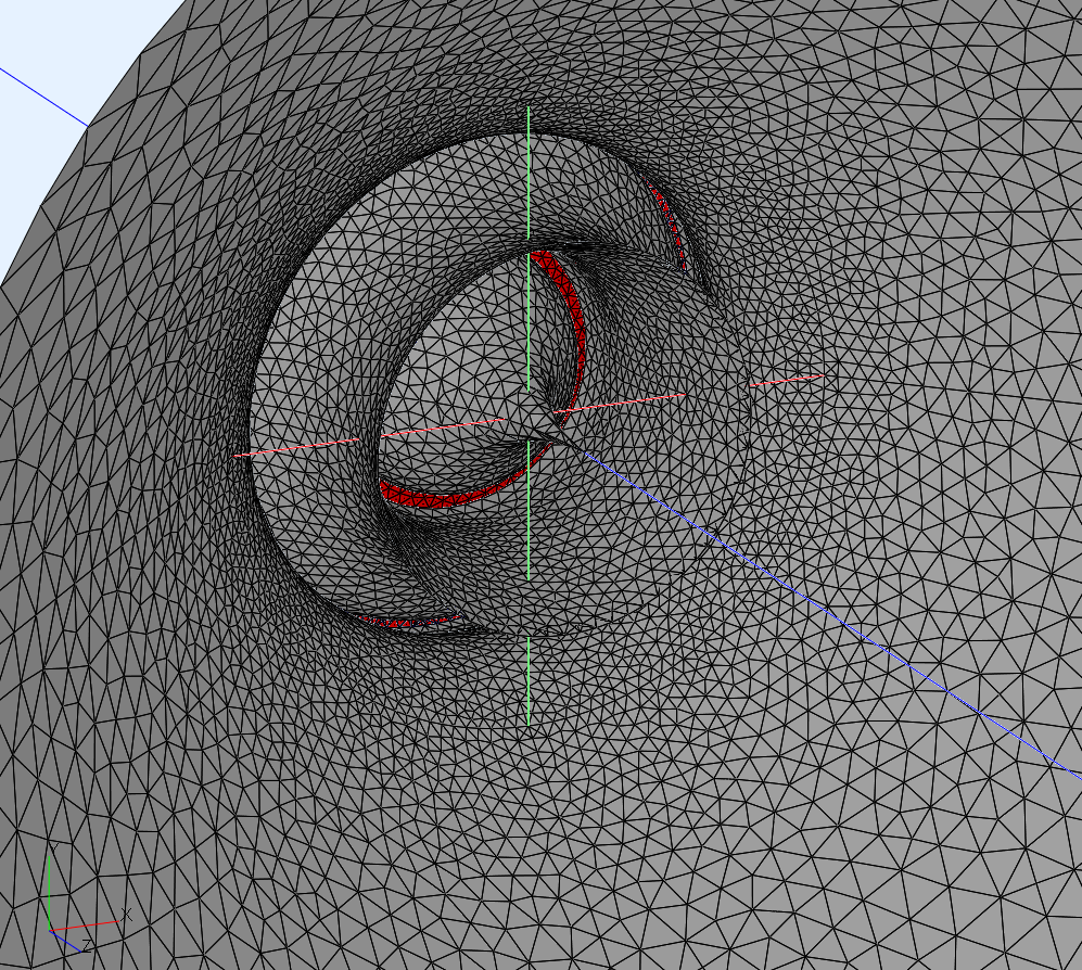

Yeah, that is very much how it would look like when seen from outside. Now the question is whether the dome behind is convex or concave. If it was convex, I'd be most interested to see their results. Based on some of the images I think it will be the conventional design though.
- Ah, now I noticed the photo of the back side of the phase plug. Then it is the conventional design where a flat exit wavefront is the target.
The HF plugs in the first post are chalice shaped, but since the horns are "Salmon type" and the plugs are designed to work with these (slow opening) horns, they are slightly different from yours.
The (mid range) plugs in the second post are (very) different and more conventionally shaped.
So far I've only seen plots of the bass and low / mid horns (up to 800Hz) and those are horribly flat.
In short, I think you are on the right track with your principle.

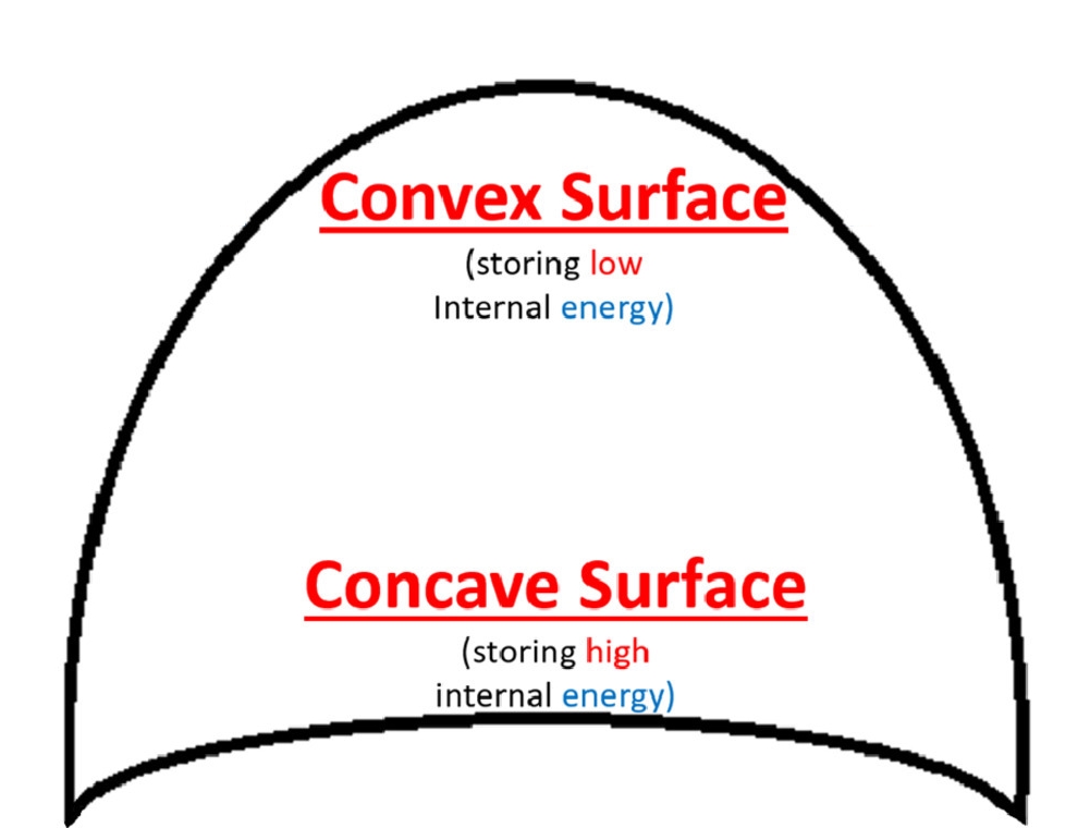

Guys, it is the convex diaphragm that makes all the difference here. It allows for (something like) a spherical wavefront that can be matched to a pure conical waveguide. This would be the best of all worlds situation.
The reason why you don't see this with conventional drivers is that you simply can't reach this goal with a concave dome - the path differences are simply too large for that. At least I haven't seen anybody really making it. So it is the flat wavefront that is being taken as granted. It doesn't have to be that way.

We are not at the same page here, I guess. Actually, the compression ratio for the above example is 8:1 as it is the total slot entrance area that matters, not the throat area (which is not even clearly defined in this case). And I really do think that if done as I suggest the velocity entering the waveguide (i.e. at the exit of the slots) is much more closer to radial than for the diaphragm alone.
I'm with you here as well. I am not sure what Art is thinking.
And I do agree that your idea has merit, but here is my prediction:
1) it will likely never be tested because building one presents a lot of complex issues that will make a prototype very expensive.
2) if is not very practical because it requires a fixed waveguide and as the marketplace will tell you, one thing that people never seem to agree on is what is the best horn/waveguide. That means that "interchangeability" will continue to rule the market.
3) in the end it will all make little enough difference that it will simply go away into the woodwork.
It's a nice idea to try from a theoretical point of view, but wide acceptance is highly unlikely.

i thought most compression drivers the "acoustic output" is from the concave side of the diaphragm, no?
but i could be misunderstanding what Mabat is saying.
also why would a fixed waveguide be required because of a phase plug redesign? i thought the concept was to make the drivers output be a flat wavefront so that any number of waveguides could be utilized?

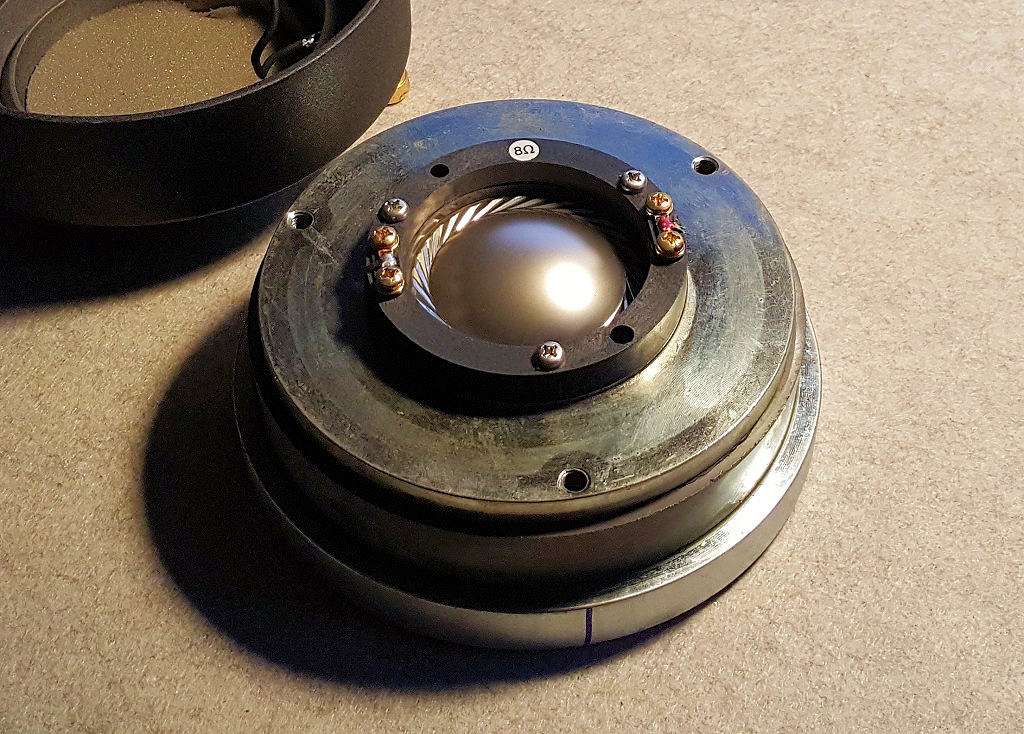

I have these two lying around, free to experiment with - 4" and 1.75" diaphragms. Haven't tried yet to remove the original phase plug on the smaller one. BTW, what would be the consequences of keeping it there?I thought about that as well and looked at some drivers. It won't be that easy and the phase plug from the other side will have to be removed, which, in some cases isn't too hard. ...
I would expect, owing to the compression ratio on the concave side, that any impedance on that side will be amplified. So any compliance, or mass, or reflections, will all be amplified by the compression ratio. Hence, unless this impedance is negligible, it's effect could be dominate.

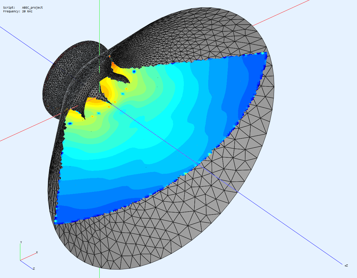

Regarding ABEC, I'm a bit frustrated right now as it seems that the field observation can't use the user provided mesh but uses always a simple plane instead that intersects the model rather randomly. Nevertheless, after dividing the whole thing into several subdomains, it calculates in an acceptable time. BTW, this is for 20 kHz on a 100 kHz mesh grid. The phase plug used is the most simple variant I could think of for the start - two slots, placed more or less randomly. Will need to use a still longer waveguide.
Maybe a polar map from somewhere inside the waveguide will be a better presentation.
