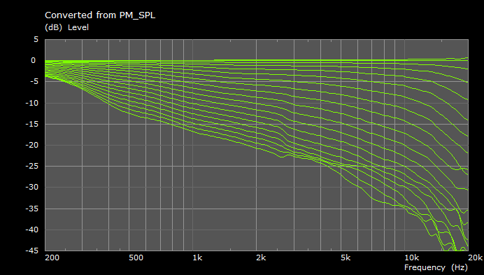

... I think that around 800 Hz there still must be basically only a beamwidth narrowing, i.e. no strong lobes, just a narrowed width of the main beam (which is what we want; otherwise it wouldn't be usable, of course). (?) And because it's not so much larger than a single 15", I would not expect a large difference overall. It would be close to a single 18", and those are not big differences. Certainly we could do with a single 18" in terms of midrange directivity. The bigger waveguides can be used down do 600 - 700 Hz without any issues.

It's the same as for a large diaphragm. You can think of a diaphragm of an 18" woofer as multiple smaller diaphragms, tightly packed together. You can then move these sources a bit apart and it makes virtually no difference, as long as the wavelengths involved are still long enough compared to the dimensions of the sources. This would probably need a simulation to see better if 800 Hz is already too high or not in this case. The "slightly different arrival times" across that area is what makes the (narrow) radiation pattern after all.

I think you'll see much more rapid pattern-narrowing in the 400-800 Hz octave with the 2x2 matrix of 10's than with a single 18. But again, that may be a feature instead of a bug! Which would be GREAT... so I'm hoping Earl sees this and comments.

Above 1/4 wavelength spacing the drivers will begin to interact with each other and not radiate as one single sound source. For 4 tightly packed 10" woofers this would be somewhere around 400Hz. Above 400Hz there would be increased interaction and a reduced beam width as a result. A simulation would make it easier to "see" but as the core issue is based on physical spacing and membrane size a calculator is good enough to work out where the trouble or feature will start.

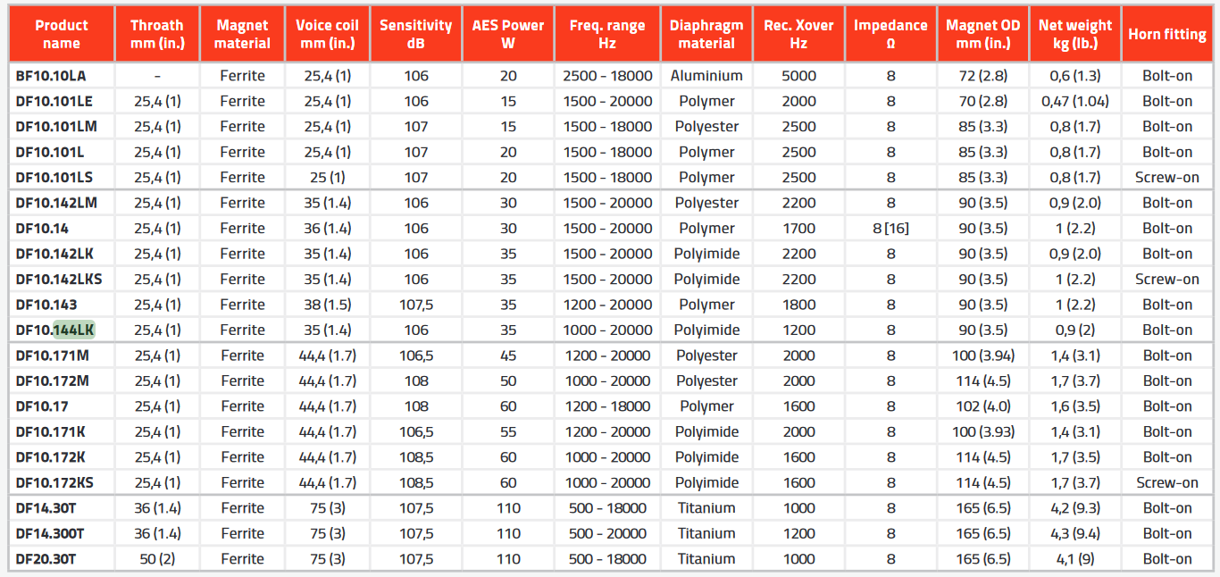

Yeah, it has the lowest recommended Xover from their whole 1" catalogue -
It would be interesting to know how they actually specify this / determine the number (if it's not a typo).

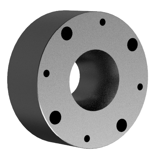

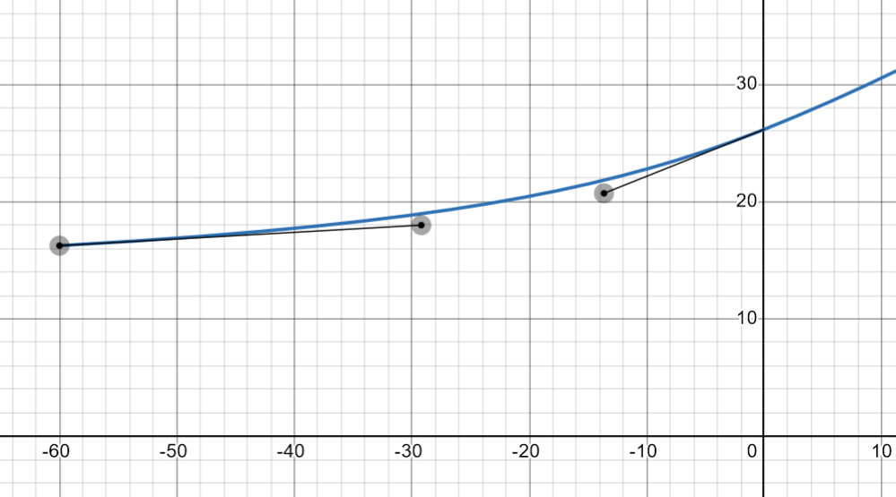

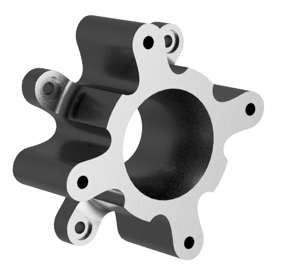

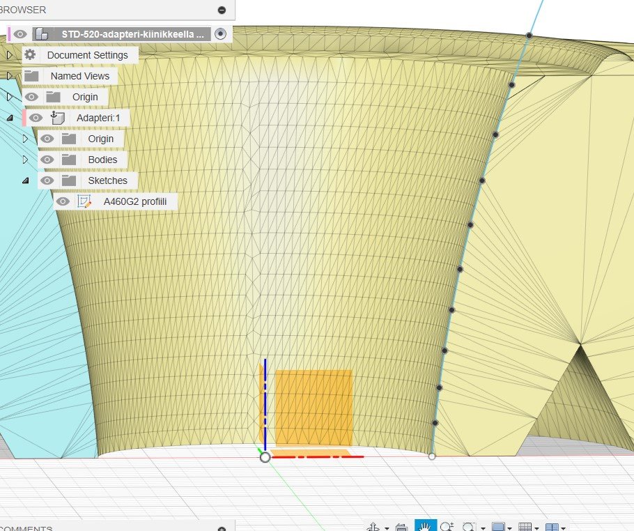

How do you actually make these adapter profiles? any chance to get Ath script / profile for this ND3x adapter so I could revolve my own adapter in fusion?
I recently bought the A460G2 and STD extension adapter for 1.4" driver, but would very much like this optimized version as it exists now. Issue is, I'm customizing the extension adapter a bit for mounting points. I did this using A460G2 ath profile and got the rest by slicing the STD adapter mesh and made my own compatible adapter in fusion. which was quite lot of work 🙂 I guess I could smash it all together in slicer as well, but if the adapter profile is available somehow it would be cool. Thanks!
I couldn't find description how the throat.ext.ctrl part is formulated, also I don't have parameters for the exit section of the driver so' I'd rather buy this ready made kit. The mesh file is pain to edit, so the profile for this one I'd like, to be able to make custom version of the adapter.
I have understood rest of the device would be the same and only the adapter portion changes and haven't had time yet to play with the scriot to find out how it works regarding with the extension part.

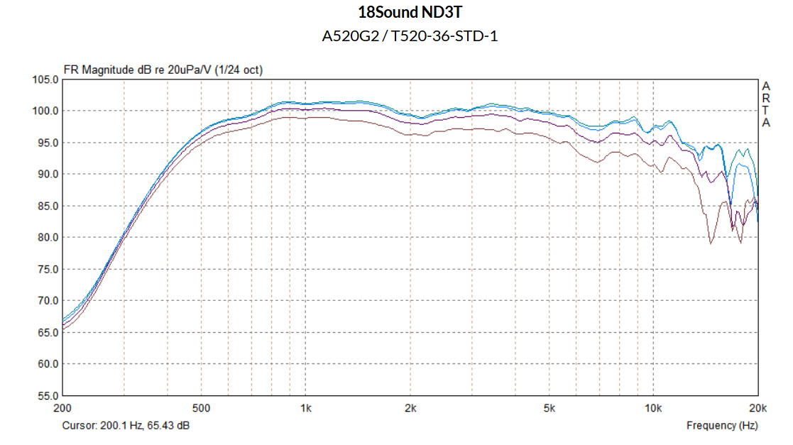

I guess so. Actually, now I recall that the adapter "36-STD-1" was made specifically with the ND3T in mind, but at the time I didn't include the exit section of the driver in the optimization. So these two will be in fact pretty close, the "ND3N" adapter a bit more refined perhaps...
The ND3T is problably not as good as the ND3N in the top octave, I don't know.
T520-36-STD package doens't have it. I'll buy this new ND3N model soon and it would be nice if it had it.

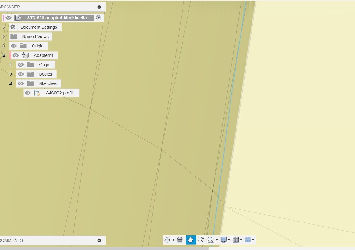

A460G2 has the full ath file, but I think the resulting profile seems to be bit different than what the T520-36-STD adapter (mesh) is, although very close. At least the mesh doesn't exactly align with the profile generated with the ATH script:
While the error is very small and within error margin of my printer, it would be still nice to be sure. Yeah, this is customisation work so not your responsibility to support it, although it would be nice to be able to customize the adapter as it is nice part to make mounting with, while still being sure the throat profile is exactly what it should. At least before printing 😀
