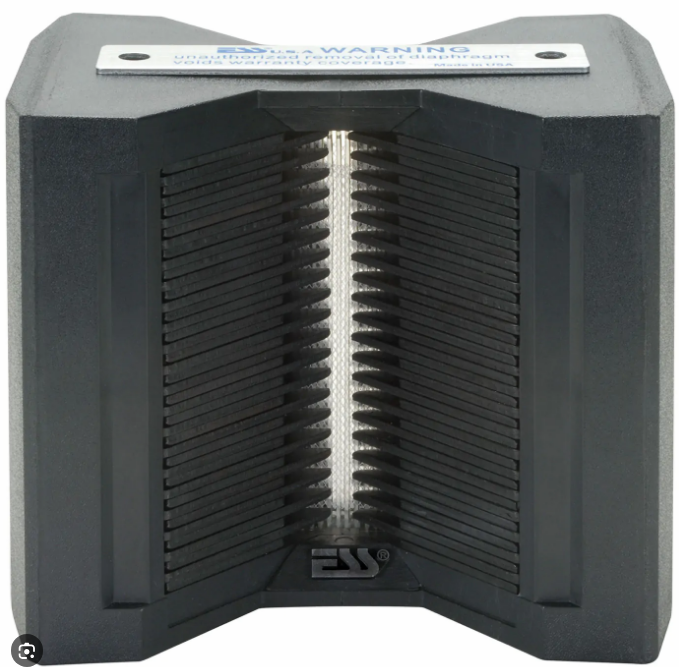

Here Danibosn presented a script intended for the ESS AMT-1. I have very little experience with ATH, but I generated the mesh with that script and realized that the geometry at the throat would not really fit the AMT.
Is there a way to start the horn (at the throat) with an arbitrary angle on the sides of the rectangular throat?

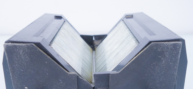

To make it more clear, here is a pic of the AMT-1. The horn would start where the metal part of the "V-shaped" contour ends and would need to start with that same angle. The newer version of the AMT-1 (pic #2) looks a little different, but the horn would be the same.
Sure, just delete the first horn section from the script (Horn.Part:1), which is only a segment of a straight duct in that example (a = 0).
Then in the section that remains (you can rename it to Horn.Part:1, but it doesn't really matter), set 'a' to the desired values. This is set independently for H and for V, which are arbitrary OSSE profiles.
Got it, thank you.

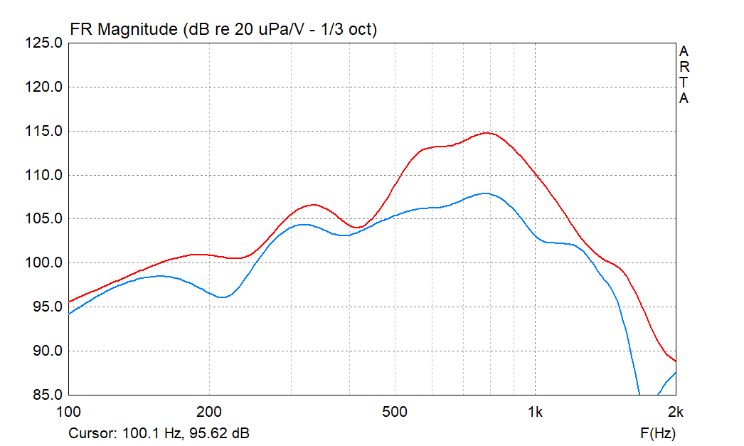

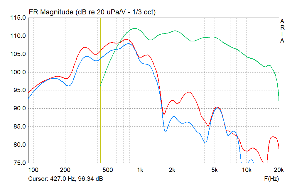

A340G2 and 13cm midwoofer close to the mouth, port firing, more parallel to the waveguide axis. As predicted by Hornresp resonance is smaller (blue)

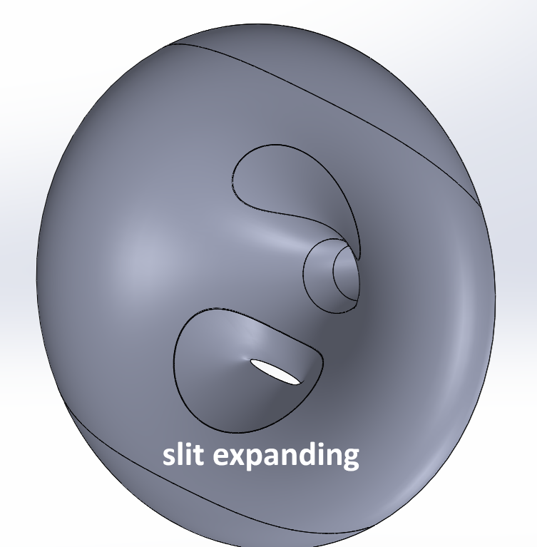

Below is tweeter 2535 green (not in scale) and two types of port: slit expanding blue and wide open red:

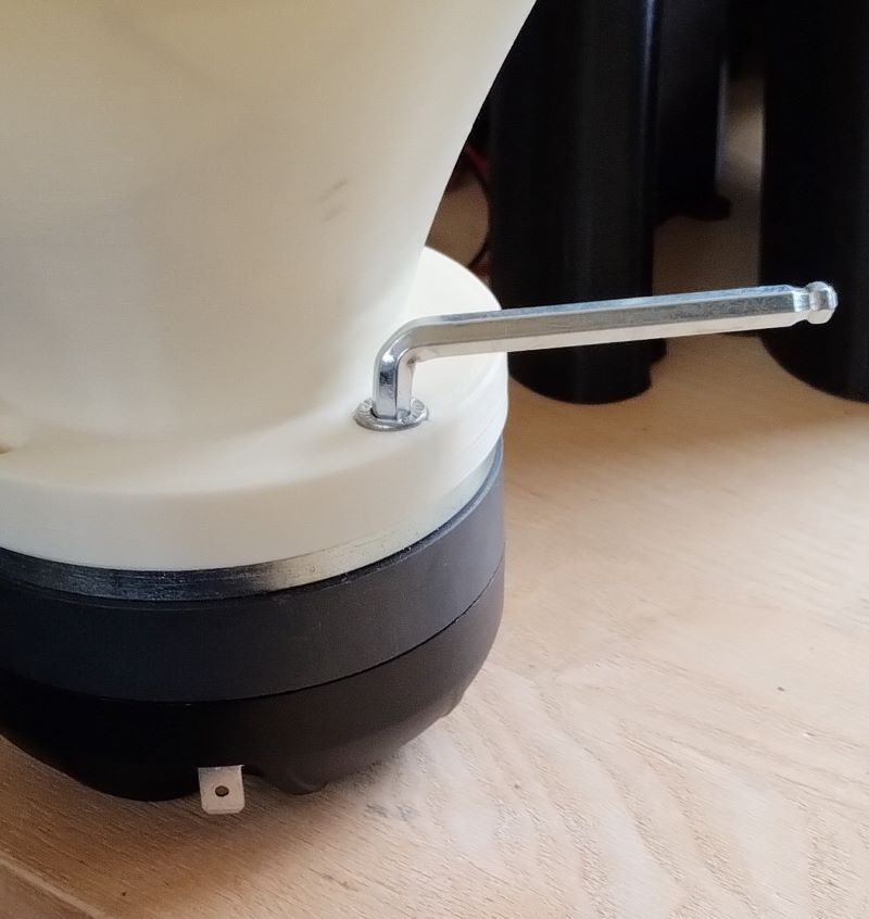

I noticed a few complaints that there's not enough space for accessing the mounting bolts in some of the kits. I don't know where I got to this but I have a short Allen key and it works perfectly. So I would suggest just to obtain one 🙂
In some cases it's possible to use threaded rods instead of bolts and then the access to a nut with a wrench from the side is much more straightforward.
