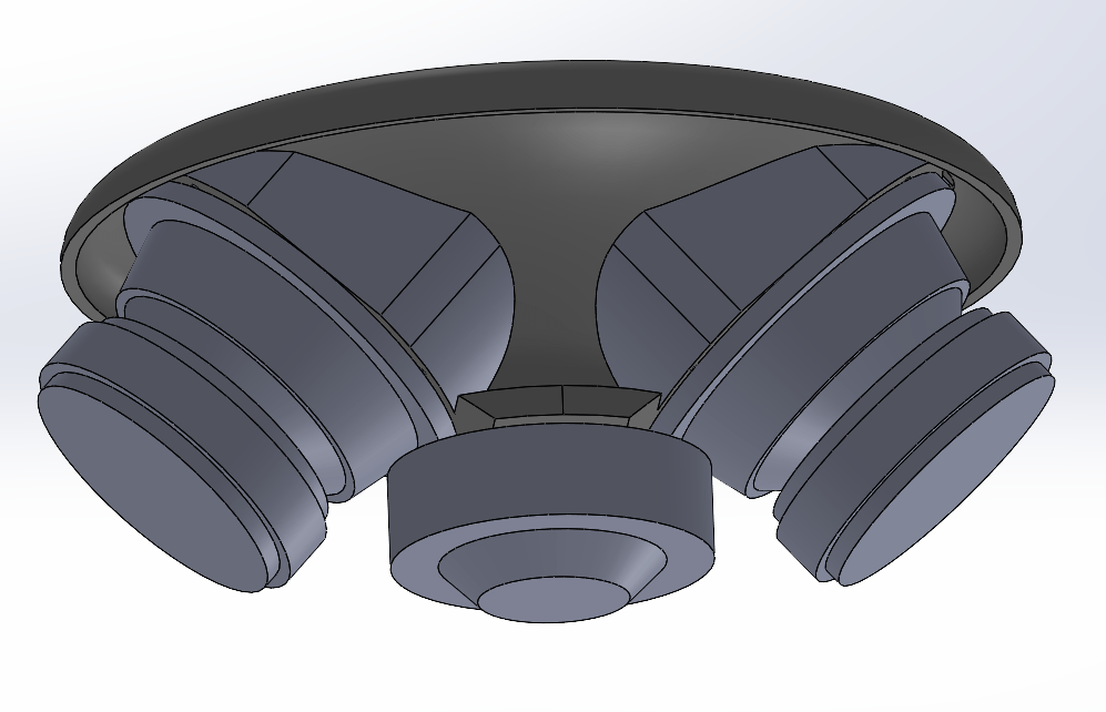

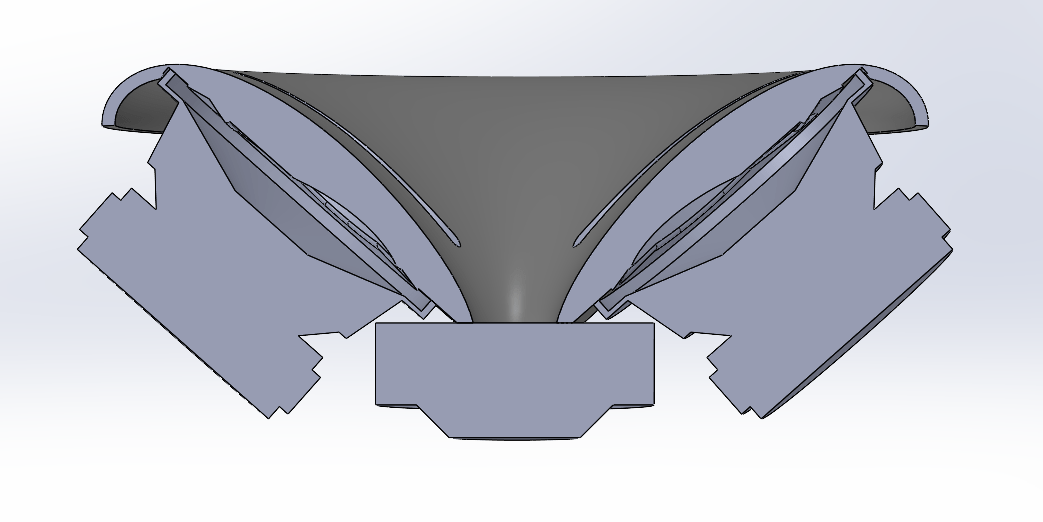

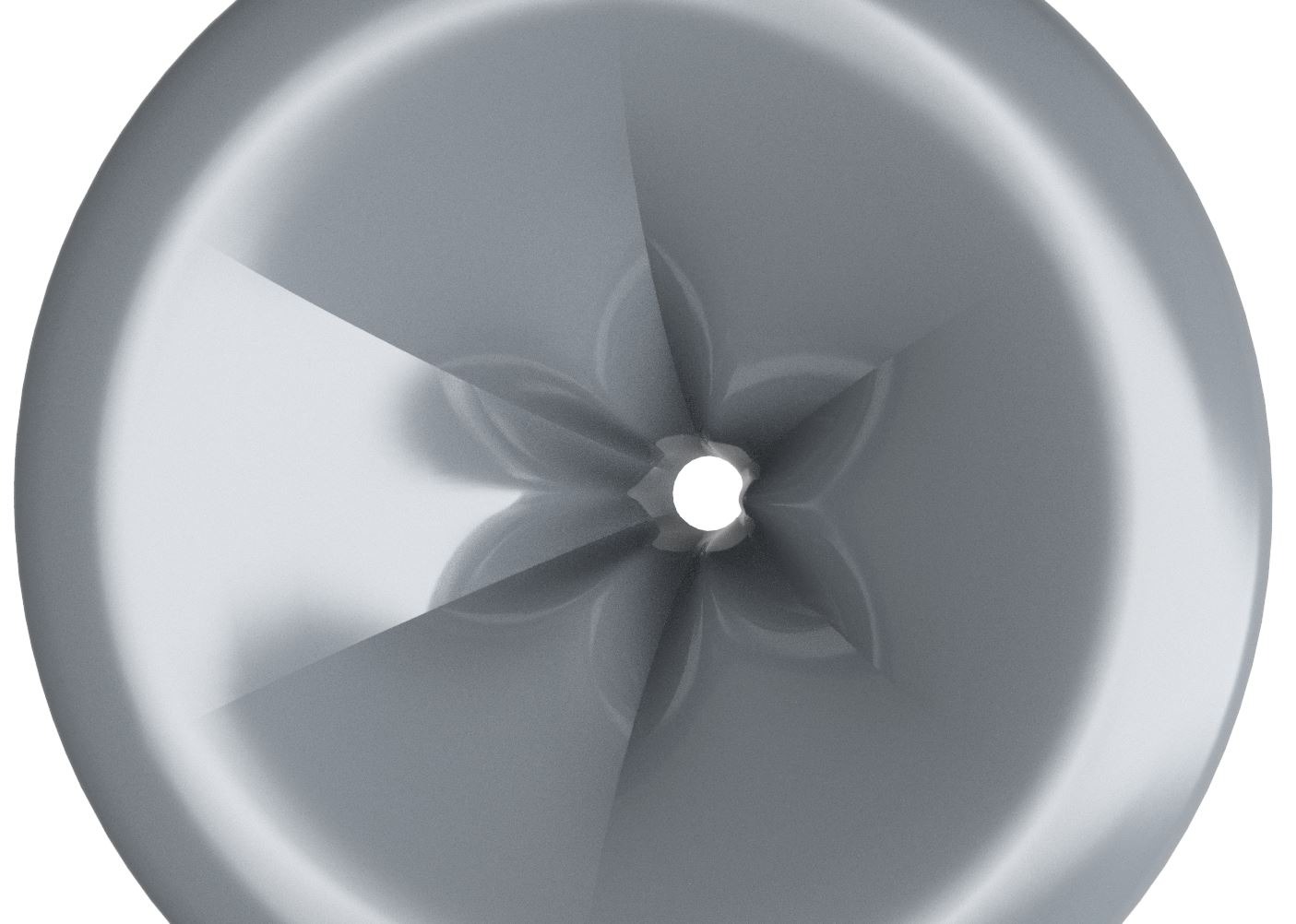

I'm not sure how important it is to have a such flat area on the back side of a waveguide for mounting a midrange.The middle part of the R-OSSE horn is pretty flattish - if there is no other way, the middle part petals could be machined to be slightly curved on the inside while keeping the outside flat to be able to mount the MF and LF drivers easily. I need ca 45 cm of flat surface on the outside, the rest can be whatever.
I was able to massage a pair of 4" Celestion TF0410MR on the back of a variant of the ST260 with decent results.
I have not worked on this in some time now but it can be done.

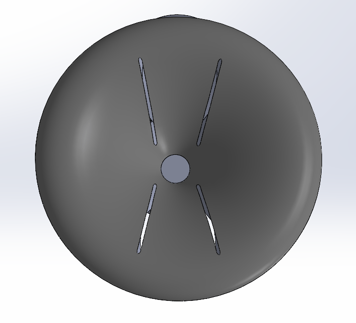

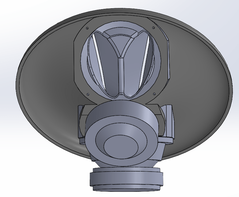

Here are some pics of the 3d work and a measurement:
Back:
Front
Cross section
Back sans mid
Response
Mids are not an issue, it is the 12" woofers used for lows - so that the port is not too long. If you look at the cross section you posted, I was referring to the driver mounting interface - which would need to be machined from the outside as well...so having a flat panel to mount the drivers makes it easier.

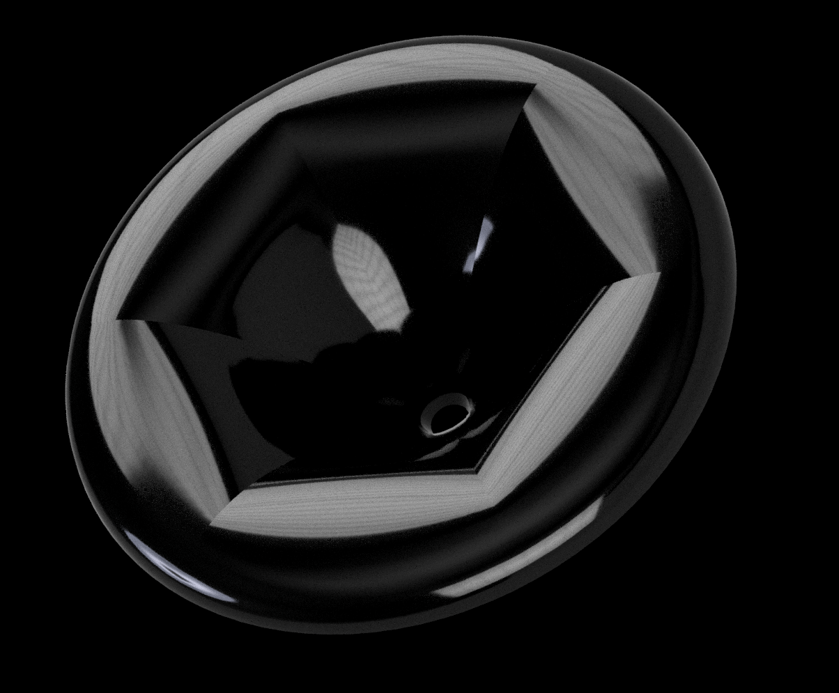

I did some more simulations and the dip is almost gone. I made a simulation without the roundover - that looks like a nightmare, but does not measure that badly.

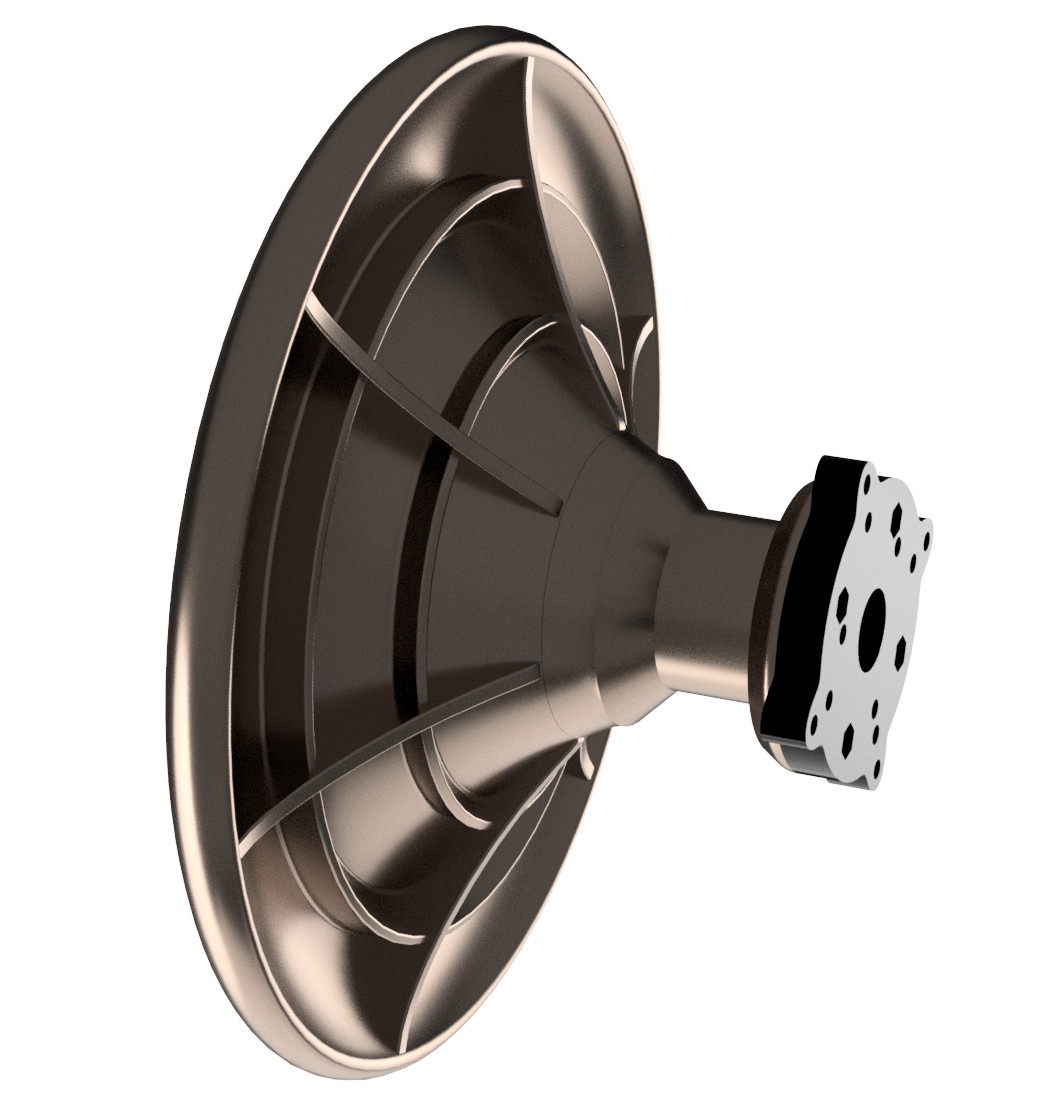

All that said, if I will be able to find a set of parameters for a 95 cm diameter horn with a relatively flat area in the middle, I will go for fully curved layered construction. It is a lot of work, so the profile must be worth it.

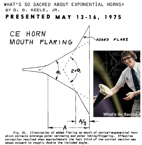

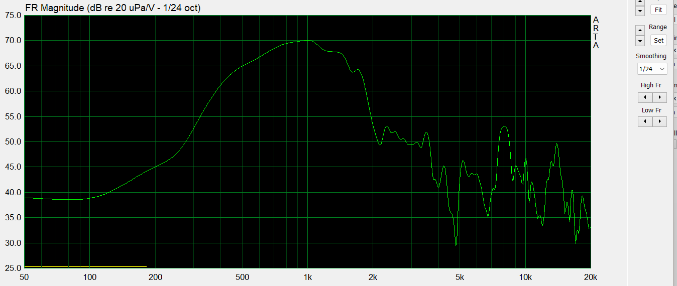

Don Keele described the expected "waistbanding" problem with conical horns in his his "What's So Sacred About Exponential Horns?" paper back in 1975.That looks exactly as I intended. What surprised me were the results:
Is this to be expected from this type of horn? Especially the dip and peak below and above 1 kHz on axis. The configuration is attached.
The (partial) solution which has been adopted by many, as in Tom Danley's Unity and Synergy horns is just as Don described, approximately the last third of the conical horn angle is doubled.
Relatively easy to make from flat material, relatively constant directivity, but not very good in comparison to other designs.
Anyway, as Mabat has proven, horn design has come a long ways in the last 50 years, conical limitations are not worth pursuing now if you want to make a constant directivity horn.

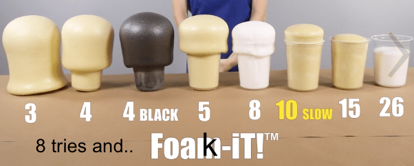

Thanks, OK, I'll let the foam idea go. I've never worked with the glass microballoons - doesn't it make the mixture too thick to be still pourable?

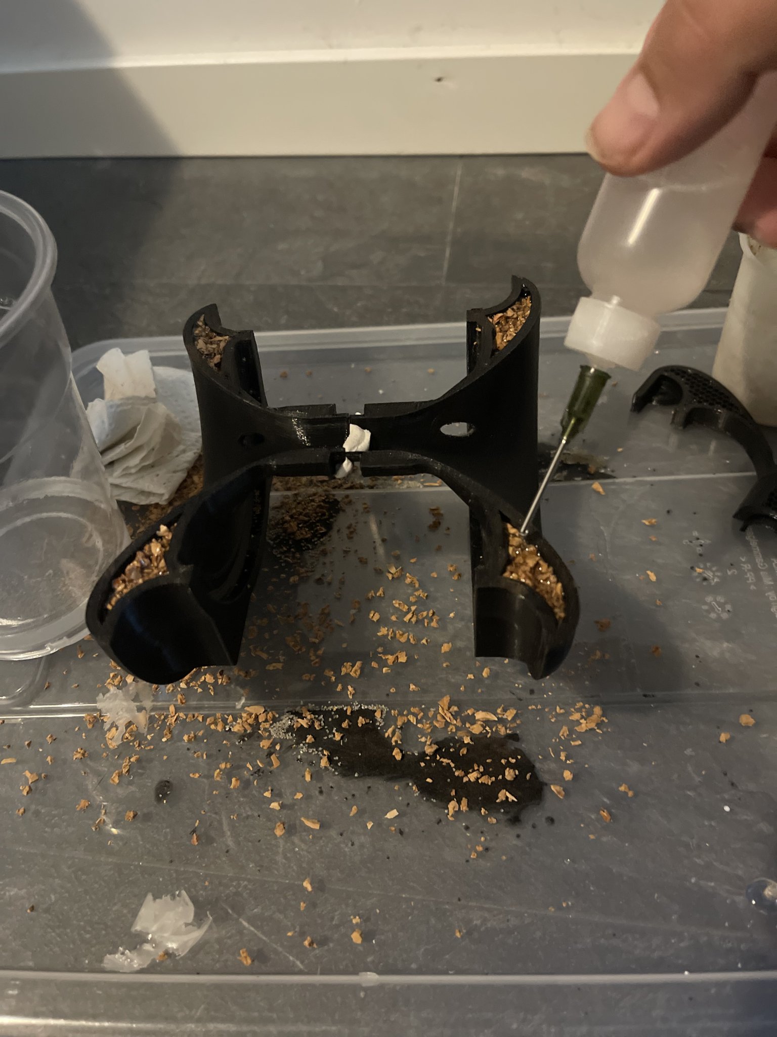

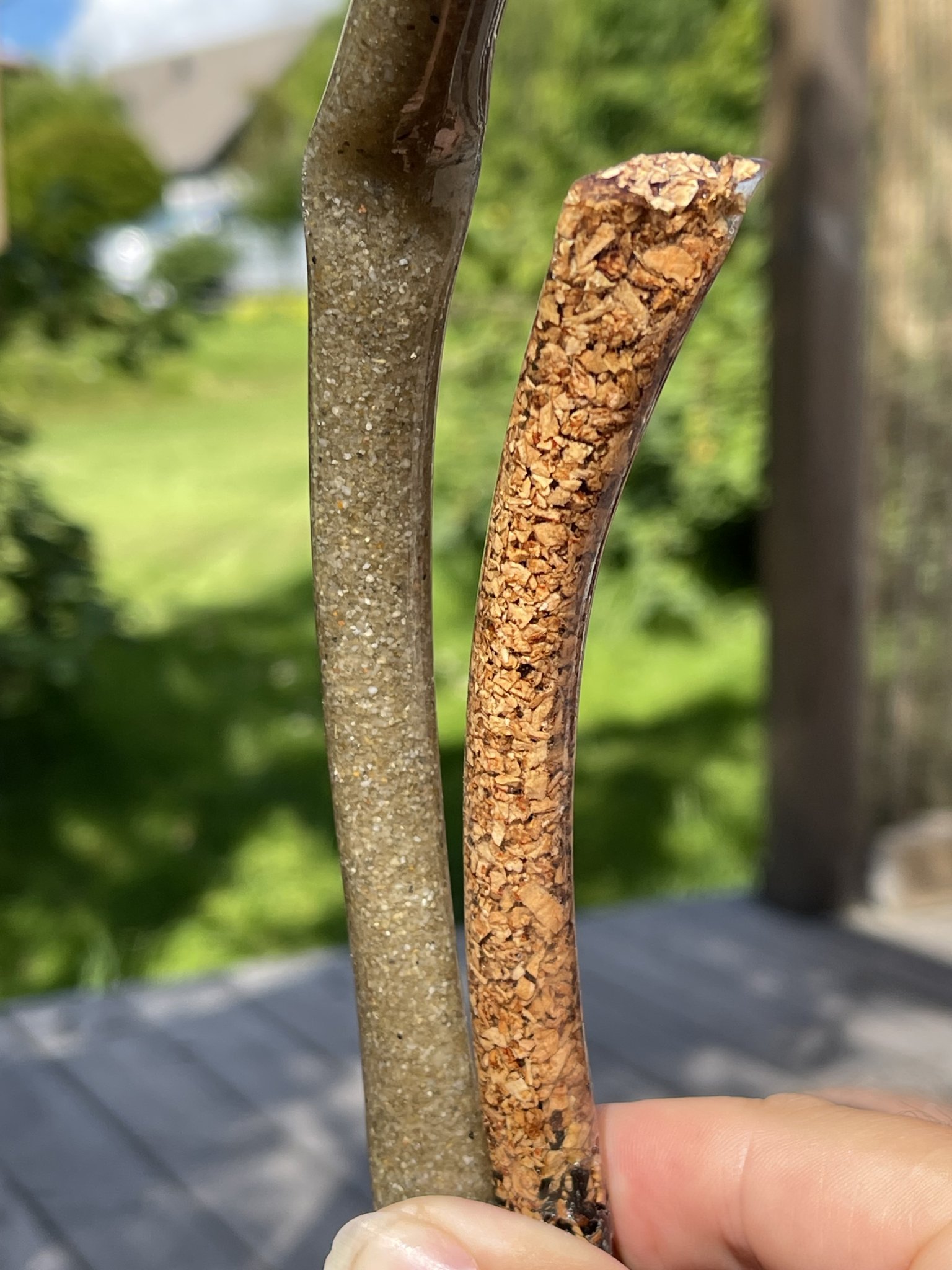

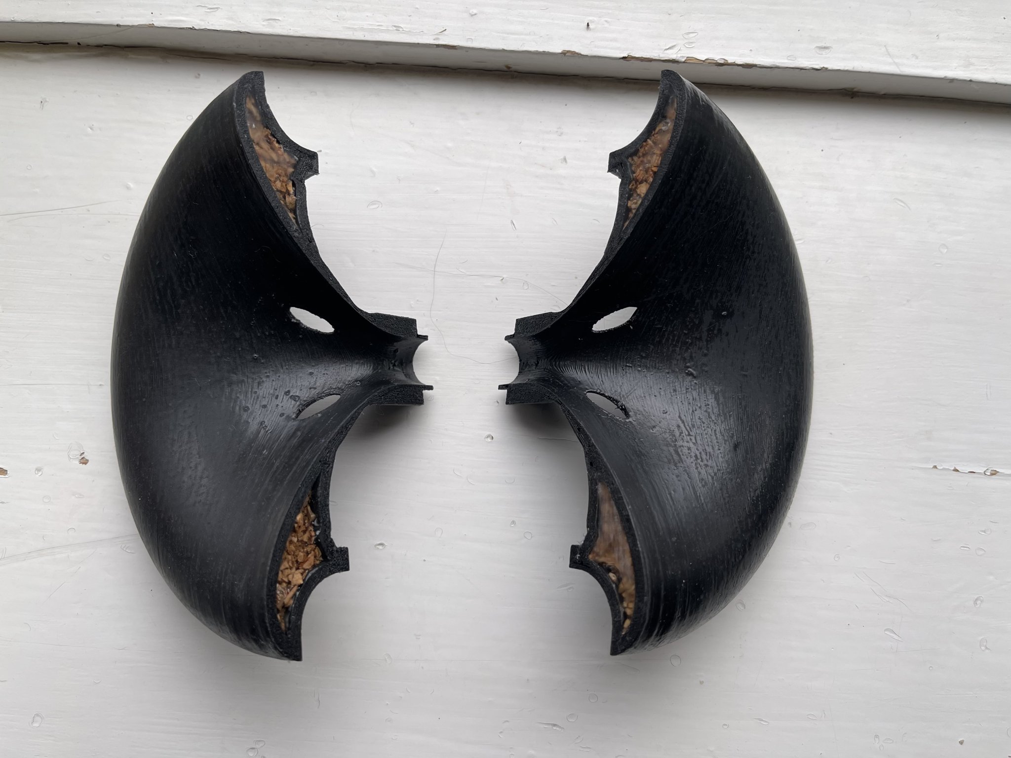

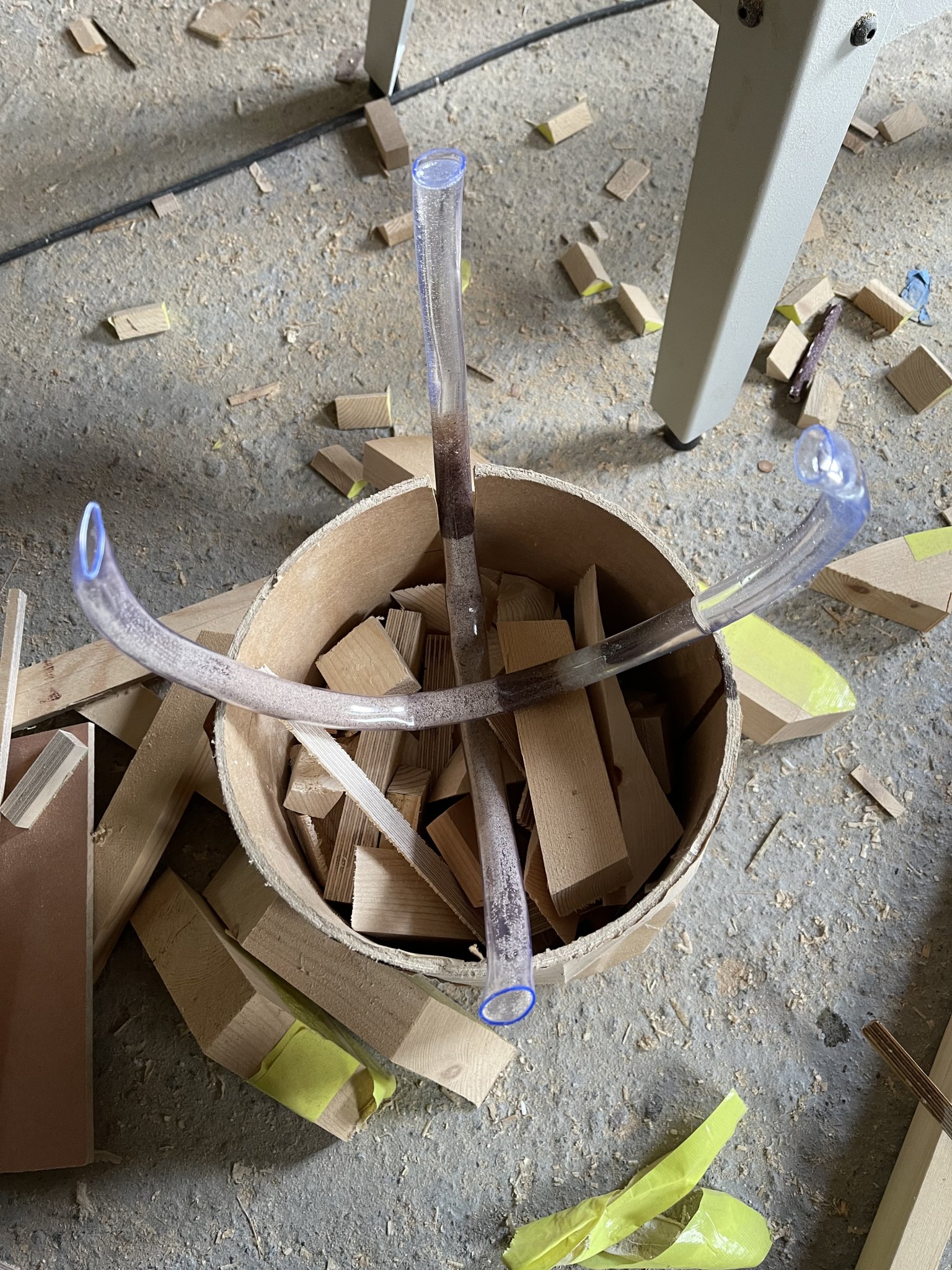

I don’t think I mentioned this here but this summer I made a couple tests where I took a vinyl hose and filled it with dry fillers of different grain size and material (sand, cork grains) and introduced epoxy from the top and watched how different types of epoxies performed when it came to penetrating and displacing the air from the top.
And a low viscosity infusion epoxy hardened with a slow setting catalyst together with filter sand 0.4-0.6mm grain size worked as intended.
Also cork grains with the same epoxy. (Highly damped composite material)
I have an idea that one could incorporate a printed tube that goes thru the bed of filler material that has micro perforations that won’t get clogged by the filler but will let the epoxy flow in to the material of choice. Like an infusion supposed to work but without the vacuum.
But haven’t tried it.
Edit: https://www.easycomposites.eu/in2-epoxy-infusion-resin the winner.

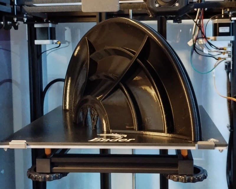

STLs updated for the ATH330EX (in a knock test it seems fine; also the wall itself is not thin) -
... when I say thickness, I mean the overall thickness of the waveguide, not just a single (printed) wall of the outer shell.
It is 1/2 - 1" in this case, I think. The shell itself is only ~1.2 mm (two perimeters for 0.6 mm nozzle) - I didn't try more, perhaps it would help as well.

- Still thinking about it, I'm probably going to try the F@#k-iT foam anyway 🙂

I have printed waveguides with 9-10mm thickness and 100% infill before, and saw no difference in measured behaviour compared to just a decent amount of wall loops (3-4 with a 0.4mm nozzle) and 15% infill density. It seemed to be a waste of filament to me, but I still did it for peace of mind after the prototypes showed good results.
That's what I would think. The infill inside seems to be pretty good for damping, actually. The idea is that it just leaves a lot of voids to be filled with something even better (or not)... For this reason, I use gyroid infill all the time (<10 %), just in case.

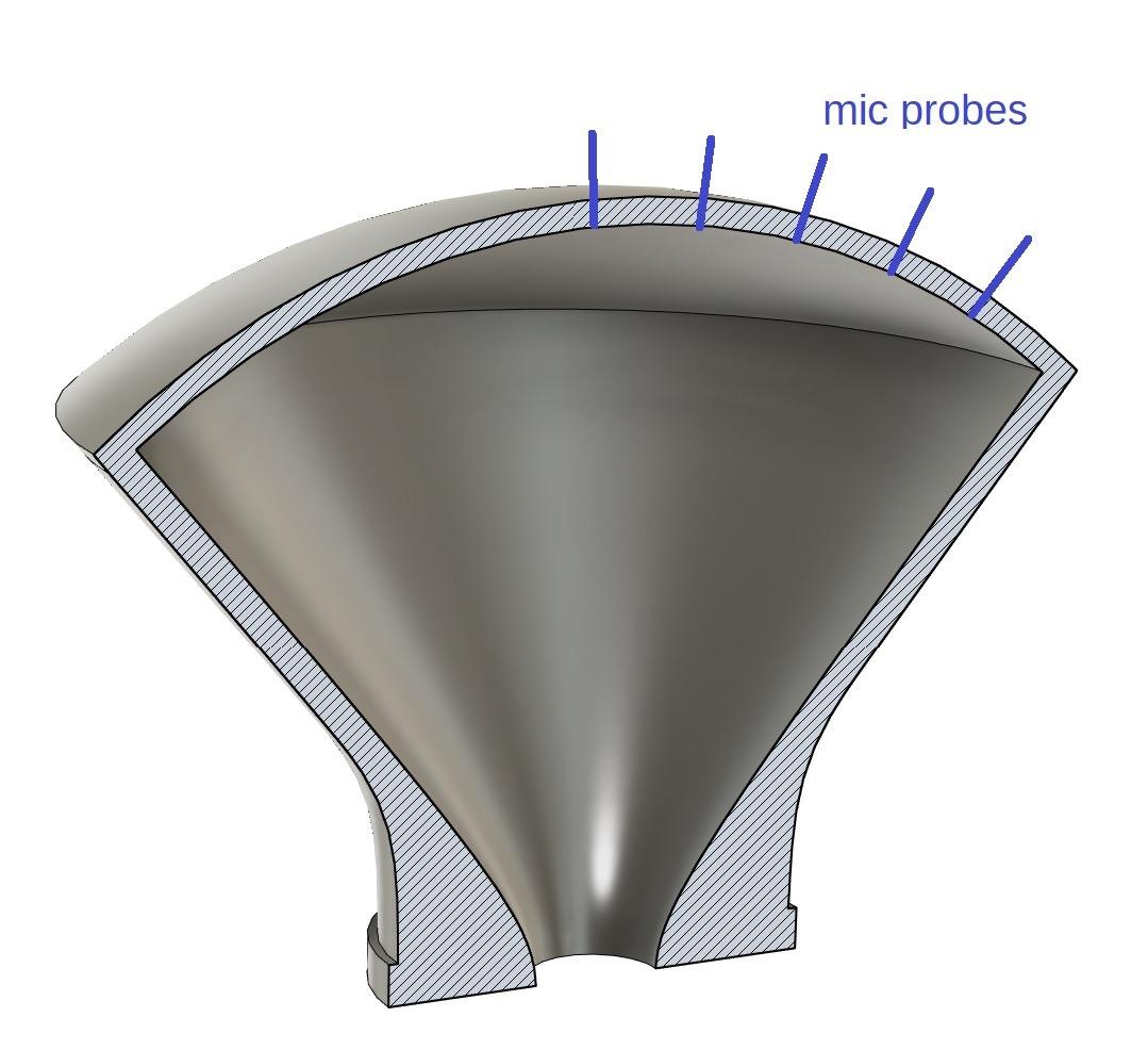

BTW, I think I've found a way to measure HOMs in an OS waveguide directly -
With the help of IR gating, there should be plenty of time to capture the high frequencies in detail.
The top cover is of course in the shape of the main mode.
Could be probably used at least to compare/assess different drivers in the amount of HOMs they produce.

Instead of several mics I would make it with only one mic in a sliding part. That would eliminate the need of mic matching and also allow for a free positioning.
How will you analyse the measured response? How do we expect the HOMs to be discerned?
- If we have infinite spatial resolution, there will be certain frequencies that show pressure nodes across the radiating surface, the horn mouth.
- Echoes in the impulse response at certain angles.
- Hash/noise in the frequency response when comparing to simulations at certain locations.
