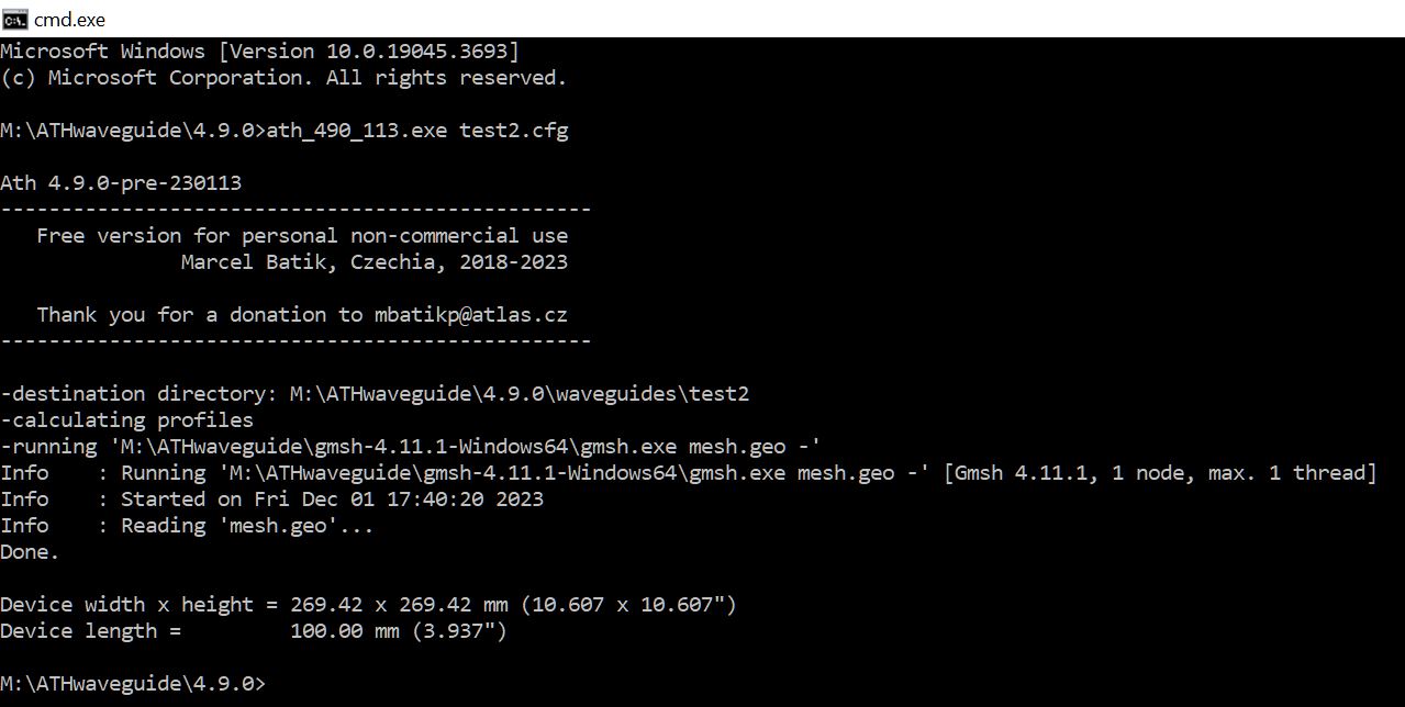

This is what my console looks like when I run it. The files in the attached ZIP should be in your c:\Horns\test2\ folder. Page 6 of the ATH user manual (also attached) explains the "%f -" suffix. Did you include a space between the f and the dash?
Thanks @CinnamonRolls
I noticed you were running 4.9.0. I remembered seeing this on the ATH4 website...
The last released package: Ath 4.8.2 with a User Guide; the latest build (recommended).
I clicked on build and downloaded a new ath.exe. Replaced the one that came in the Ath 4.8.2 package with the new one, and it worked!
Dumb mistake.
Got an STL file and no errors with the dash. Will continue my journey.
Thanks again!

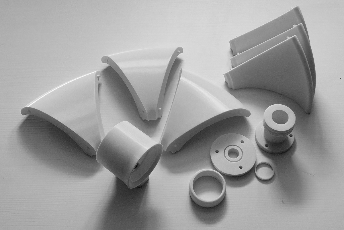

What models do you mean? Some of the EXAR waveguides? I can provide such models (not necessarily the same as the 3D print kits) - if you are interested, please write me a message. I guess that for CNCing from wood, round (axisymmetric) versions would be more appropriate... (?)If there are solid models, I can cnc them out of wood and test them.
I should be able to measure these waveguides soon myself, I have them almost finished. The EXAR 400-25 is virtually the same device as was experimented with originally, but the 340-20 is a new one.

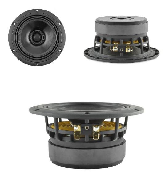

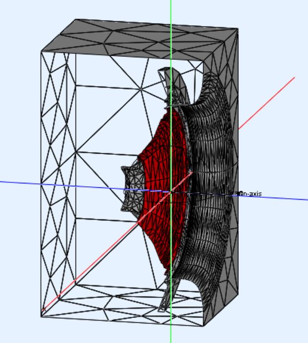

@mboxler clued me in to a new build of ATH so I tried it out. Version 231015 automatically adds the "Direction=z" to the Solving.txt file for you when using custom driver diaphragms formed using Source.Contours when you set Source.Velocity = 2 (move diaphragm in axial direction). Thanks, mabat! That was a big help because I'd always forget to add it when doing multiple runs to get my diaphragm measurements correct. Attached a zip of a configuration file I made for a Sica coaxial driver as an example. @vineethkumar01, this is the same driver you used in your coax cardioid build, Sica 5,5 C 1,5 CP. I bought one after I saw how successful your project was.

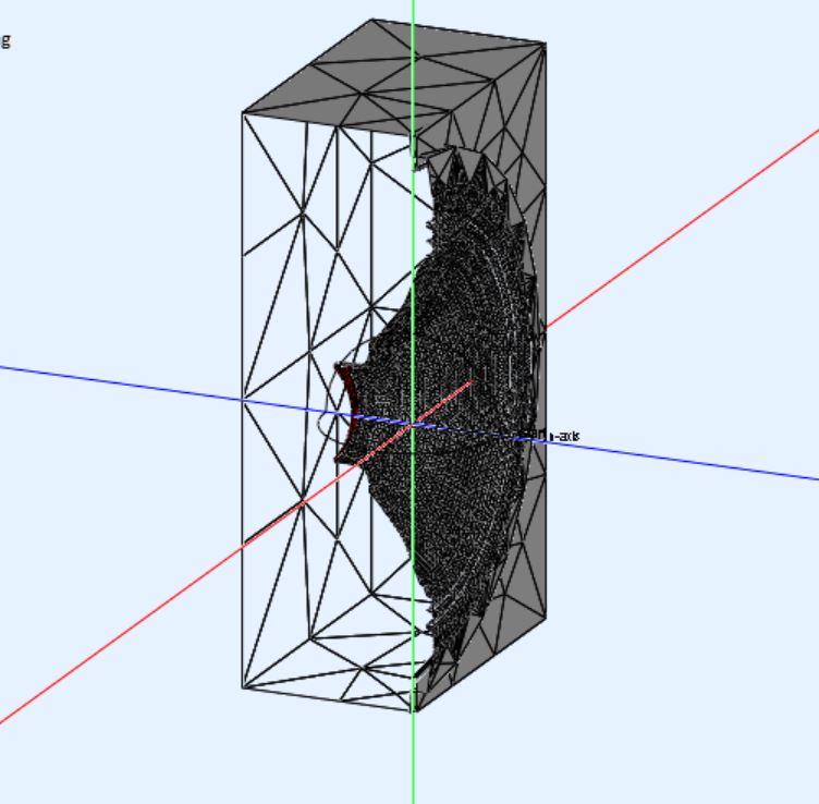

For anyone who wants to use the two config files I recommend the latest ATH build, obviously. Also, I commented out some Source.Contours statements that are more detailed around the tweeter but don't improve the simulation. Instead, I added simplified contours to reduce processing time. Source.Contours resolution is set too high in the tweeter file for reasonable processing times so you will want to decrease that. Two attached configuration examples: 1) tweeter file hides waveguide behind a surface mounted driver. 2) woofer file places a waveguide over woofer starting above the second surround.
Tweeter elements turned on (woofer off): Waveguide hidden, driver surface mounted.
Woofer elements turned on (tweeter off): Simple waveguide w/ driver recessed into enclosure.
