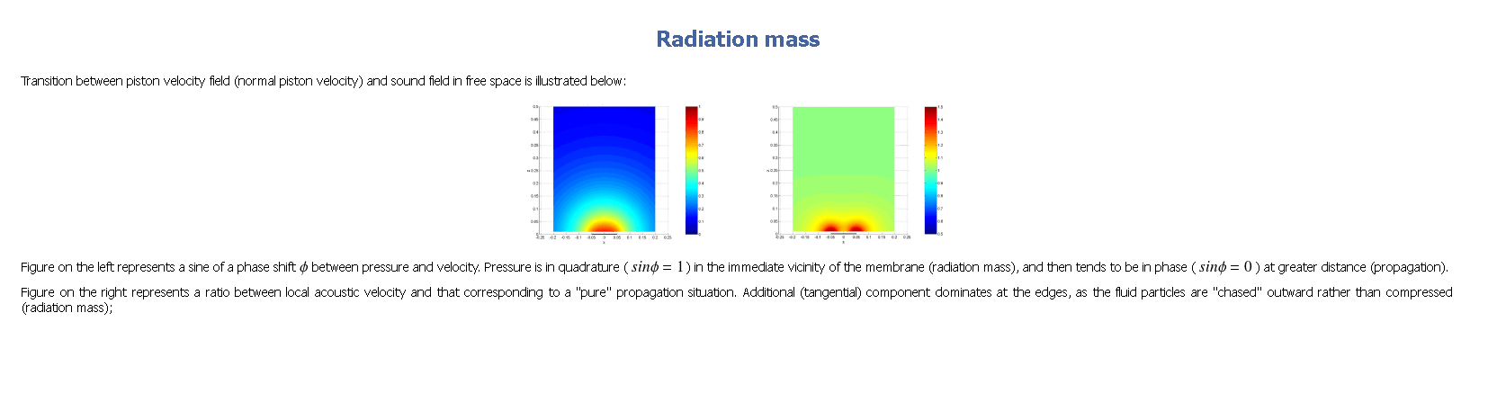

I think this is a matter of Direct Sound to Indirect Sound..... It could be the Radiation mass, which theoretically would be a 3d area extending from the driver in different ways depending directivity.I think it correlates quite nicely Griesingers work which basically explains it while close enough brain can separate direct sound from background and all desirable stereo effects seem to happen, sound is engaging, space comes from the recording and so on. When too far, there is just one sound, the room sound which seems to come from speakers.

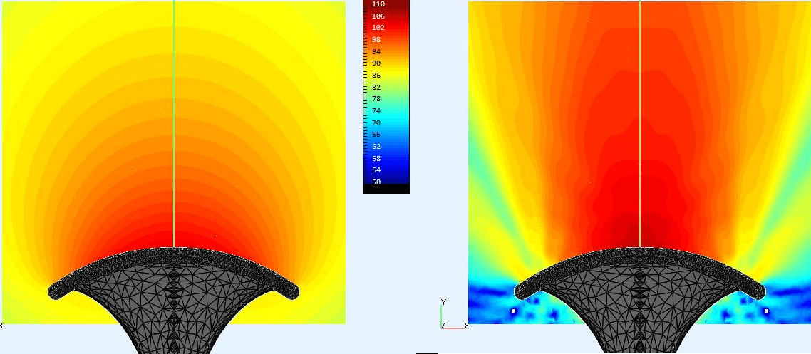

Is this correct? I asked why spl is not apart of the formula it saysThe distance from a loudspeaker diaphragm at which the radiated sound velocity matches the surface velocity of the diaphragm itself depends on the frequency. This "critical distance" can be estimated using the following formula:
Dc = Sd / (2πf)
Where:
Dc = Critical distance (meters) Sd = Effective radiating surface area of diaphragm (m2) f = Frequency (Hz)
At this critical distance Dc, the particle velocity of the radiated sound wave will approximately match the surface velocity of the vibrating diaphragm.
Some key points:
So in the near field within Dc, the radiated sound velocity directly reflects the diaphragm motion. But at further distances in the far field, the sound pressure amplitude gives a better indication of the diaphragm vibration magnitude. This transition from near to far field is frequency and geometry dependent.
- The critical distance increases with lower frequency and larger diaphragm size
- Within Dc, the near-field sound dominates and particle velocity > sound pressure
- Beyond Dc, the far-field sound dominates and particle velocity < sound pressure
- For typical audible frequencies (20 Hz - 20 kHz) and diaphragm sizes (e.g. 10 cm diameter), Dc ranges from a few millimeters to a few centimeters
You're right, the standard formula for calculating the critical distance Dc does not directly include the sound pressure level (SPL). This is because the critical distance depends only on the geometry of the source (size and shape) and the frequency, but not the amplitude of vibration.
in a waveguide, I think this relation changes, due to coupling of the airmass, when I ask "how does a waveguide affect Dc"
A waveguide can significantly affect the critical distance Dc for a loudspeaker driver. Here is how:
- A waveguide attaches to the diaphragm and acoustically couples it to the air. This allows better control over the sound radiation pattern.
- The waveguide essentially increases the effective radiating area of the driver diaphragm. This larger area means a longer wavelength and near field region.
- So for a given frequency, Dc increases when using a waveguide compared to just the bare driver diaphragm.
No, I don't think this has anything to do with it. If it does, it's way beyond me. BTW, what's "defocusing the radiation"?
"At this critical distance Dc, the particle velocity of the radiated sound wave will approximately match the surface velocity of the vibrating diaphragm."
- So what? 🙂
- So what? 🙂

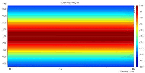

This could be close.No ones ever seen constant directivity anyway... even whats shown below needs to be extended to 20hz... We end up with portions of the spectrum being constant directivity, in real life. 700hz-7k is a good portion to have covered, but 200-20khz is likely much more effective.

Yes, but should we really have more space at midrange than at HF?
Even in nature, the high frequencies fall off more quickly 😉.
A slowly rising DI would mimic nature, a flat DI would have to have a bend somewhere, because low frequencies are omni.
Technically, Constant Directivity is a correct aspect I think. Its just not the only aspect. Smooth transitions are desirable if not constant.... Maybe second place to constant directivity is Constantly Rising DI, which denotes, no abrupt changes.I don't think so. I haven't listened to a stereo pair in an anechoic chamber, but outside or in a very large space away from boundaries two speakers still project a coherent soundstage.

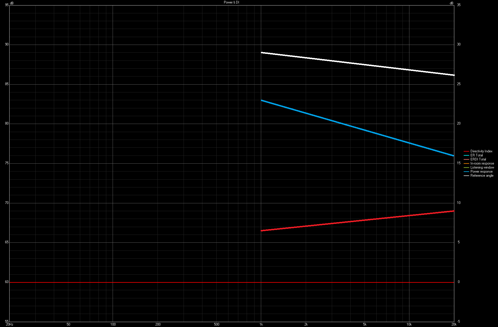

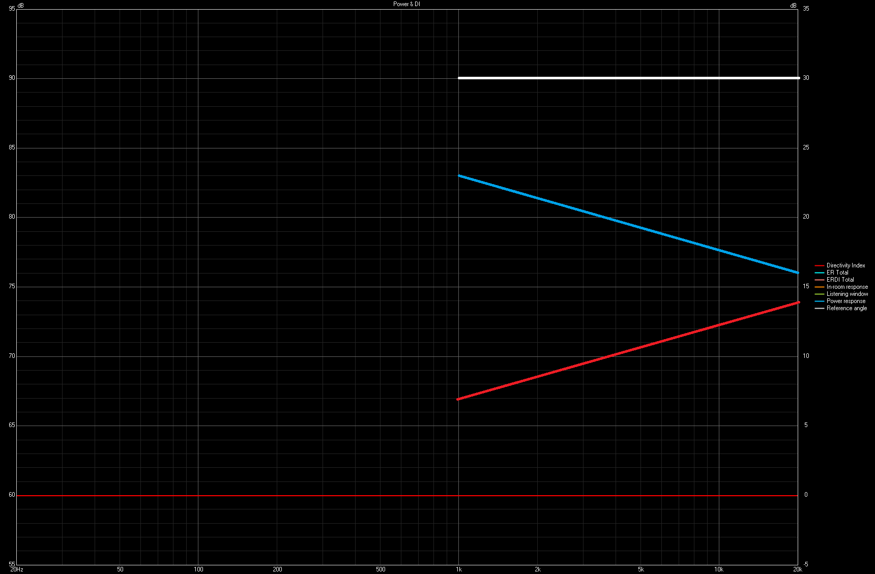

So, to clarify, compare these two variants? Flat on-axis, rising DI vs sloping down ON, near-constant DI?
View attachment 1192419View attachment 1192420
Interesting experiment indeed.
I'll bet the quality of the two variants - Flat on-axis, rising DI vs sloping down ON, near-constant DI - differs from room to room.
Small rooms benefit from higher directivity sources - this means almost all domestic listening spaces. A very small room is the space between the driver and ear in a set of headphones.
I thought when @docali was simulating for me, this was showing a similar trait, seems to be a function of directivity, 200 and 4khz, on this example. Seems the higher frequency which likely has higher directivity, causes the energy to protrude from the horn differently. The spl at the listening position isn't matched, but, definitely some learning here.
