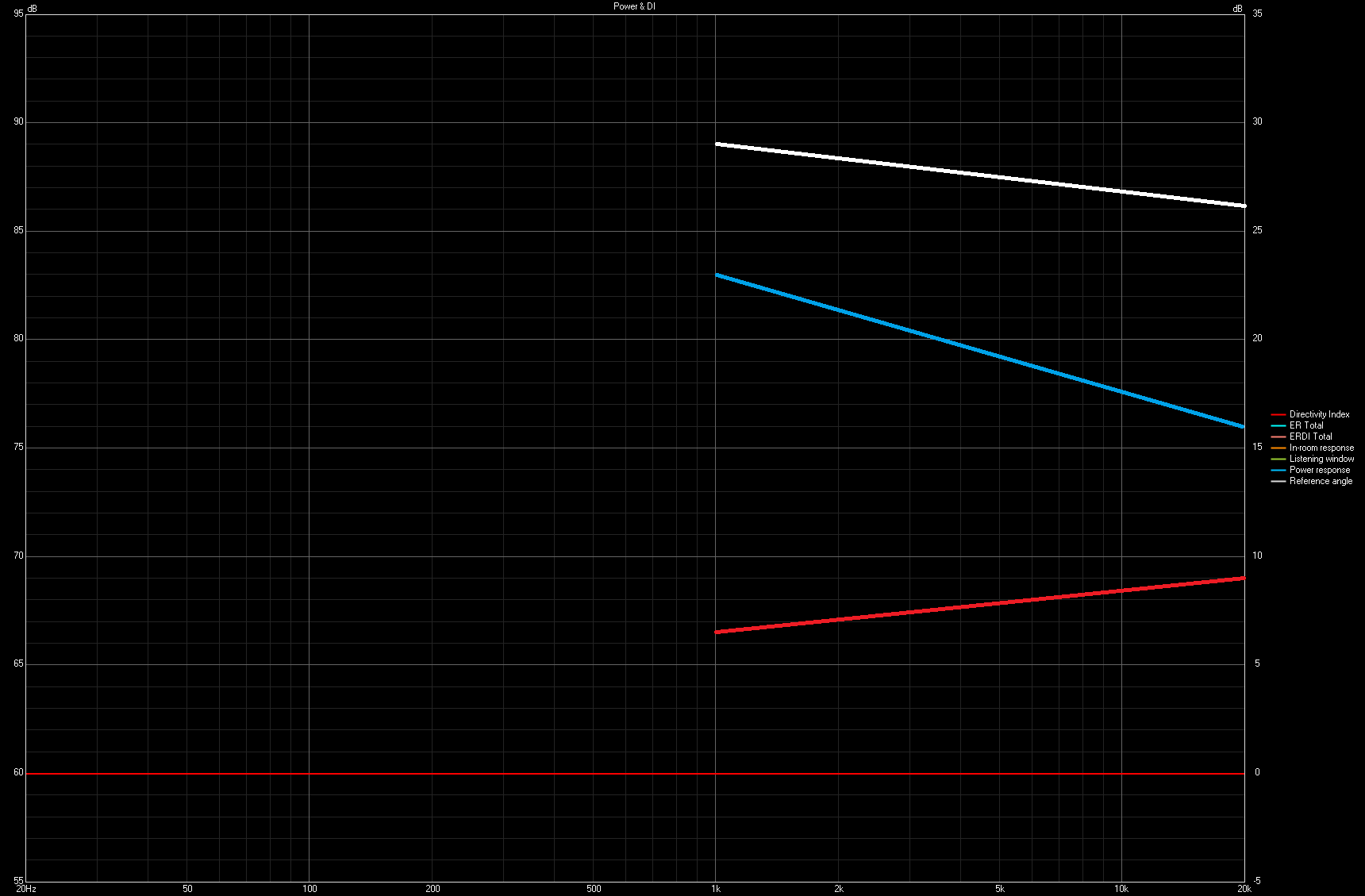

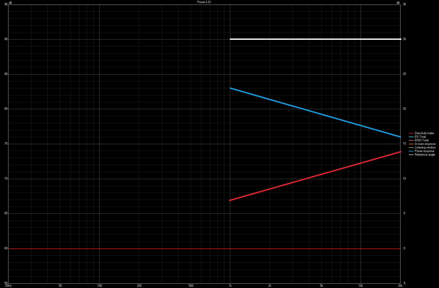

So, to clarify, compare these two variants? Flat on-axis, rising DI vs sloping down ON, near-constant DI?It's in the context of the@ @CinnamonRolls' speakers. I already tried to explain it

Yes, that's correct. That particular power response slope if what is found to give the most rewarding sound in that scenario.So, to clarify, compare these two variants? Flat on-axis, rising DI vs sloping down ON, near-constant DI?
Its not so different to increasing DI which inherently lowers the reflective sound energy to the listener
