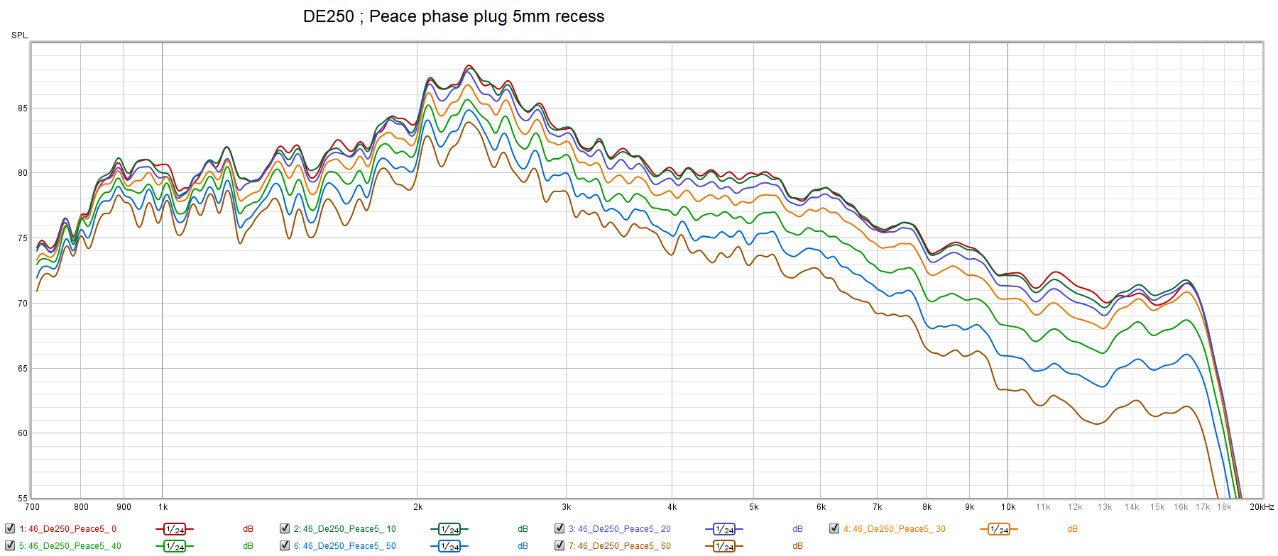

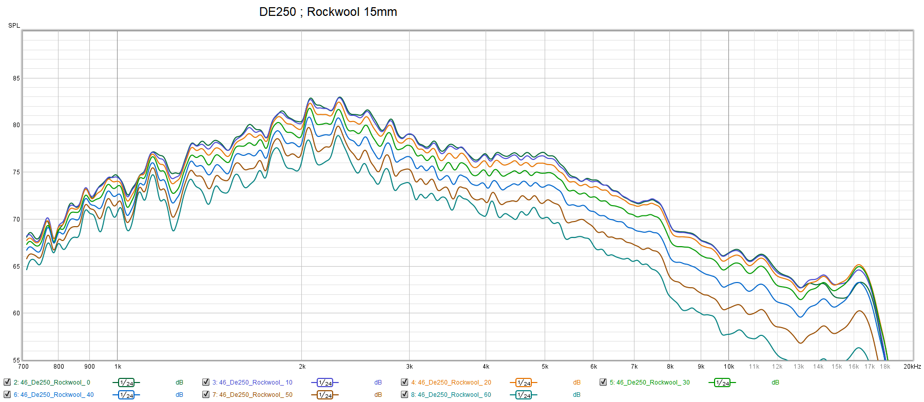

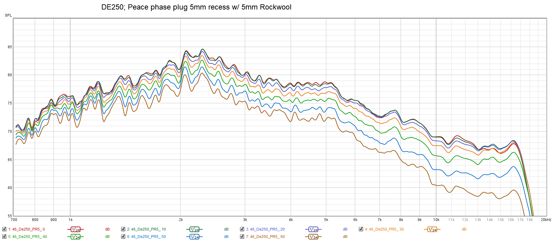

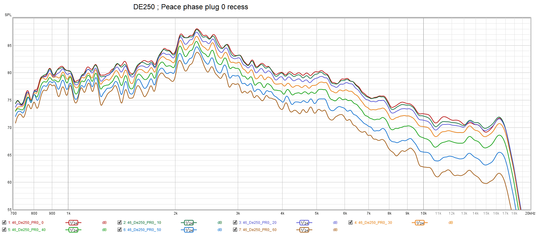

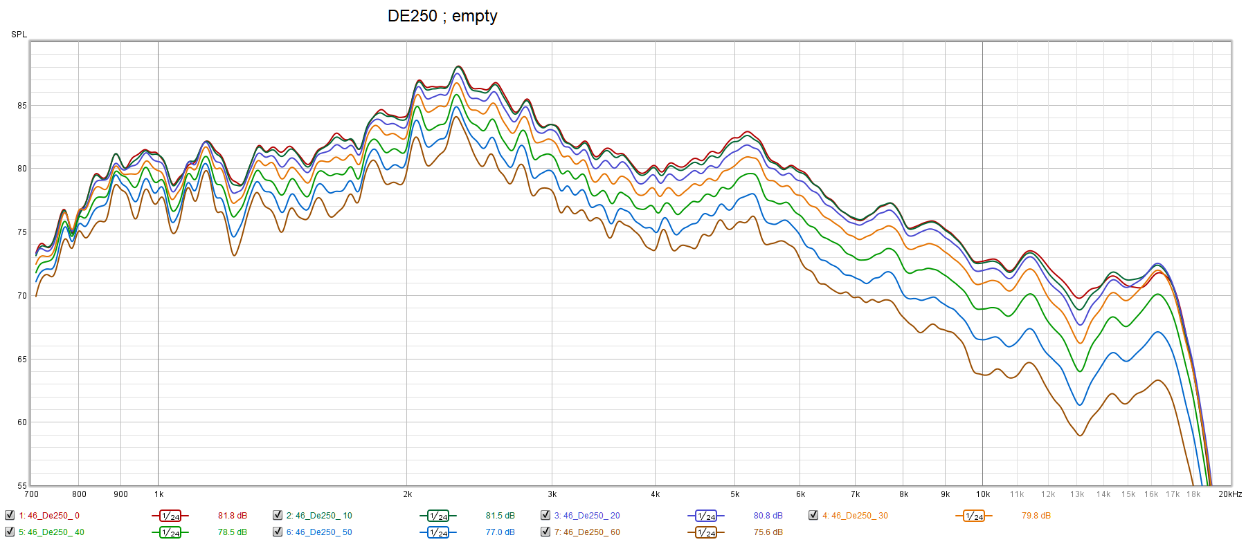

DE250 indoor measurements. No gating because it probably doesn't matter because these are just comparisons. But I included the MDAT files if anyone wants to gate them.
DE250: Empty throat
DE250: Peace phase plug 5mm recess
DE250: Peace phase plug no recess
DE250: Rockwool, 15mm deep, loosely packed
DE250: Peace phase plug 5mm recess w/ 5mm Rockwool

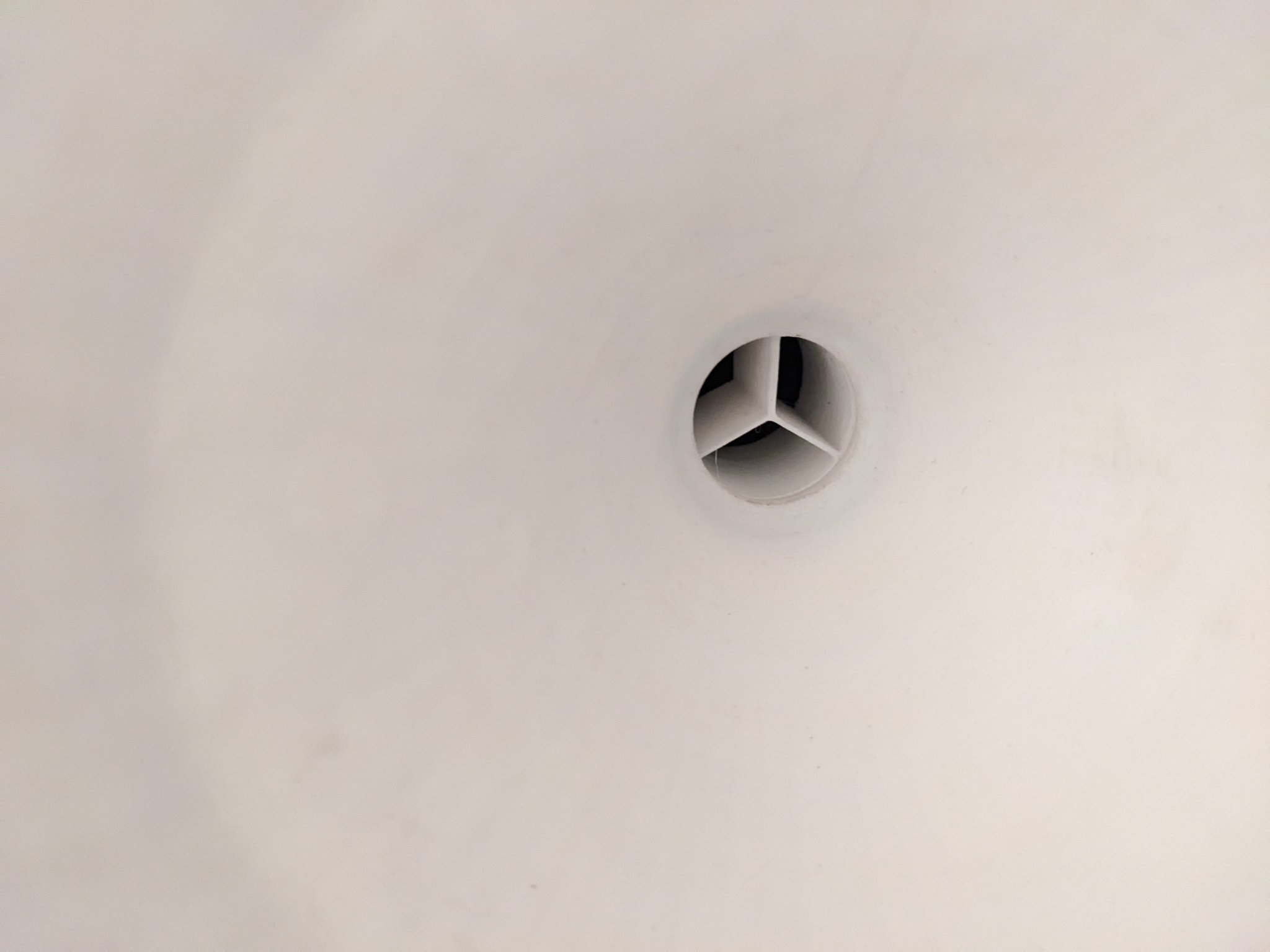

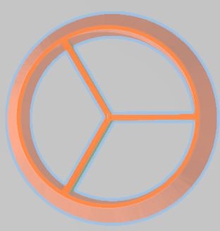

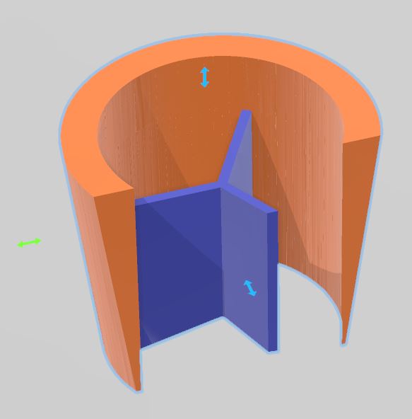

One peace plug recessed 5mm from start of waveguide and the second has no recess. See attached images of internal ring with the Peace phase plug.

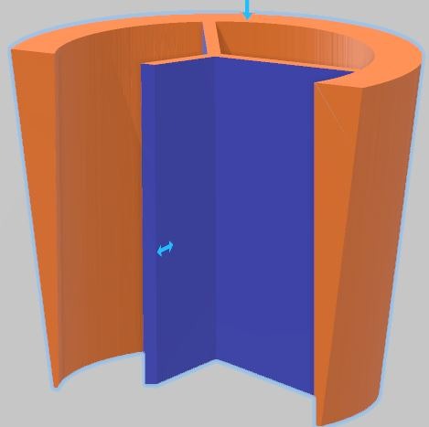

But I think that dividing the duct as showed above is a more effective approach. As I understand its function, it basically doesn't let any higher modes to develop inside the duct. And kind of averages the outputs of the phase plug slots inside each of the three angular segments.
Kind of the the tangerine phase plug of Electro Voice.
In theory it should do little if anything "if" the wavefront is completely axisymmetric because there is no angular velocity to disrupt and so the vanes should not do anything. Perhaps there is far more non-symmetric activity than we assume.
Reactions: 1 user
