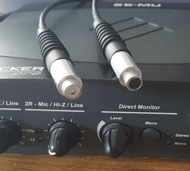

Marcel, for your experiments you could easily make a short planewavetube of a piece of 40mm pvc drainage pipe, lets say 50cm,. This would give you a gating time of +-3ms and proper loading.
protip; use these microphones; they are excellent and very small ( and cheap), I have measured dozens of different batches and they hold up to the datasheet, almost type1 performance and extremely tight tolerances ;

these mics are tiny, 3x2x1mm, if you place the mic flexpcb sideways there wont be any significant disturbance of the wavefront, it only "sees" an object of 1mm, which is not relevant up till 20k.
regarding the tube; of course an exact match will better, but an approx match is good enough for 1-10khz and with the tube you can easily measure down to 500hz.
( a 40mm pvc pipe with 2mm wall thickness has an inside diameter of 36mm, which is close enough)
of course with these mics you could also measure inside the throat of an os waveguide 🙂

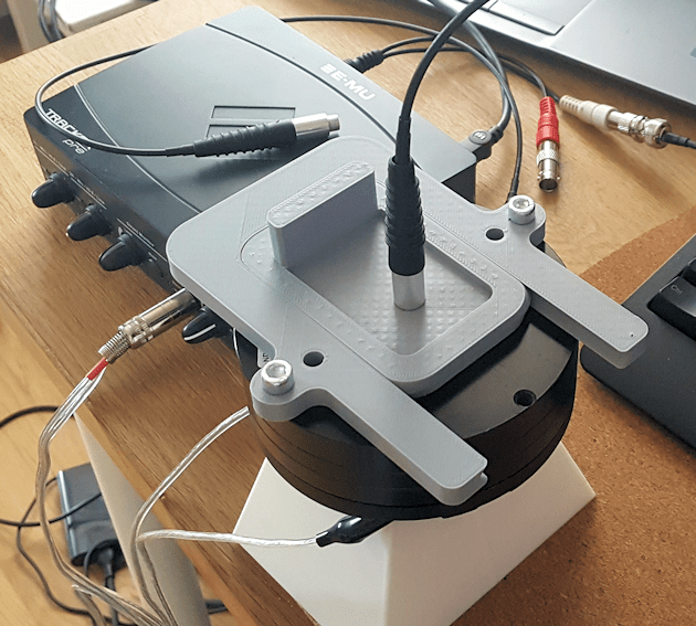

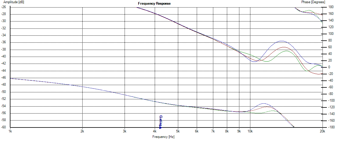

My aim is to measure especially the amplitude distribution across the driver's exit aperture to be able, hopefully, to better optimize the spherical wave-forming plugs, especially for 2" drivers. These devices work great in simulations with ideally flat input wavefronts (constant directivity up to 20 kHz even with a 2" throat, improved loading - really a pinnacle of performance), but with real drivers and their non-flat exit wavefronts they obviously don't work nearly as good, as the channels don't sum as expected...
Even with 2" drivers there probably won't be anything of interest below 6 - 7 kHz, where the wavefronts seem to be still pretty homogenous. The problems start higher. The only thing that I'm worried of is that the drivers will be all pretty bad, only in different ways.

Yeah I understand what you're aiming for.
Still, messuring with a really tiny mic in the throat of a waveguide mounted on the compression driver of interest could imho give you a lot of usefull info, since it gives you the abillity to measure " what is wrong" with the wavefront, and then reverse engineer that in abec.
Also, try to look at the phase curves, this will give you more exact info about wavefront "delay" per position

So do you think, after all, that as I outlined the experiment, it's able to provide such data? When the idea occured to me, it appealed mainly by its practical simplicity - virtually anyone with a basic equipment could acquire the data right away. This way a database of drivers could be gathered from different people pretty easily, which would be of course a great benefit.

If the goal is modifying the forming plugs taking into account the actual wavefront shape of the driver would it not be better to try and measure at the exit of the forming plug and then modify as necessary? Perhaps measuring at the exit of each channel of the forming plug would be easier as each segment will not interfere with the other? Just a thought
What is interesting (if I'm interpreting the graphs correctly) from the testing you have done is that the ring radiator style compression driver is producing a much "flatter"wave front at the exit of the driver than the dome style diaphragm

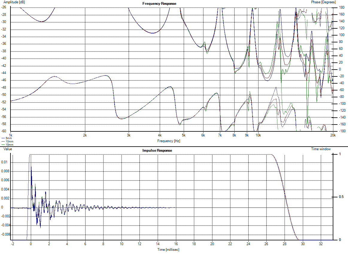

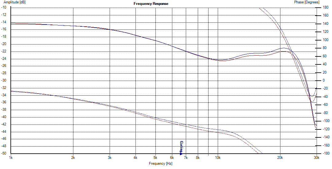

I think it's easier to proceed from the input side, i.e. to measure the input wavefront and then try to design/simulate a plug using that data. At that point you can decide where to divide the exit area into channels, etc. Also I think it's not so easy to separate the channels at the output of a plug for measurement, as I think that any mismatch will immediately influence the other channels as well.
BTW, the HF1440 including measured phases (5,10,15 mm off center):
And without a time window (not very useful here, I guess):
If this turns out to be worth it, I will prepare some toolkit to visualize the wavefront data in a convenient way.

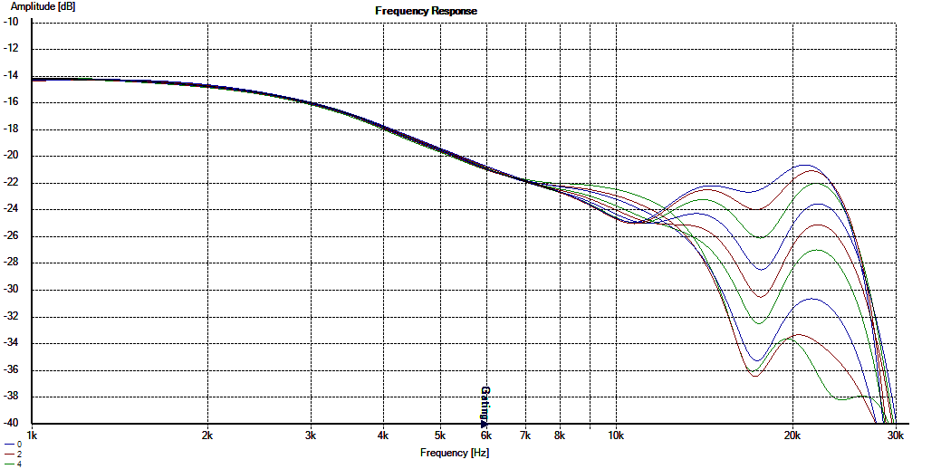

If this graph is correct, then this would imply that any flat plane wave assumption is quite wrong above 10 kHz. The specific driver might then be a determining factor. Yes, it would be a very easy test as a driver comparison. I would suspect that they would all do this at some point, but perhaps differently. Worth a try. I'd like to see some more examples.BTW, the HF1440 including measured phases (5,10,15 mm off center):

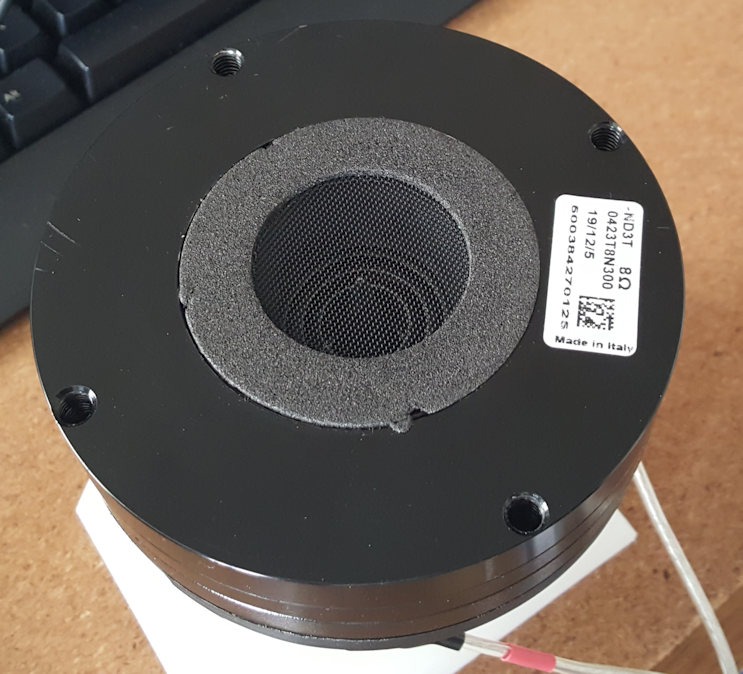

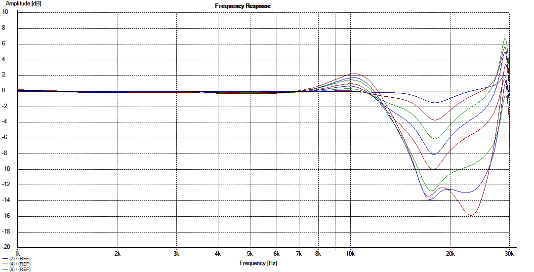

I'll see what I can do. In the meantime, this is 18sound ND3T, more densely sampled along the exit radius.
The raw responses and relative to the axis -
Perhaps if there was a strong (0,1) mode it could look like this. (Or it's all BS due to the boundary termination.)

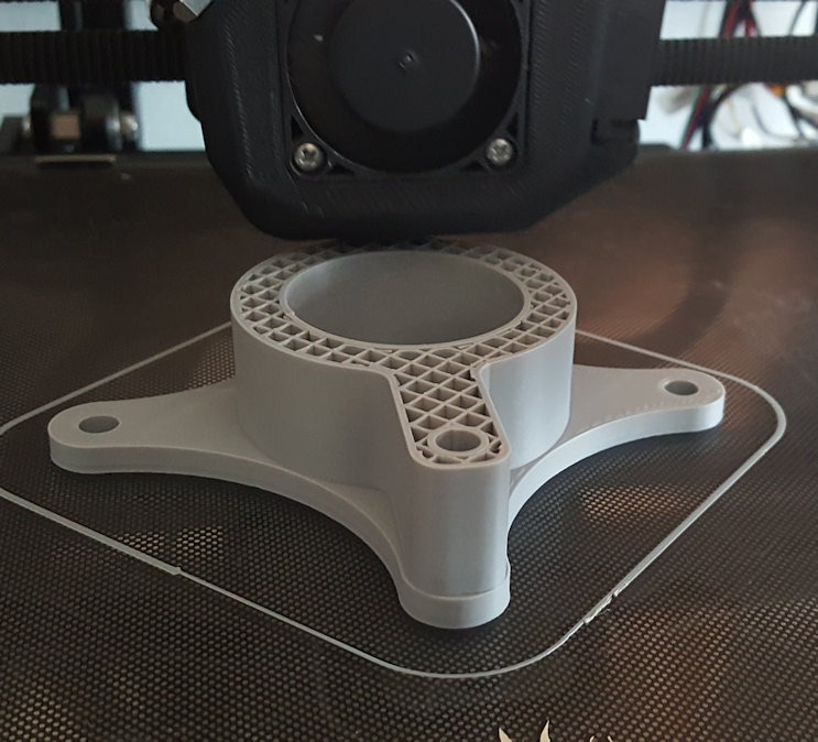

(Loading extension adapter in the printing...)

Tried a different mic capsule as I have a bunch of them from the previous experiments with plane wave tube which turned out to be quite complicated.
(Now I want to add some rack and pinion gear with a gauge for an easy and accurate mic plate positioning... part of the fun.)
