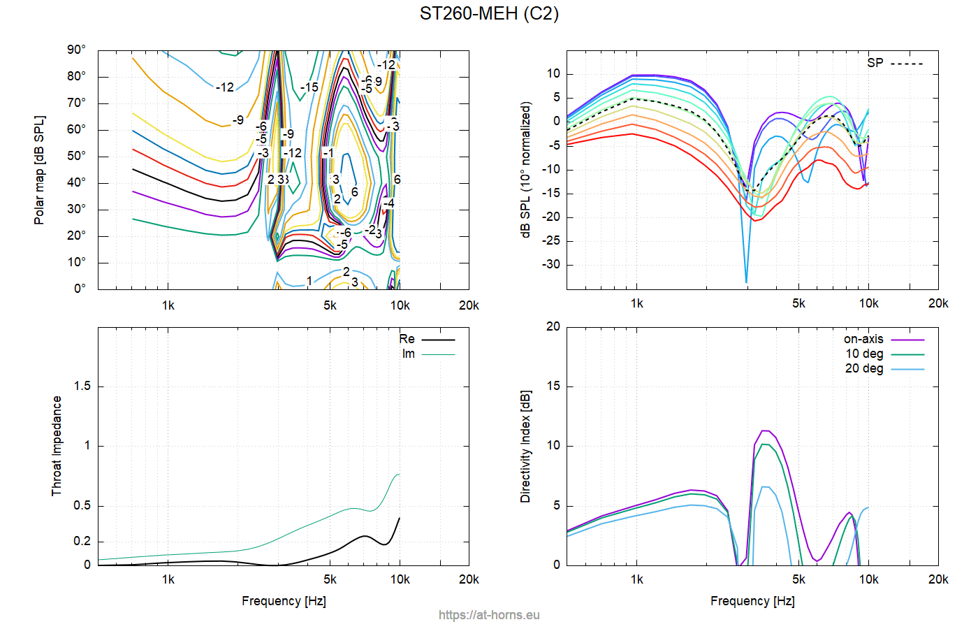

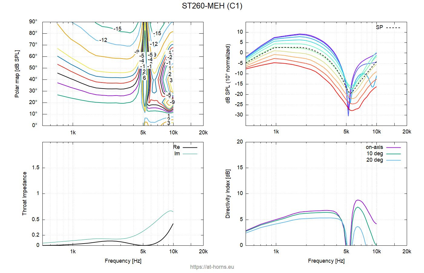

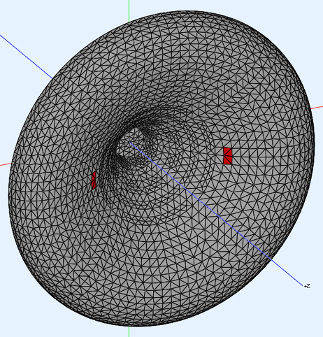

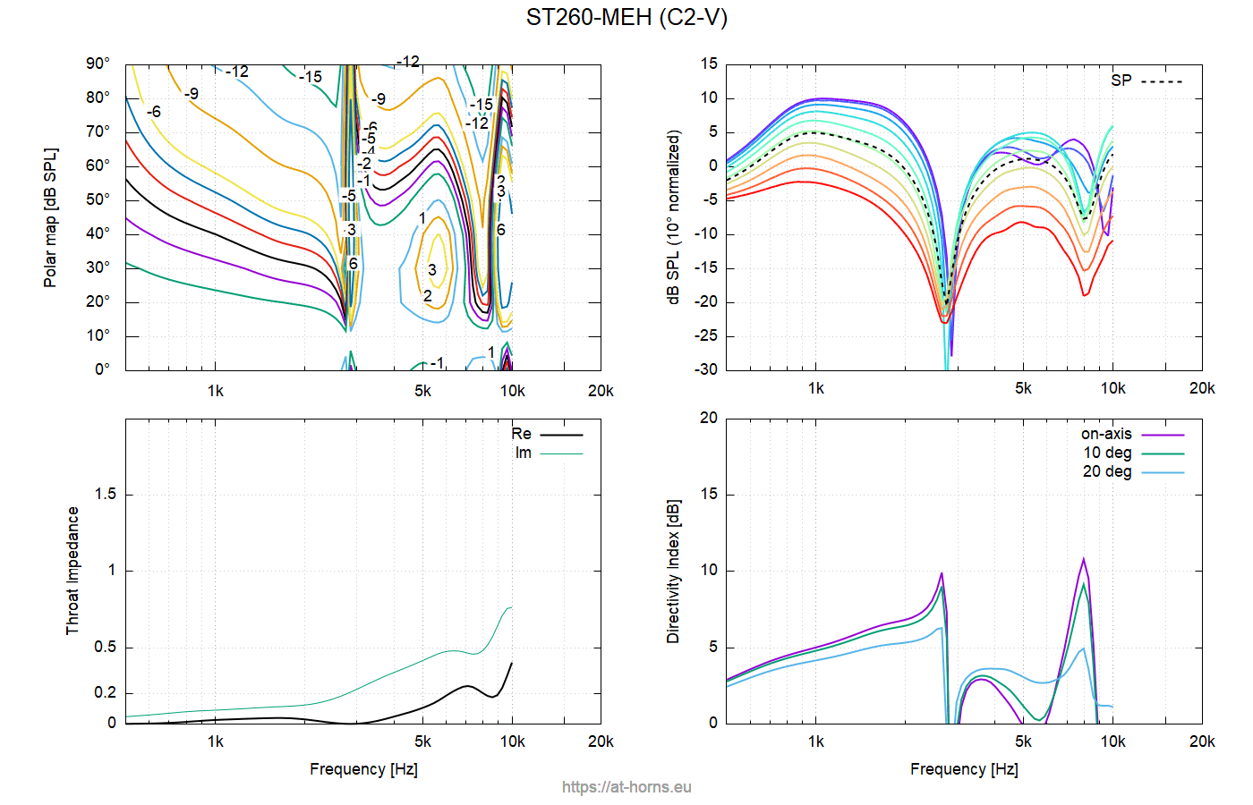

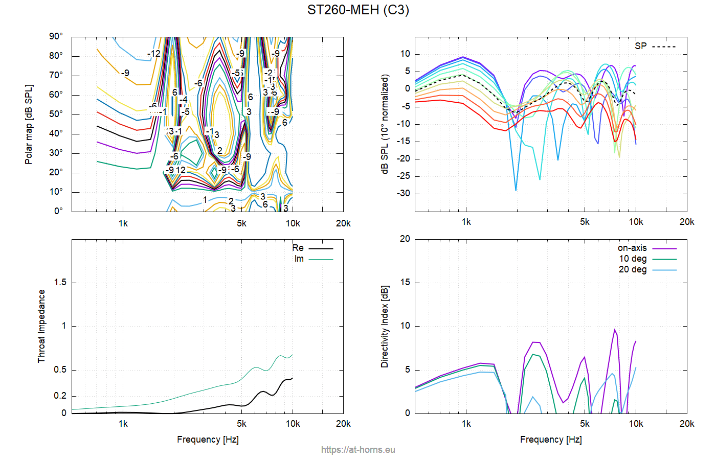

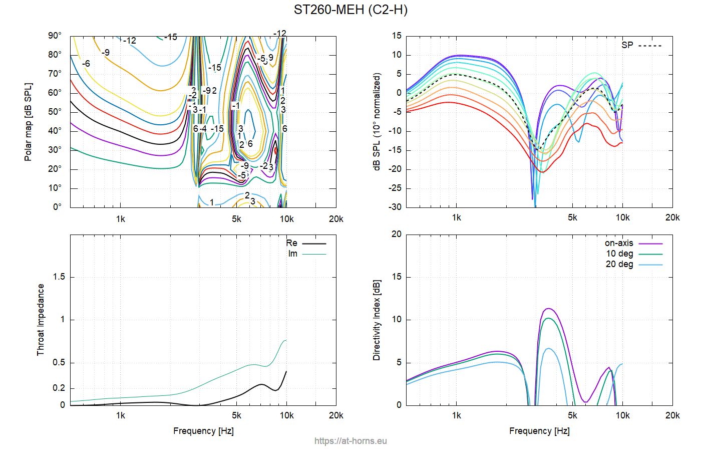

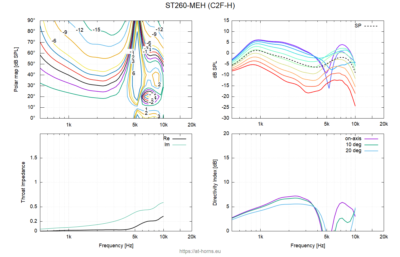

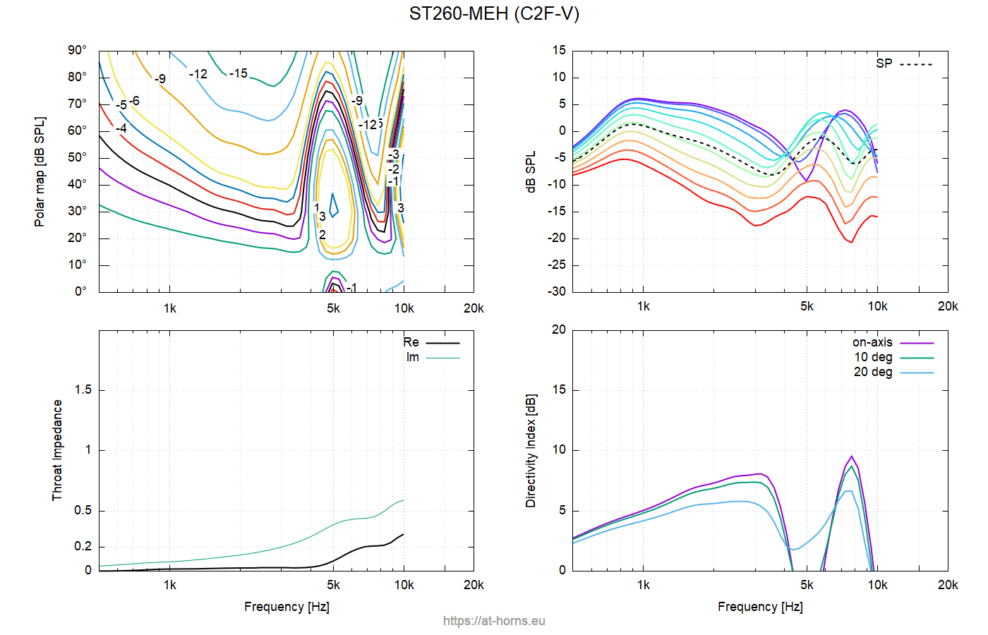

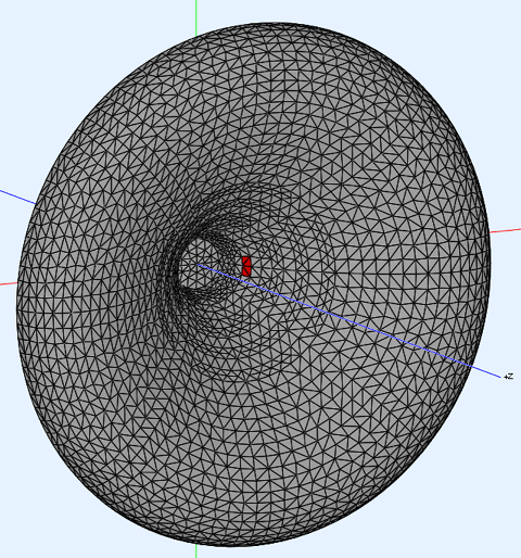

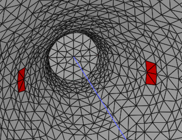

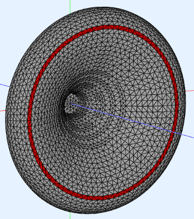

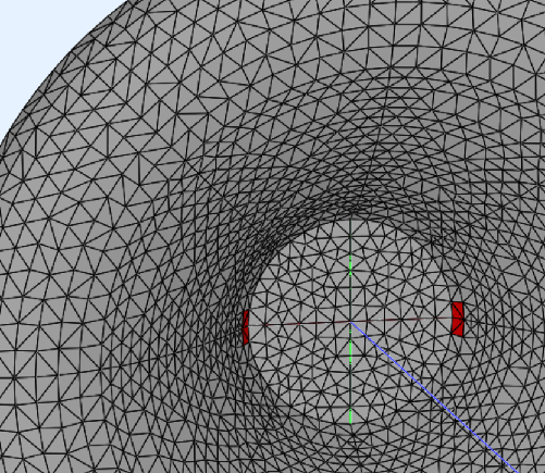

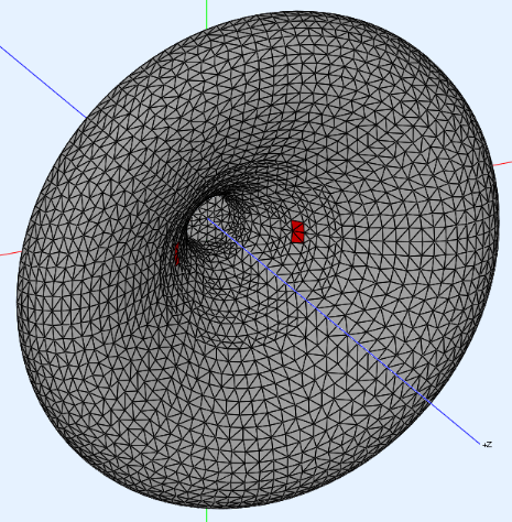

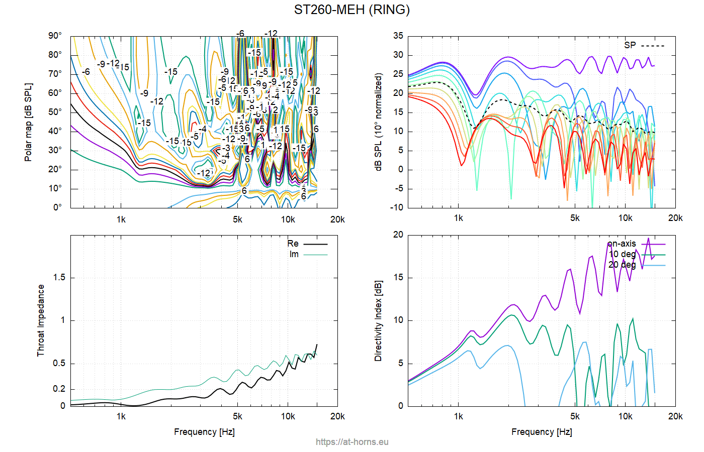

That's a good question. What I at first considered an effect of the acoustic low-pass is acutally a cancelation inside the horn - see the following.
I took a regular ST260 and manually set chosen boundary elements (shown as red) as a sound source, at three different locations:
So this is really a very strong factor actually, but perhaps for a bit different reasons.
(The polars 0-90/10 are not normalized, despite the graphs saying otherwise. The polars maps are normalized though.)

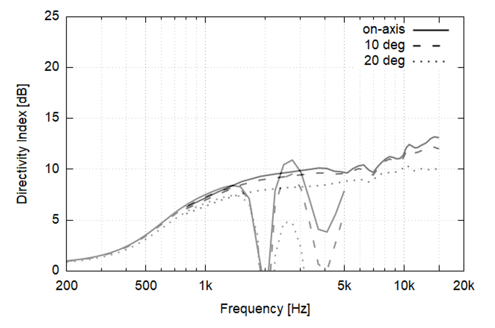

Isn't a "reversed MEH" a better proposition. The more favorable location for a driver should be at the end of the WG - no? High frequencies, say > 6-7 kHz, could instead be injected via holes in the side of the WG - those holes should be possible to make smaller than for mids and be less intrusive to the WG in general (long waves skip small holes, short waves fall into large holes ). So, a (larger - means we need to leave the "260" territory) WG fed by an ordinary cone driver usable with desired directivity from say 500-600Hz should be much more desirable than optimising a WG for being perfect above 13kHz ->.... Small CDs for 6kHz->
Or?
Possible?
Or?
Possible?
Thank you! What were the distances? Both axial from the throat and between the radiation points.That's a good question. What I at first considered an effect of the acoustic low-pass is acutally a cancelation inside the horn - see the following.
It seems like the cancellation dips from the throat reflection gets close in frequency to the horizontal interference between the two mid ports in this example.
Is it possible to add a hard surface just behind where the mid ports are to disable the throat reflection and thus isolate the horizontal interference pattern?
