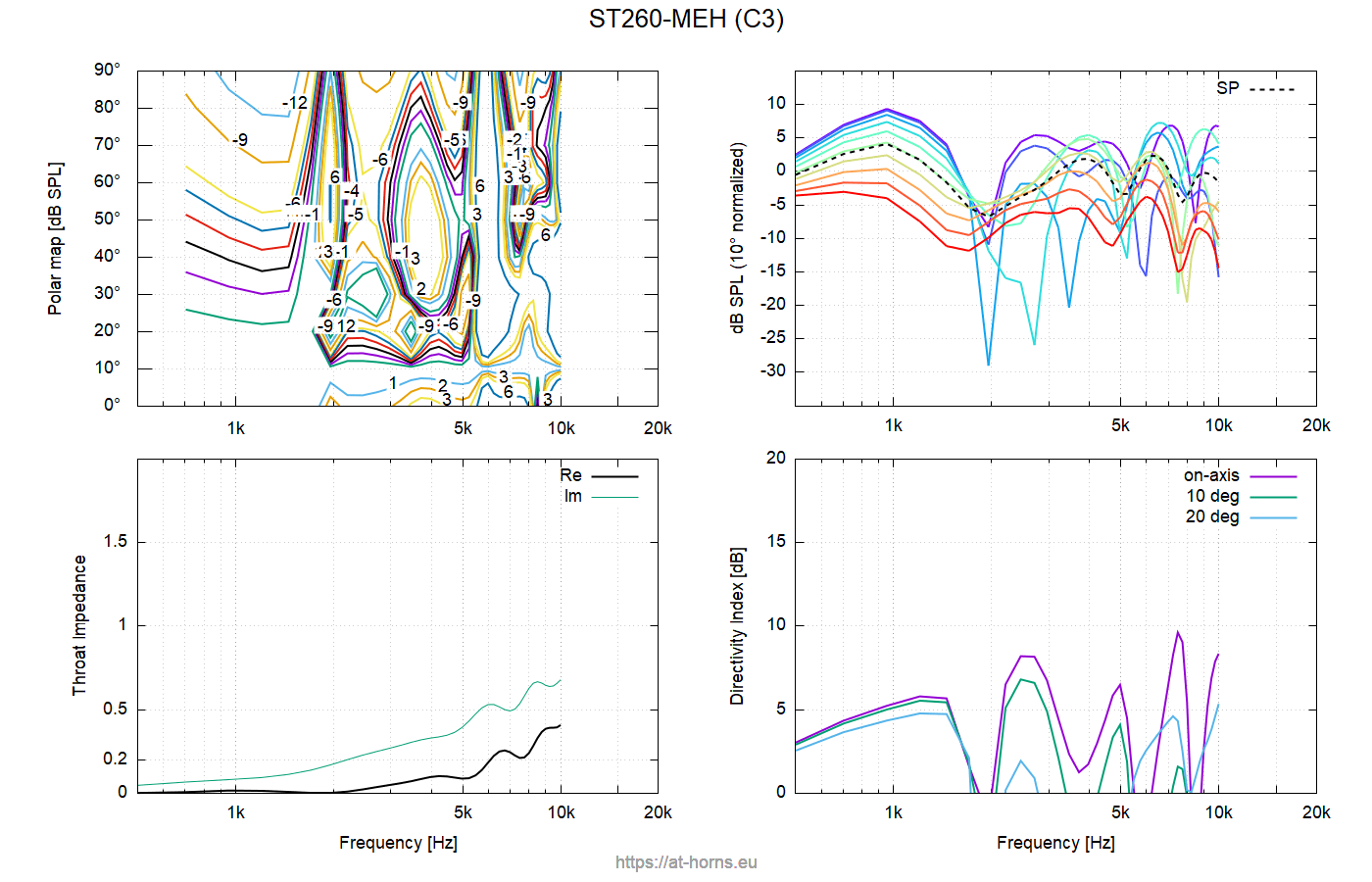

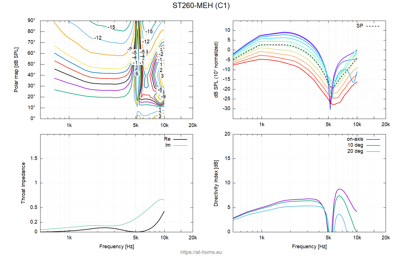

I'm surprised that the interface pattern is very soft (broad dips) compared to the throat reflection. Maybe being inside a wg smears the polar pattern compared to a flat baffle. Dips are also higher in frequency than what I initially thought. This is good news since it enables the mid ports to be placed further from the apex compared to the 1/4-wavelength (mid spacing) rule. Easier to time align with a tweeter and less diffraction from the mid ports in the tweeter sound.

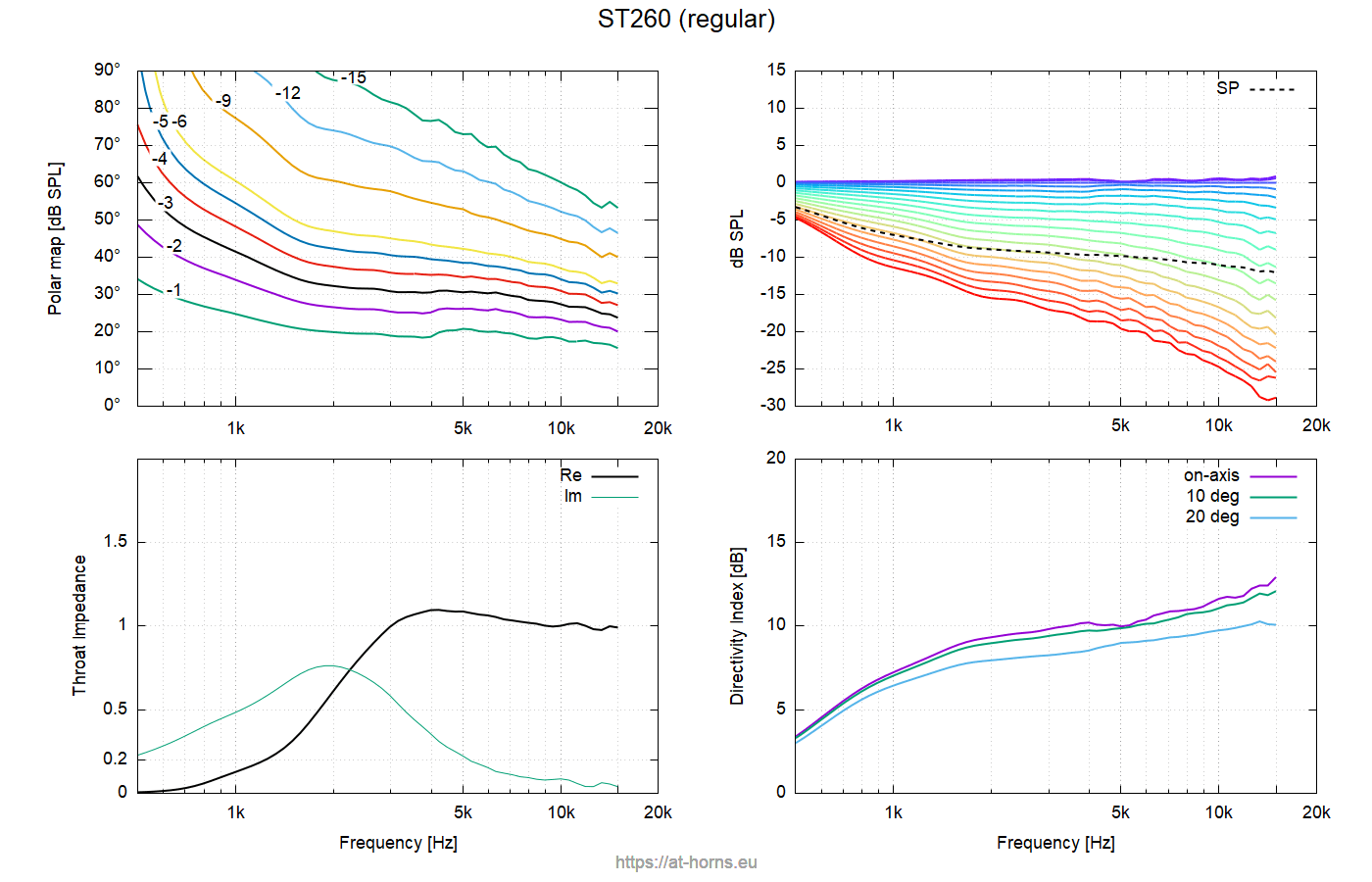

Just to stay within context, this is the regular ST260 (again) -
("SP" is the equvialent total radiated power, i.e. a FR of a point source radiating the same total power.
The on-axis ripple can be further eliminated, as was shown before, that's not addressed in this model.)
- I keep using it because it's small enough not to take a long time to calculate, yet it still covers all the design aspects.

How do you set boundary elements like this? I'm wondering what happens when you include the conical portion of a compression driver such as a B&C DE250. In that case, 35mm length total (~10mm of phase plug above the diaphragm, 25mm of conical horn to the exit of the compression driver).I took a regular ST260 and manually set chosen boundary elements (shown as red) as a sound source, at three different locations:

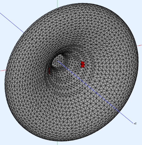

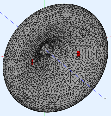

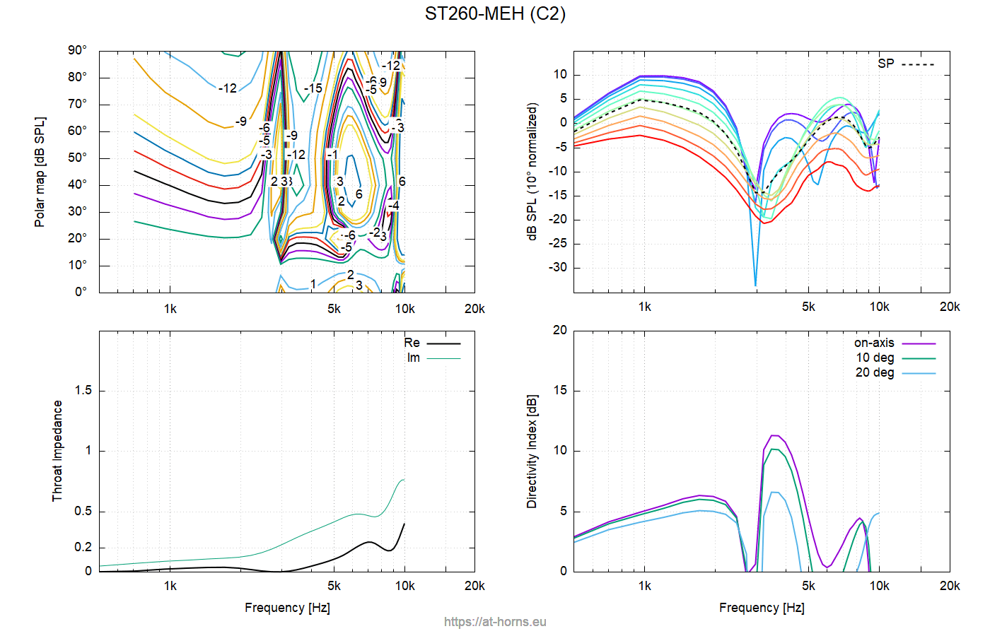

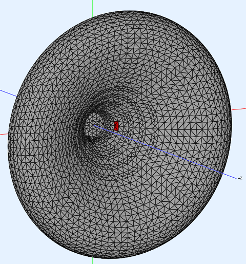

To me this looks pretty good!That's a good question. What I at first considered an effect of the acoustic low-pass is acutally a cancelation inside the horn - see the following.
View attachment 1141236 View attachment 1141239
View attachment 1141238 View attachment 1141240
View attachment 1141237 View attachment 1141241
So this is really a very strong factor actually, but perhaps for a bit different reasons.
(The polars 0-90/10 are not normalized, despite the graphs saying otherwise. The polars maps are normalized though.)
Just a thought experiment - could you rerun this, making the red areas completely absorptive and use the throat the driven element?
